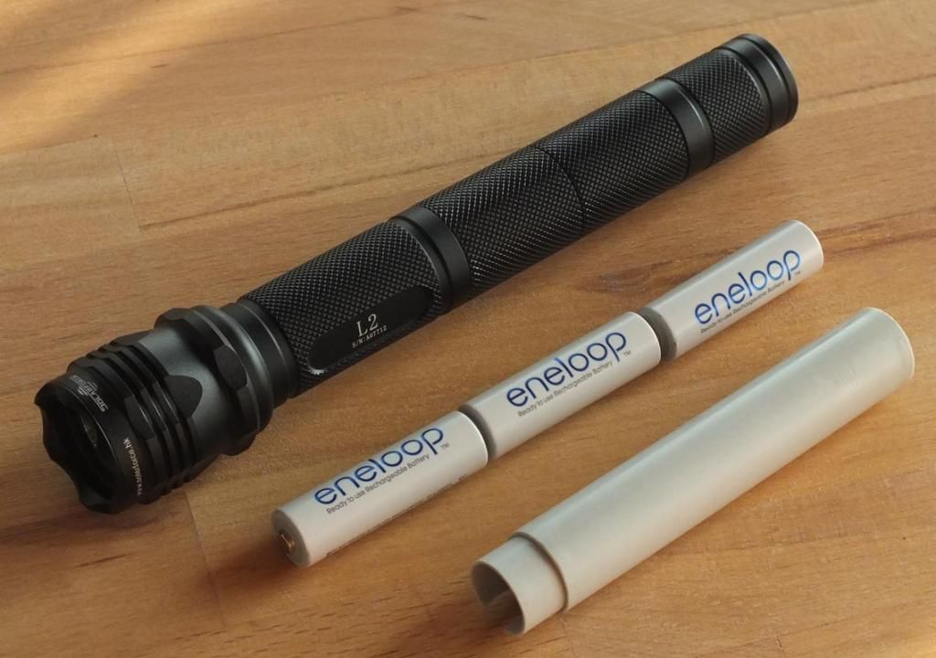

My setup of an L2 with 2x L2m extensions is 170mm long (overall length, no head, no tailcap). It’s 129mm on the outside without the threaded sections on both ends, this is what should matter as head and tailcap sit on these points. But I think the threaded sections are quite similar in length on all Solarforce hosts, so overall length will be a valuable number.
Be careful with the 3AA, in my setup it did not work with a usual dropin. I tried it carelessly and my eneloops are dented at their backs now.
I recessed the driver in the pill and enlarged the space in the tailcap, as I usually do on my L2m/18500 builds, to get enough space. It’s a tight fit already.
I could cope with even less space (4x Nanjg instead of 8x and completely sunk into the pill / filing down the reflector) but I’d like to know if it’s doable at all. If the L2-D18 is more than 5mm shorter than my setup, it’s useless.

Total length of the tube from top to bottom is 16,8 cm. 3xaa won’t fit, they stick out the back, with a 16340 extension, it works prefect after tossing in a coin on the back 8)
The host usually just fits the cells, absent of the threads. 18650 cells measure about 65 to 68 mm’s. 65mm times 2 is 130mm’s. Just right for 2x18650 cells. Typical AA cells measure about about 50mm in length (Using the 14500 cell theory). So one would need a 150mm host (absent the threads) to get 3xAA cells inside.
