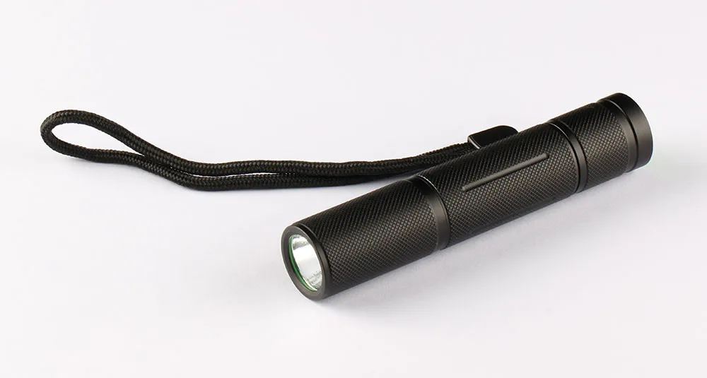

The S3 has an integrated head that should transfer heat better than a pill, it is several mm shorter, and (IMO) looks better than the S2/S2. Why does it not get the same attention from BLF and modders that the S2 and S2 enjoy?

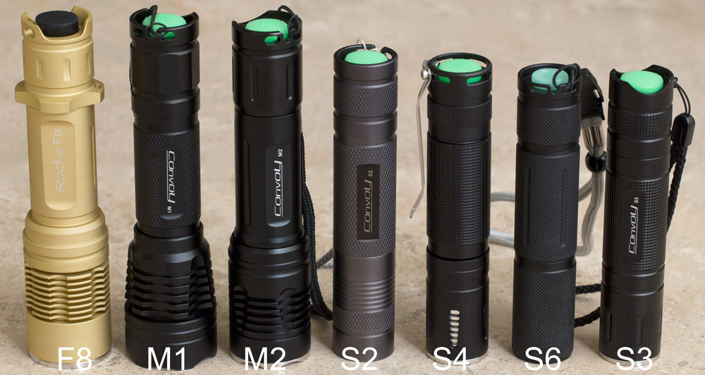

I really like the aesthetics of this light, but it’s not a good go-to because of the integrated shelf design which makes it harder to mod. I vastly prefer a removable pill design, making it easier to disassemble, modify, replace emitter, etc. This design also makes the connection with a good spacer for a triple build worse than a brass-pill design.
My personal favorite is the Convoy S6, which has the removable pill, sleek design, and no branding:

hmm a S3 head, S6 tube and S4 tail would have my preference

Just fell in love with the F8! that one in matte black (flat black) would be awesome.

Took a better look at the S3 Host. Appears it now has the Flat Black finish as on the newer production models. I like that. But no pocket clip groove… don’t know why not. I would never “deep pocket” an 18650 light. Maybe a clip on a pocket.
