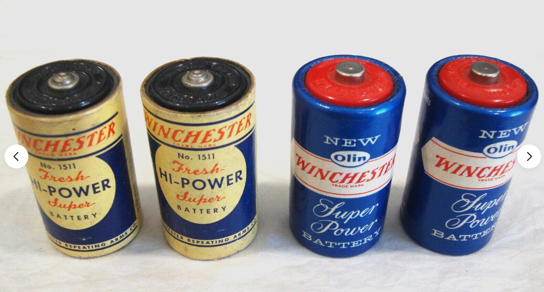

These have to be 50 years old. Was the chemistry different back then? 50 year old Duracell’s would be completely covered in white chemicals.
Thoughts?

Yeah, I’m thinking the chemistry used was different back then.
Newer technology is most likely cheaper to produce, but leaks.

Thicker metal walls, most likely. Takes longer for the electrolyte to eat through them. Possibly the electrolyte became neutralised by age before it managed it, because it’s not going to last forever due to impurities in the manufacturing process (IIRC, impurities are also the main reason along with heat accelerating the corrosion process that alkaleaks tend to leak as often as they do, so it sort of works both ways though). The electrolyte will degrade over time, which is the reason alkaleaks generally have an expiry date, normally 5-10 years out. The electrolyte available 50 years ago was probably also less pure so likely would degrade faster.

I’d expect these are zinc carbon batteries which don’t leak like alkalines, but have lower capacity and voltage under load.
I recall reading that batteries used to have mercury in them, that prevented leaking and bulking.
Those are zinc chloride cells, not alkaline cells. The physical designs and failure modes are not the same for those cell chemistries. They also had mercury in them, which prevented corrosion reactions and internal production of hydrogen gas. They have almost certainly dried out completely by this point, and are incapable of leaking now.

Zinc-carbon (or “heavy duty cells” nowadays) predate alkaline cells. As far as I know alkaline cells broadly outperform them: superior energy density, power density, shelf life.
Idleprocess is correct. Alkaline cells are higher in energy density, current capability, voltage stability under load, and shelf life.
Shelf life? The batteries in the picture are 50 years old? I don’t think 10 year old alkalines would look as good.
Lower performance and energy density and higher cost, in addition to releasing mercury into the environment when people inevitably chuck them into landfills and incinerators.

Just because the exterior of the can still looks good after 50 years doesn’t mean they still actually work.
Yes but the question was why haven’t they leaked, not why dont they still work. I think its mutually agreed upon that they stopped working many years ago.
They were listed in a 1949 ad for “only” 10 cents each. That would be about $1.27 in today’s money.
