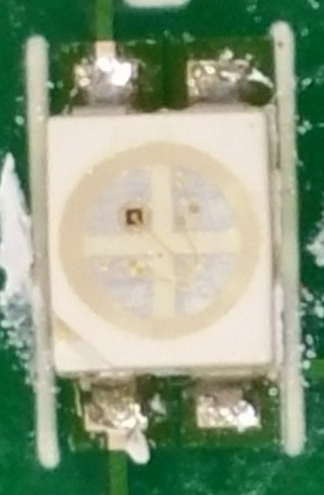

Update 2: I’ve taken a fresh PCB with LED on it (haven’t done any tests yet with just the LED) and soaked it in kerosene. I’ve taken some close up photographs of the LED before soaking, after soaking while it’s not working and after it resumes working after it’s been left to dry.
What the photos show is that there is a very obvious bulge in the LED lens during the period when it’s not working. Once the bulge recedes, the LED illuminates again.
Unfortunately, I don’t have a camera set up on the PCB to see the exact moment that it stops working. I’d let it soak for about an hour before it stopped working. I checked on the LED every now and then and noticed no change in the LED brightness. I came to check it once and it was just off. My suspicion is that the change is sudden.
Judging by the swelling, I’m going to guess that there is some mechanical damageinternally that’s moving something and once the swelling recedes it springs back to position.
Left: Kerosene-soaked LED; Right: Normal LED
LED in failed state after soaking
Normal LED
Left: Kerosene-soaked LED after being left to dry and in the working condition; Right: Normal LED
