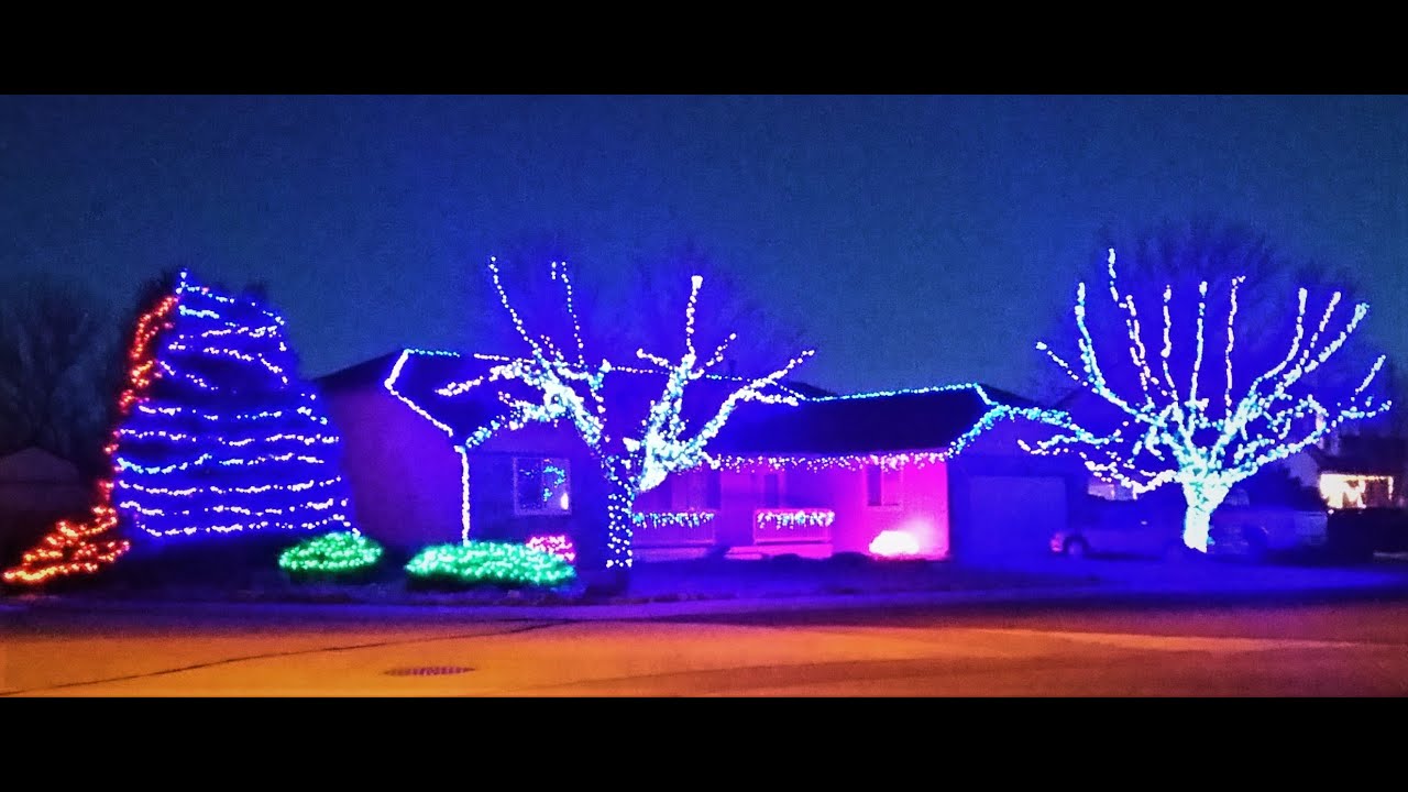

The flashlight led and the RGB-pixel led worlds don’t really seem to know about each other. I’m one of the few people with a foot in both worlds. “Dumb leds” (5050’s, strip lights, etc) are usually assembled as a 3-emitter chip and are color-controlled via variable current. You need a board that can do that to act as your driver. They can be anything from cheap single-channel remote controlled, up to big multi-channel computer-controlled units. I’ve got an old Light-O-Rama CMB-24 that I’ll be using with some new 12v rgb floodlights for Halloween this year. I’ll try to post something once I have them up and running. “Pixel” leds are 3-emitter elements that come in various form-factors, but are individually addressable. So if you have a string of “100 leds”, “dumb leds” will all be the same color and all on, off, or dimmed the same. “Pixel leds” could be 100 different things. Each pixel can be a different shade, some can be on, others off, etc. Each pixel can be controlled individually like a pixel in a JumboTron TV. (guess how they make JumboTrons?) If you group enough pixel leds together, you can make patterns, effects, and even JumboTron TVs using software like Vixen or xLights. Systems are usually built using a basic DMX architecture plus a ton of creativity. My lighting displays are heading in that direction. But pixel-leds are still around $15-17 US per 100. And that’s from Ray Wu on Aliexpress, so you know what the shipping charges are like. I’ve got a small display and my “light count” is already 18,100. So replacing everything with pixels is $$$$$$$$$$$$
This was part of my Christmas show last year. All of my lights are currently just conventional AC-leds from the discount stores. But if you watch the whole video, you’ll see why I want the super-thrower and can probably guess when it would turn on.
