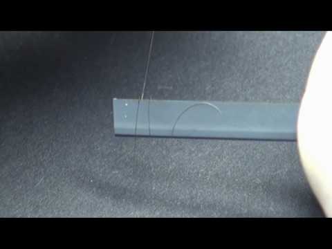

Well, the verdict is in, and it's AWESOME.
I tried it on some duller-than-dull kitchen knives with the 40-degree (inclusive) guide attachment, and they ended up hair-popping sharp after ten passes with the medium grit, then ten with the extra-fine grit.
My EDC went through next, using the 50-degree (inclusive) guide. After the same treatment, I was able to push-cut some very thin receipt paper easily.
My forearms are now hairless, thanks to a few passes with the finished blades.
The WSKTS is highly recommended for those wanting a no-hassle razor-sharp edge on their blades.
Now all you need to do is post a video.

I hate to split hairs(Sorry for the pun) but how difficult is it for the blade to shave after coming out of the WSKTS? A video would be great, the only bad reviews Ive seen said when they were finished the blades were reasonably sharp but not a truely keen edge, barely able to shave hair. Which was a huge disappointment to read.
Your review on the other hand sounds much more promising…does it shave cleanly smoothly with little effort? Could the 50* inclusive EDC edge shave similarly to the thinner bladed kitchen knives? Did you order any additional aftermarket belts?
Sorry for all the detailed questions just trying to quantify the results you achieved (as a fellow members word I take with more weight than a random from the interwebs) before I take the plunge myself which is nearing.

One way to make it shave better would be strop it on some leather, because it’s a convex edge. Or if you really wanted to use newspaper, just put it on the leather. If you have any compounds that’ll work well to. Being literally abraded with sandpaper, it’ll have some burr left over, so if you remove that, it should could smooter.
The EDC came out shaving sharp as well, but required a bit more attention than the kitchen knives.
A light touch helps quite a bit, and the guards can be dispensed with for the advanced users - I'm not there yet !
I plan on ordering a few intermediate grits, but overall this is something that I consider a game-changer that a monkey (me!) can use without f@#^ing up the blade.
