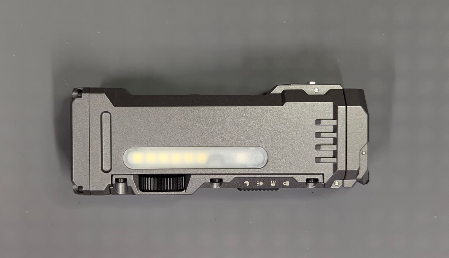

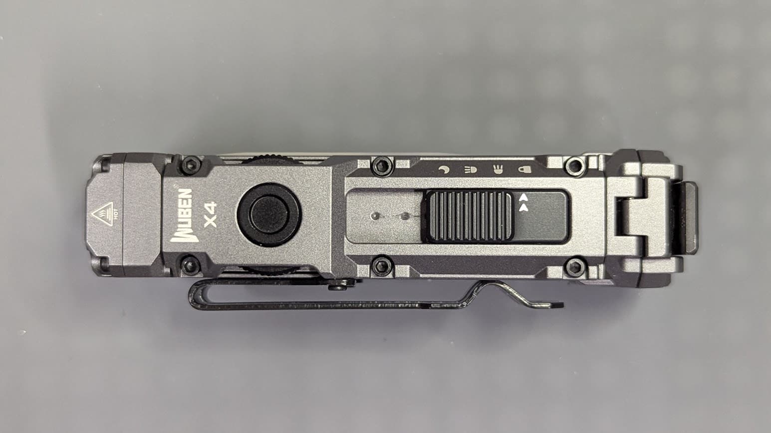

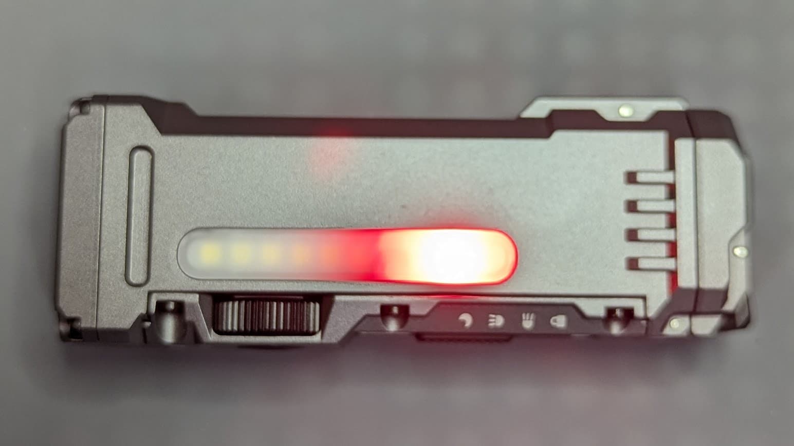

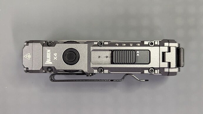

Side view with slider switch and button. Rotary dial is also clearly visible. The slider is to select the mode: Locked, side light, front light, moonlight. When set to moonlight, the USB-C charging port is now visible.

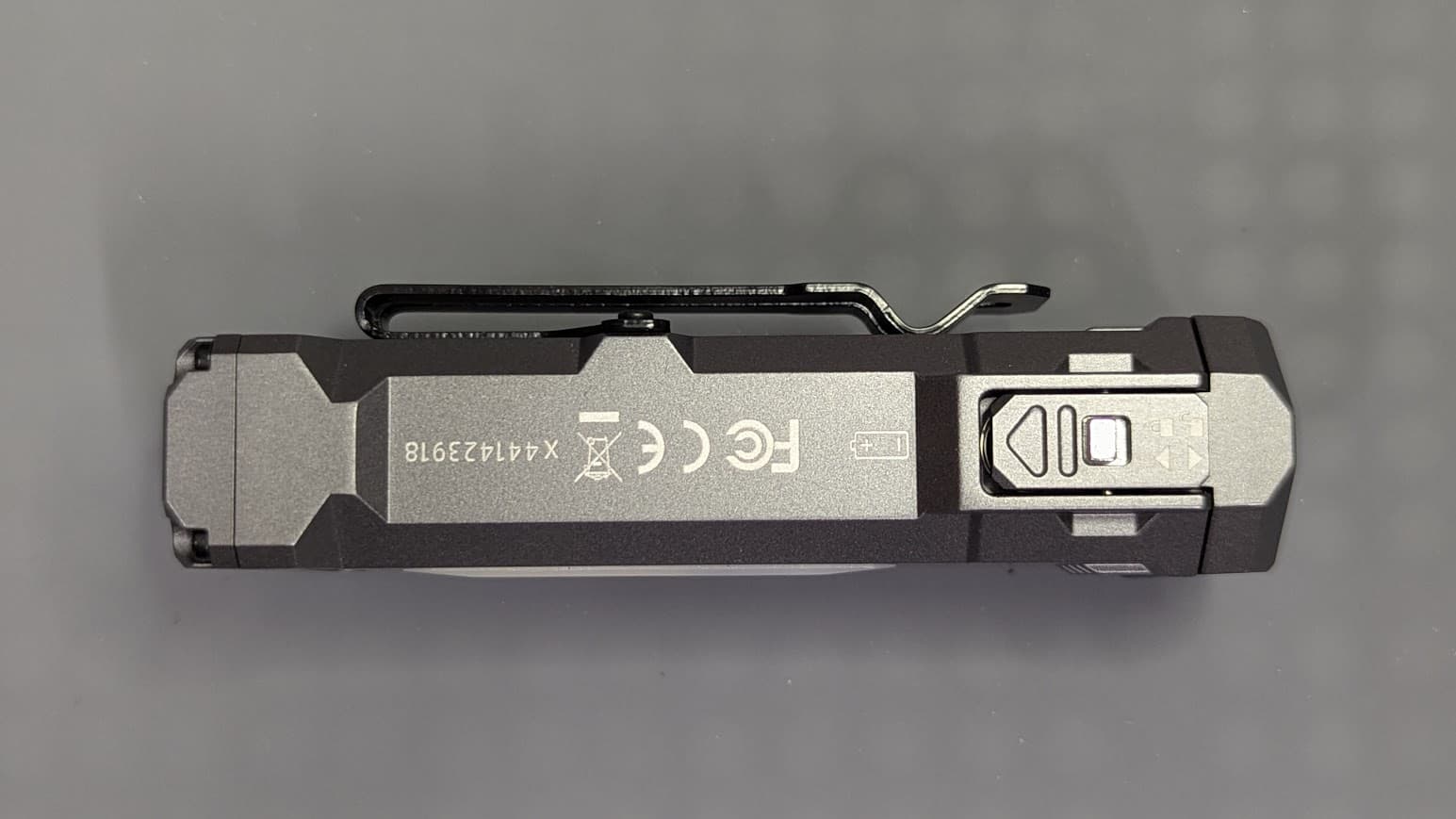

Rear side with clip

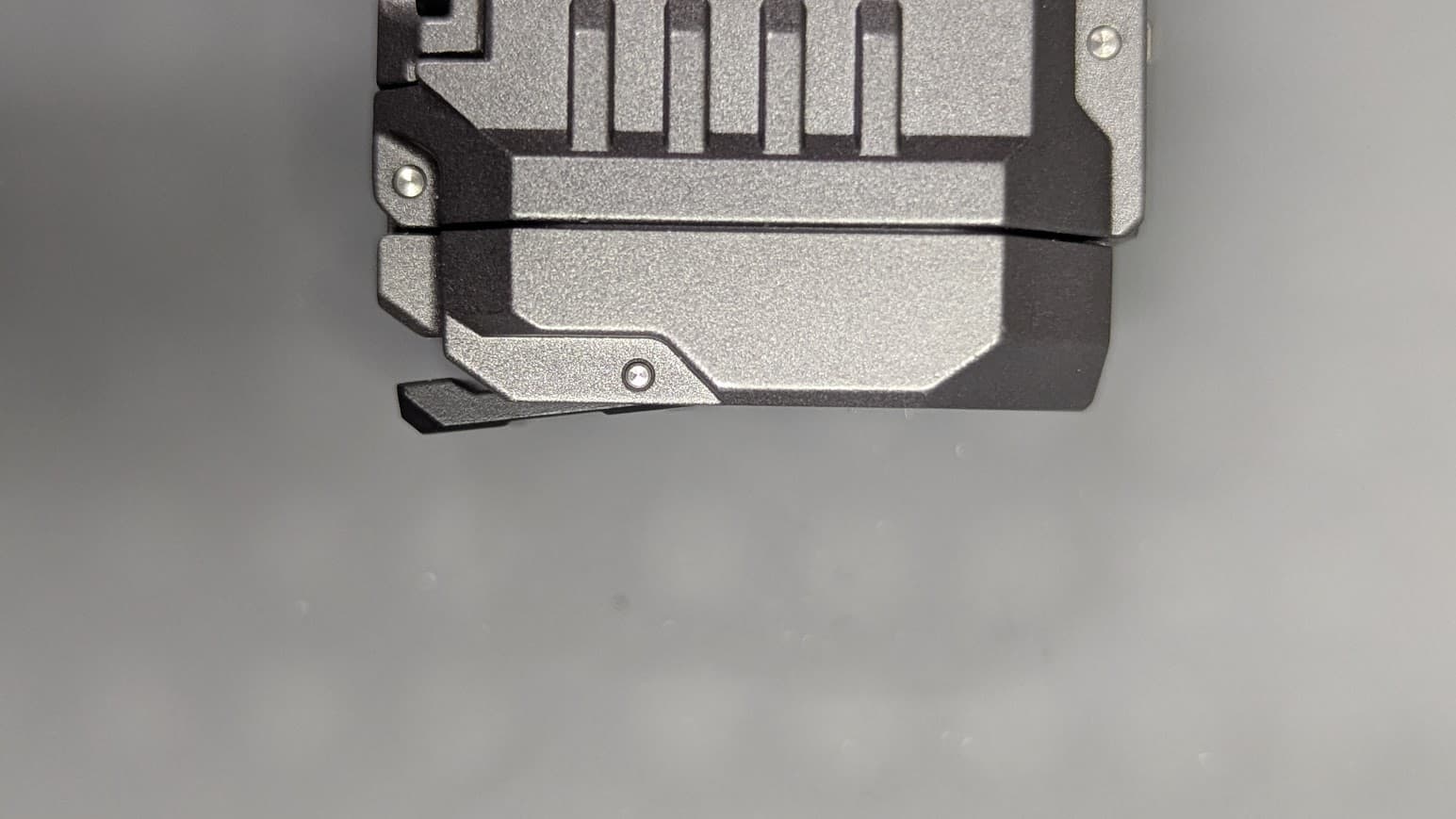

Side with battery door clasp and locking mechanism

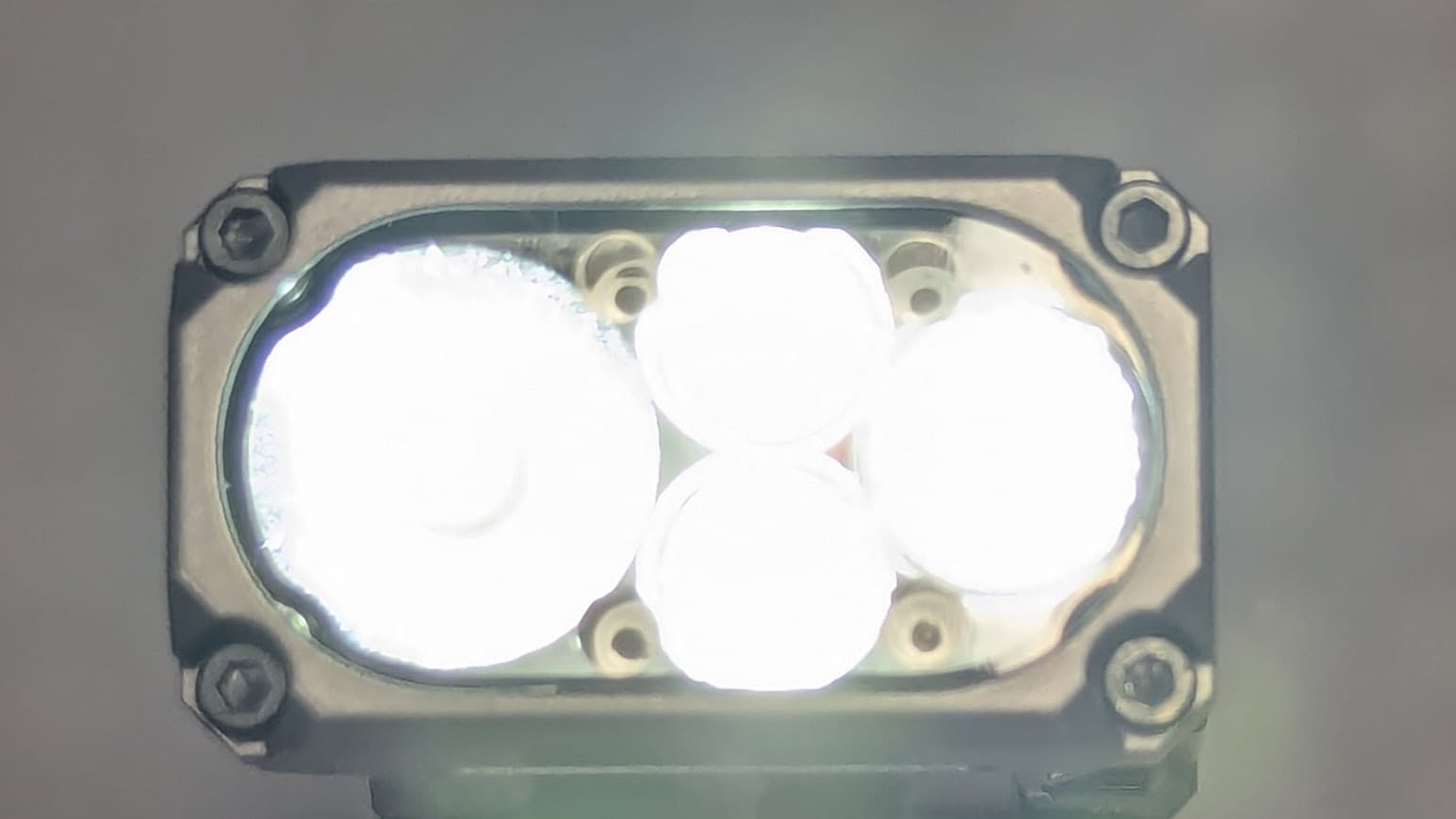

Front view with 4 LED’s
(Sorry! I couldn’t get my phone camera to dim this down)

  • The wheel feels a little gimmicky. But, I like the wheel. It’s very easy to dial in the brightness you desire. Or set the RGB to one of the 7 available colors.

  • The side COB light isn’t very bright. However, it’s enough to dimly light a room.
  • The slide switch. It’s very easy to select which mode you want. And it has a nice click and haptic feedback to let you know that it’s now in one of the modes. And hiding the USB-C port behind is kind of ingenious!
  • The tail switch is extremely handy. And it has a nice click to it.

  • Even though there are 4 LED’s for different types of light, flood and throw combined (and then I’m not sure why the 2 extra LED’s are there. I guess to provide just more lumens?). You cannot select one or the other. You get all 4 LED’s, no matter what, even on Moonlight.
  • The LED’s have horrible CRI. Using an Opple 4, it was rated at 64CRI on the front lights and 77CRI on the side COB light. The only light I have that’s lower than 64 is a red 617nm W1 light. Not to mention that at low settings, the LED’s are very green! They get slightly better on turbo and when using at a distance. But, up close… not so much.

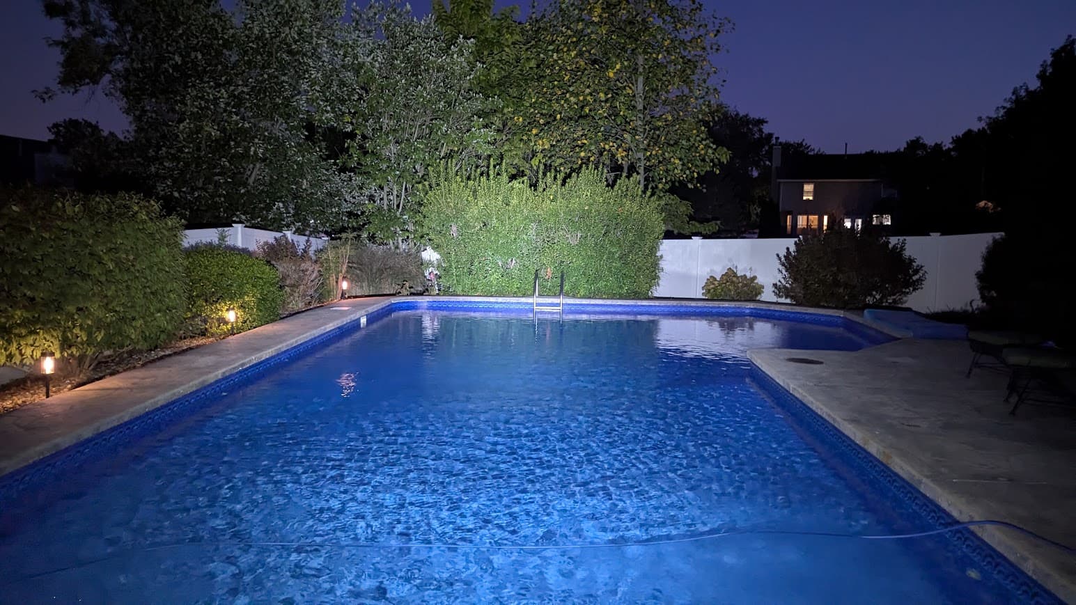

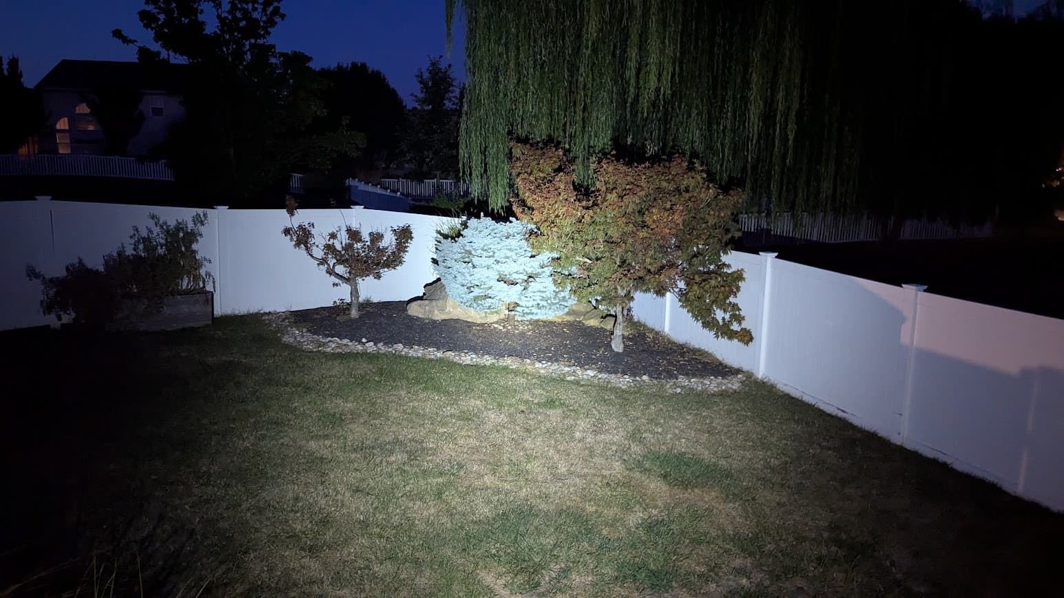

Beamshots:
Hedge at the end of the pool is approximately 20 meters
Shrub is approximately 15 meters

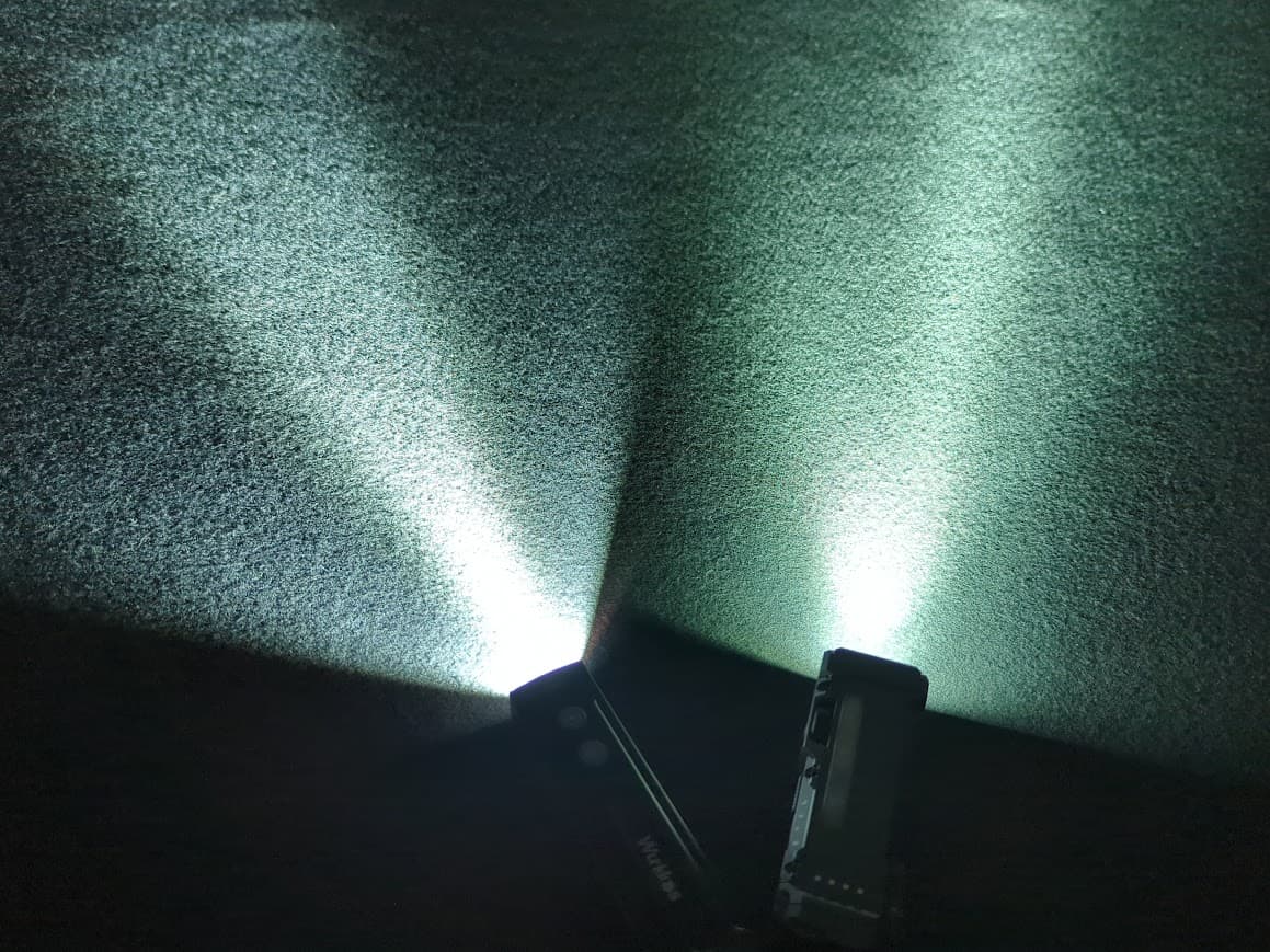

Wurrkos HD01 Pro on left. Wuben X4 on right (locked at 5200k)
