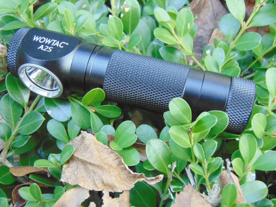

The light itself looks and feels nice to me. The Knurling and anodizing is all well done and I did not find any bare spots , pin pricks or thin spots.

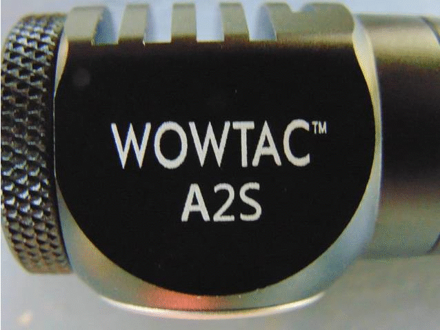

The Branding (etching) is also well done on the light.
The light alone and with the headband…

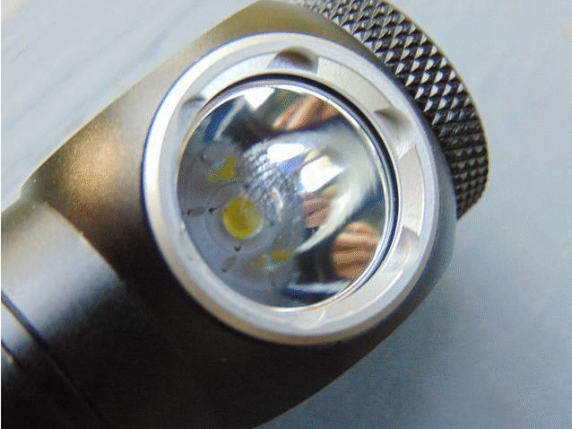

The reflector / bezel , again remind me of looking at a Thrunite product and all are very well made on my sample (s). ( received 2 of them)

The XP-L V6 emitter is well centered in the reflector and the AR lens is crystal clear. What fins there are on the light are well done.

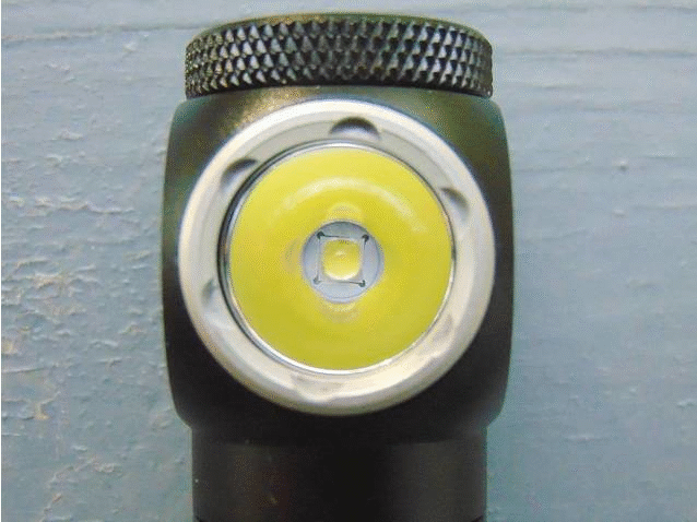

I know with the XP-L emitters , they usually have the egg yolk or greenish cast to them , but I was surprised with the sample (s) I received (cool white) as to how it does not have near that greenish cast in it like I am used to seeing with most of the XP-L emitters. Maybe I just got lucky with these 2 lights? You will be able to see what I mean in the beamshots and outdoor live video if you watch that part. If not , there are some GIF’s with the beamshots further down in the review.

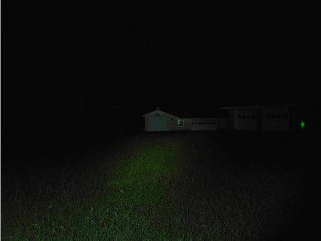

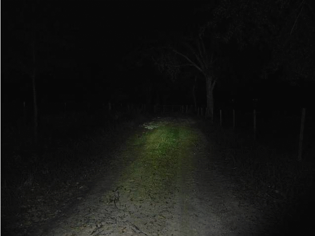

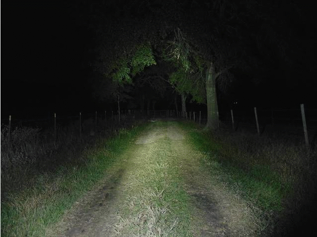

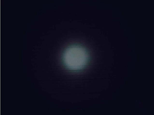

Here are the beamshots……
3 feet Firefly and Low…
10 yards— Medium / High / Turbo…
Gate 50 yards— Med / High / Turbo
Garage 70 yards — Medium/ High/Turbo
Gate 75 yards— High / Turbo
Gate 100 yards —Turbo

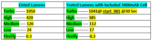

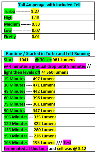

Here are the Lumens / Amperage and Runtimes from my testing…
