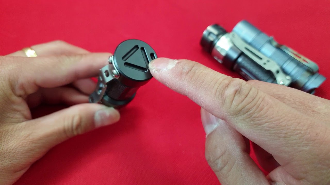

Does anyone know, what size trits fit on the RRT-01? Is it 2x12mm?
See this post by moderator007 https://budgetlightforum.com/t/-/47799/261
The post says that 2x12mm are too long and need some grinding. It says that 2x10mm should be fine, but I can only find 2.5x10mm. Anyone who has the light at hand, do you think that 2.5x10mm will fit without grinding?
I asked that question and he replied that the slots are not wide enough.
That does not make any sense at all. Tritium slots that need to be modded to fit tritium vials? What are you doing Jetbeam?

I was kind of dumb founded myself as to what they where thinking. 1mm longer slots and 2x12mm would work fine and the size is pretty common. When I first measured the slots I thought they would work, that’s the reason I ordered that size. But the slots are just barely not long enough. :person_facepalming:
I have seen a few post about people using 2x10mm trit vials, so I know they exist, I just can’t find a seller. I think there was a guy on the other flashlight forum that did carry this size, but don’t hold me to that. Have no idea if he is still even in the marketplace area there or not, I don’t visit there anymore.
And no the 2.5mm in width will not fit unless you modify it. 2x10mm is as big as will fit drop in style, of coarse anything smaller will fit also, just not as much illuminated area. I checked with a drill bit at 2.49mm and it will not fit. The slots appear to be as best as I can measure around 2.25mm wide. If you have a rotary tool and a small cutting or grinding bit, It doesn’t take to much effort to fit the larger 2x12mm and the slots are cut in aluminum.
If anybody comes up with a source with 2x10mm trit vials, please post up the source, several people here would probably buy 3 per RRT01. ![]()
I have seen a few post about people using 2x10mm trit vials, so I know they exist, I just can’t find a seller….
4 choices it seems
- unobtanium 2x10
- cut the slot longer and use 2x12
- cut the slot wider and use 2.5x10
- drop in a 1.5x6 and call it good
