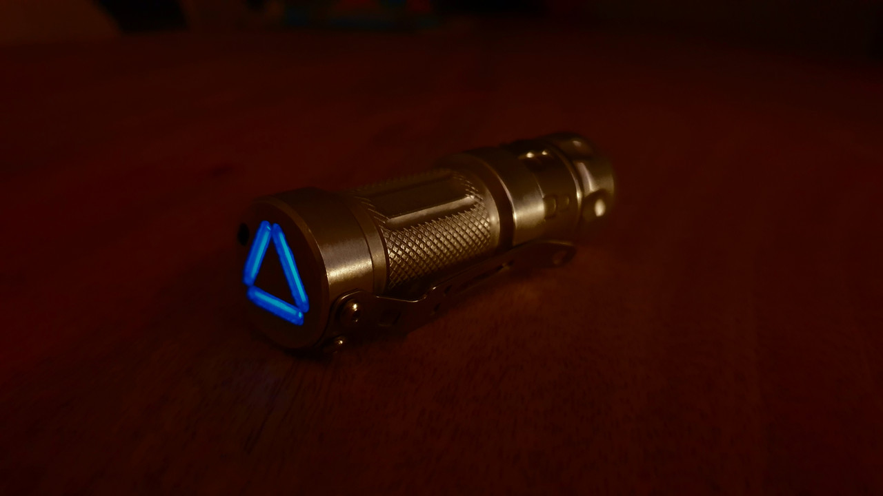

3 short ones laying flat on their side forming a triagle around the tail post, below the lanyard hole ![]()
