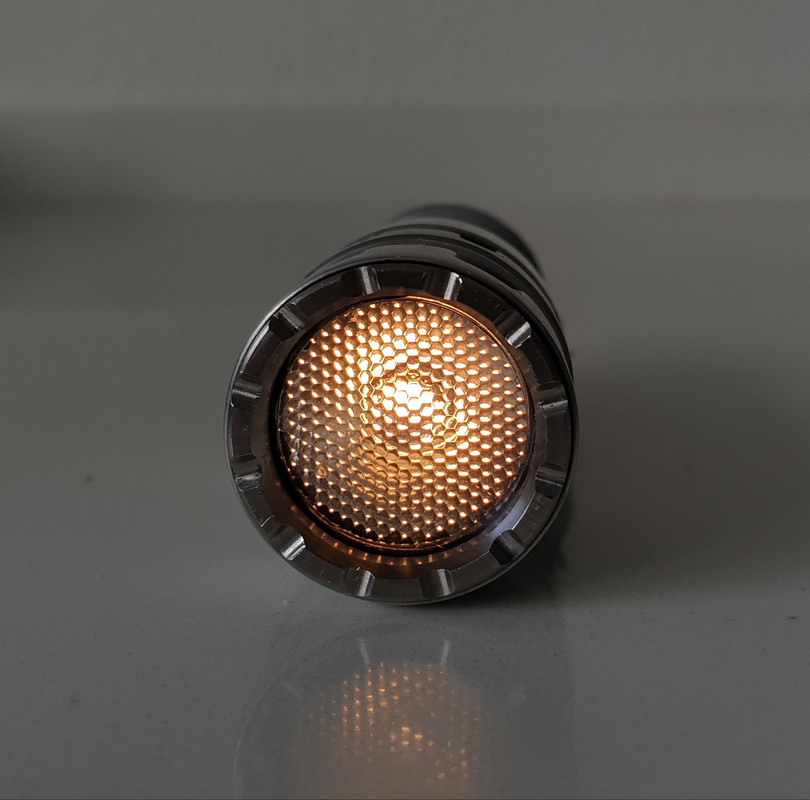

Old-Lumens called it stipple. Video - How I Stipple a Reflector
I have used it several times with great results.
