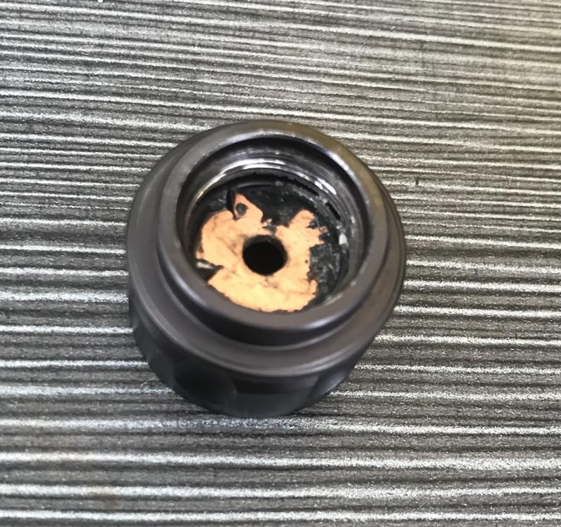

It was about time to post my poormans 2019 RRT triple mod.
Since i’m not a man of photos i only have 3 of them but you’ll get the idea
First, open and disassemble the head as already posted many times. Remove the driver and MCPCB.
I have used replacement driver from Jetbeam which has longer led wires so instead of soldering extra length needed for triple build, i had to cut them.
Open first beer and start filing 3UP MCPCB…
Since i didn’t meassure anything i had file and check physicaly fitment in the bottom of upper part of the head (see photo)
After 3rd beer MCPCB with emitters was ready for thermal adhesive (glue) and to be installed in the head. I have Phoby2, 2-component epoxy.
Next day i’ve stuffed the original led board opening in brass portion of the head with thermal pads which can be found in KD store (don’t have a link now)
Now Carclo 10507 was about to be filed which i did, again few beers helped me and at last i had a correct size for installatio.
Please note that neither MCPCB nor Carclo were perfect round circle due to hand tools!
Once you tighten the head back on the brass section, the only thing that’s left is soldering led wires, installation of Carclo, original lens oring and lens (with the bezel ring).
And that’s it.it can be done in few hours (1-2h) but alcohol and wife were crucial factirs not to.
Thermal pads are transfering heat from MCPCB to the bezel since i didn’t have heatsink at that time. MCPCB in this build seats high above brass section, in the bezel.
I have to add that one member shortly after sent me machined alu piece according dimensions of the section where stock led board seats and is to be installed when bezel and barss are connected. And of course i didn’t took a picture and i just realized i don’t have optics photo…damn it.
I believe most of you are familiar with the tasks required to be done once you see pics but if any info is needed, just shoot.
