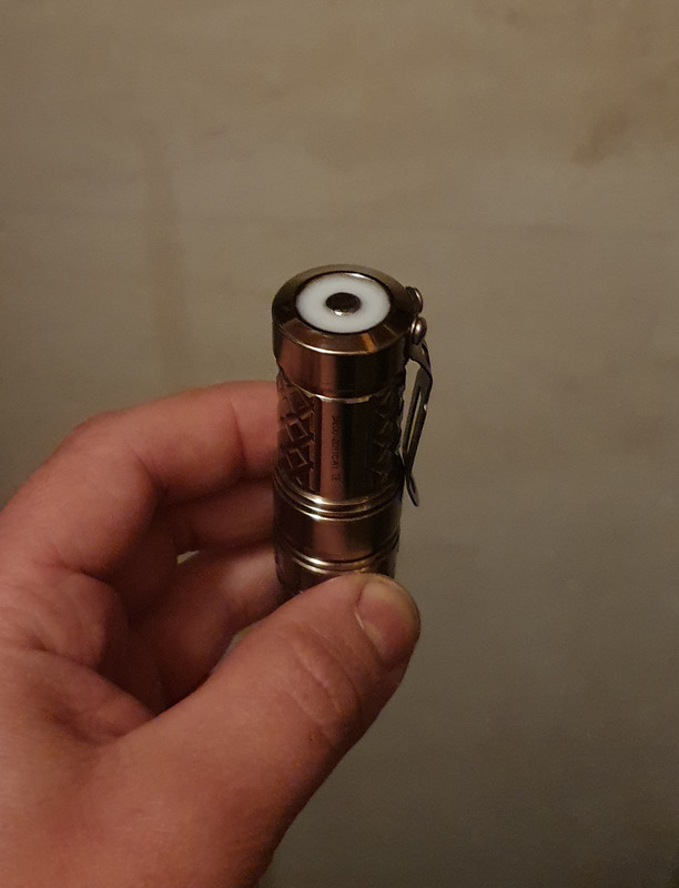

So, Multicolour or Blue? Vote!
Keep in mind that I will never actually be able to see both the Timasus pattern and the tritium colours at the same time, as it requires both natural an UV light at the same time to take these pictures, so it will be timascus with white vials in the light and glowing vials in the dark.
Blue!!
Blue
That looks BlueTiFull!

I do not agree with the use of tritium vials outside specially designed grooves, as I consider it unsafe. They are too fragile and the tritium is harmful if inhaled. Granted, in this case the recess at the back of the TC-R1 is probably protective enough, but still not as much as with the disks.
The vote is in and blue won by far. So, here you go...
Pretty sweet Pol77. :+1:
If I would have been on earlier, I would have voted blue also.
Thanks guys.
