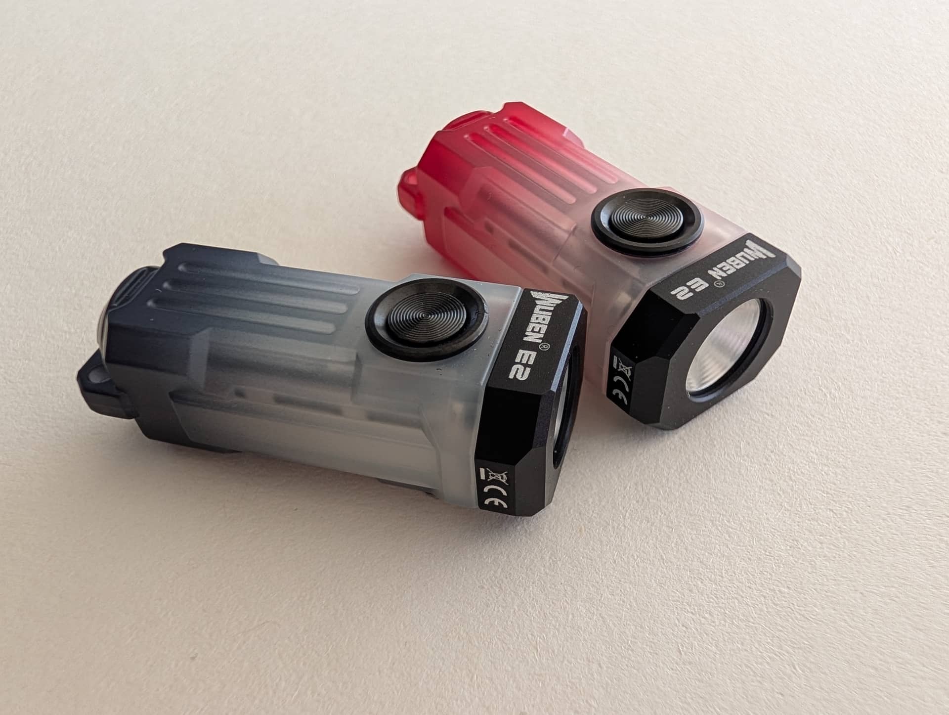

Wuben sent me two E2 and asked for a review - so here it is.

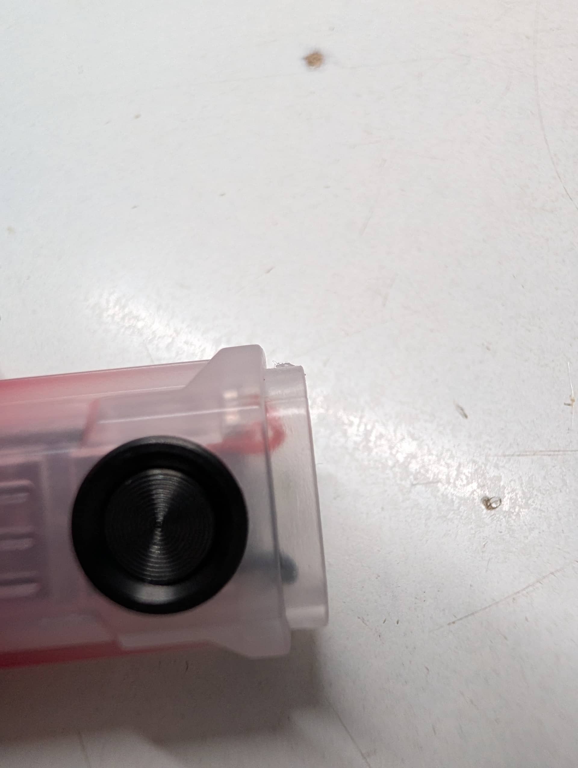

Why two? I asked them if they can send me two because I wanted to open one to have a look inside. I was expecting to have to dremel this thing apart to have it opened, because I was certain that it would be glued shut - which it isnt!
So, let’s give you a couple of pictures.

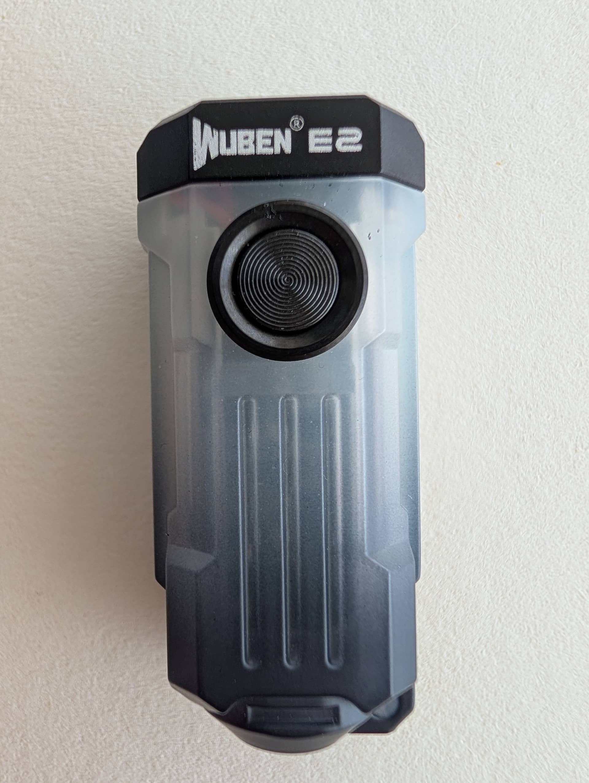

These lights look rather nice, I think. The gradient fits them well. The button is made from aluminum. The light is waterproof

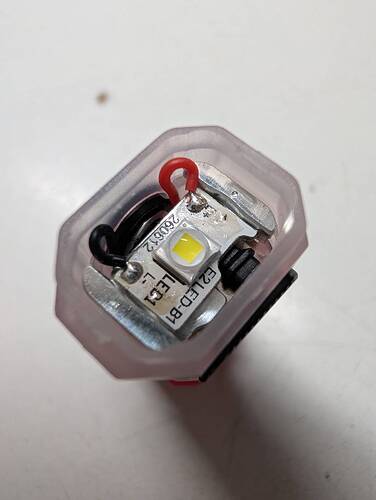

Behind the flat part there is a little PCB on both sides with a row of High-CRI LEDs and a blue and red one.
The USB-C cover is weirdly stiff, it’s not made from rubber but hard plastic with a glued-in part from a somewhat hard rubber. It’s not easy to get it away when you charge the light and it stopped me from disassembling the light further than I did.

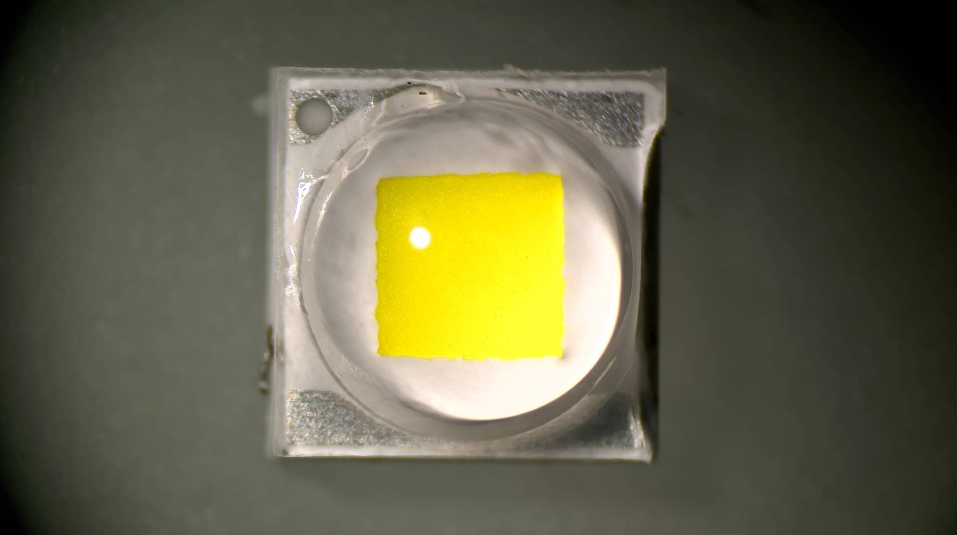

Some noname emitter
The damage on the right side is from removing it.

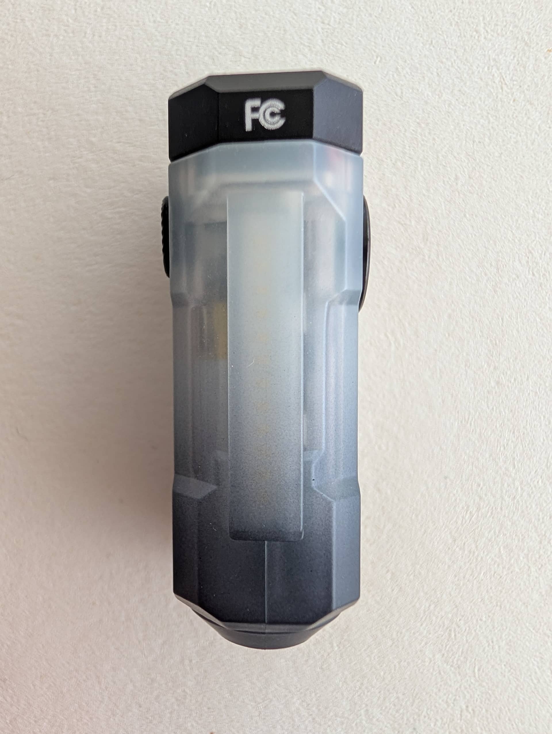

The magnet in the back is strong enough to hold the light on any angle, but it’s not super strong, so having it on an uneven or very small surface probably won’t work well.
I also don’t like magnets on lights made for the keychain.

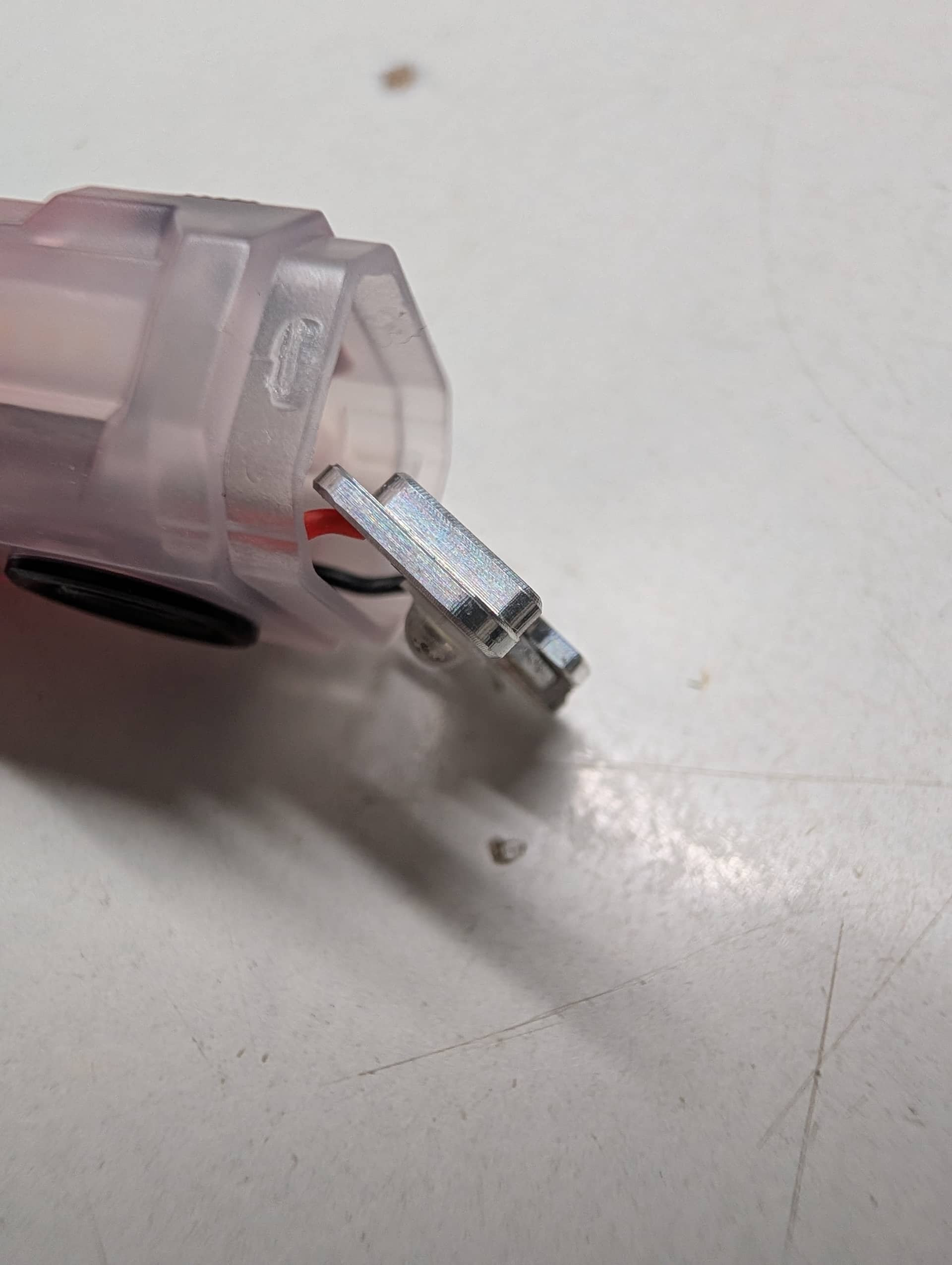

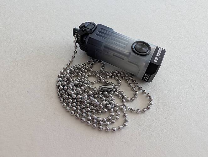

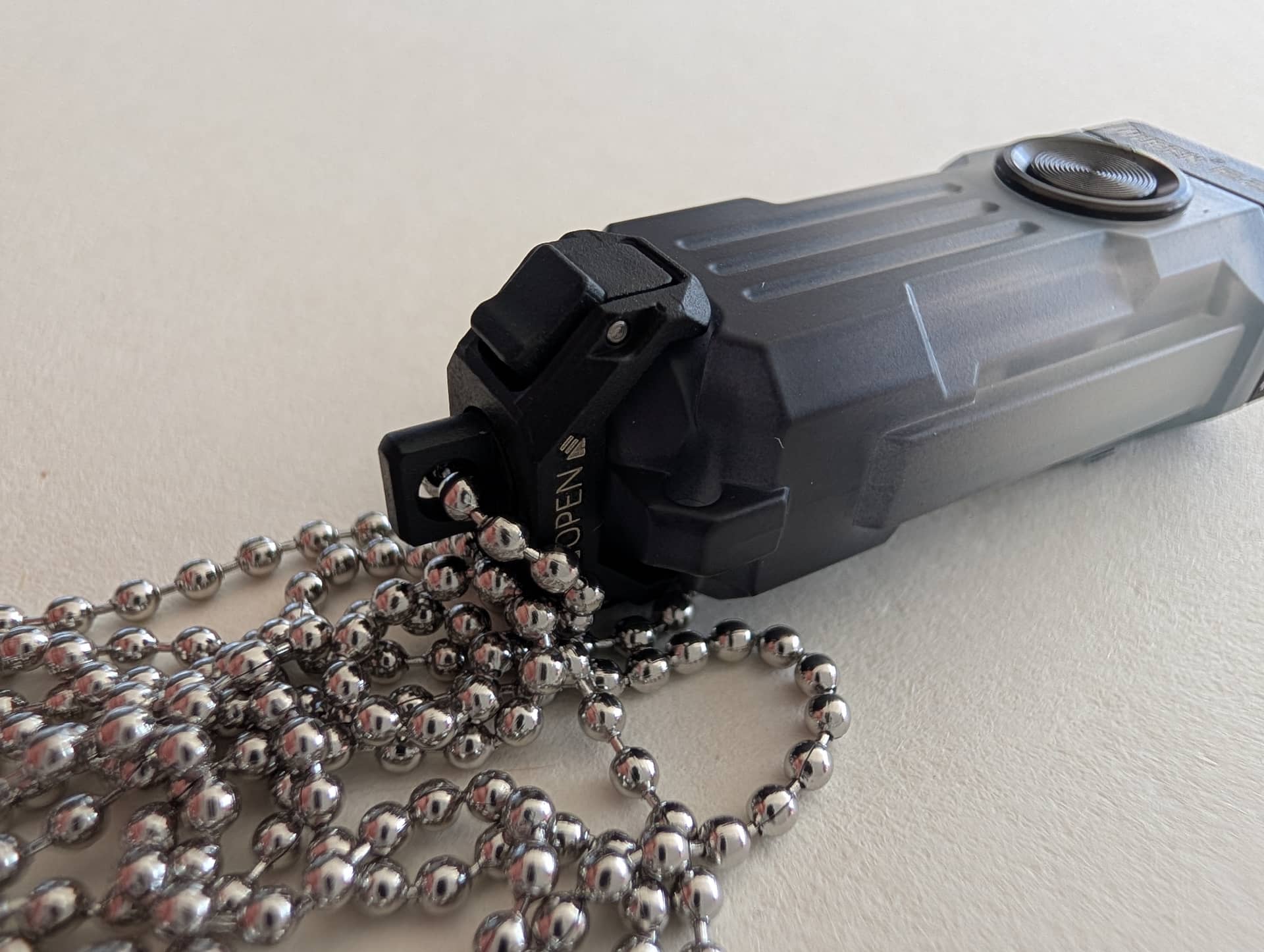

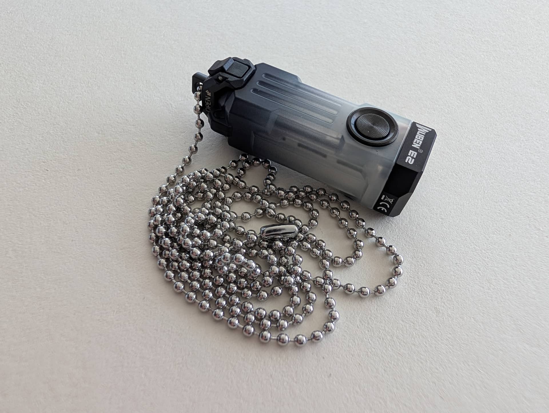

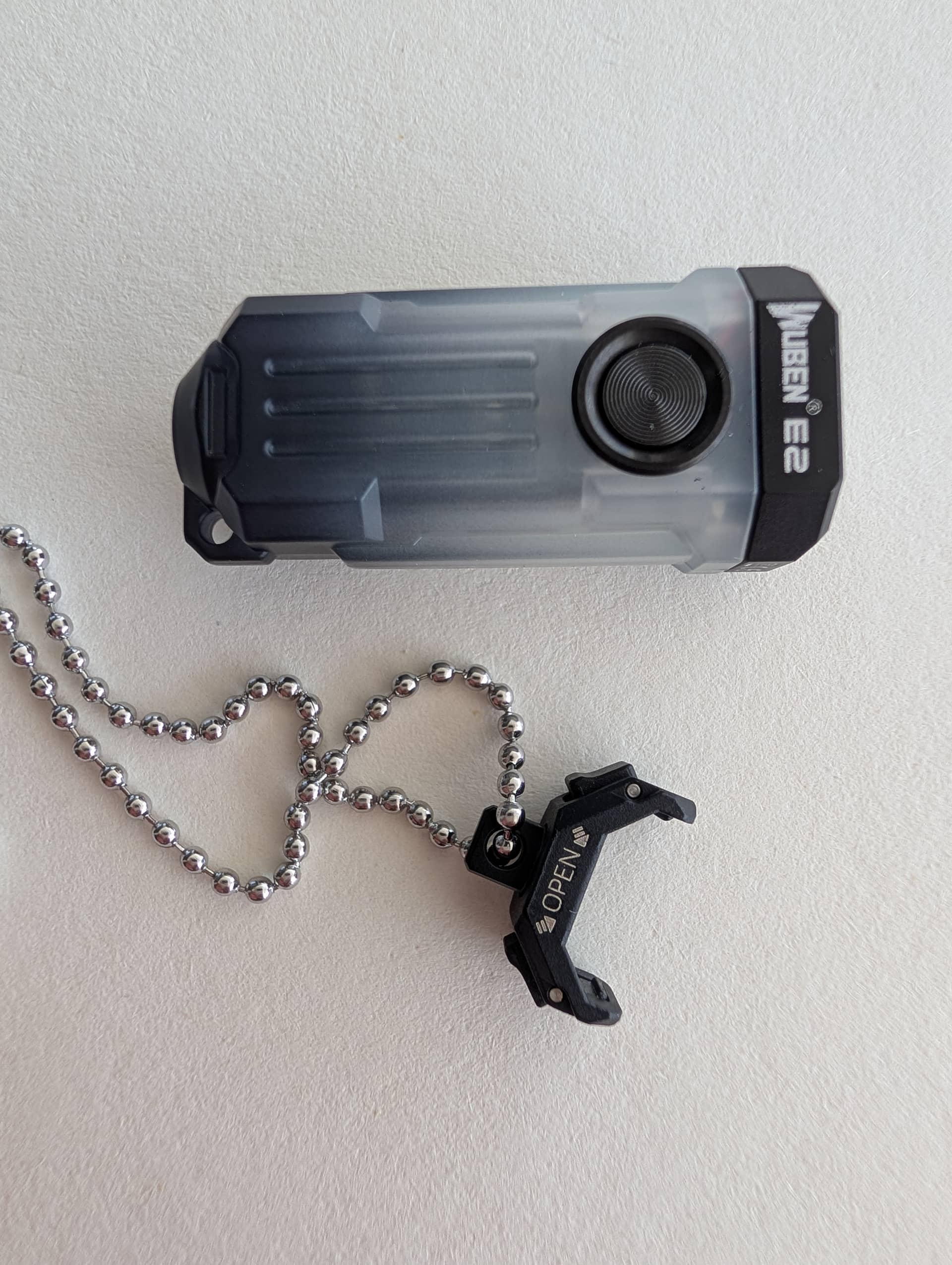

Wuben has made a necklace for this light with a holder that doesn’t just snap on but has two wings that you may press to release the light
And yes, it’s plenty strong enough…

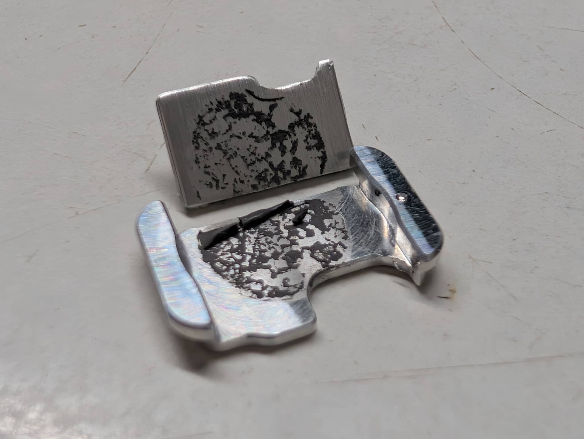

A little aluminum to dump some heat:
Props for using thermal paste!

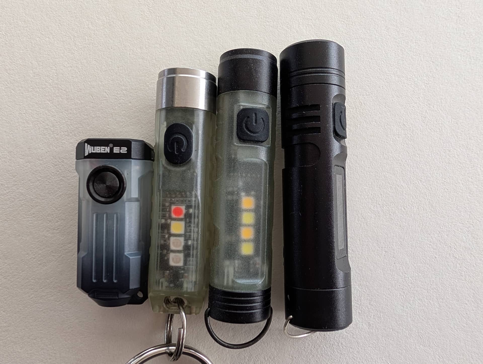

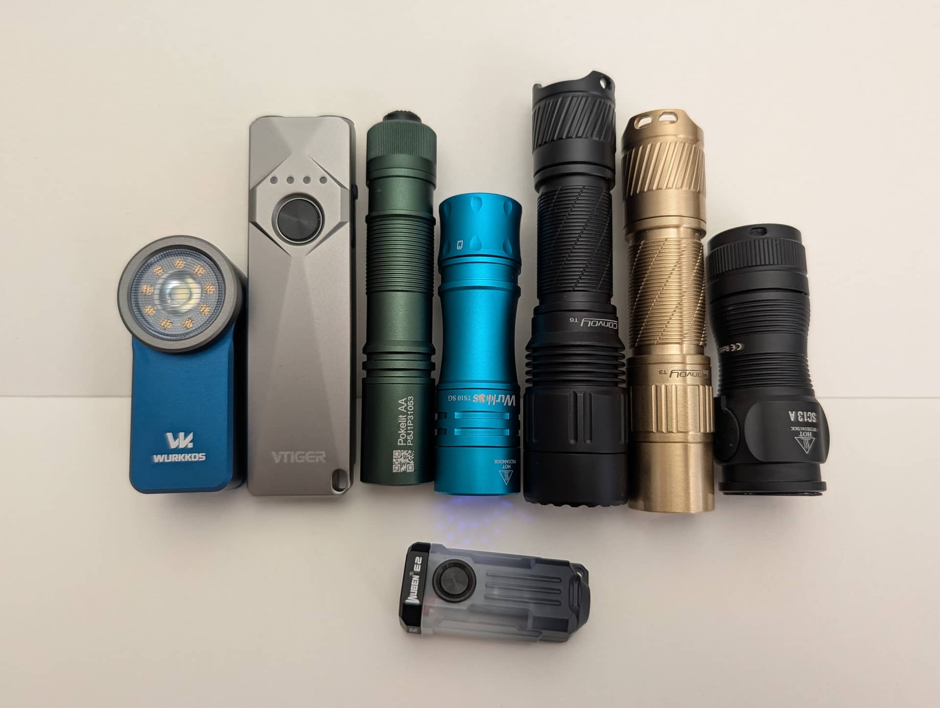

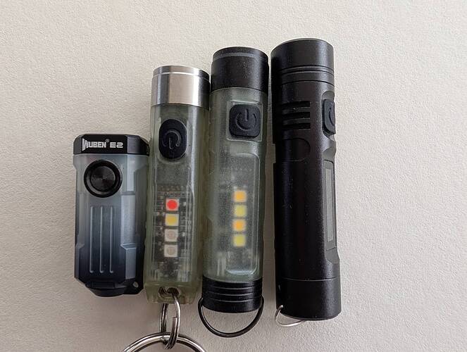

It’s really not in the same weight-class with these lights, because all of them are much bigger, heavier and brighter, but I thought it’s good for a size comparison with lights that many of us have.
With some other keychain lights including the one I Use so far (second from left).

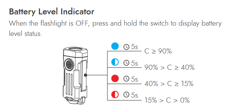

Something that I really like, it has a battery indicator:

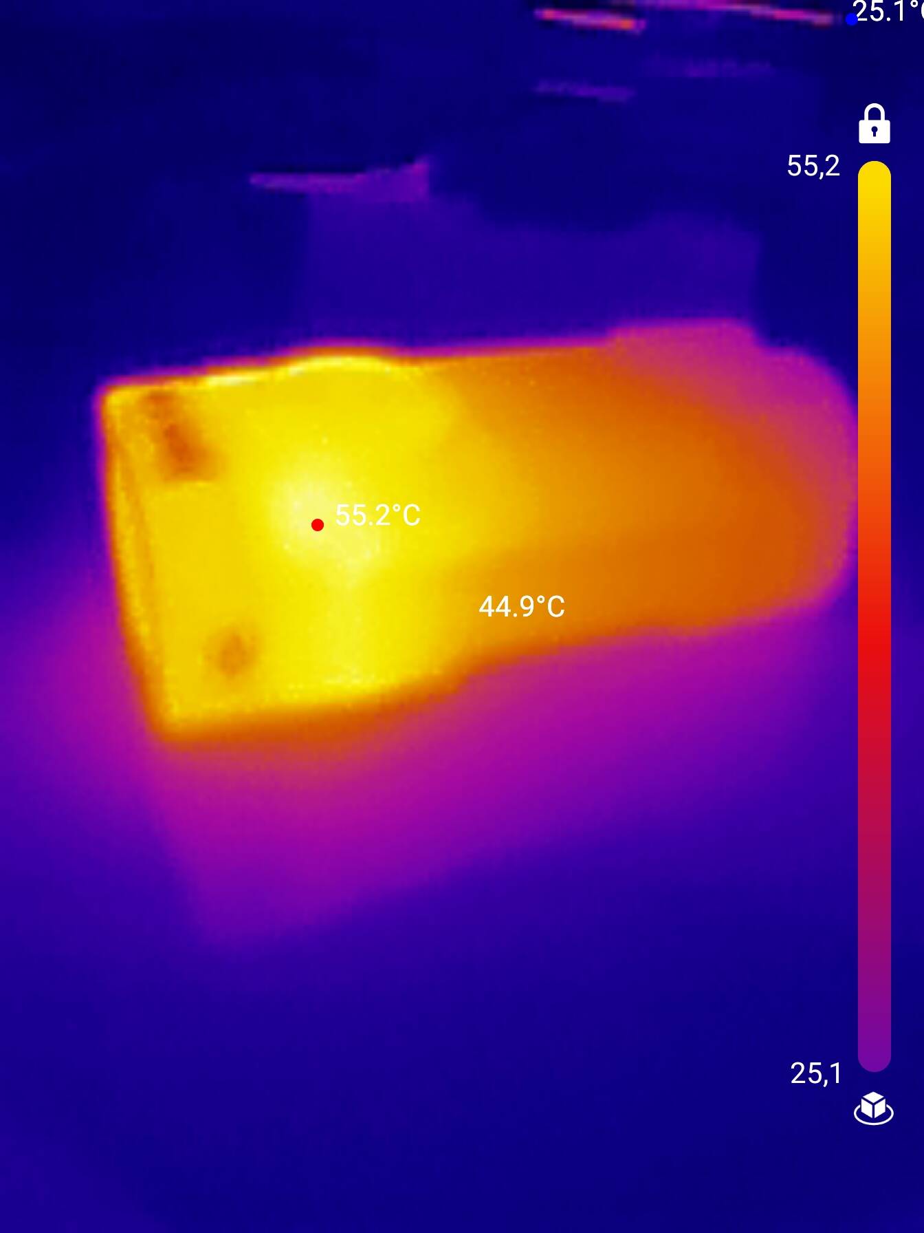

Thermals:
It does get toasty, but since this light has basically zero thermal capacity, you don’t burn your skin with it.

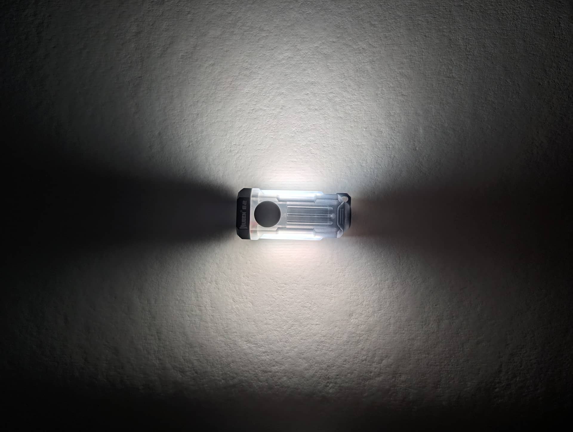

White side light:

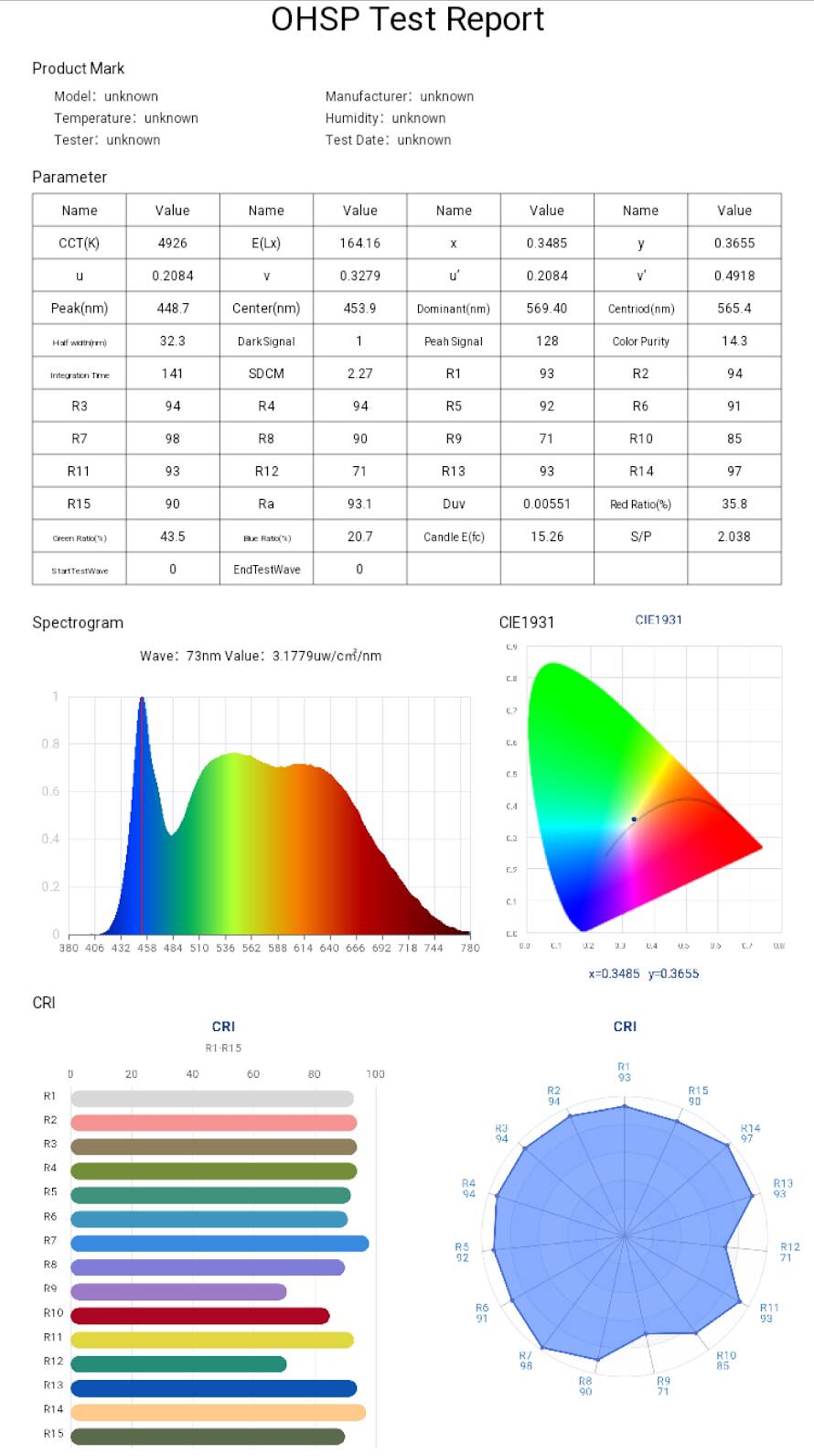

So, the front-LED isn’t something to write home about, but who cares about CRI in a keychain light?
Well, I do.
So I put in a SFT25R 5700K High CRI in one and will put a 519A 5700K in the other.

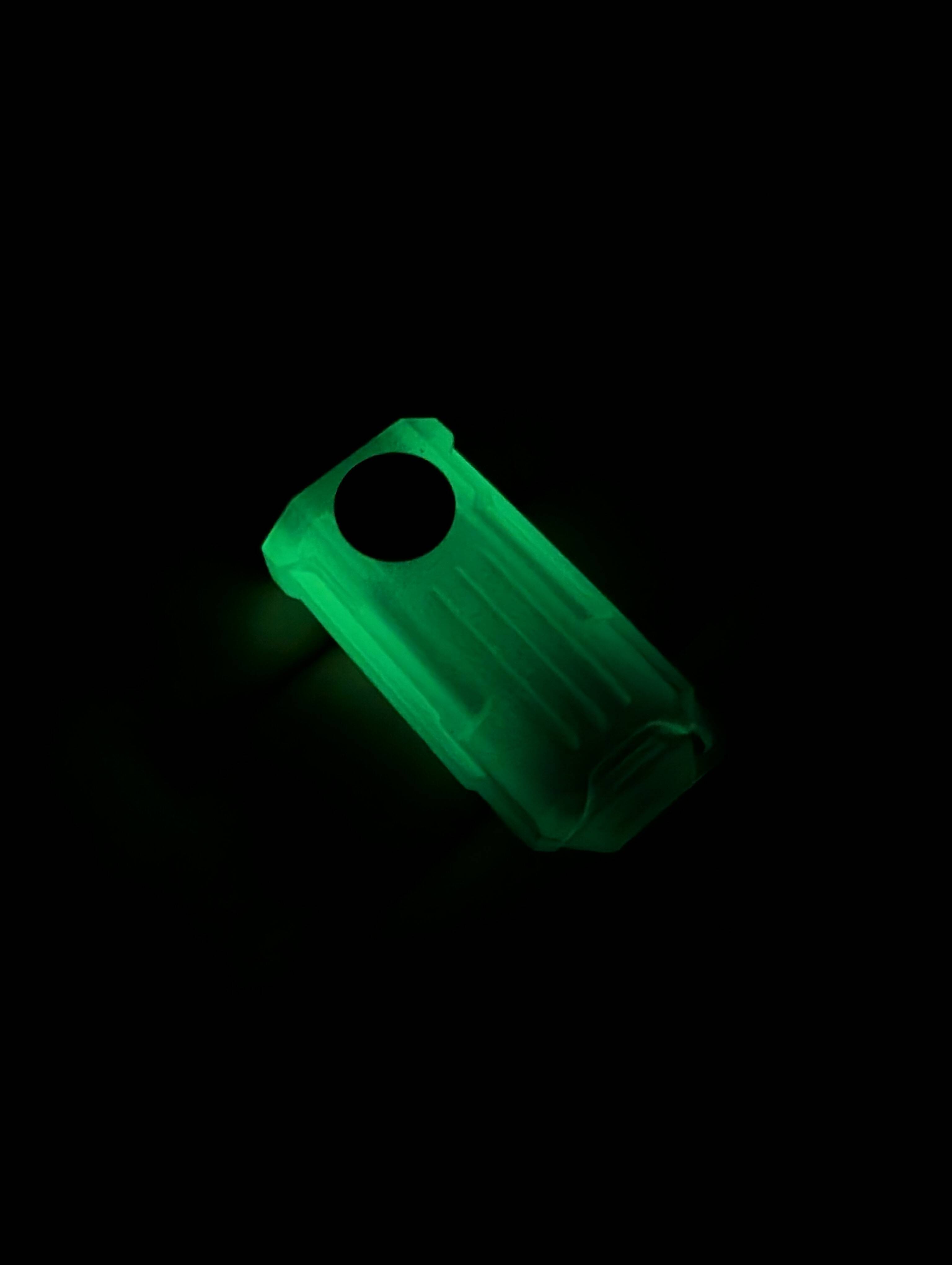

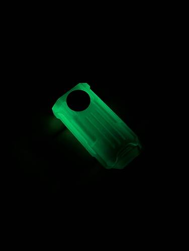

  • GITD case

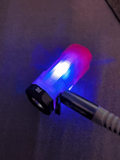

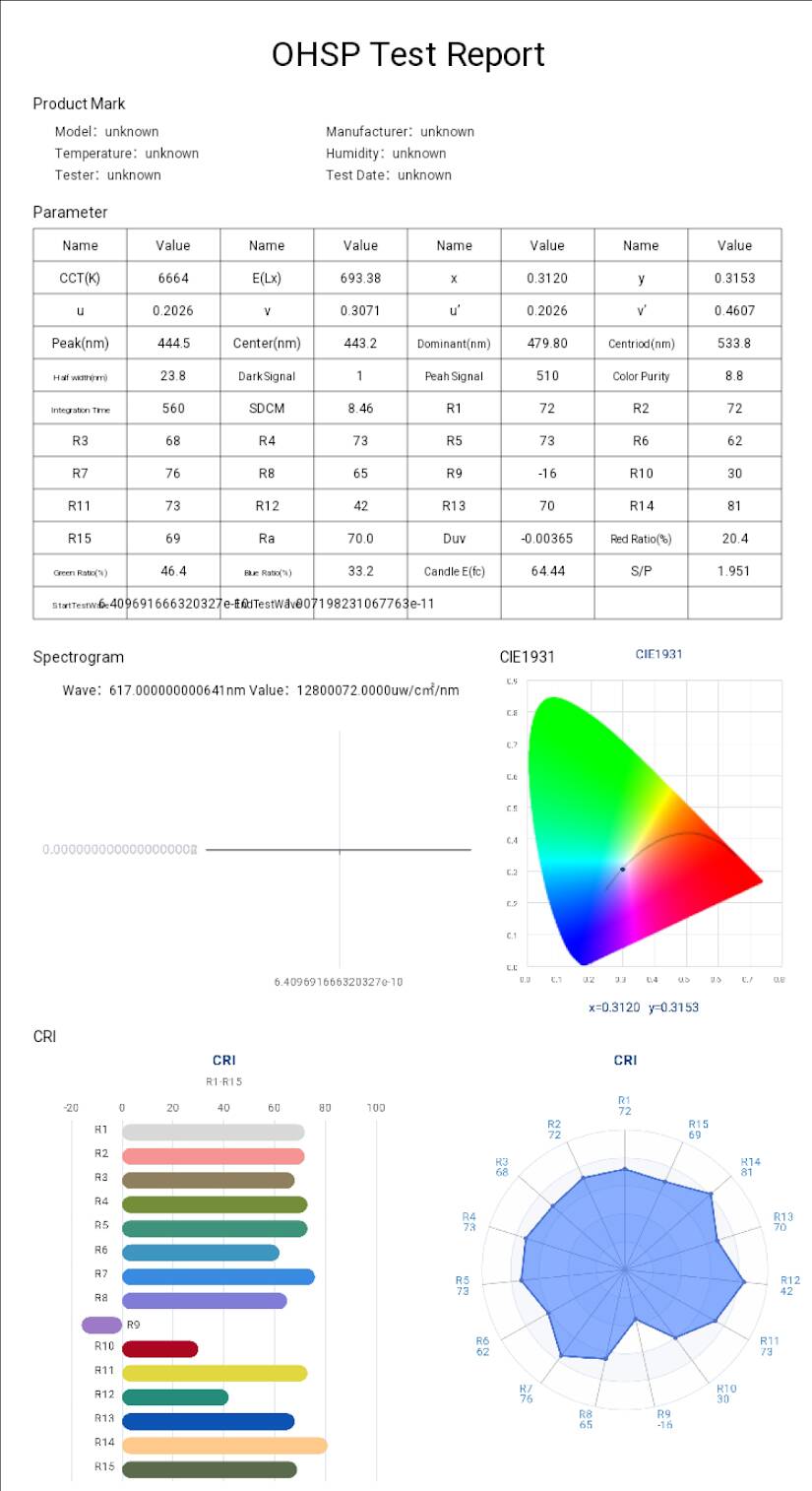

And maybe this: While charging, one of the lights gave me a light-show:
PXL_20260826_155537873.LS(1)
It did charge with no problems, but that was irritating. Usually the red light is on during charging and the blue one when it’s done.
I wasn’t able to duplicate this, though.
Nice review!

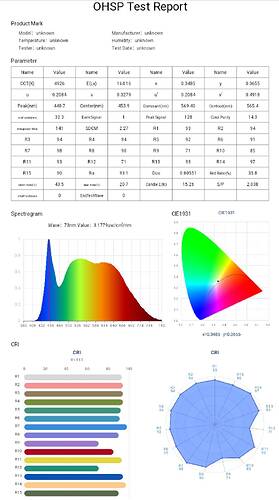

Somewhat tangentially, I believe the display on your spectrometer is a bit buggy. It looks like all the color bars (R1-R15) have been offset by 1–I noticed this because R12 means deep blue but is colored green instead.
Thanks for pointing that out!
It’s probably because I have to use an app that is a bit wonky, because you are supposed to use some WeChat App instead, but I don’t want the chinese government checking on my phone…

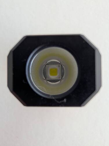

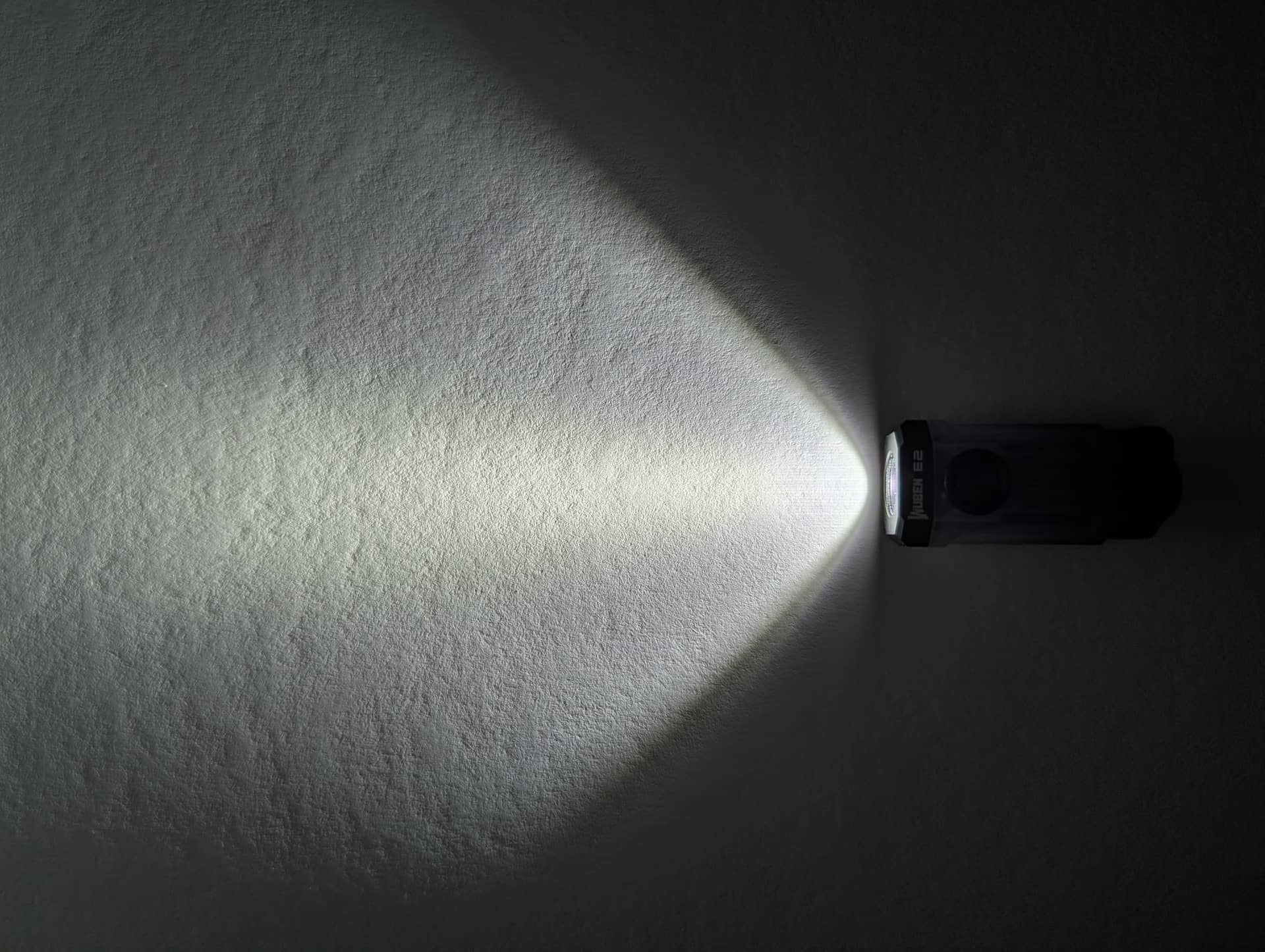

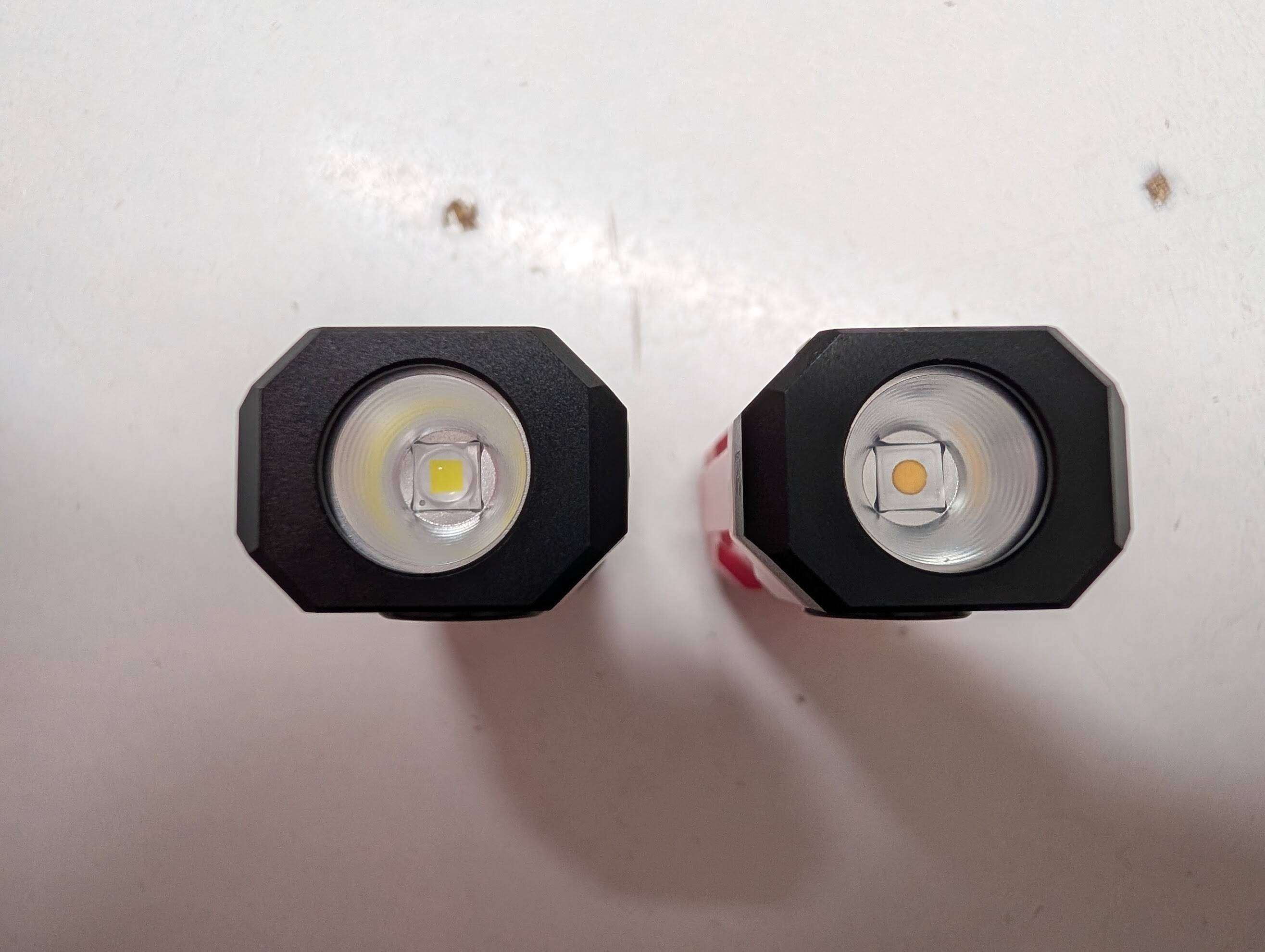

I changed the LEDs as said, SFT25R and 519A and the beams are both nice. You can see them if I make the picture smaller:
Left 519A, right SFT25R
The SFT one has noticably more throw, the 519A has a spot that is 3-4x as big.
Both LEDs perform very nicely in this light.

I would use the SFR-25R because the spot is a bit more defined and it throws a bit further, which is useful because the light isn’t super bright to begin with.
