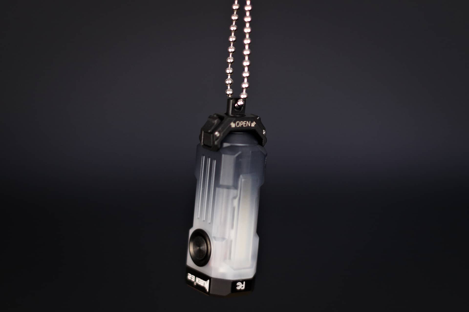

This is the Wuben E2 Pulse, a recently released necklace/keychain flashlight with 3 light modes, 120mAh LiPo battery, tail magnet, necklace accessory, glow in the dark main body and USB-C charging.
• My opinion
The E2 is a pretty convenient keychain flashlight, very light and pretty small flashlight with 150 Lumens max on the main cool white beam and 80 Lumens on the side warm light, the battery has a kind of small capacity, but OK for the tiny size of this flashlight. The warm side lights are pretty good with around 92 CRI!
I didn’t like the main LED choice, it’s not bad as far as I know, but I would prefer a 5000K as advertised, not the 6000K it came with. The USB-C port is tight to connect with most USB-C cables I have, as the cover gets in the way. The battery not being replaceable means that when the battery dies the entire light will die together. I tested PWM on every mode of the flashlight, not on the “High risk” side of the Opple LM4, but still PWM that can be unpleasant for those who are sensitive to it.

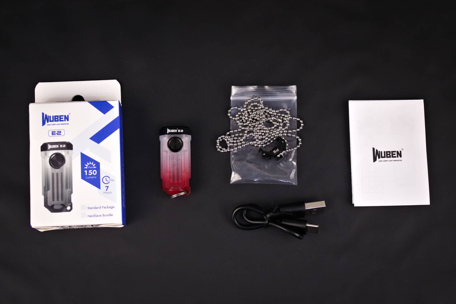

• Box contents
- E2
- P5 Quick release connector
- Metal ball chain
- USB-C cable
- Keychain ring
- User manual

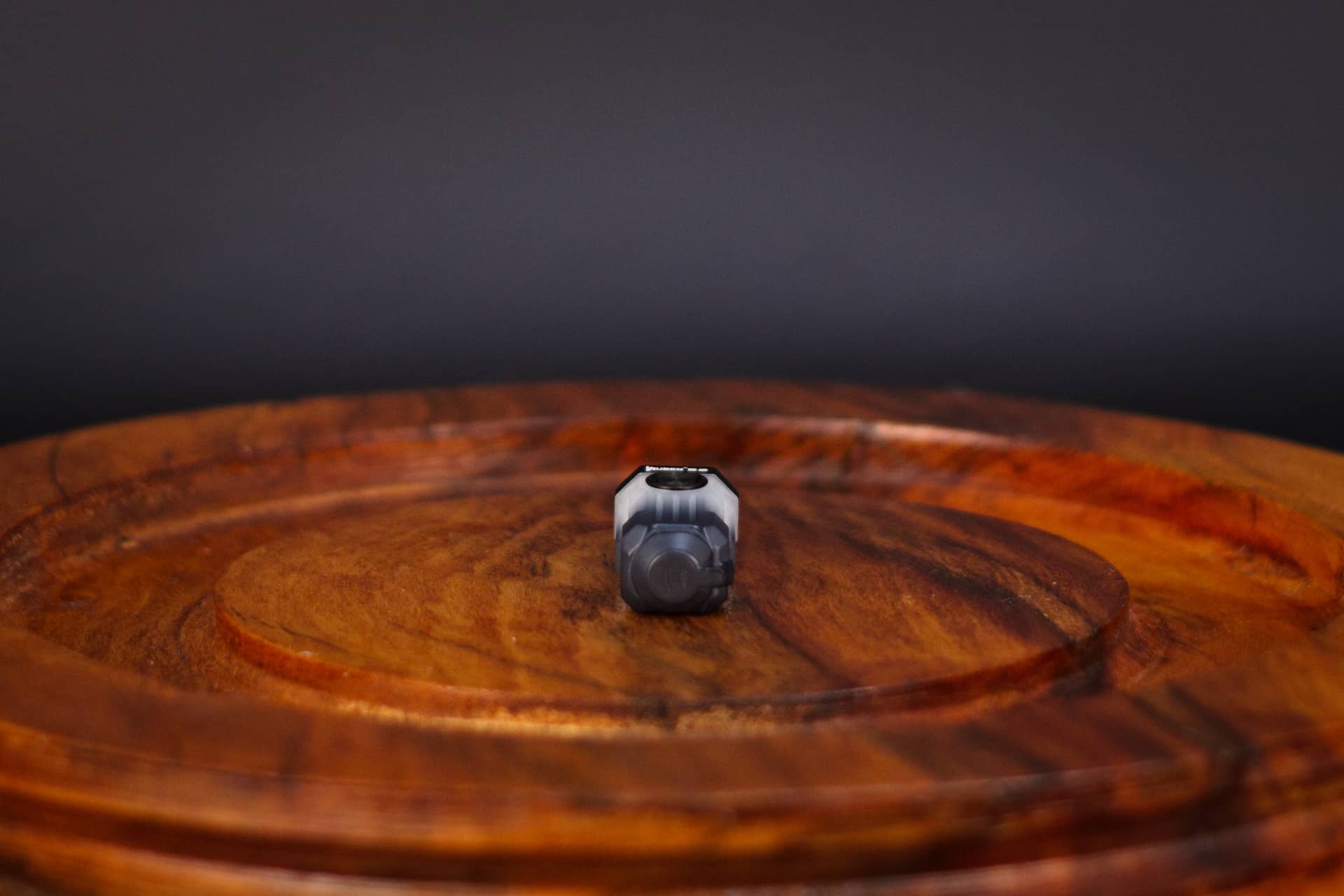

• Body and build quality

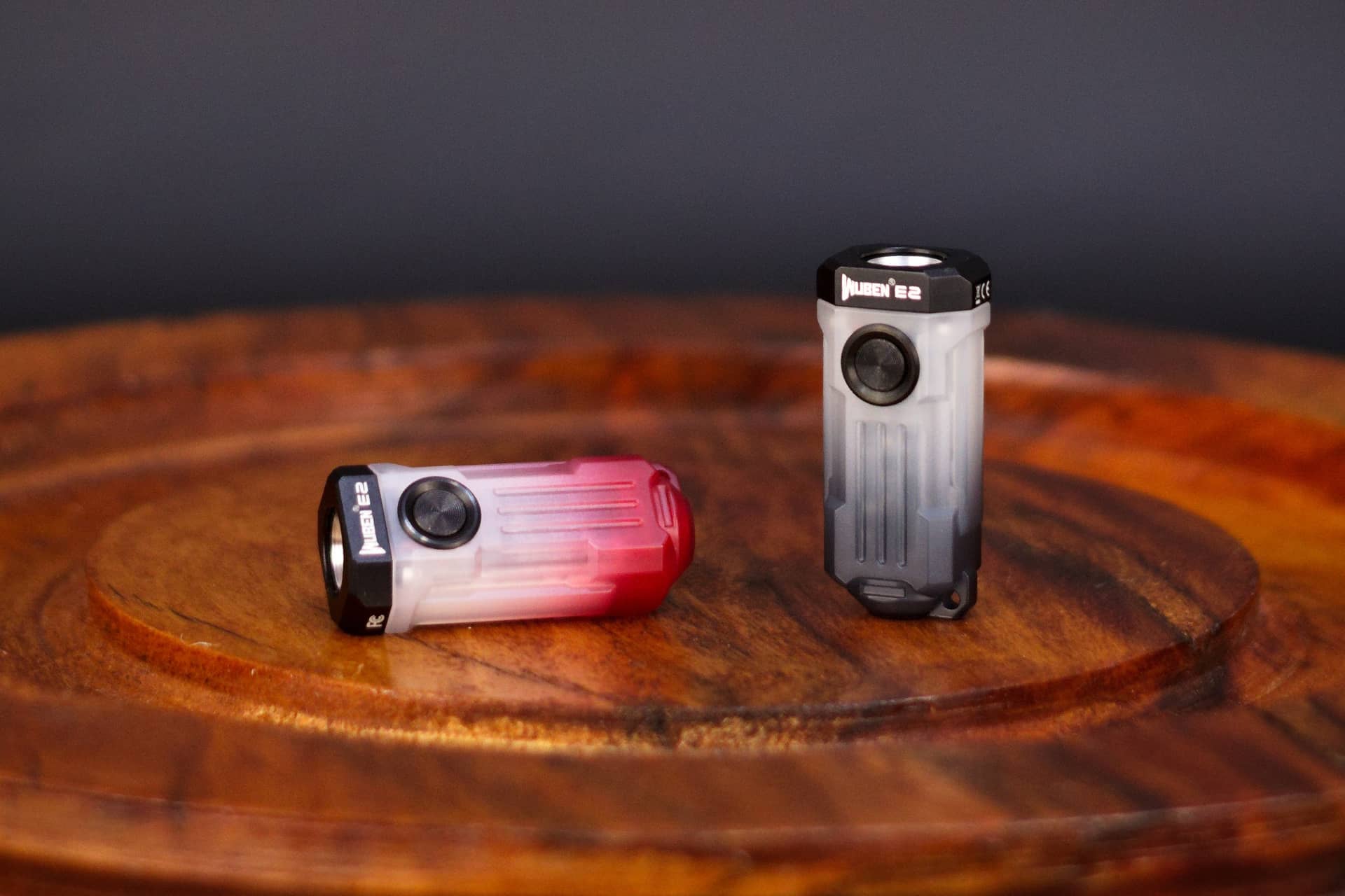

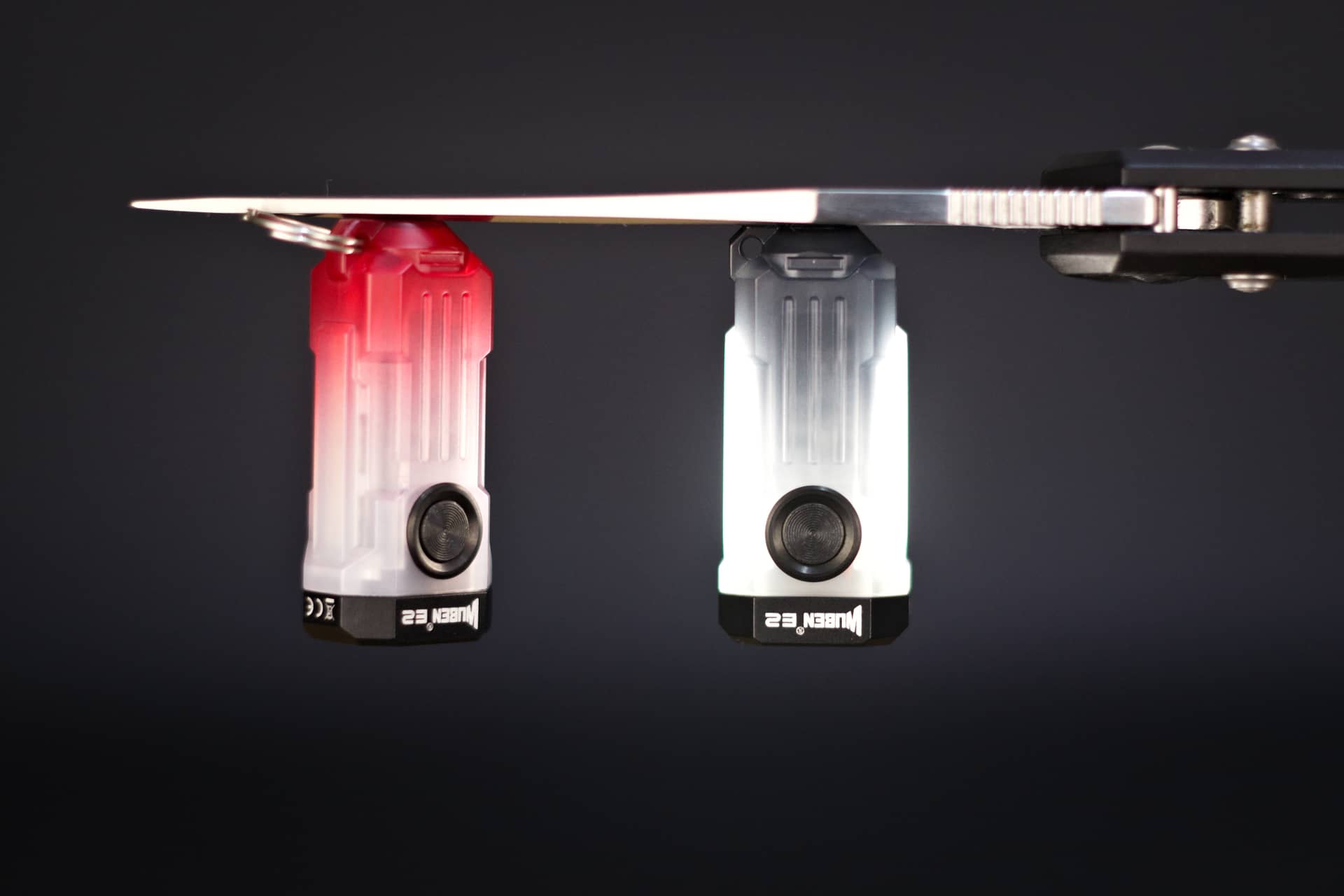

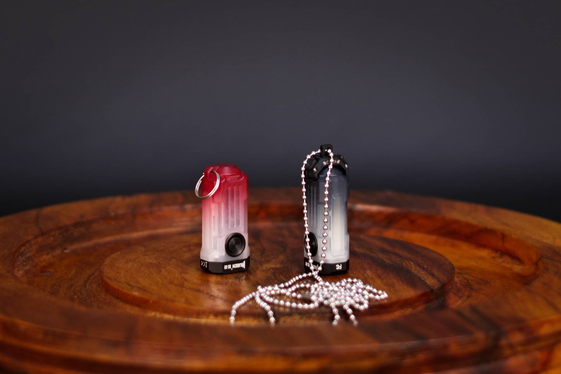

Anodizing Colors/Material Options: The E2 is currently only available in PP plastic with 2 colors: Black Translucent and Red translucent. A cool fact is that there was an E2 prototype made of Ultem, a super resistant and durable thermoplastic, the reason why it wasn’t used was the color availability.

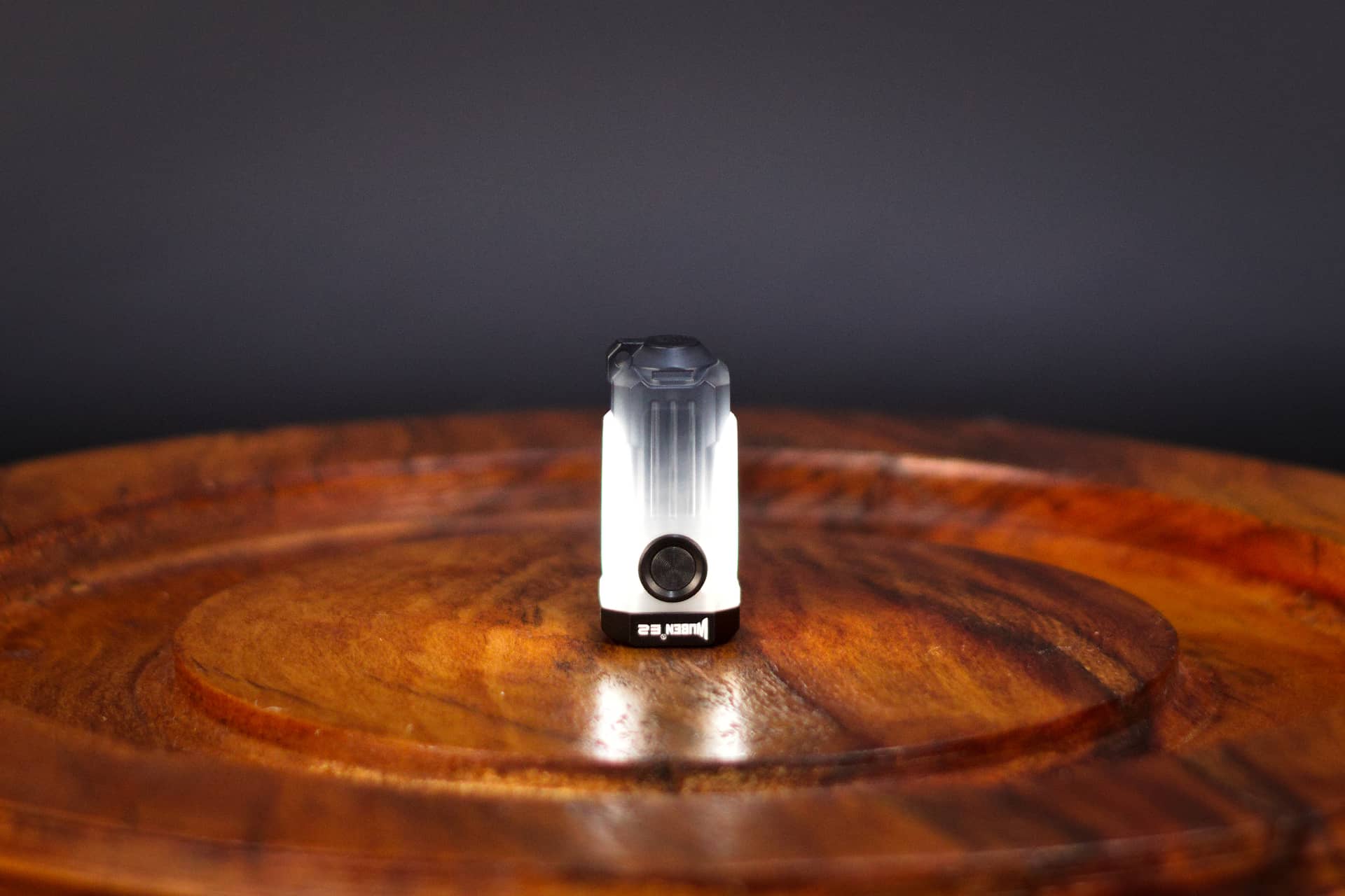

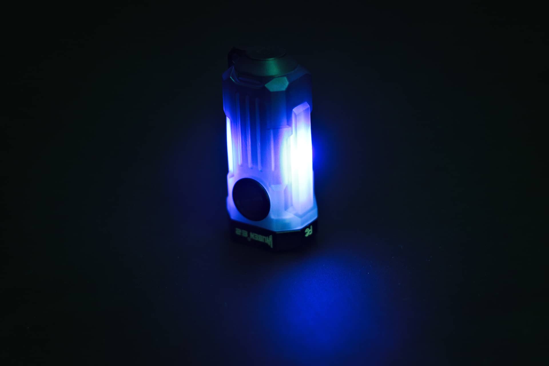

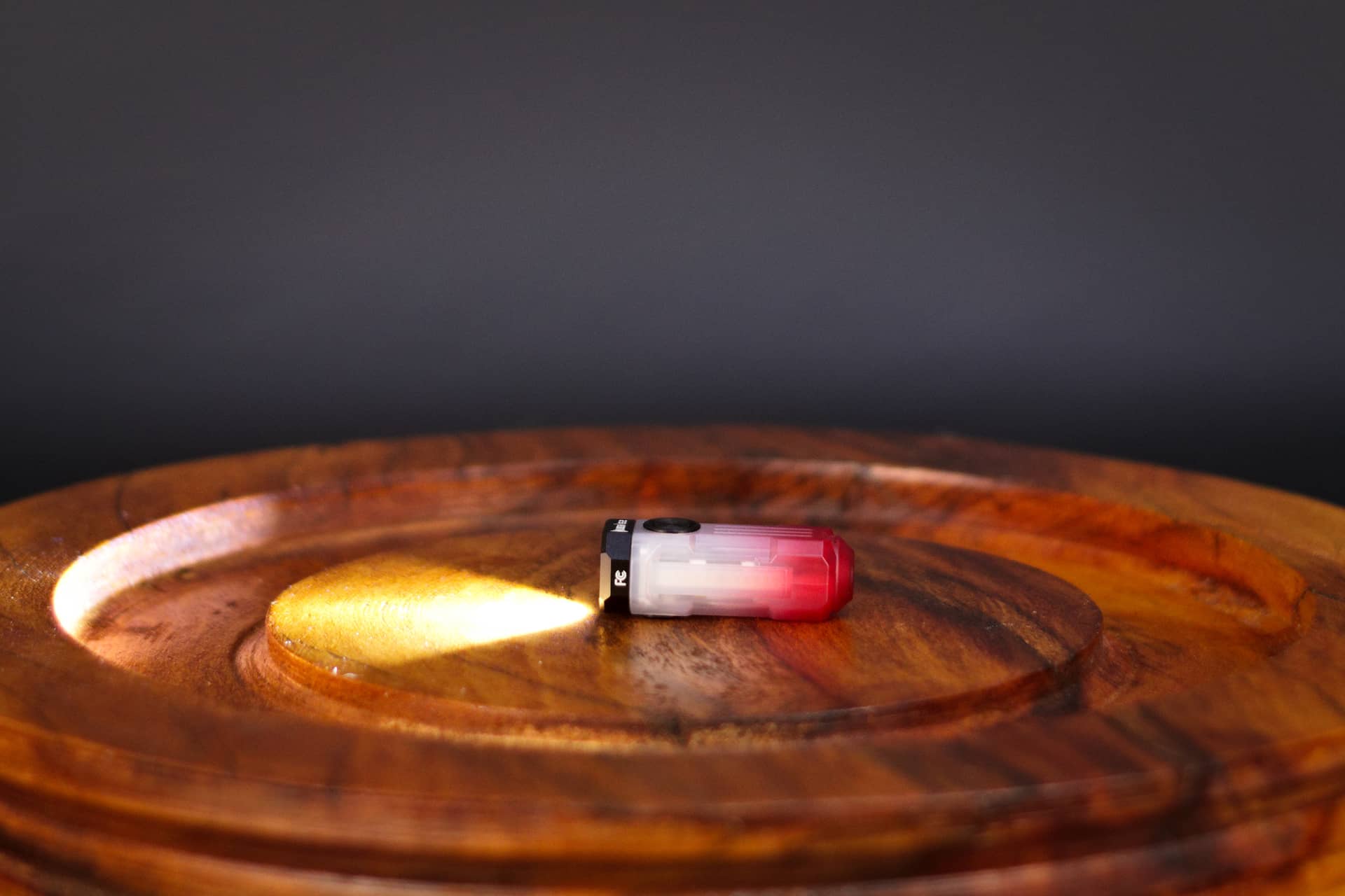

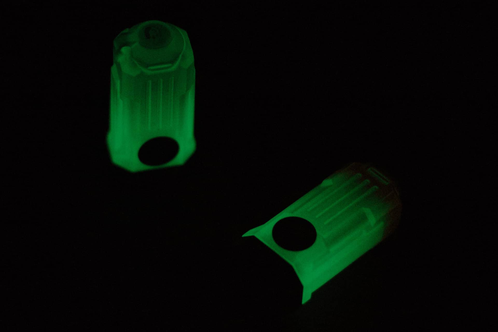

Main body/Grip: The flashlight is pretty compact and great for carrying on a keychain. The main body has grooves to improve grip, but it’s a little slippery when it’s wet. The main body Glows in the dark when exposed to light previously. The glow is not much strong, especially after some minutes, but if the side lights are used to charge the glow on the body, it will glow for some minutes and help find it in the dark. It will glow very faintly after some hours and can be visible if the ambient is very dark.
Material: The main body is entirely made of PP plastic, the bezel is made of matte black anodized 6061 Aluminum alloy, the main button is made of 304 Stainless steel.
Threads: The flashlight has no threads.
P5 Necklace and metal chain: A package including the P5 quick release connector and a metal ball necklace is available to buy and is featured on this review.
Tail stand and rolling: The flashlight doesn’t roll, as it has a rectangular body shape. The flashlight can head/tail stand with stability.
Magnet: A small N52 magnet - the strongest type of neodymium magnet usually used on flashlights - is present on the tail cap for easy snaps on metal surfaces. The magnet is not the strongest, but as the flashlight is pretty small and light it will grip into almost any metal surface with ease.

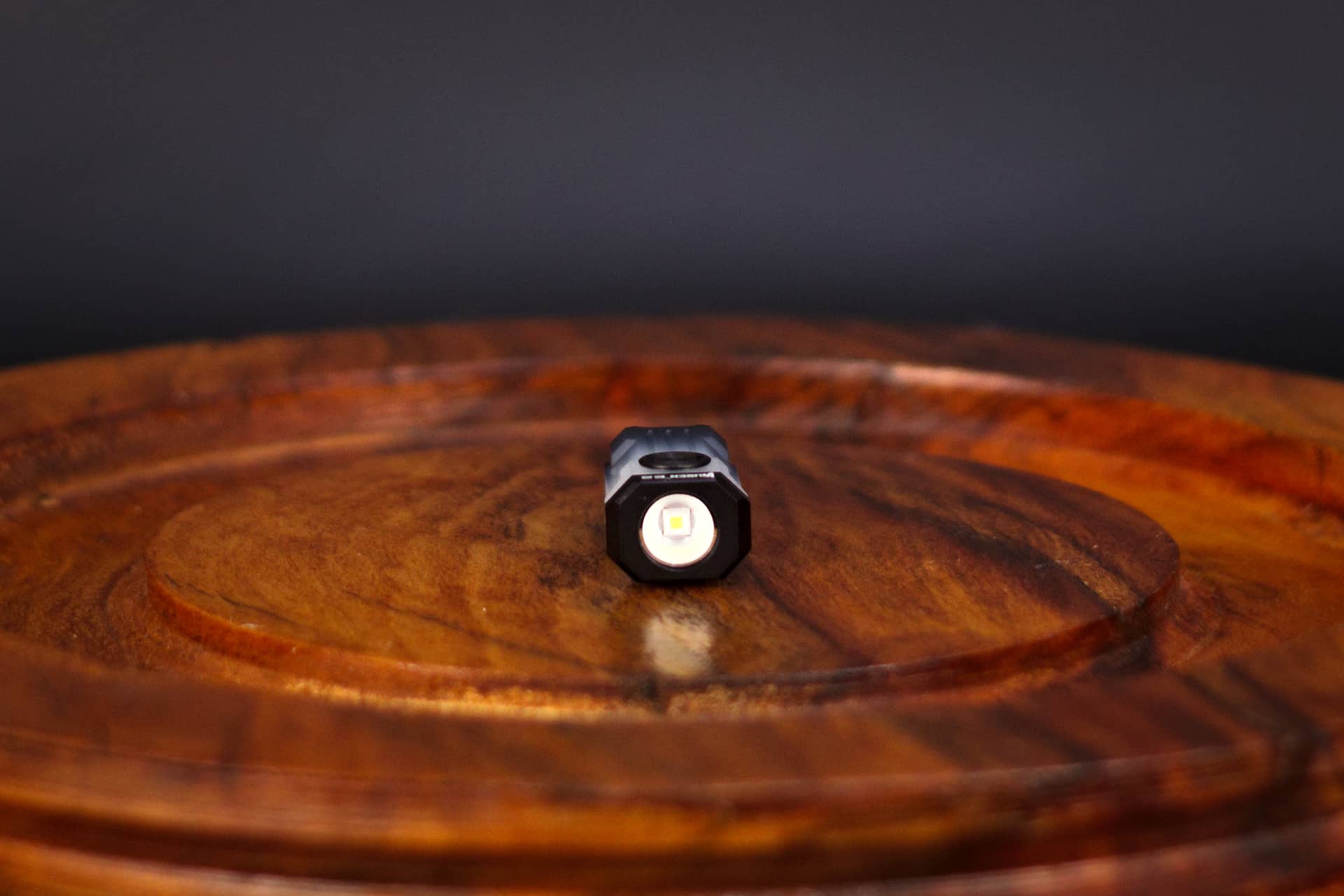

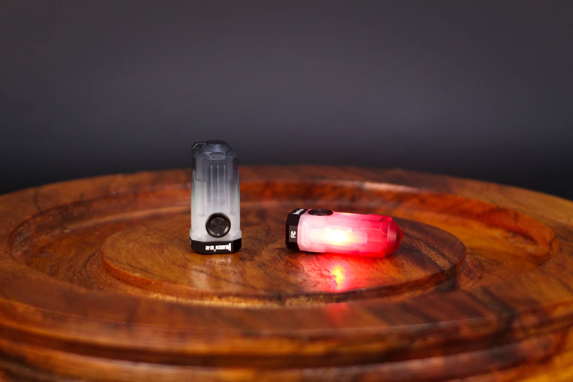

AUX lights: It feature, aside from the main cool white beam, side lights in neutral white, red and blue flashing modes and a 2 color battery indicator. No RGB Anduril-like AUX.
Buttons: The E2 features a single e-switch on the main body, it’s covered by black coated metal button with a slightly raised ring around it to prevent accidentsl activations. The button has a good click and doesn’t make any loud sound

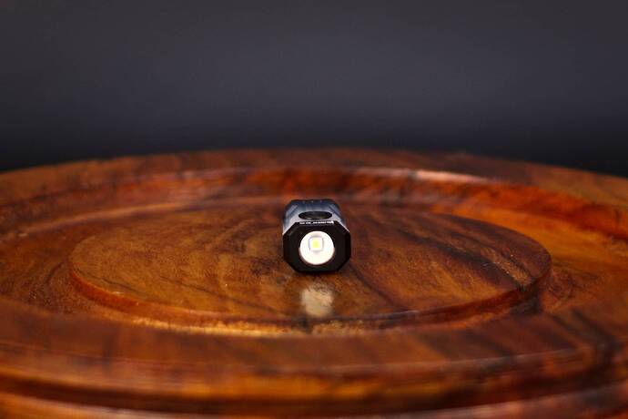

Bezel: The bezel is standard EDC smooth shape, with no crenelation.

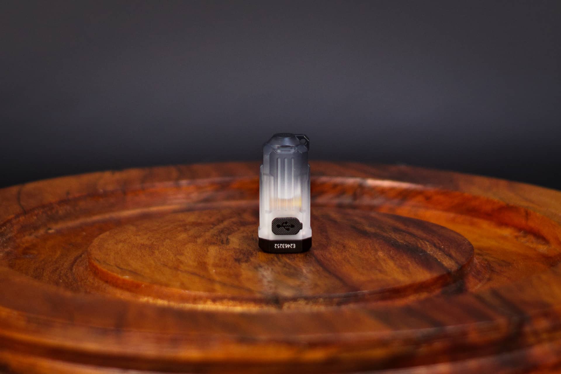

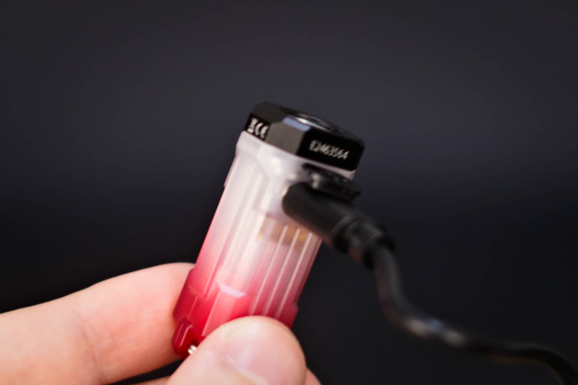

Water Resistance: The E2 has IP66 ingress rating, which means it has protection against pressured water jets, but can’t be submerged. The USB-C cover has a hard plastic outside, but the inside is made of rubber to protect the USB against water, but the cover is a little stiff and short that it makes hard to connect the USB-C cable on there most of the times.

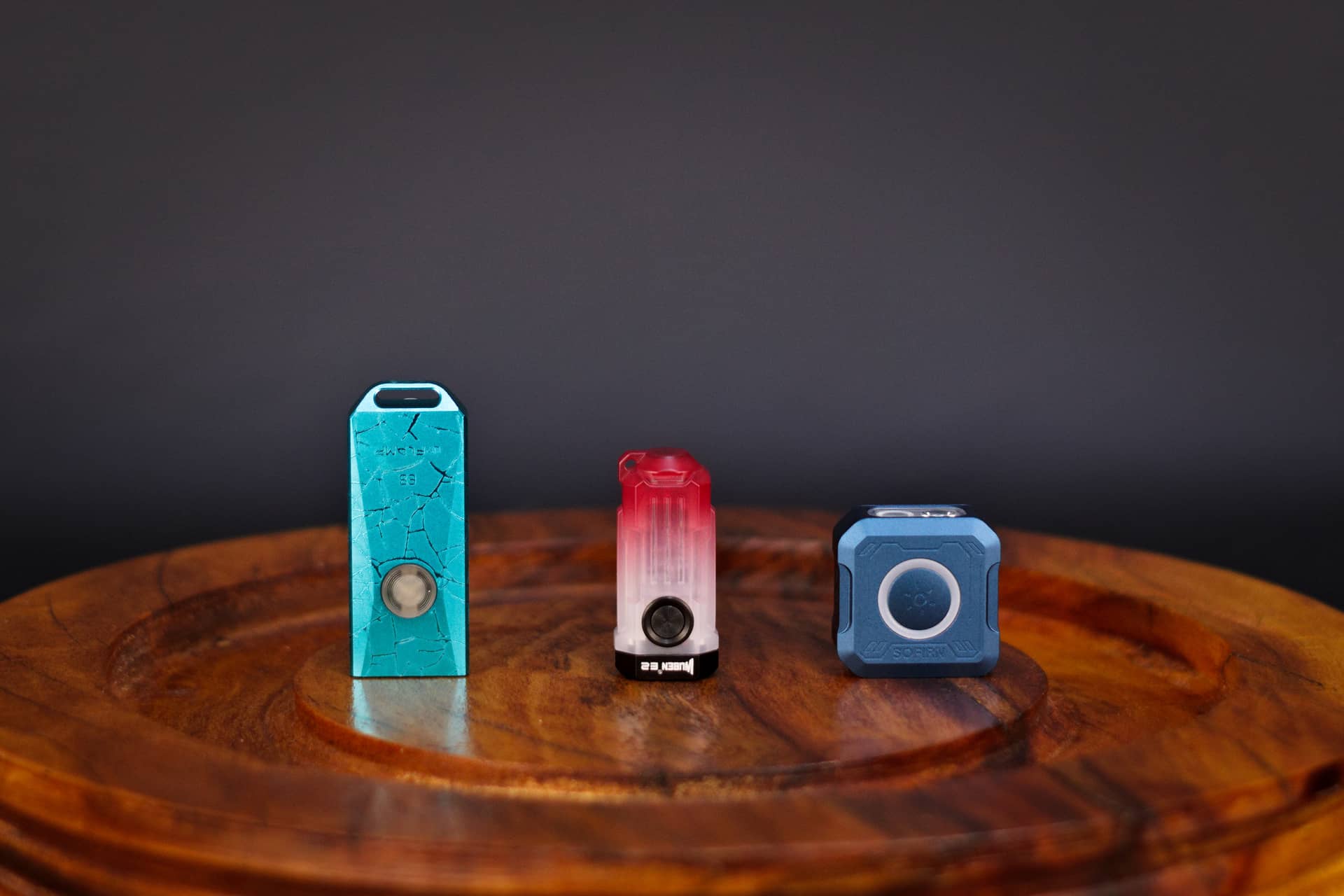

Size comparison: On the left is the UrFlamp E8, on the center the Wuben E2 and on the right the Sofirn SE1.

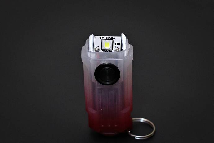

Battery: It uses a 120mAh Li-ion battery inside the main body, the battery is not user removable easily.

Charging: A USB-C port is present at the main body on the opposite side of the main button, it’s covered by a rubber/plastic part, this cover makes inserting a USB-C cable a little hard though as it stays to close to the USB-C port. The input is 5V 0.1A, taking around 1h30min for a complete charge.

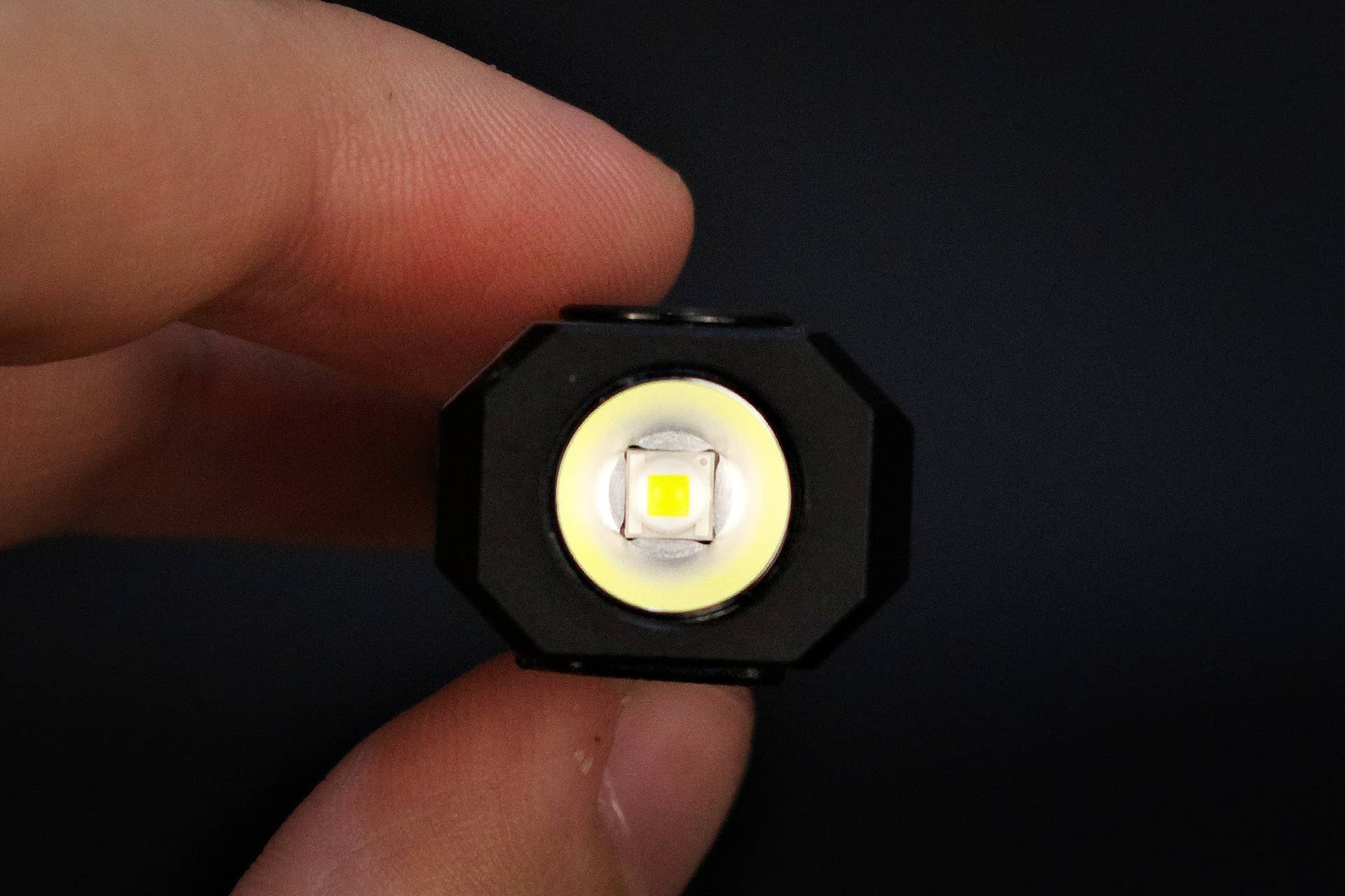

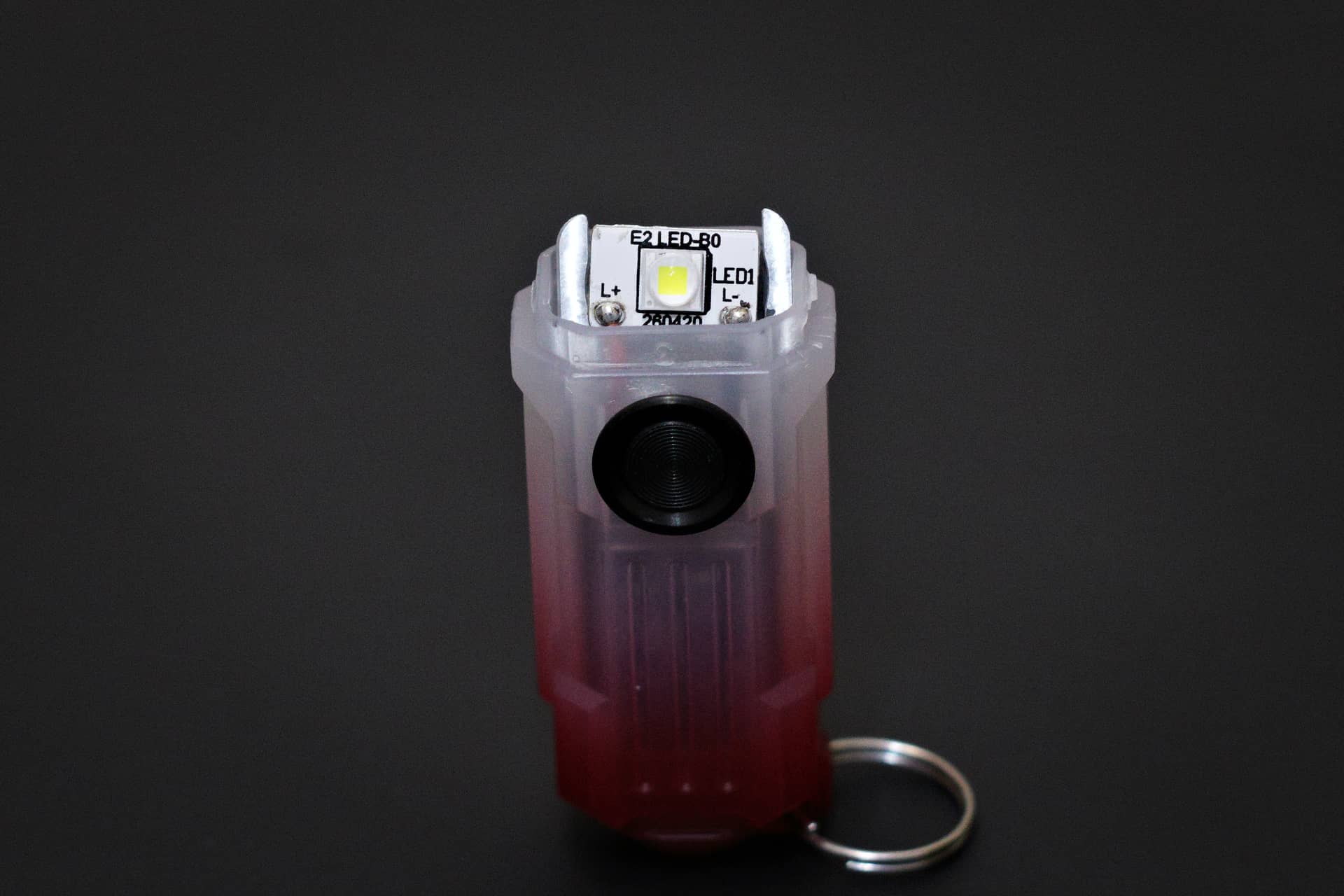

Emitter: The main emitter is said to be a W3535 5000K LED, but my readings showed that it was actually around 6000K-6500K, I will be honest, I didn’t like the main LED at all, but the side LEDs are pretty good, the side LEDs are custom warm white High CRI emitters, they have a pretty good tint and CRI.
Lens: It has an AR (anti reflexive) coated glass lens in front of the reflector.
Reflector/TIR: The reflector is pretty small, as expected on a keychain flashlight, it’s a reflector similar to an orange peel, but with lines on the reflective surface.

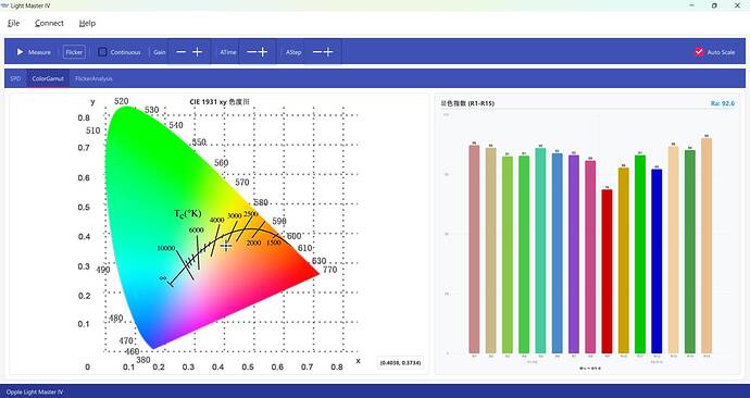

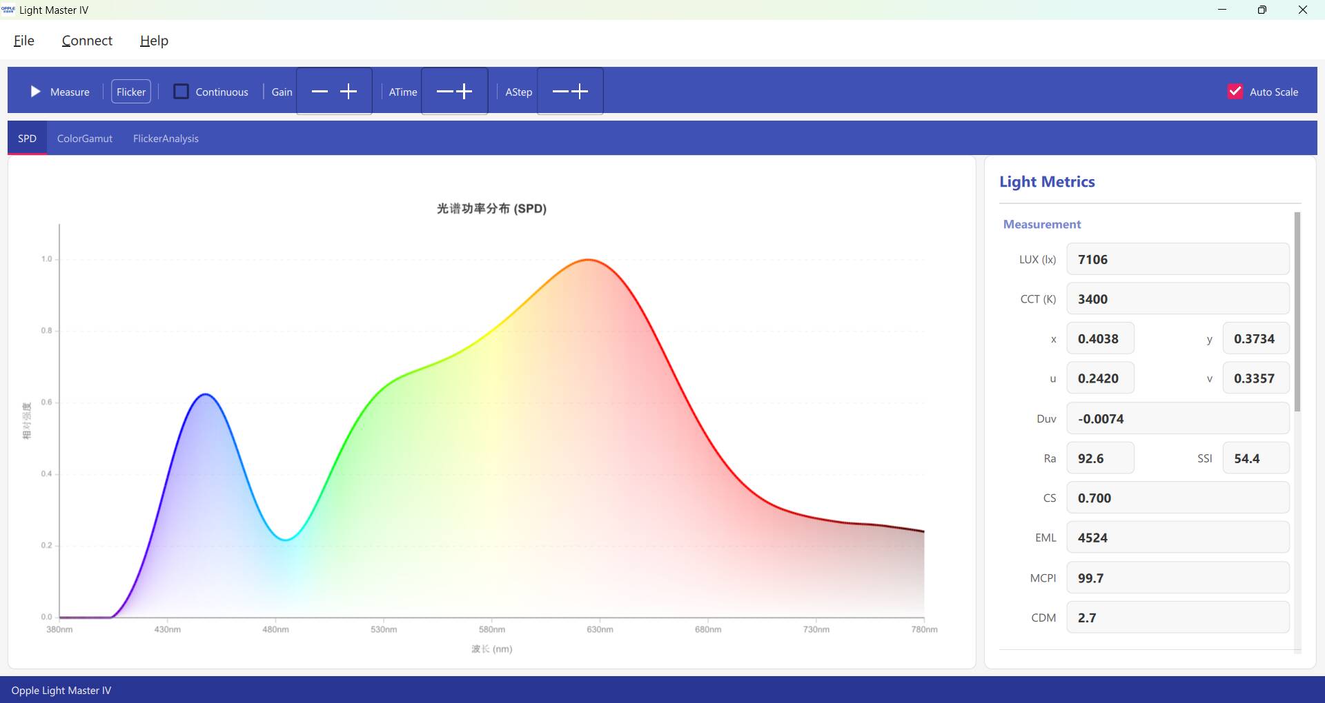

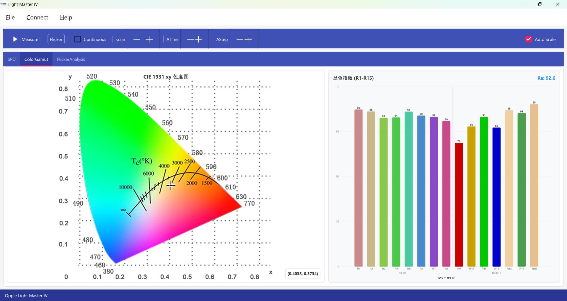

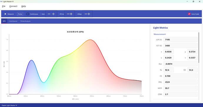

CRI/CCT/Duv: The side LEDs CRI is amazing, I measured 92 CRI on it - aside from the big cyan wavelength gap; with around -0.0078 Duv.
(Side warm white light Opple LM4 readings)**
The white main light has standard CRI, around 70 CRI, with a visible blue tint.
*Opple Lightmaster 4 was used to get these readings, it’s not a professional spectrometer, so use this readings as a reference only. This test was performed in a dark environment without any light sources besides the tested LED.
