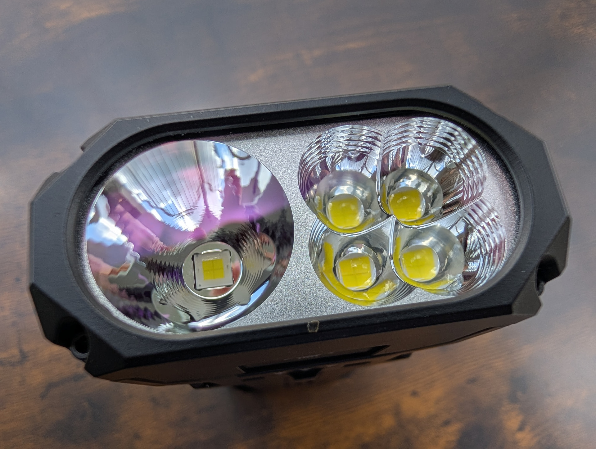

On paper, this light seems to be perfect for me. Somewhat big, bright and very floody. But is it as fitting as it seems?

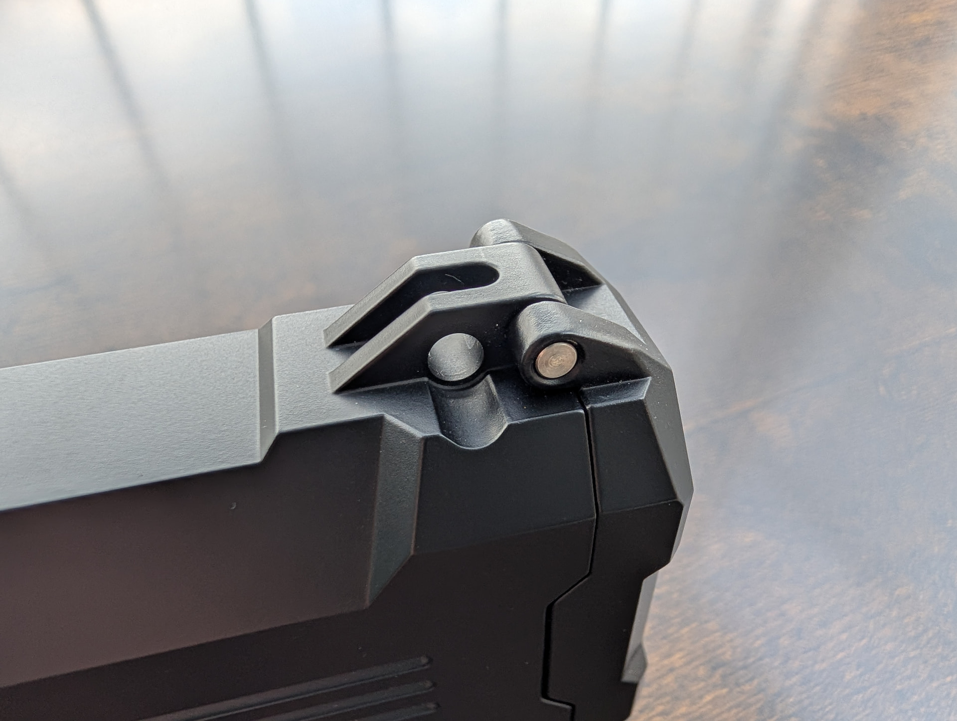

THe pin for the battery hatch is more than enough for this job

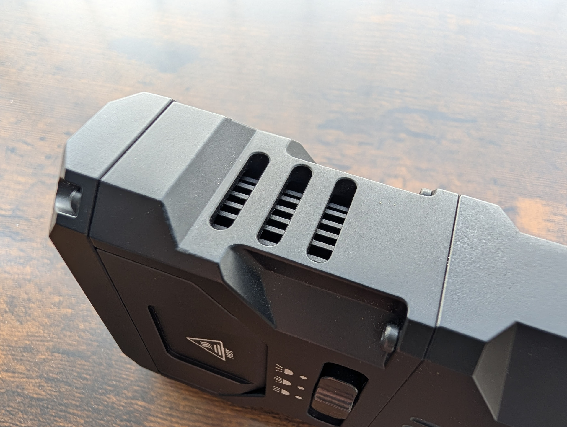

This side is. It’s easy to see that any fan would have a hard time sucking air through these small openings.

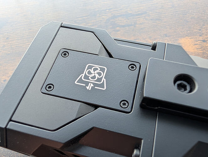

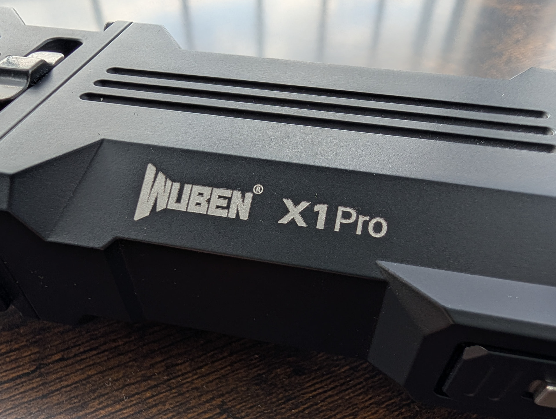

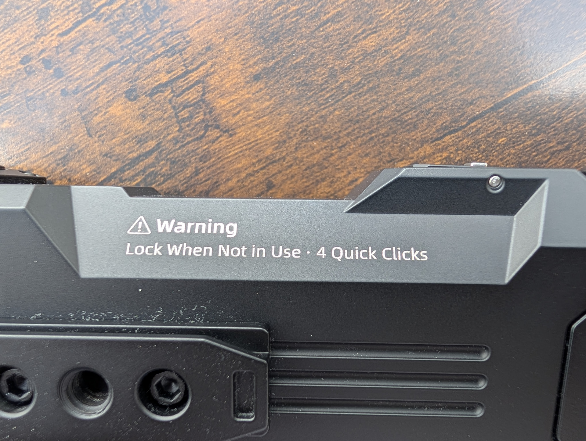

Nice to have an important information like this etched into the paint!

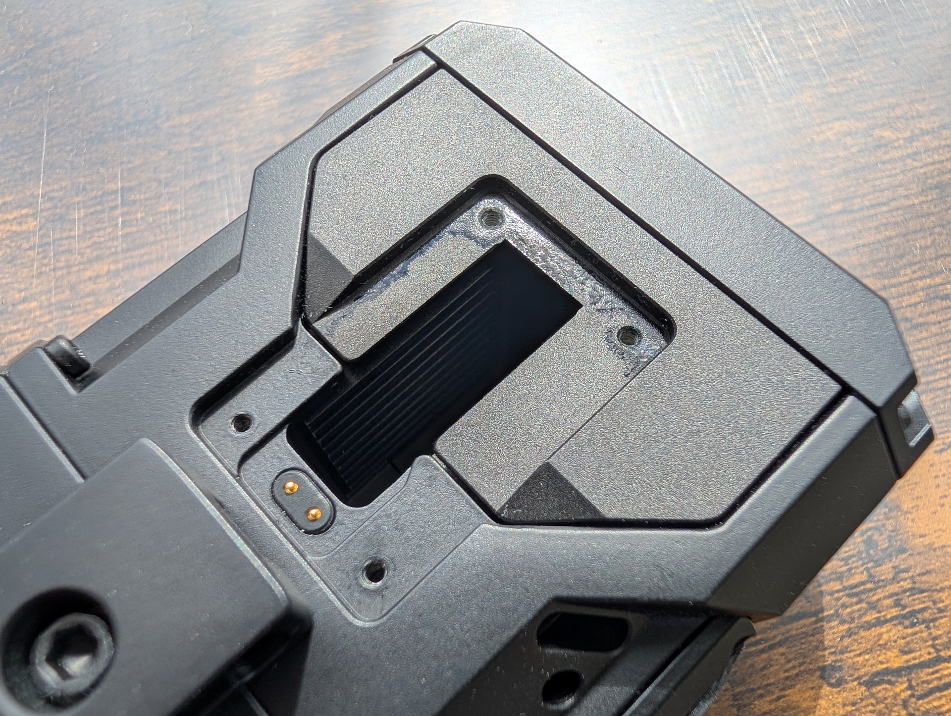

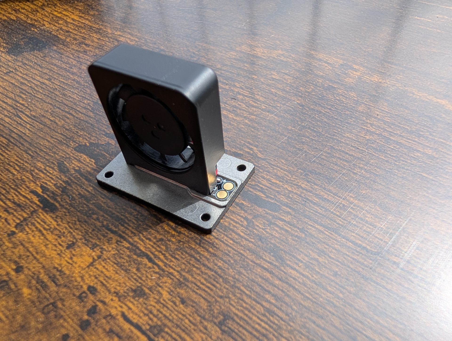

The apartment where the fan lives rent free

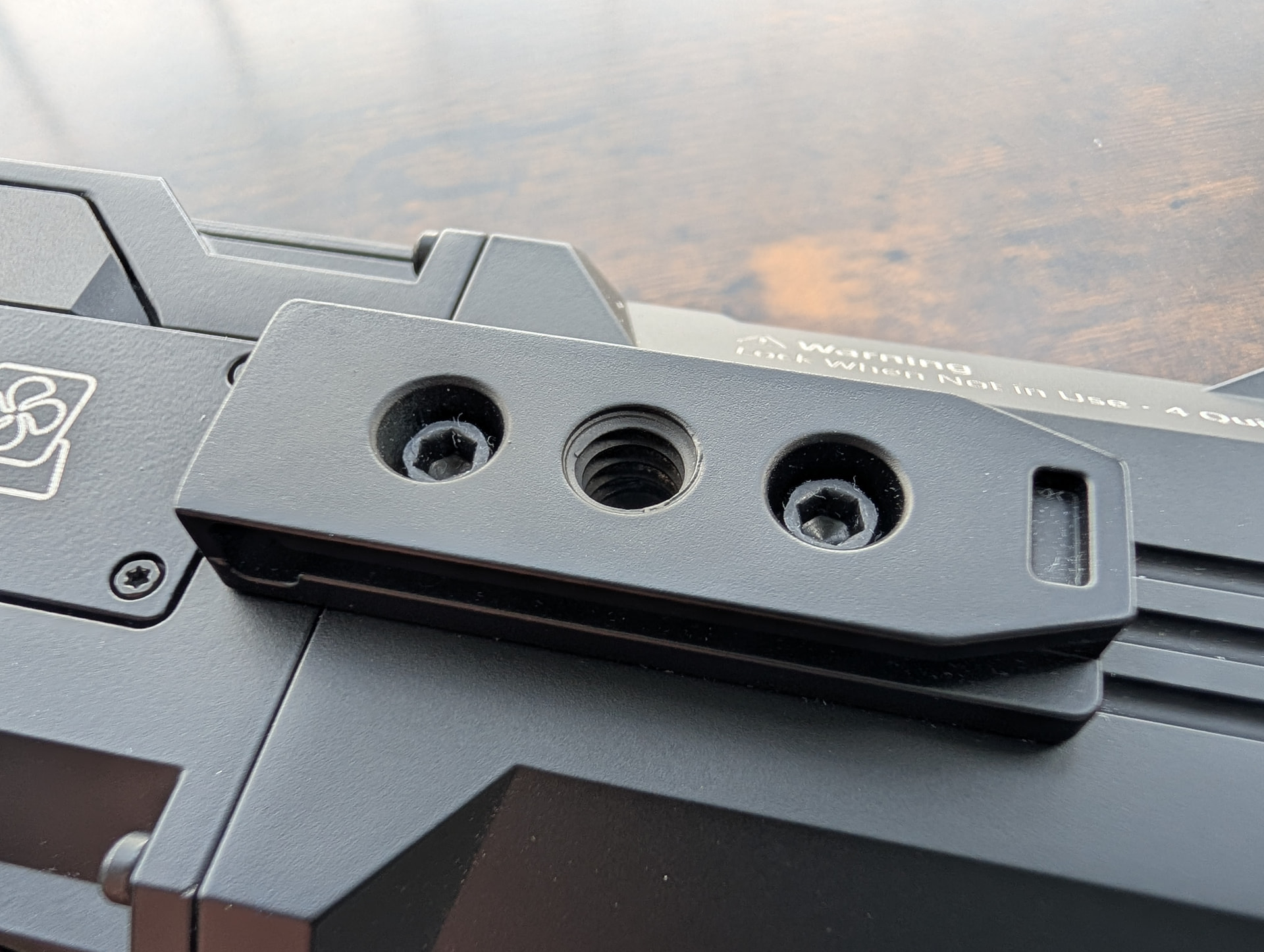

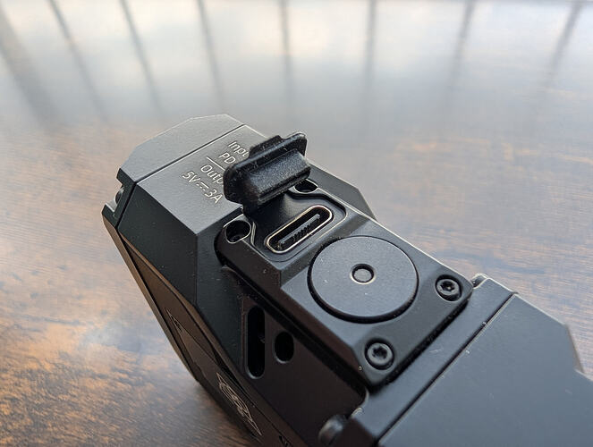

This extra attachement doesn’t come with the light normally. Wuben sent this to me and I am happy about it, because I like to have 1/4" ports on floody lights when you need to have them light up a room or campsite without me having to handle it. It is also used to attach the light to a handlebar.

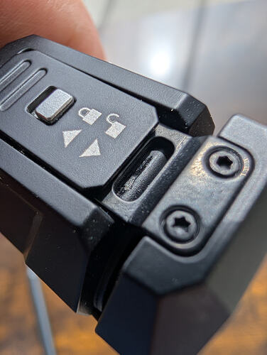

The USB port has a good and tigh cap

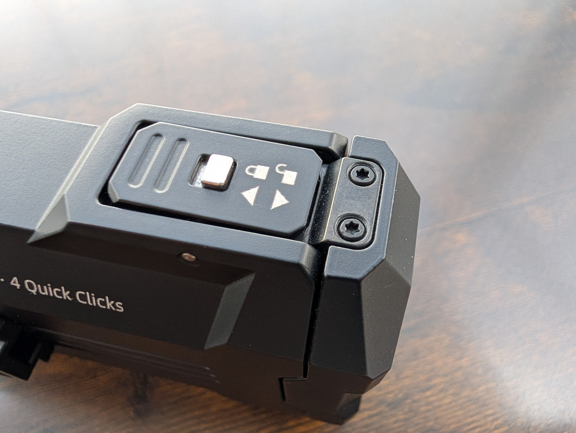

The lock for the battery compartment. This wasn’t working fully at the beginning, the little silvery piece wasn’t moving smooth. I had to force it into position a couple of times, now it moves as intended.

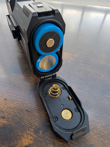

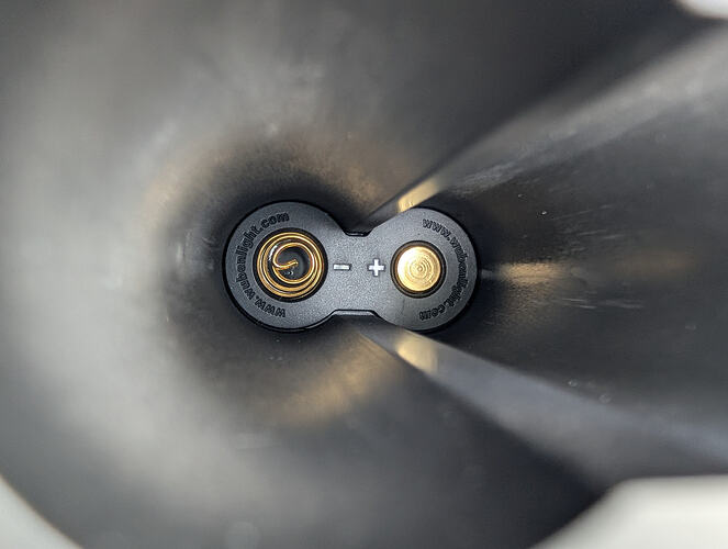

The light comes with batteries (XTAR VC4SL measured 4947/4892mAh). The light only accepts button top batteries!

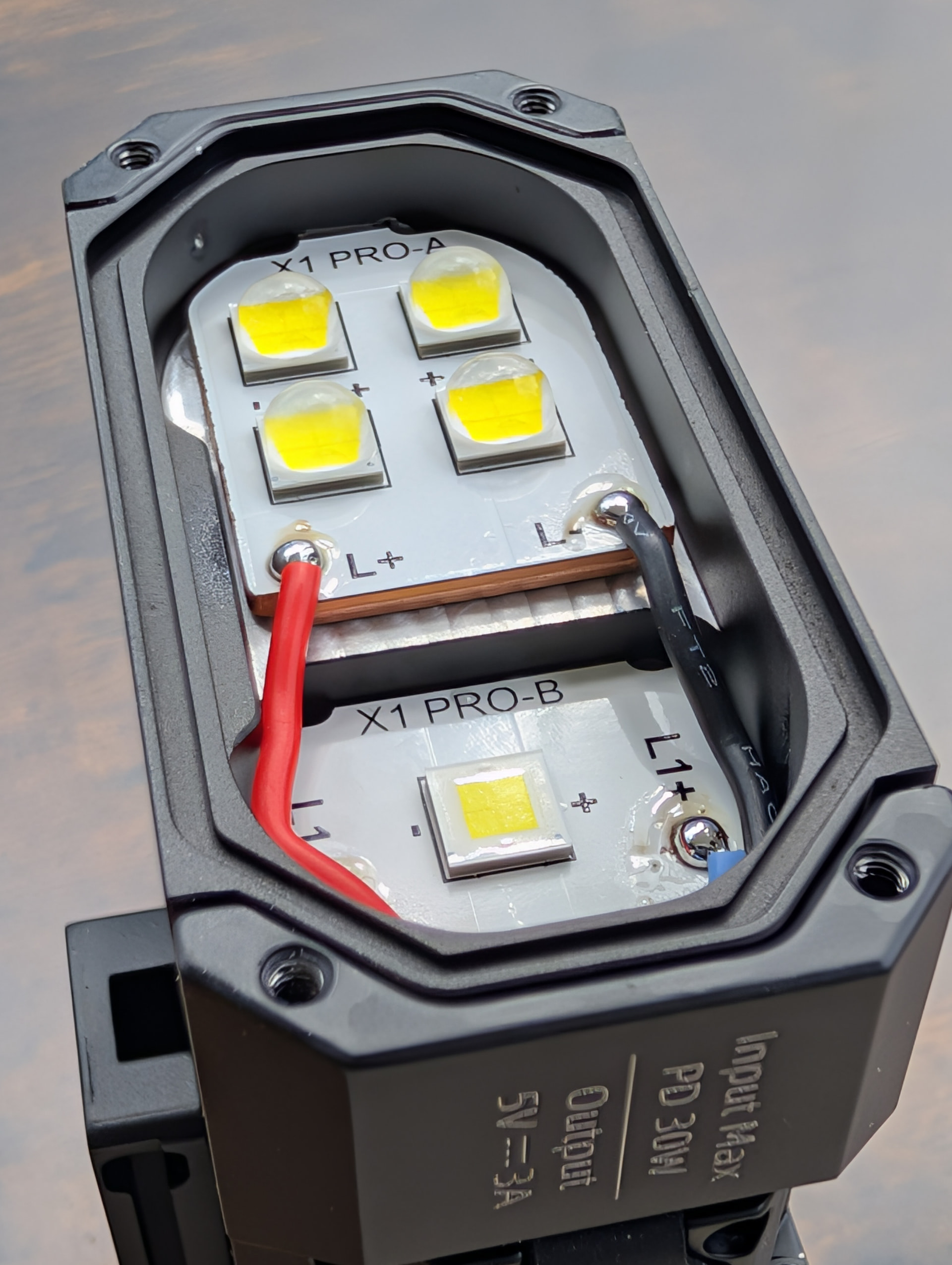

The glass is quite thick and the gasket underneath is even thicker, very nice! No loctite on the threads.

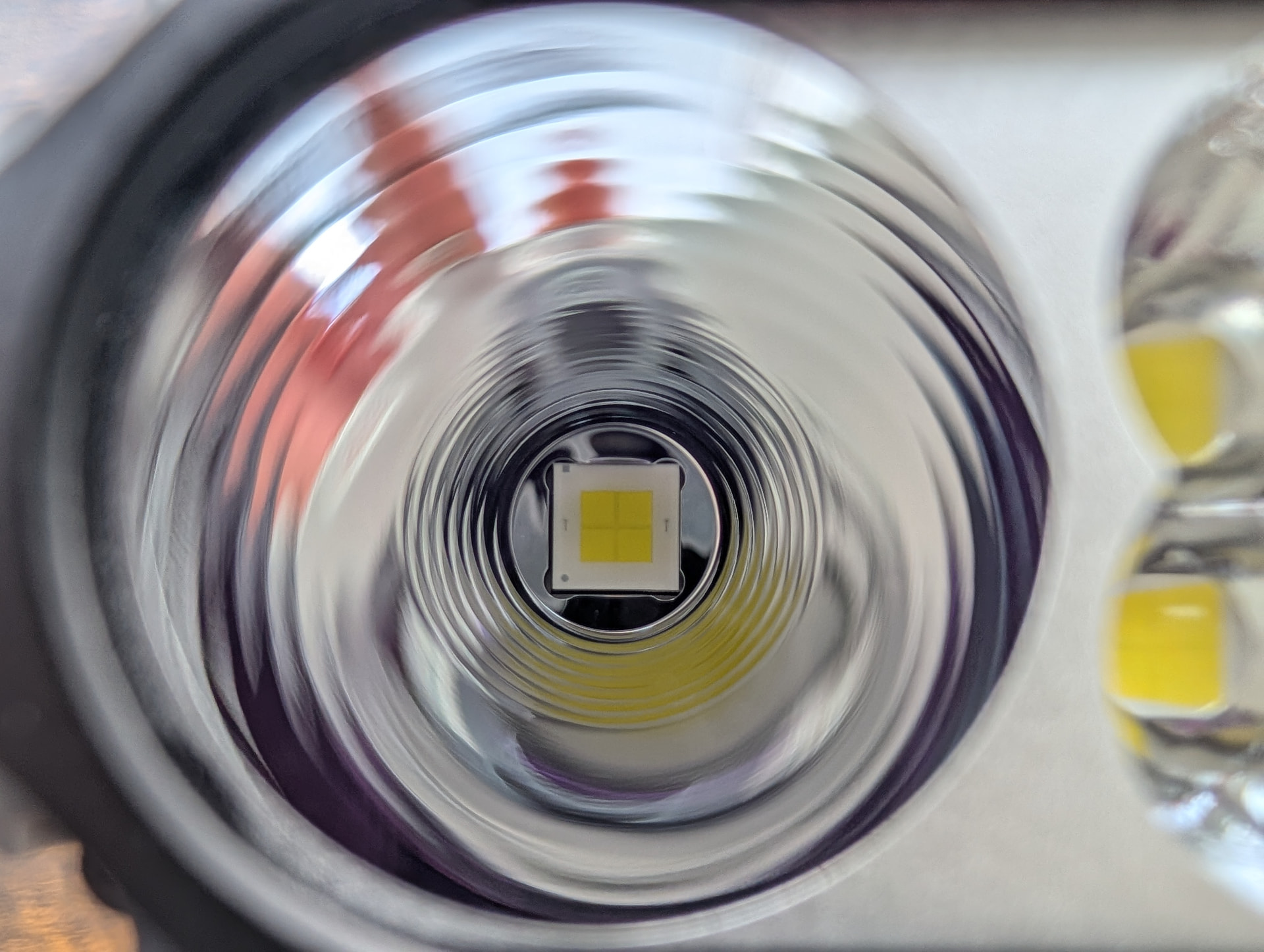

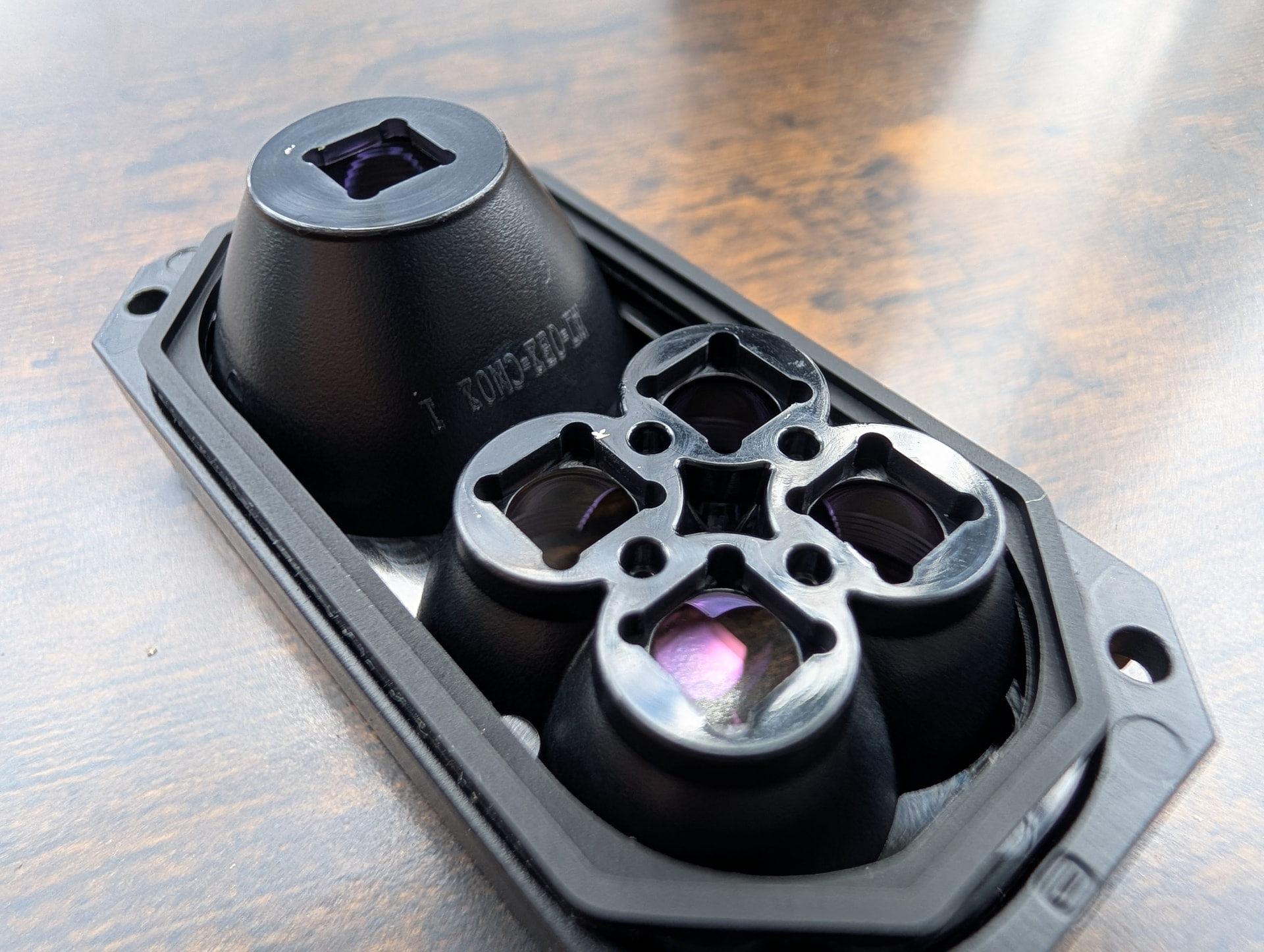

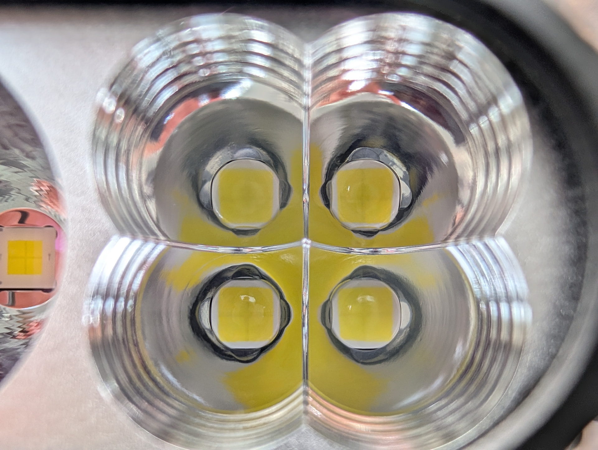

The reflector is made from plastic, which surprised me because it is so well made that I thought it would be aluminum

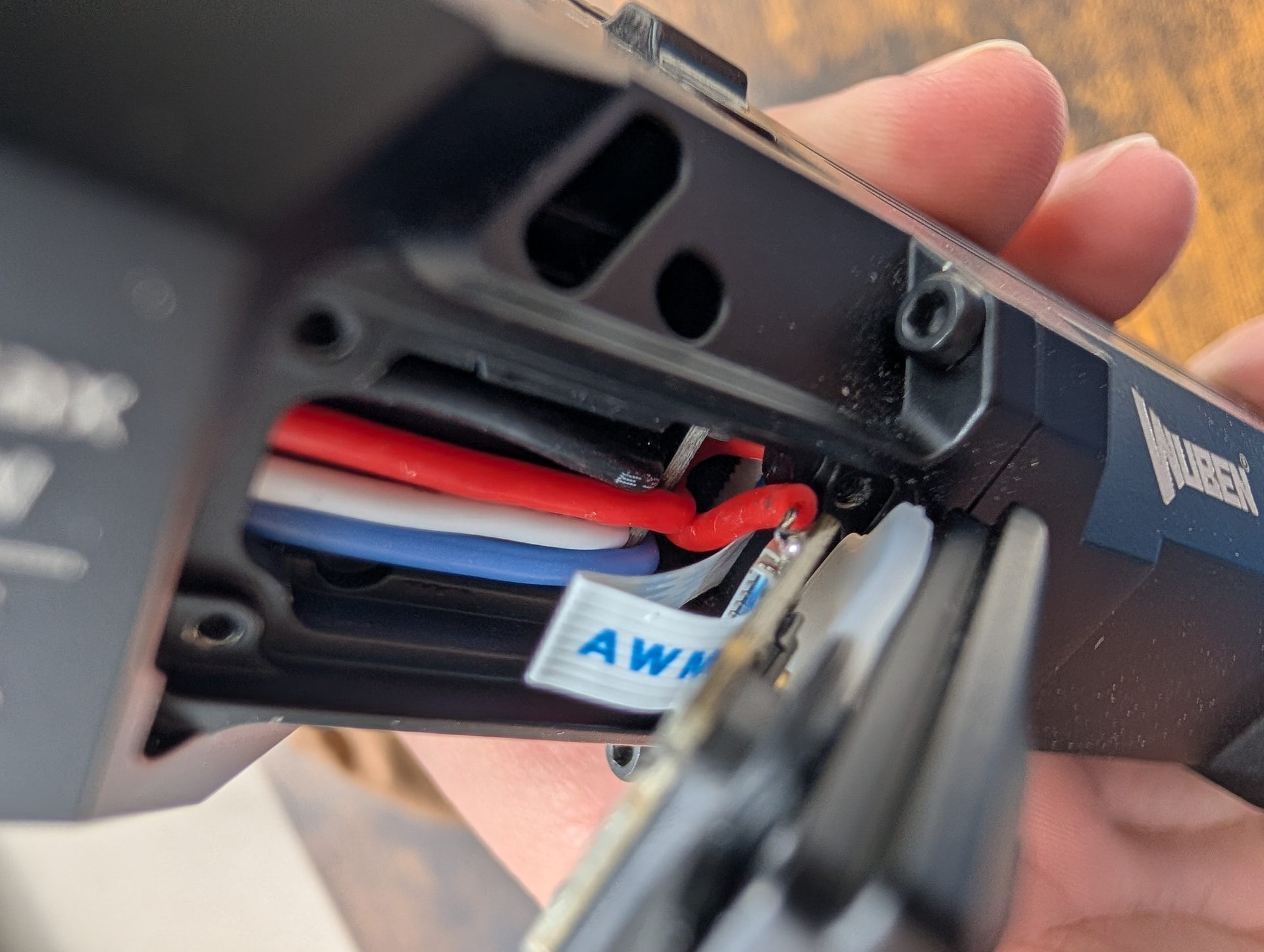

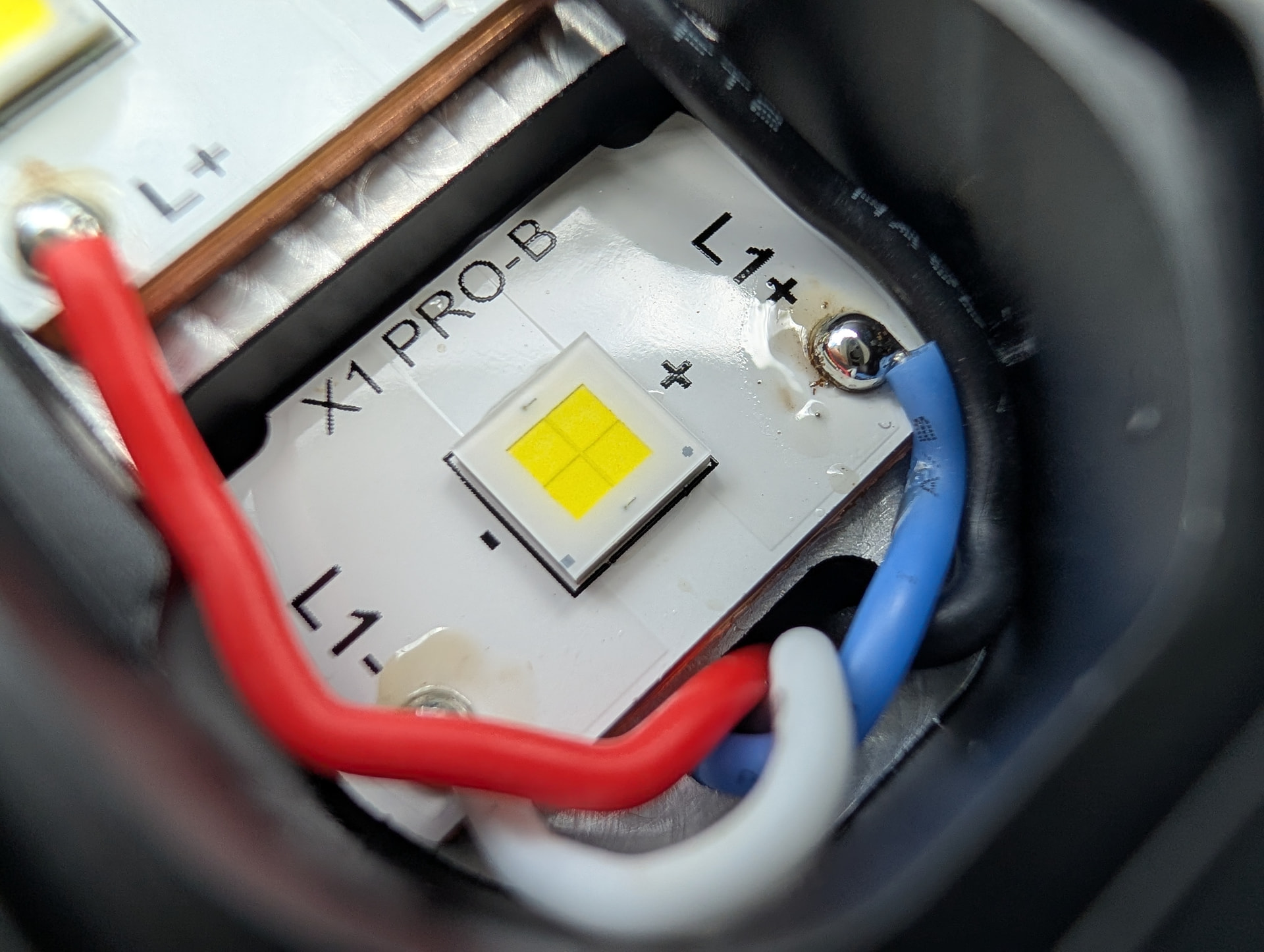

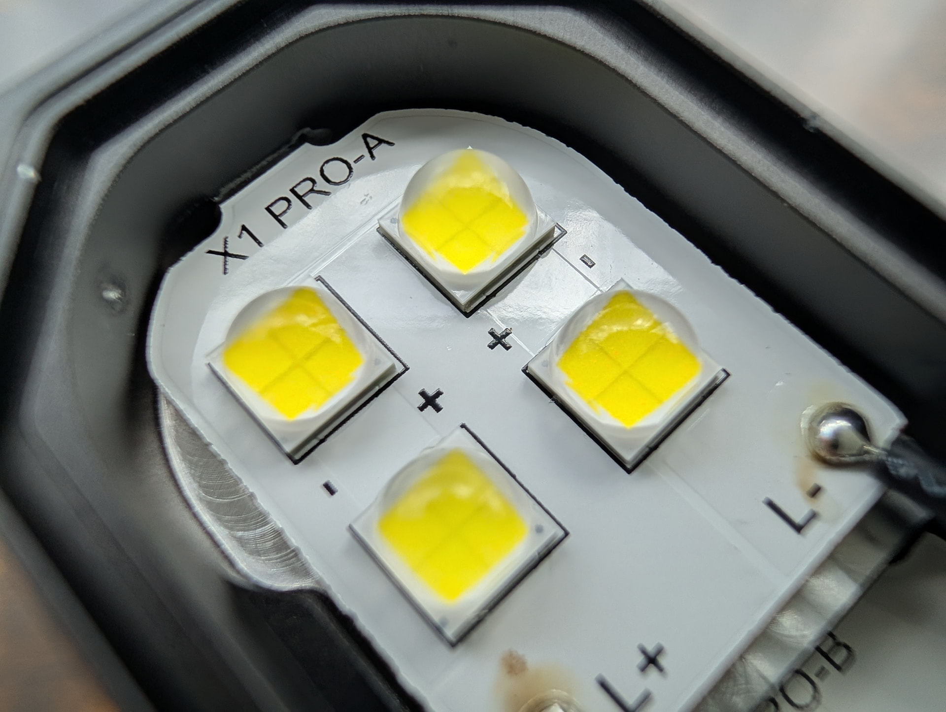

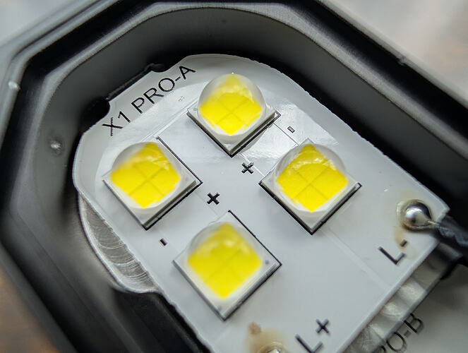

If I looks at this picture, I think Wuben should have used a bit bigger wires for these 4 LEDs?

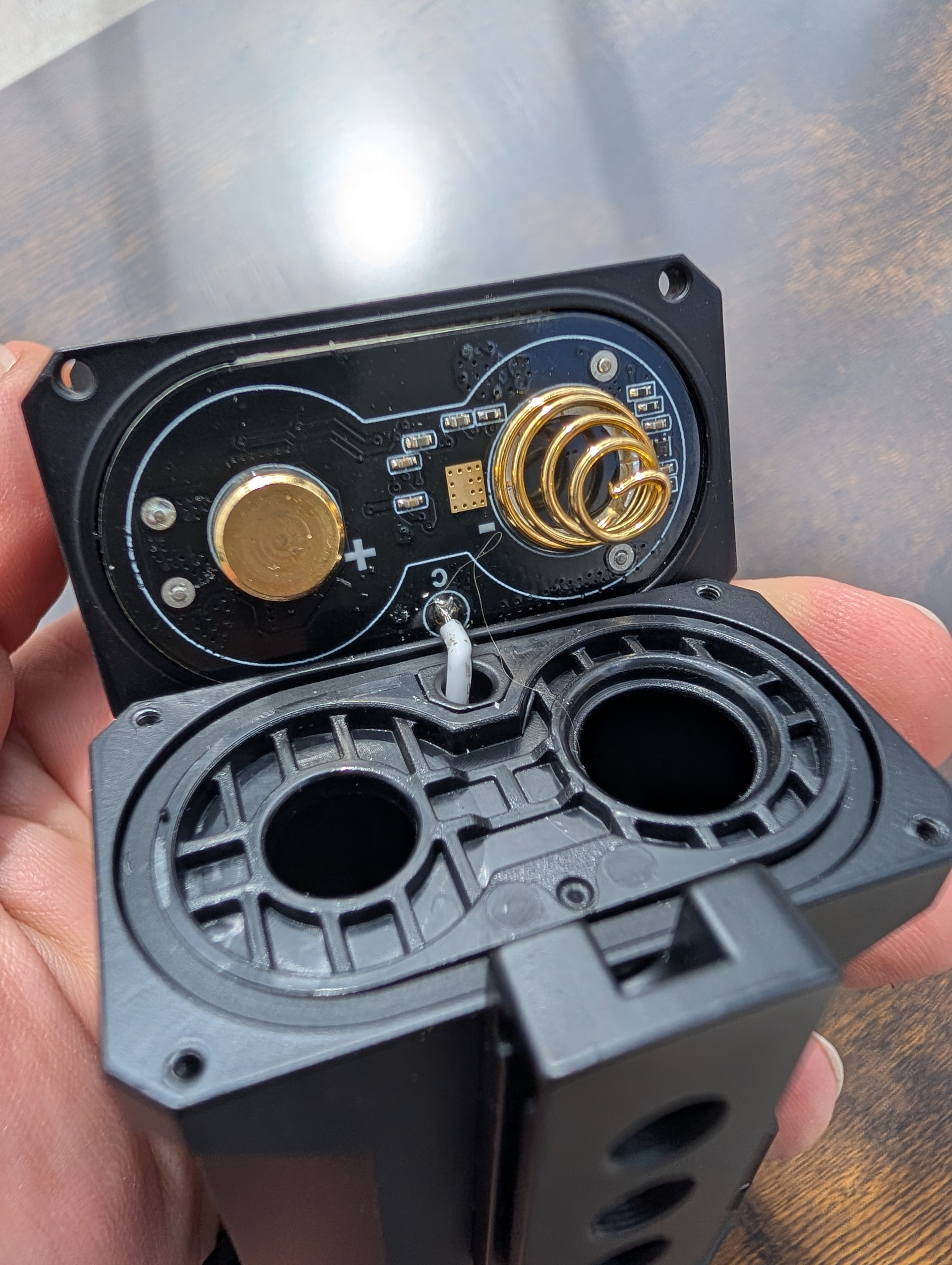

The underside of the flashlight head - If you want to use flat-top batteries, you could probably add a solder blob here? THe cable is for the balancing while charging.

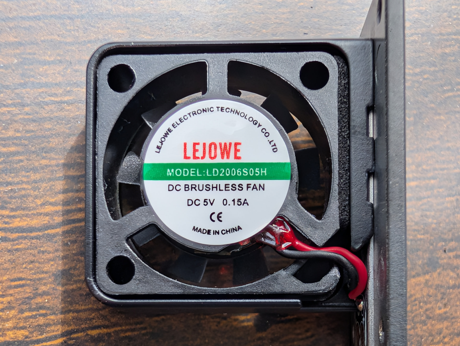

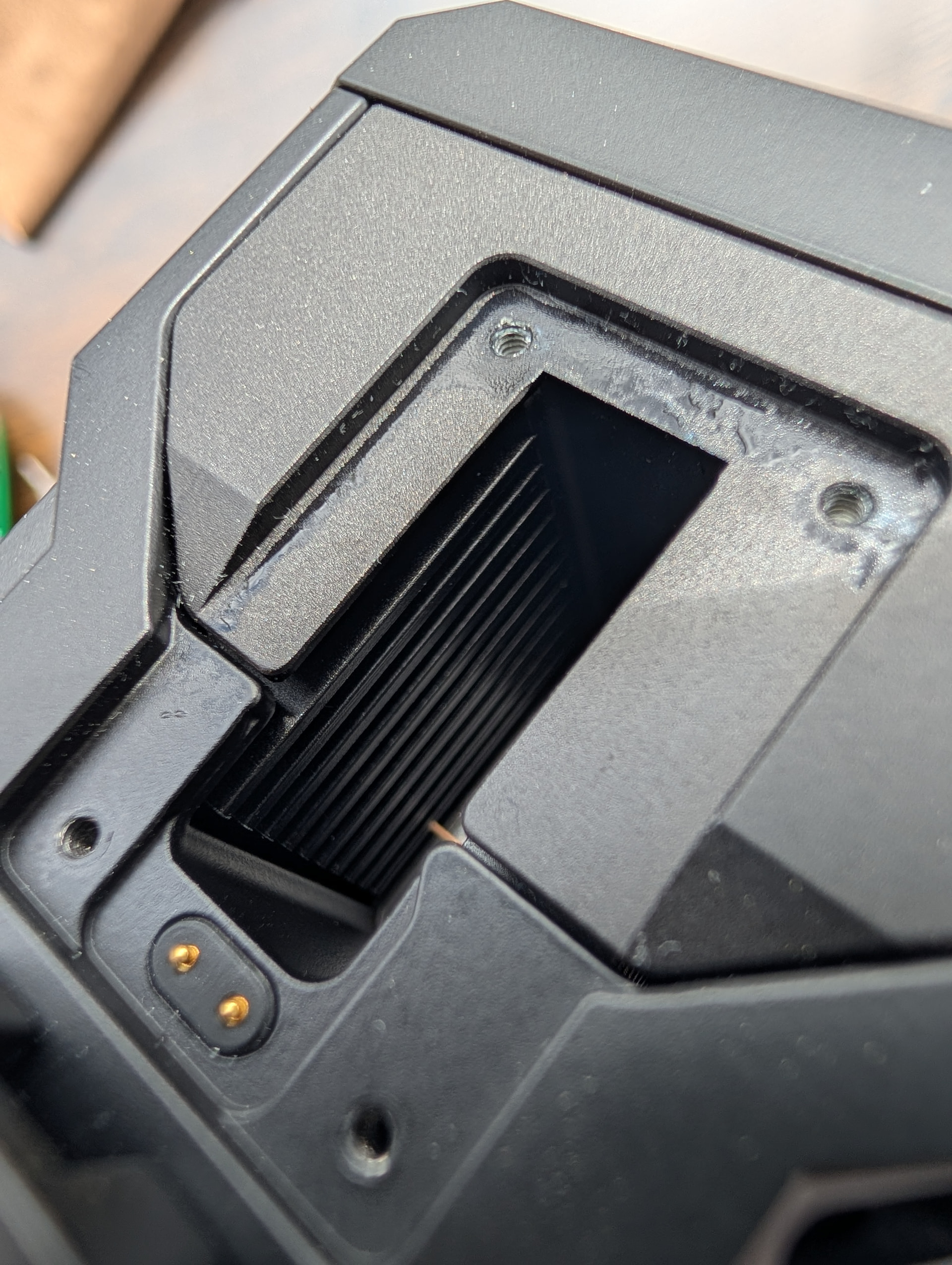

This is the slot for the little fan, the color difference of the two parts is not that much visible in real, but you can see that the cooling-part has a tiny bit of a different surface texture than the rest of the light. I guess because the light has some sort of paint on it, but the heatsink is anodized.
The side switch comes loose, but there is not really something repairable underneath.
The only “flaw” of my light is, that the battery-compartment-hatch doesn’t open easy if there are no cells in the light. If there are cells inside, the hatch springs open.
On this picture you can see in the oval cutout where the lower arrow is pointing to, a little paint is missing because the latch is rubbing on the case.
Nothing you see if the hatch is closed and a really minor flaw that most people probably would never notice.

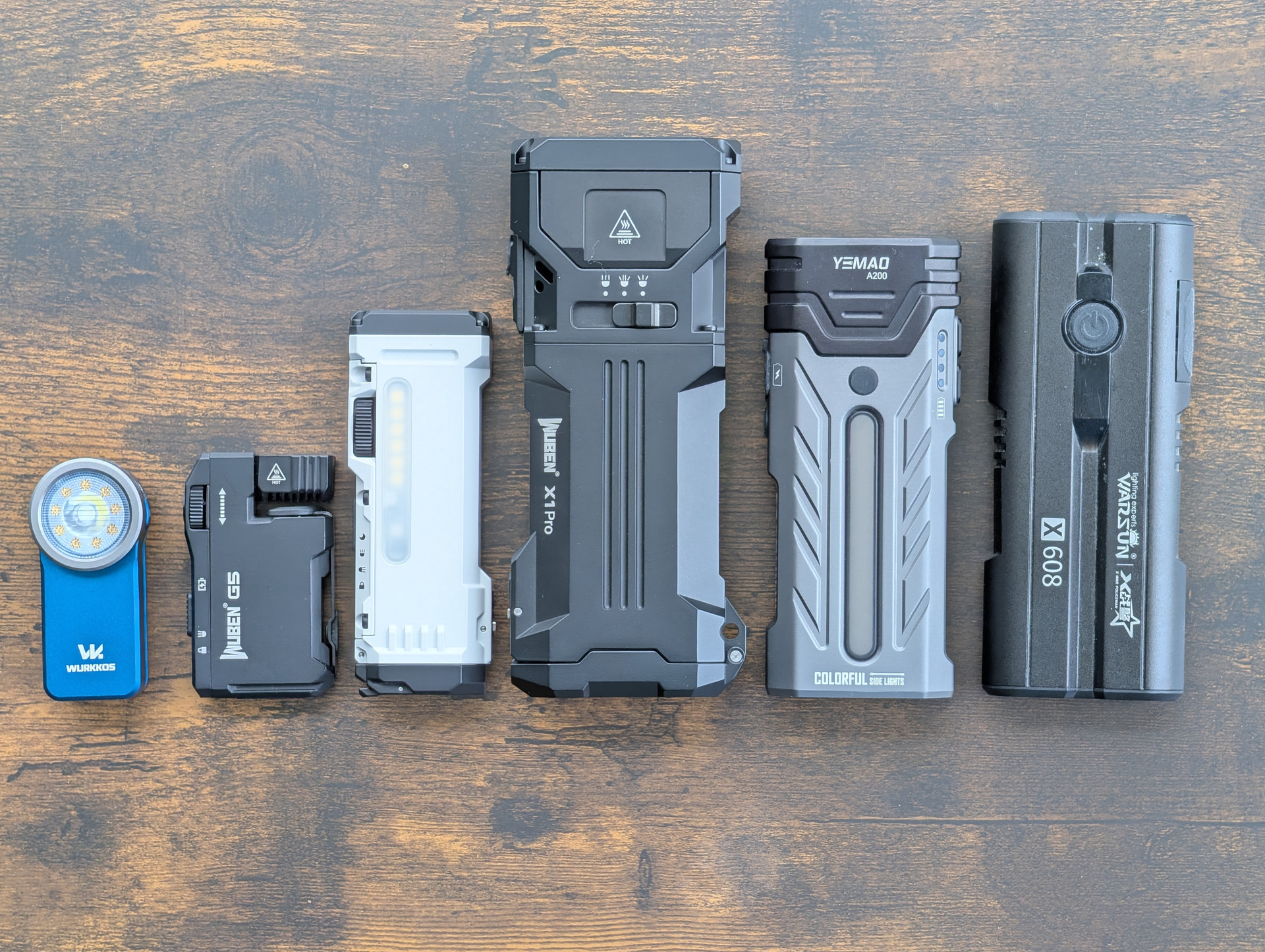

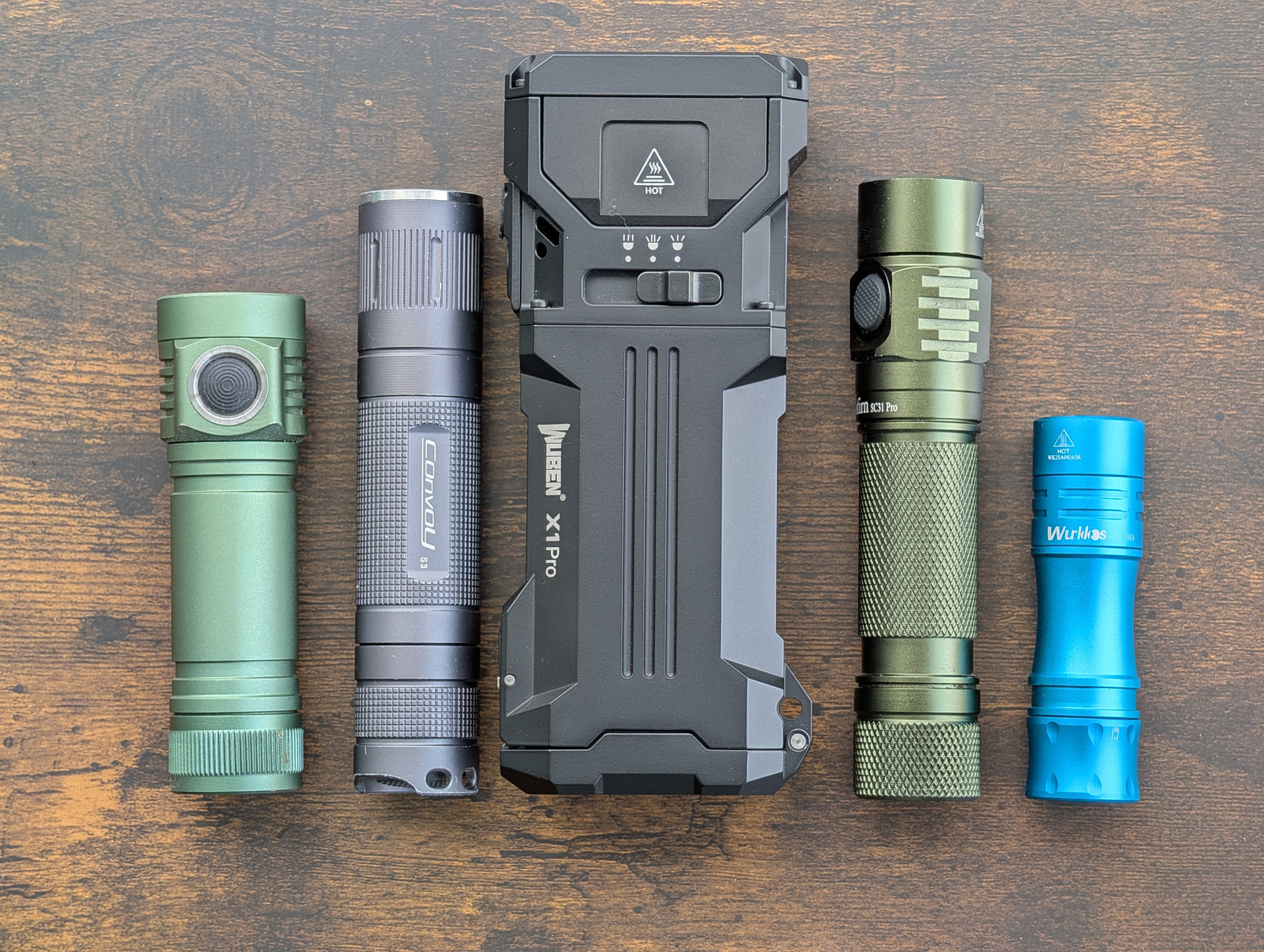

A quick comparison to other square lights:
Wurkkos HD03, Wuben G5, WUben X4, Wuben X1pro, Yemao A200, Warsun X608
And with round lights that a lot of us have:
Emisar D4, COnvos S3, Wuben X1pro, Sofirn SC31pro, Wurkkos TS10

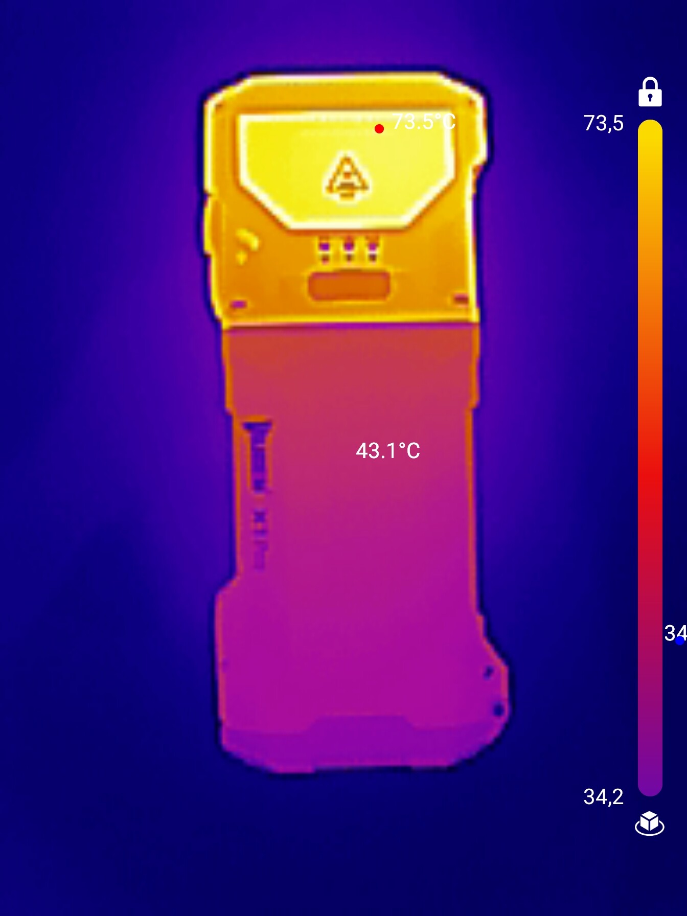

Now thermals in turbo, all LEDs on:
After a couple of seconds, fan not on.
After two minutes, fan kicks in after around 10 seconds:
After two more minutes, the temperature has settled at 60°C, so you don’t want to touch that heatsink.

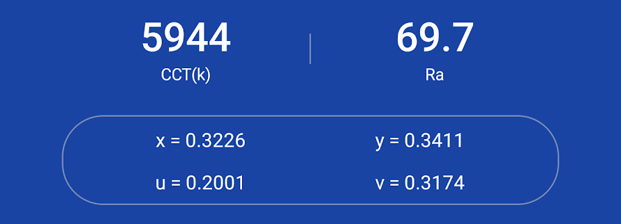

If anyone wants to have this information:
DUV = 0.0045, a non-blue cool white

Thanks for the review, especially for the little teardown! The plastic reflector is a surprise, although it makes sense with the difficult shape and the little rings. Also I didn’t expect hat the USB cover is the same part as the switch rubber.
Cool. I always wanted to see whats inside the X1 Pro. I reviewed it also and i think Wyben made changes from the pre sale model I reviewed. Good to know the LEDs can be swapped. It’s begging for a sft70 for the throw led and xhp50.3 HI for the flooders. Did you confirm if these are 6 volt leds?
Yes, they are 6V LEDs!
For the record, Fenix, Streamlight both use plastic reflectors (the LR80R has one). Way cheaper to make and they take a superior reflective coating for way better quality control and consistency. Not a bad thing at all!
