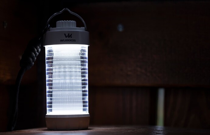

Iâve never had a lantern and never really thought I wanted one. Itâs not enjoyable to walk with it because you have to hold it out to the side or slightly behind you so itâs not blinding you. I spent some time outside on two occasions in pitch dark with it stuck to the obligatory knife in a tree. Actually there was a little tiny bit of moonlight coming through the trees on one of those occasions. Itâs not bright by any means. You donât necessarily always need bright. I suppose if there are two or more people at a campsite itâs better than having everybody having their own headlight on and shining it into each otherâs eyes. This way you just have one light shining in everybodyâs eyes. And you canât see whatâs on the other side of the tree.

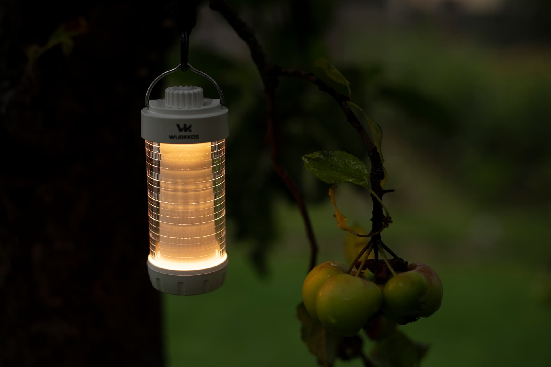

noticed something interesting: the texture of the glass redirects the light downward. This is useful not only when the lantern is hanging above your head, because it sends the light where you need it, but also makes it more pleasant for the eyes when itâs standing on a table, below eye level.
