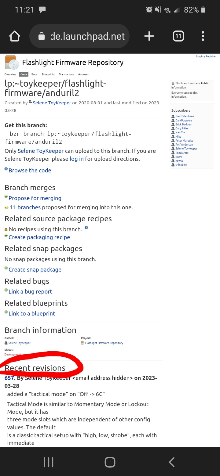

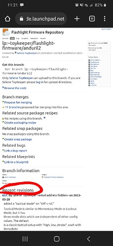

There’s view branch changes and view revision when you can see the changes between revisions : ~toykeeper/flashlight-firmware/anduril2 : files for revision 657
Other cfg files are located here : ~toykeeper/flashlight-firmware/anduril2 : files for revision 657
https://bazaar.launchpad.net/~toykeeper/flashlight-firmware/anduril2/files/657/ToyKeeper/spaghetti-monster/anduril
https://code.launchpad.net/~toykeeper/flashlight-firmware/anduril2
