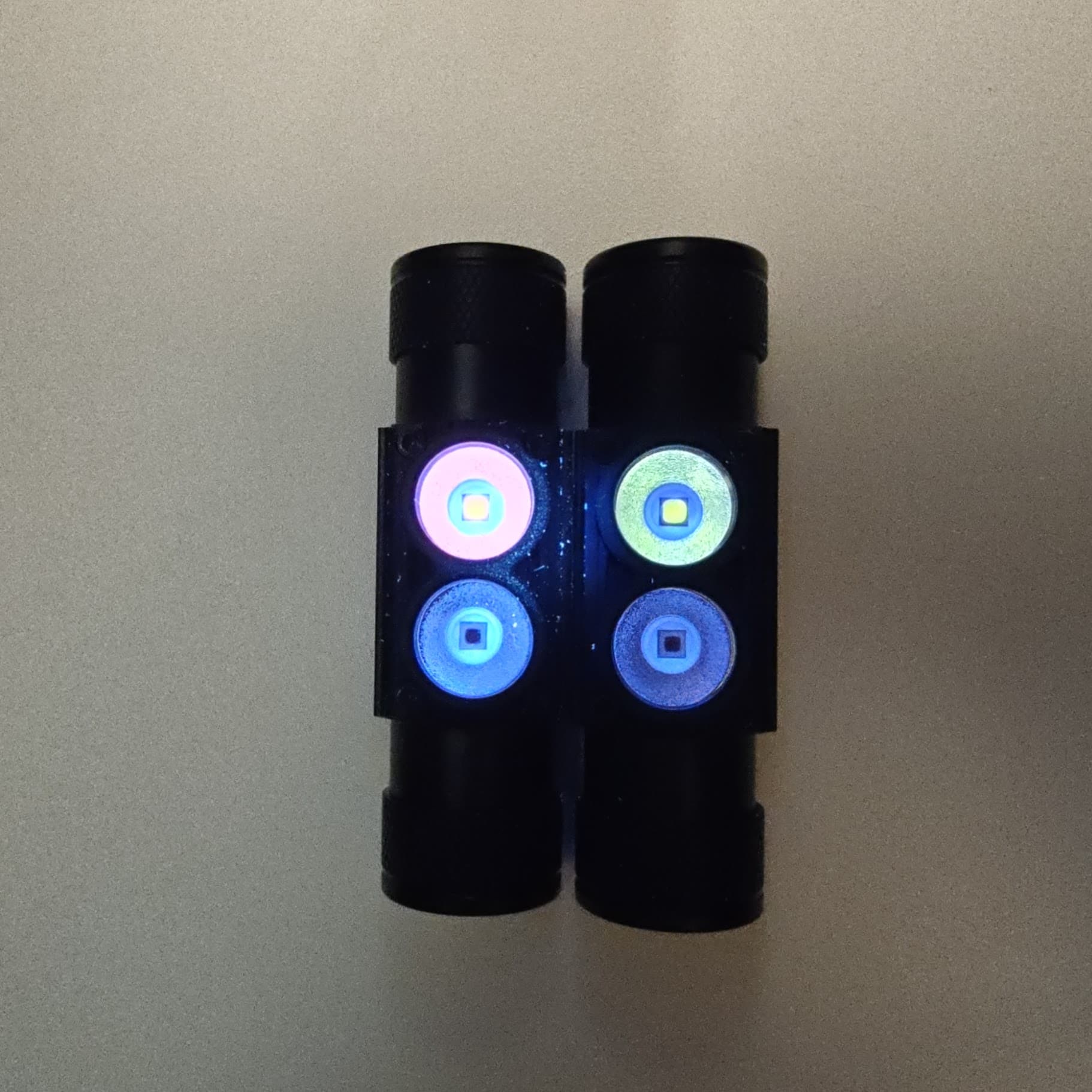

Is it Samsung LH351D or already LatticePower TN-3535 in Sofirn ?
24th picture could be the key.
White die light up differently under the UV light exposure.
Would someone be able to help determine based on the above?
Could it be different batch of LH351D in Sofrin flashlight?

Given the existing info, one of them is the TN and one of them is LH351D. Count the number of chopped-off corners on the LED: 1 for LH351D, 2 for TN.
Also, the LH351D 5000K lights up yellow-green under UV, which is highly unusual for a high CRI emitter.

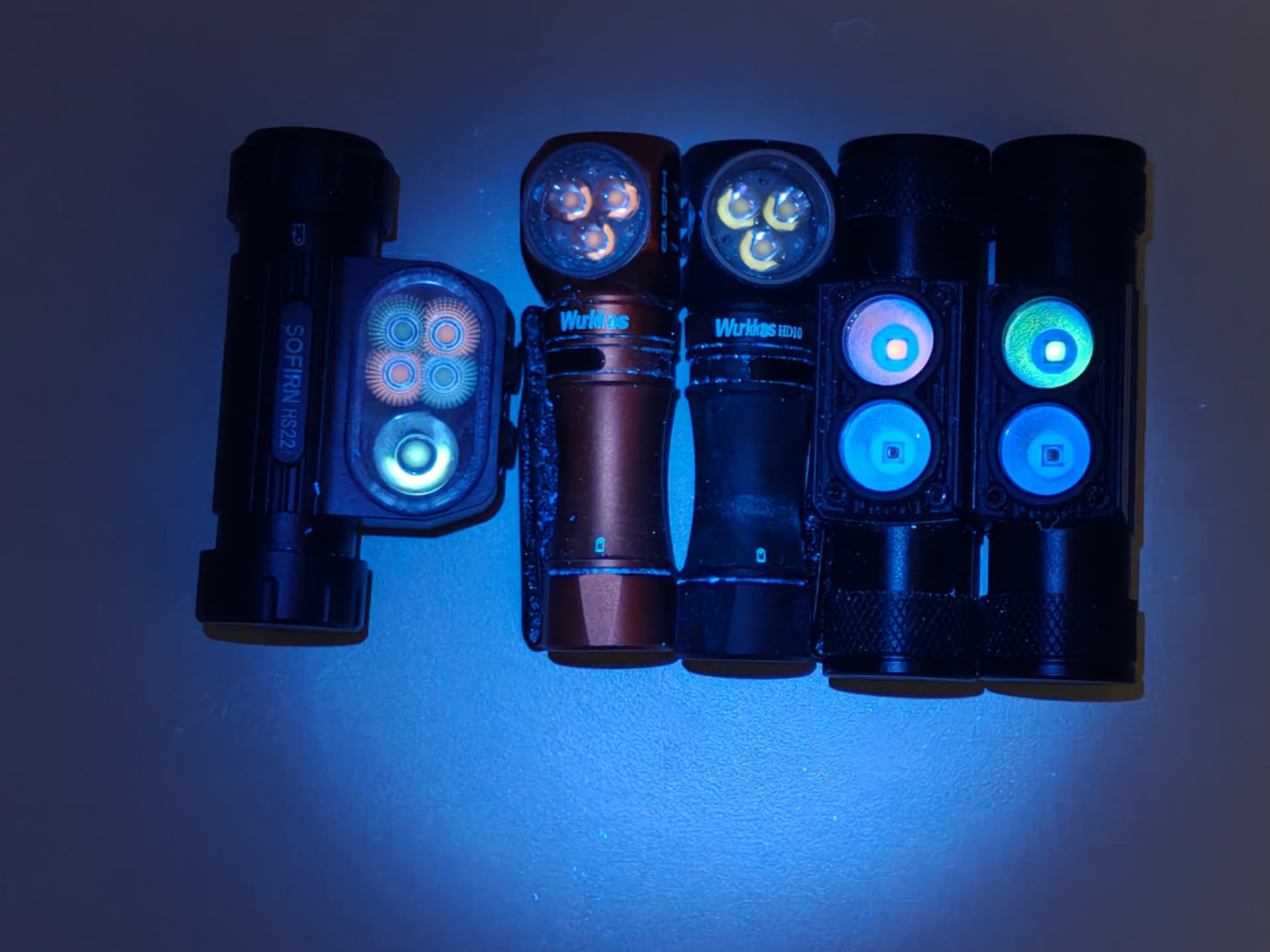

I’ve grabbed UV flashlight again and couple of others flashlight, that suppose to have LH351D LED emitter…
  • HD20 - 1* LH351D 5000K 90CRI, 1*Cree XP-L HD 5000K 70CRI
  • SP10v3 - 1* LH351D - 5000K - 90 CRI
  • HS10 - LH351D 90CRI ( I believe - 4000K )
    and again
  • Wurkkos H25LR on the Left - officially LH351D 5000K LED 90 CRI
  • Sofirn H25LR on the Right - suspected LatticePower TN-3535 5000K
    Those are the results:

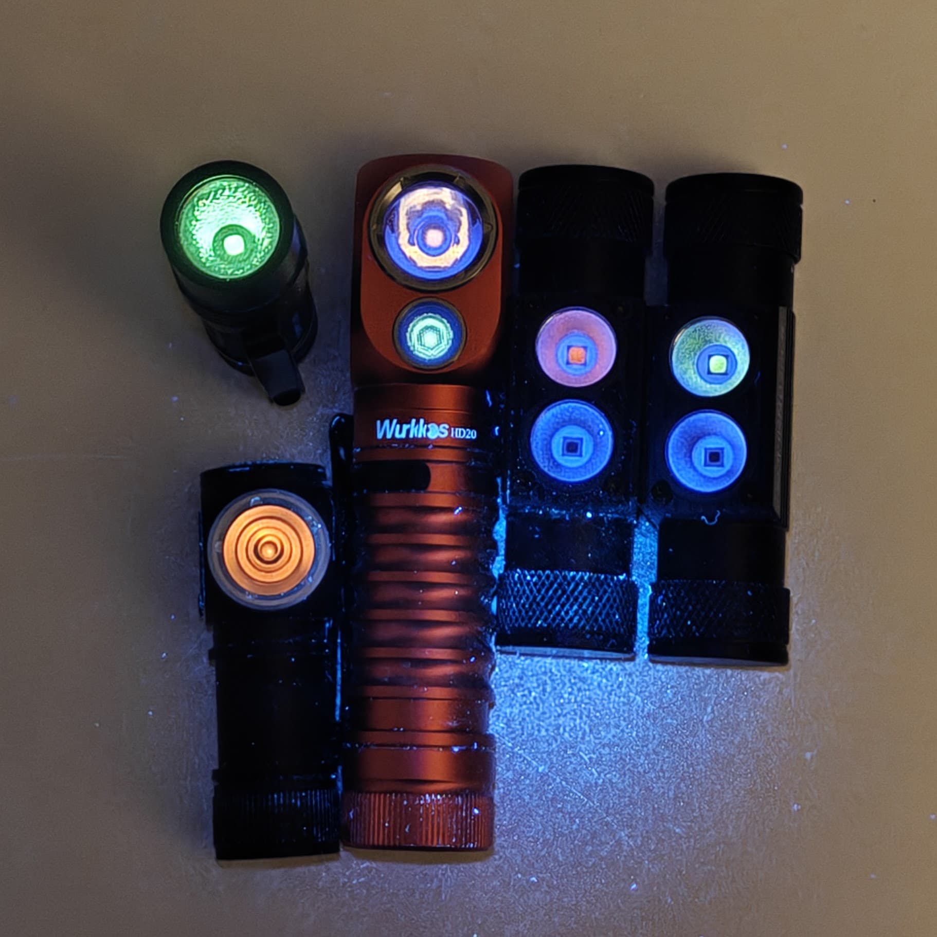

I’ve also grabbed couple of TN-3535 flashlights:
  • HS22 - 1* SFT-25R 6000-6500K, 2* TN-3535 6000-6500K 70CRI, 2* TN-3535 2700K
  • HD10 - 3* CSP2323 (3535) 90 CRI - 4000K
  • HD10 - 3* CSP2323 (3535) 90 CRI - 5000K
    and again
    this is what I get:
https://i.imgur.com/9wqjO4B.png
The conclusions are ambiguous…
:man_shrugging:
Nice beamshots! They seem to suggest that the official emitter spec is wrong–the yellow-green emitters should always be some 70CRI emitter or a 5000K LH351D.
It’s not inconceivable that the manufacturer mixed up the batches, given how visually similar the TN3535 and LH351D are.
