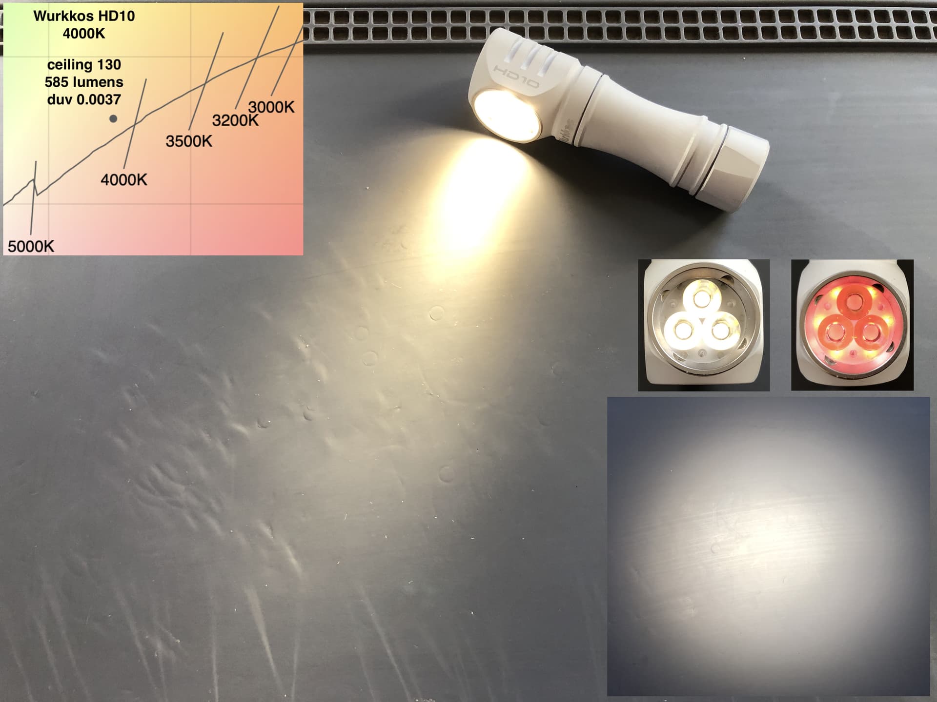

Wurkkos HD10 First Impressions
HD10 Firmware is version number 0713-0
factory reset defaults:
ceiling 130 gives 585 lumens and DUV 0.0037
tactical gives 420 lm
this firmware uses Last Mode Memory, I like that it does not use Manual Memory, nor Hybrid memory.,

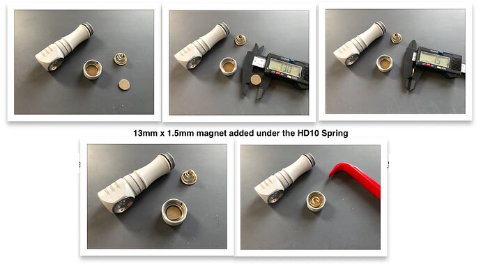

Solution to the weak HD10 Tailmagnet, add a second magnet:
link to 12mm x 1.5mm magnets

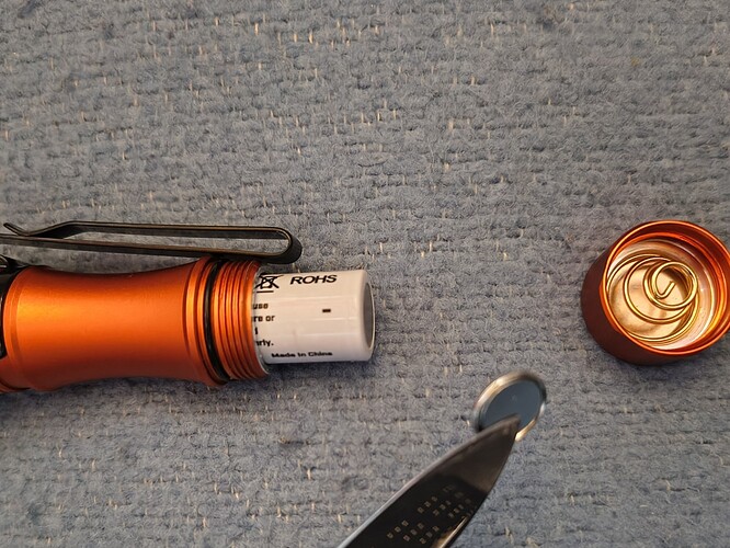

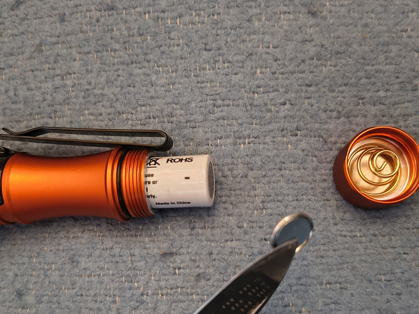

I got today (2025-03-03) an orange HD10
Wurkkos included a second additional ø11,2mm x 1,7mm magnet
(Edit: it’s not a simple two sided one, it is a thin magnet with a metall cup, so the forces have one direction)

Thanks for the photo… great to see Wurkkos is including an extra magnet…

@jon_slider I just noticed you use a thinner magnet. Was the 12x3mm magnet too thick, or is it only hard to get?
yes
3mm was too tall, the light would not close… imo 1.5mm is better, and still strong enough
Hm, I have already ordered 3mm ones. Luckily Wurkkos includes a second magnet.
