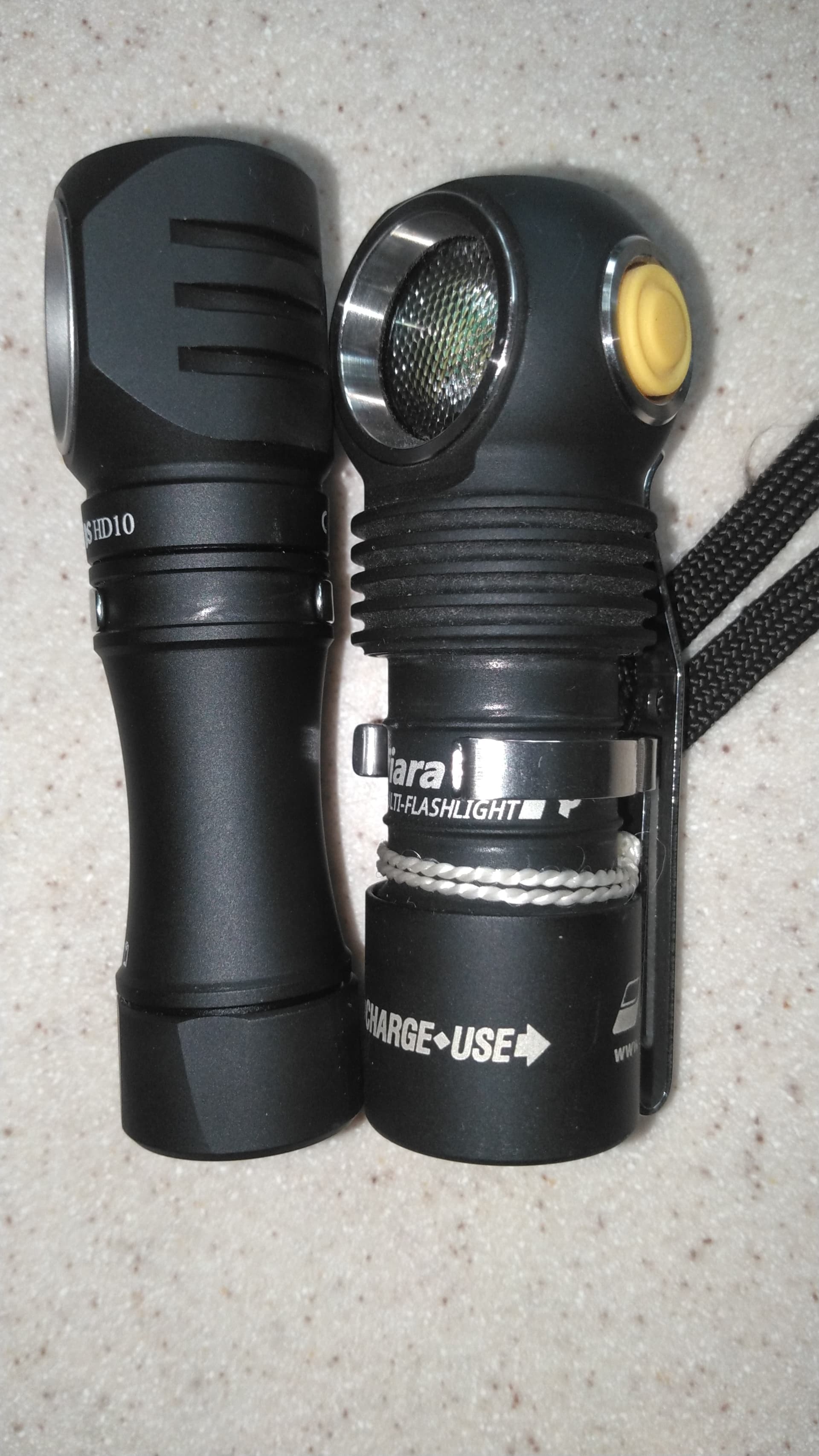

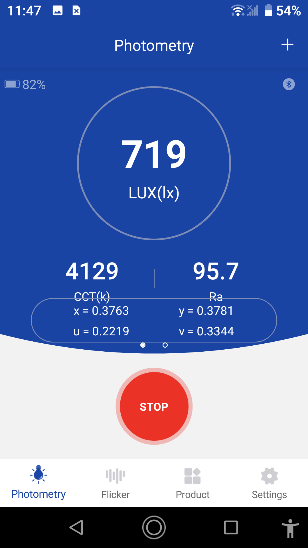

Samples are arriving. I requested a 3K or 4K if available and I received a 4K. I have some initial observations.
3.25 inches.

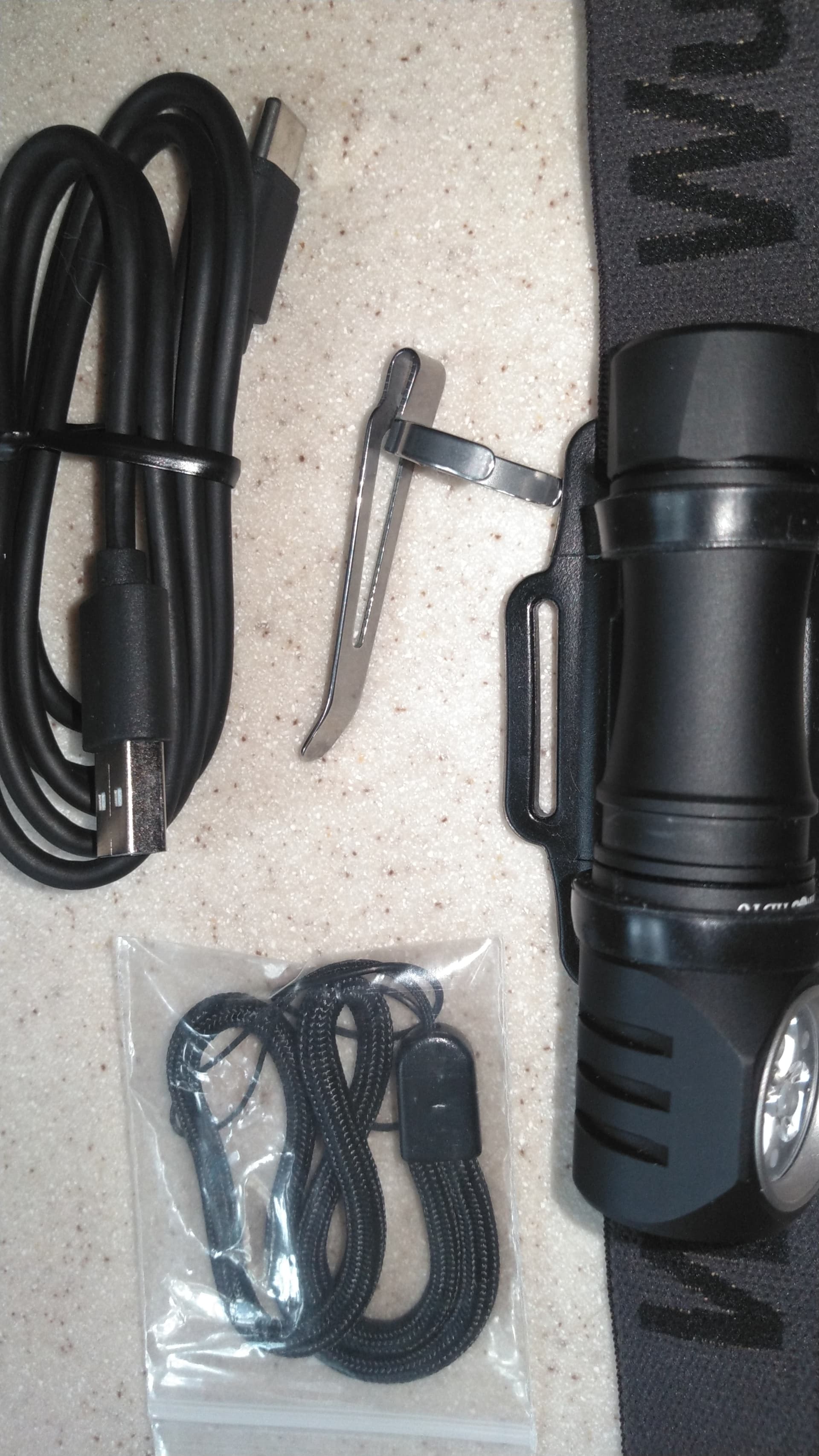

A-C cable. Clip. Lanyard, no place to attach it other than on clip. Headband with rubber loops.
The headband is pretty comfortable with very little weight. But because it’s a large section of rubber you are going to sweat and or need some sort of padding still.

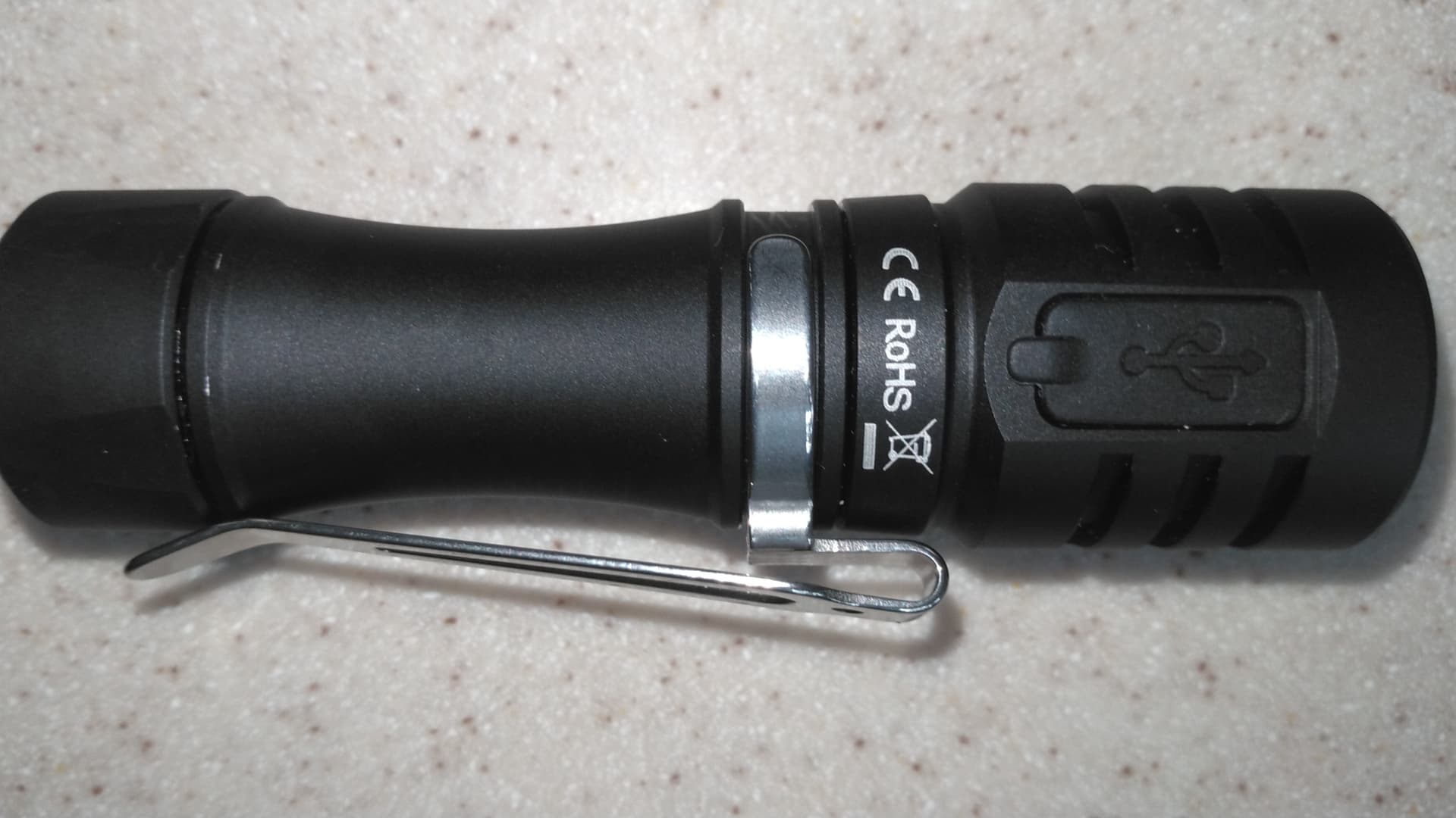

Large flush metal switch on top. It requires very little pressure and has a nice soft audible click.

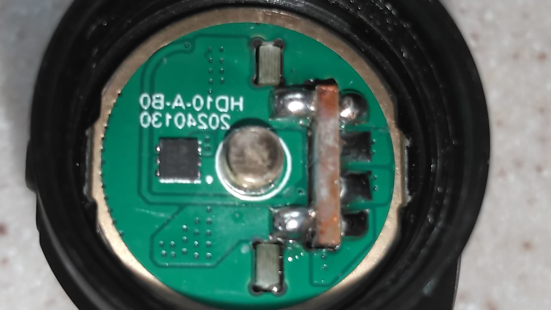

Looks like it doesn’t have flashing pads, and the optic retaining ring is press fit.
Does it at least have Anduril?

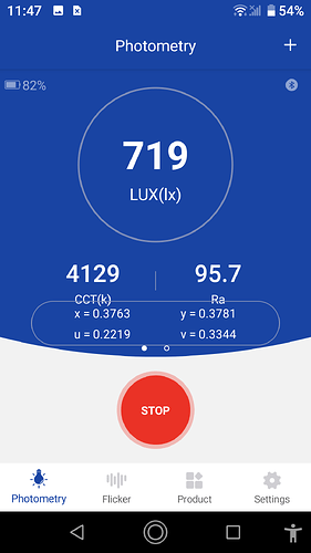

It has a hotspot that’s probably 3.5 feet wide from 10 ft away but it has no defined edges and it blends into the spill pretty well. So it lights up a fairly wide path. That’s only in my basement testing at this point as I have to wait for nighttime.

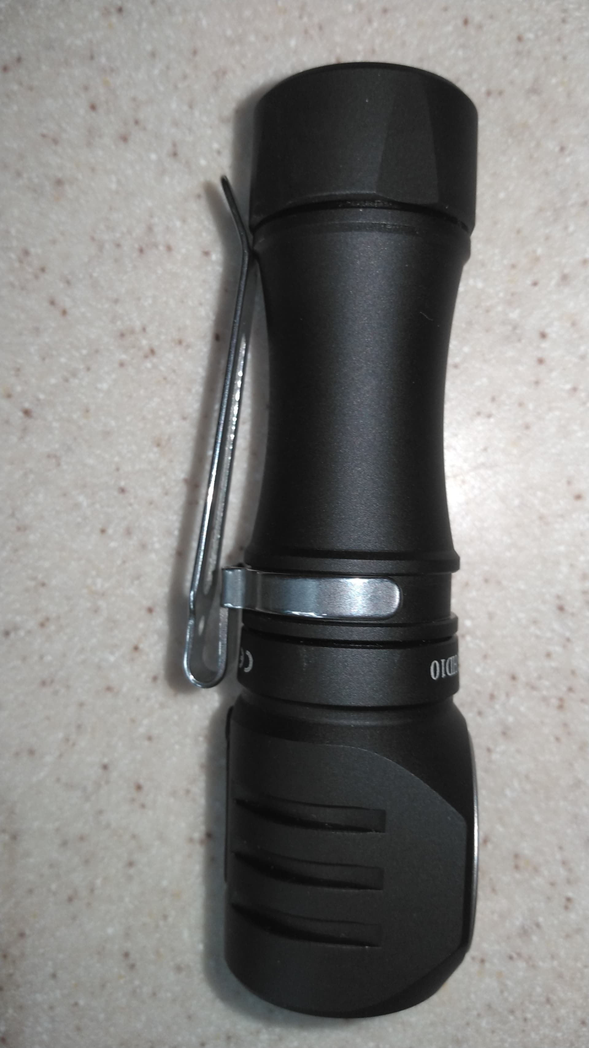

pocket clip is in the middle of the light, which to me is useless
I wonder if the body tube can be flipped, so the clip would be at the tail end?

I don’t see flashing pads either. I need to look more closely.

One of the first things I did was attempt to reverse the tube. You can reverse the tube but they don’t really want you to. They took the time to bore out the last 1/8 inch of the tube on the top end extra thin. Otherwise the thick tube tail end comes very close to those two rectangular items in the picture I posted above.
So I would recommend that they bore both ends thin so that you can safely reverse the tube.
The clip is not going to be ideal in its current position. Even with the tube reversed I don’t really like the clip.

How wide is the USB flap? Some of my Sofirn lights have too tight cuts around the ports, so most of my USB cables barely fit. This seems a bit wider?
The thick tail end of the tube actually comes dangerously close to a few components, so do not reverse the tube at this point in time.

Flashing pads are IMO a must have.
Lets hope the production version has them.

@Wurkkos_Terry @Wurkkos I really hope there’s proper firmware flashing pads and removable bezel (bezel ring with notches) for modders, on the production version.
