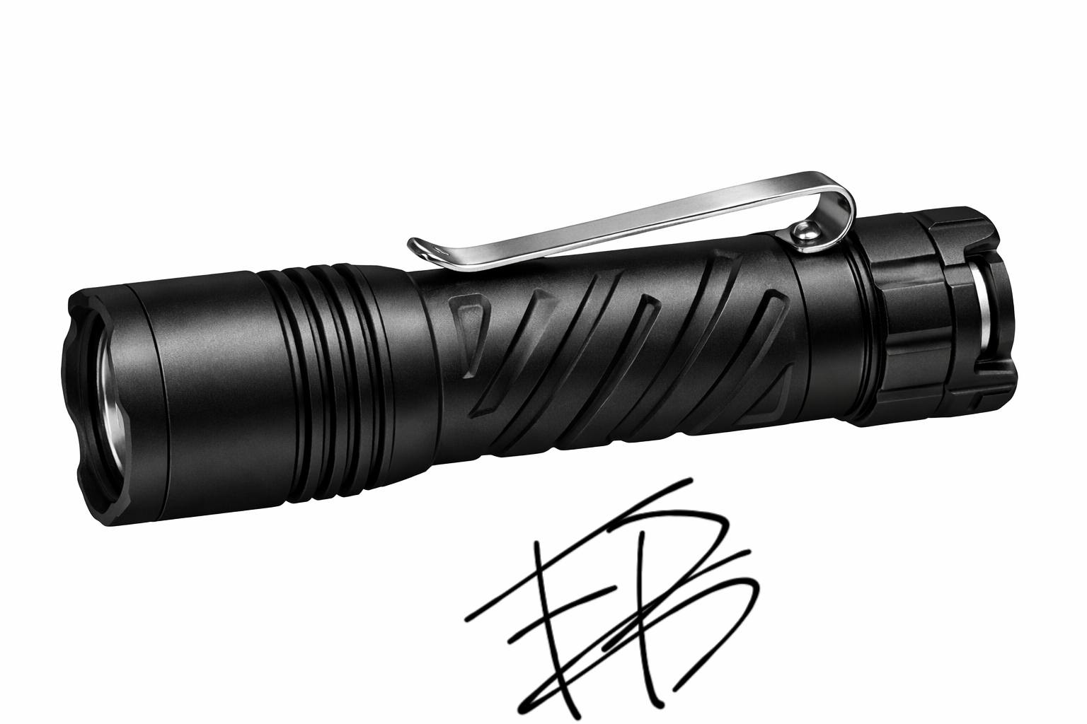

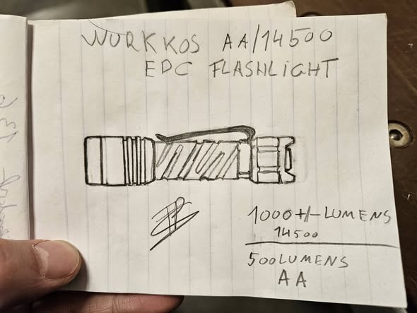

①AA EDC flashlight Points by Fábio Pereira ↓↓
  • 4/5 modes (Ideally without strobe modes)
  • Regular reflector and regular glass lens.
  • Mechanical switch.
  • Specs: 14500 battery around 1000 lumens.
  • AA Battery around 500 lumens
  • emitter: we all love like 519A or SFT25R.

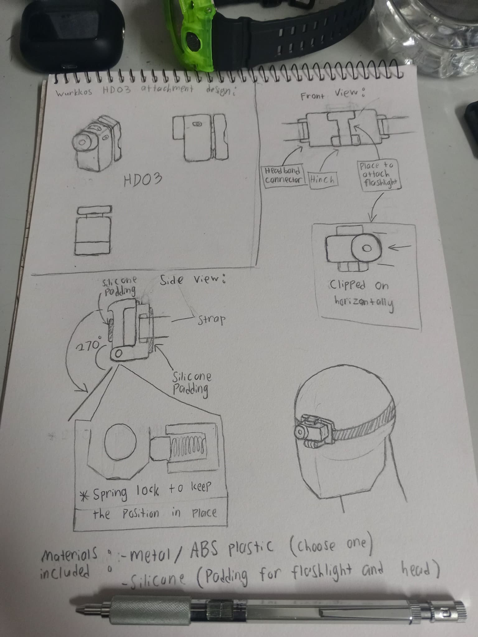

②HD03 headband Points by Meer Arts ↓↓
  • Securely mounted on a headband
  • Adjustable up to ~270°
  • Locked in position using a spring mechanism
  • Padded with silicone for comfort and stability

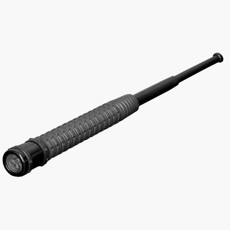

Maybe you could create a “baton” light.
Well there are already such a thing, but nevertheless.
That’s the next model - double 40138 cell flashlight
