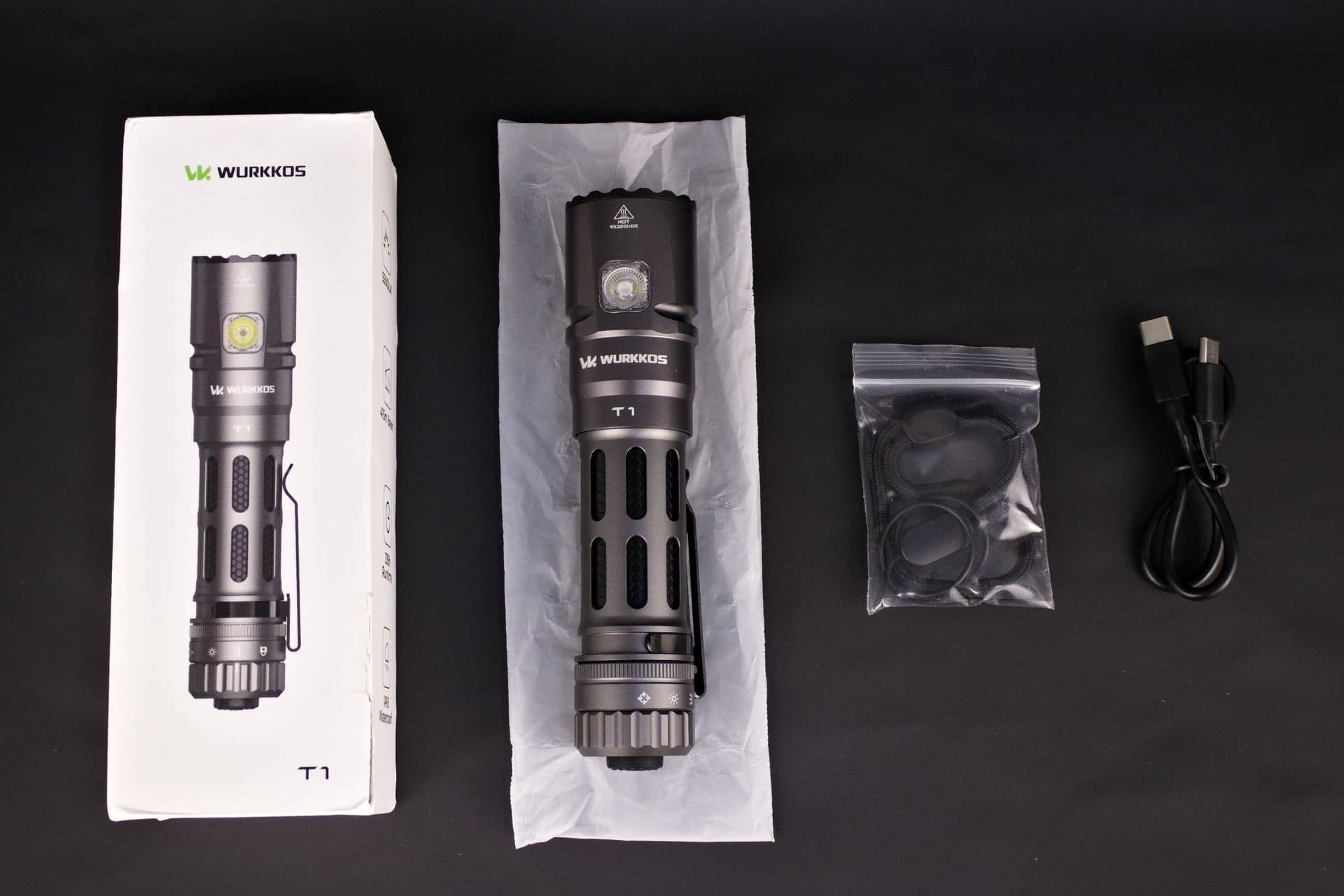

• Box contents
- Wurkkos T1
- Wurkkos 21700 5000mAh Li-ion battery
- USB-C to C charging cable
- Lanyard
- 2x extra O-rings
- *User manual (Was not included on my unit)

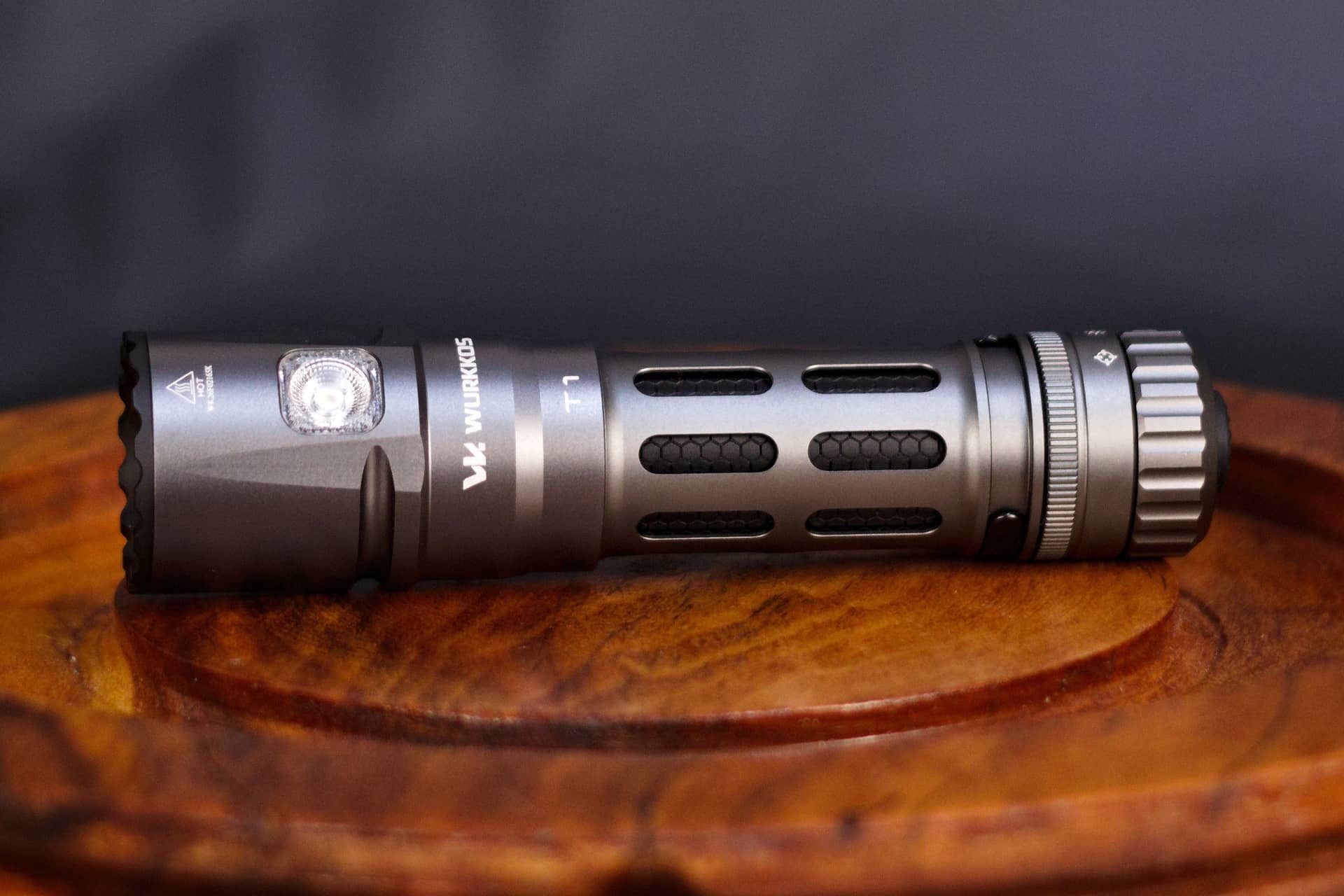

Anodizing Colors/Material Options: The T1 is only available in 6061-T6 aluminum with gray anodizing - most probably type II anodizing to have the gray color.

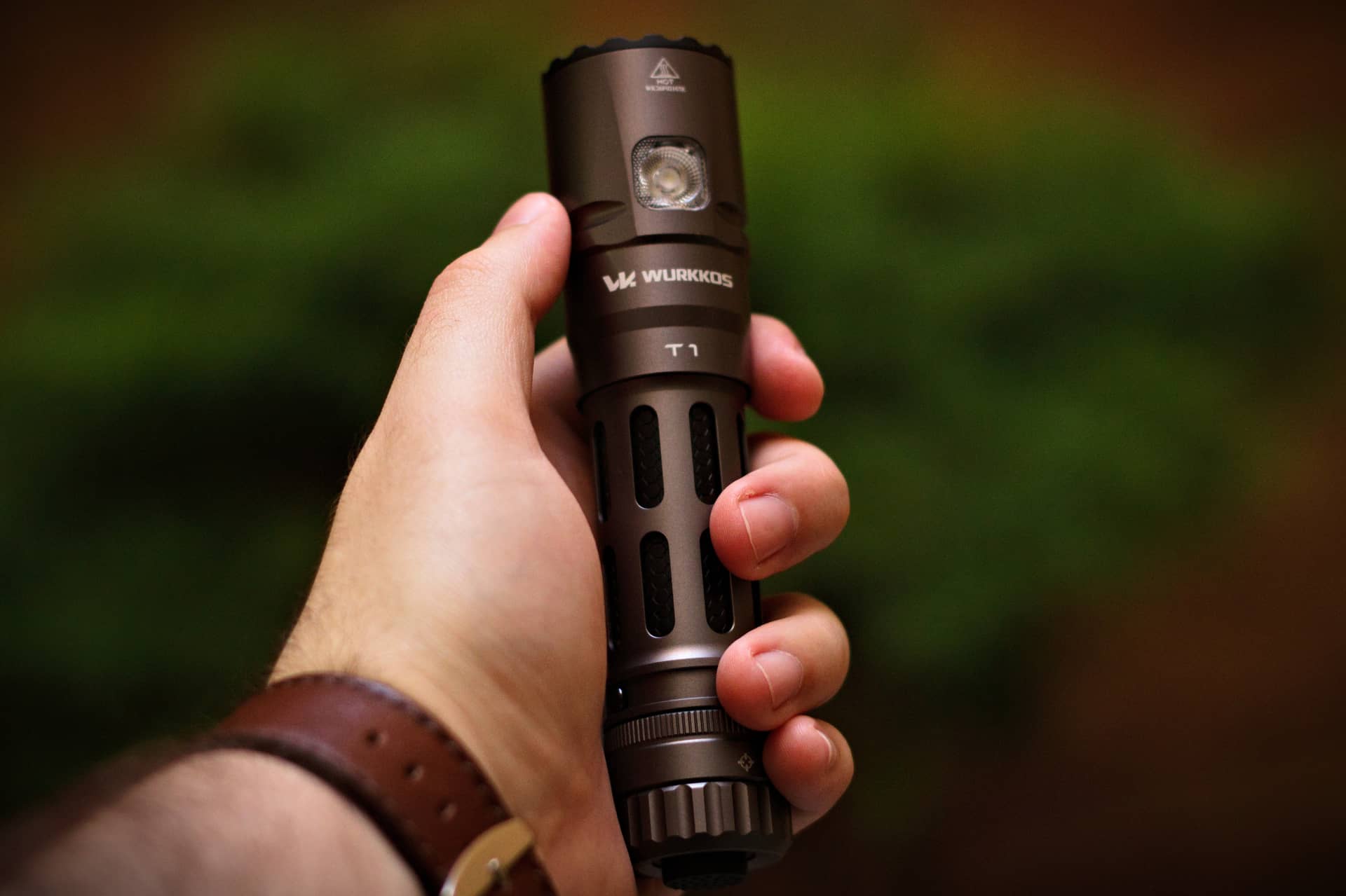

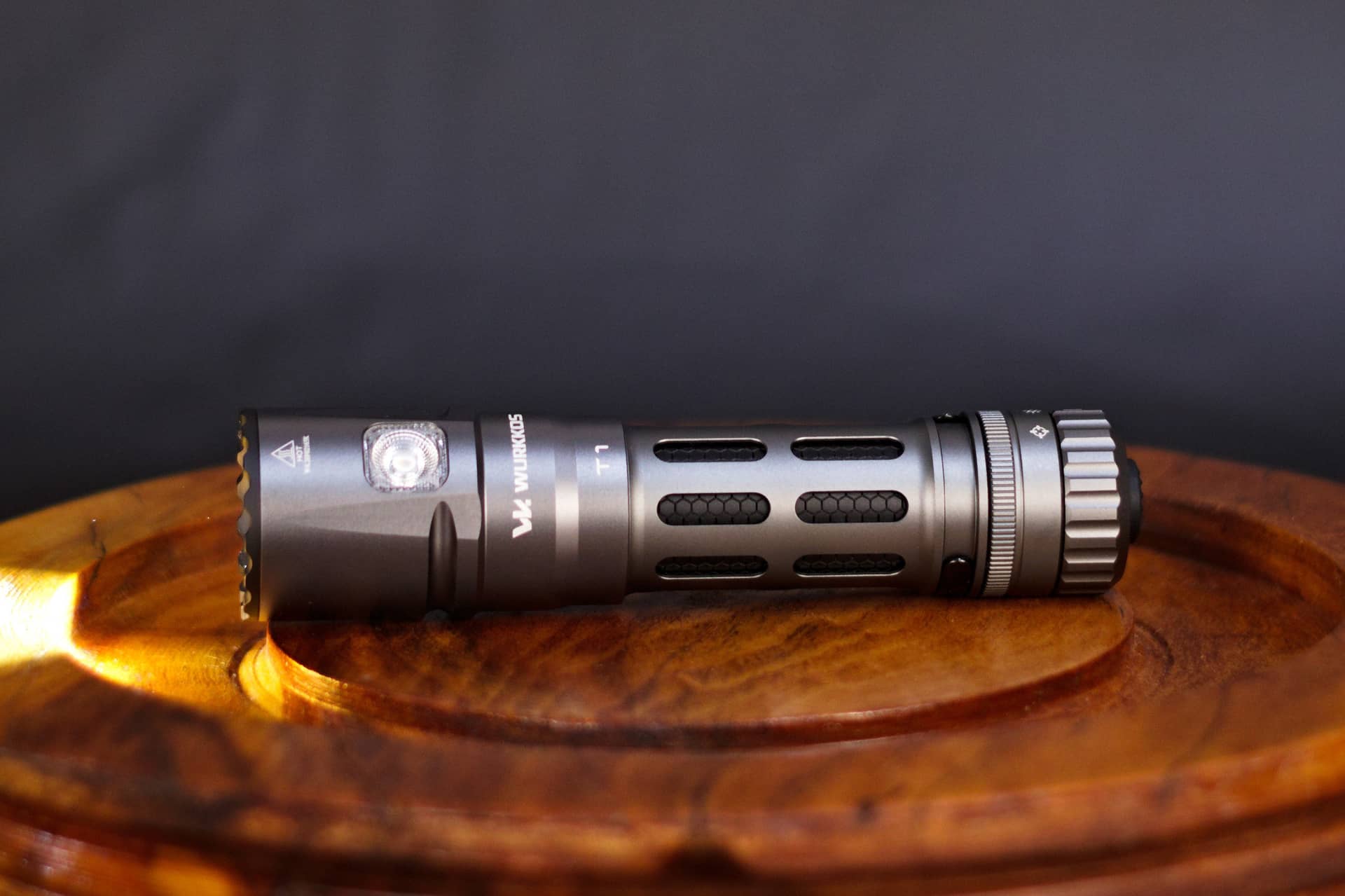

Main body/Grip: The main body is pretty smooth with almost no grooves or knurling. The tail cap has some knurling on the mode selector and near the clip. The battery tube has some “holes” where it’s possible to see the inner aluminum tube that makes contact with the driver, I think this makes the flashlight a little more fragile than necessary.
Material: The flashlight main body is entirely made of 6061-T6 Aluminum alloy. The bezel is made of stainless steel with a matte black coating.

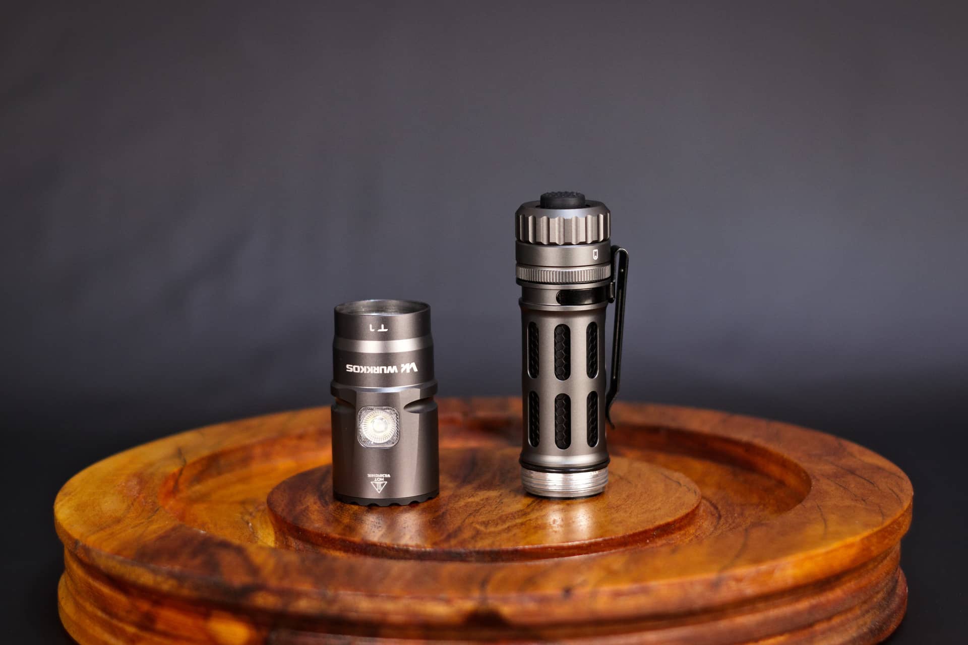

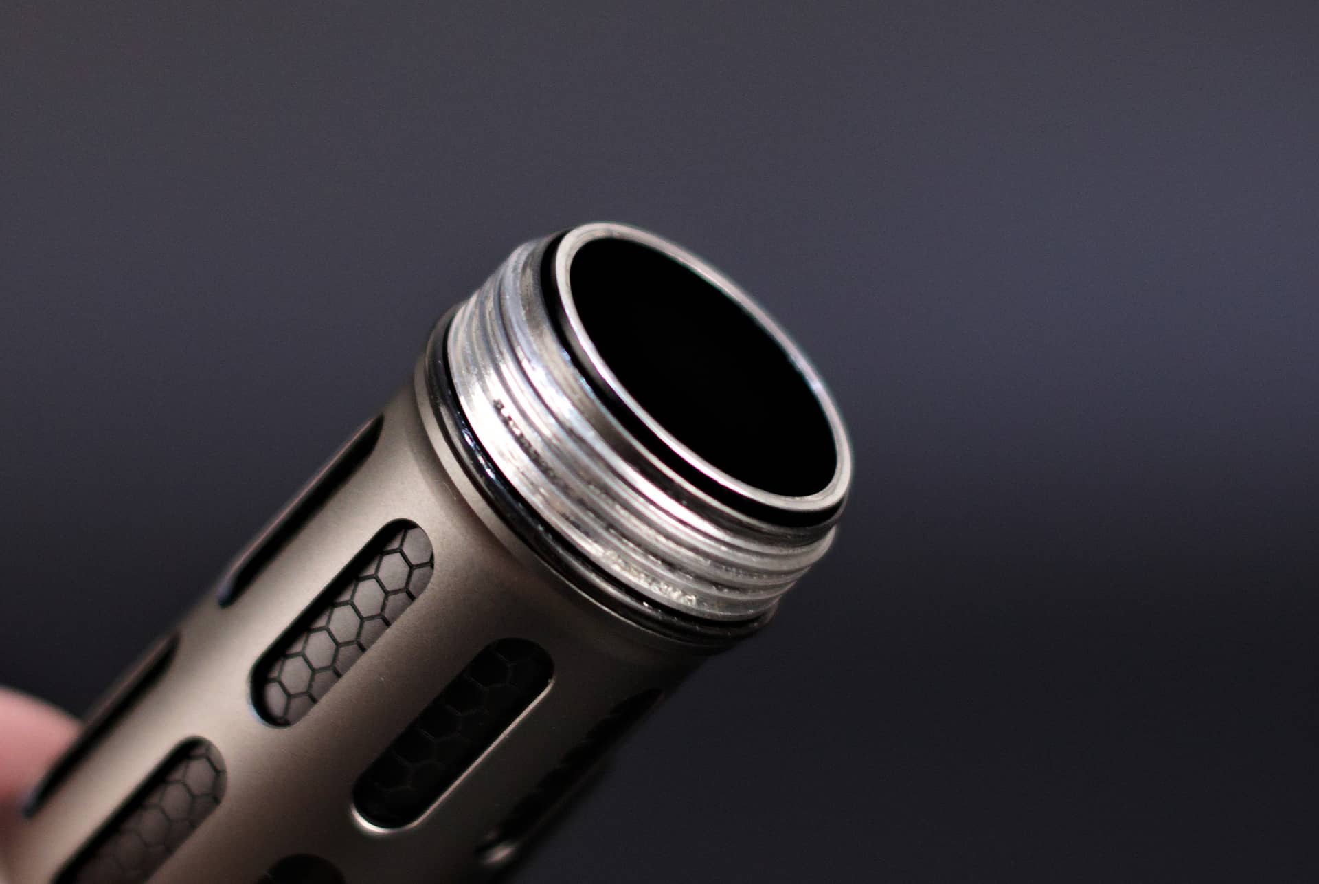

Threads: Only the battery tube side that makes contact with the driver is unscrewable, it has un-anodized squared threads.
Clip: T1 comes with a stainless steel clip with a glossy black coating installed on it. Pretty default clip. Clips well.

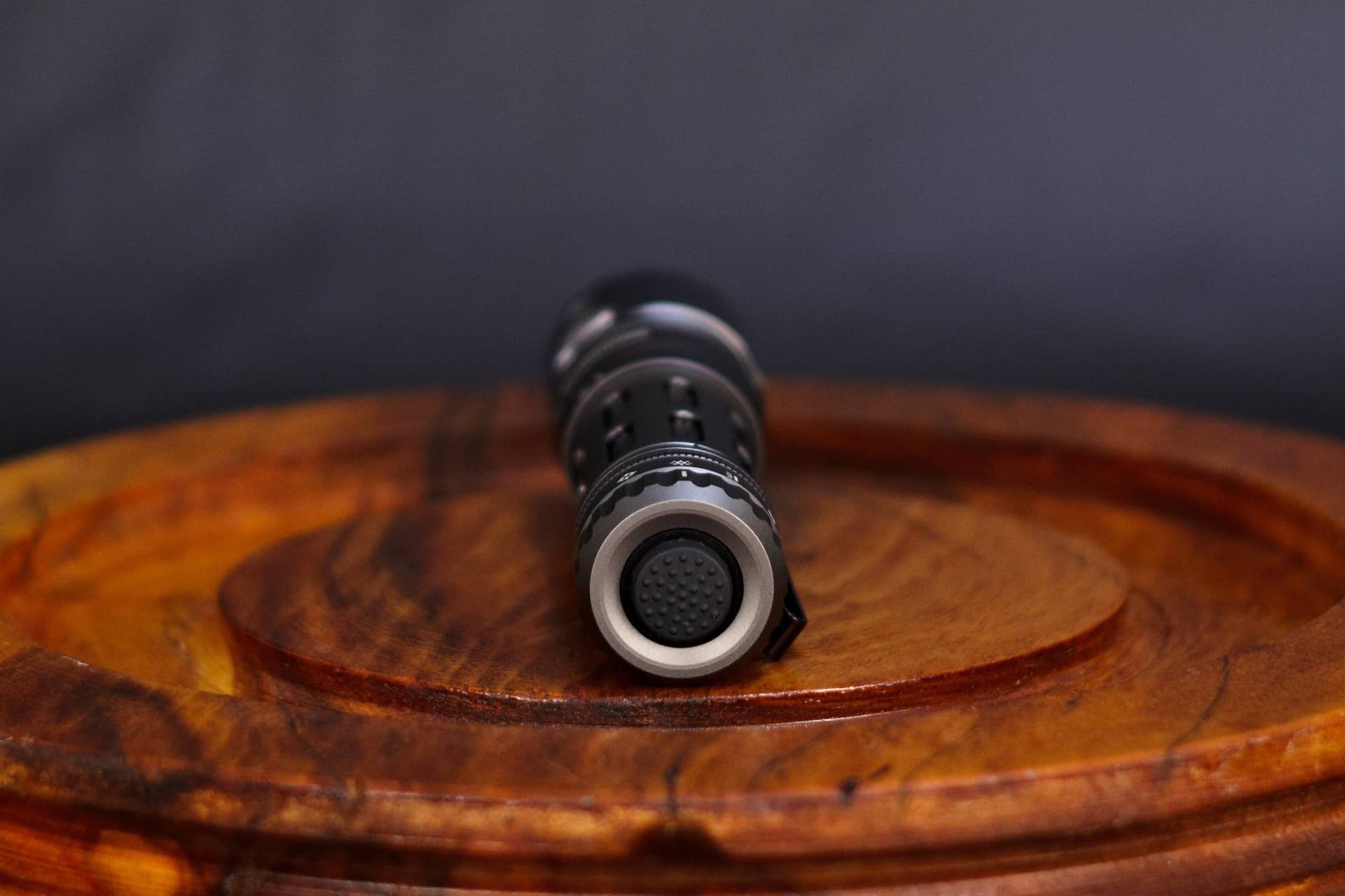

Tail stand and rolling: The flashlight doesn’t roll much as the grooves on the mode selector prevent it. It can head stand, but tail stand is not possible due to the button sticking out of the tail cap.
Magnet: Doesn’t feature a magnet.

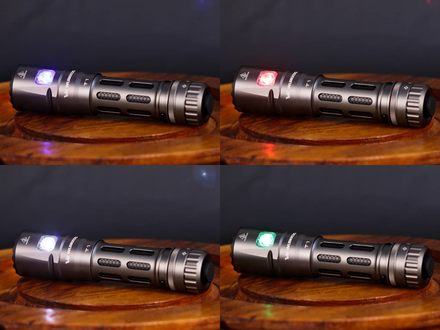

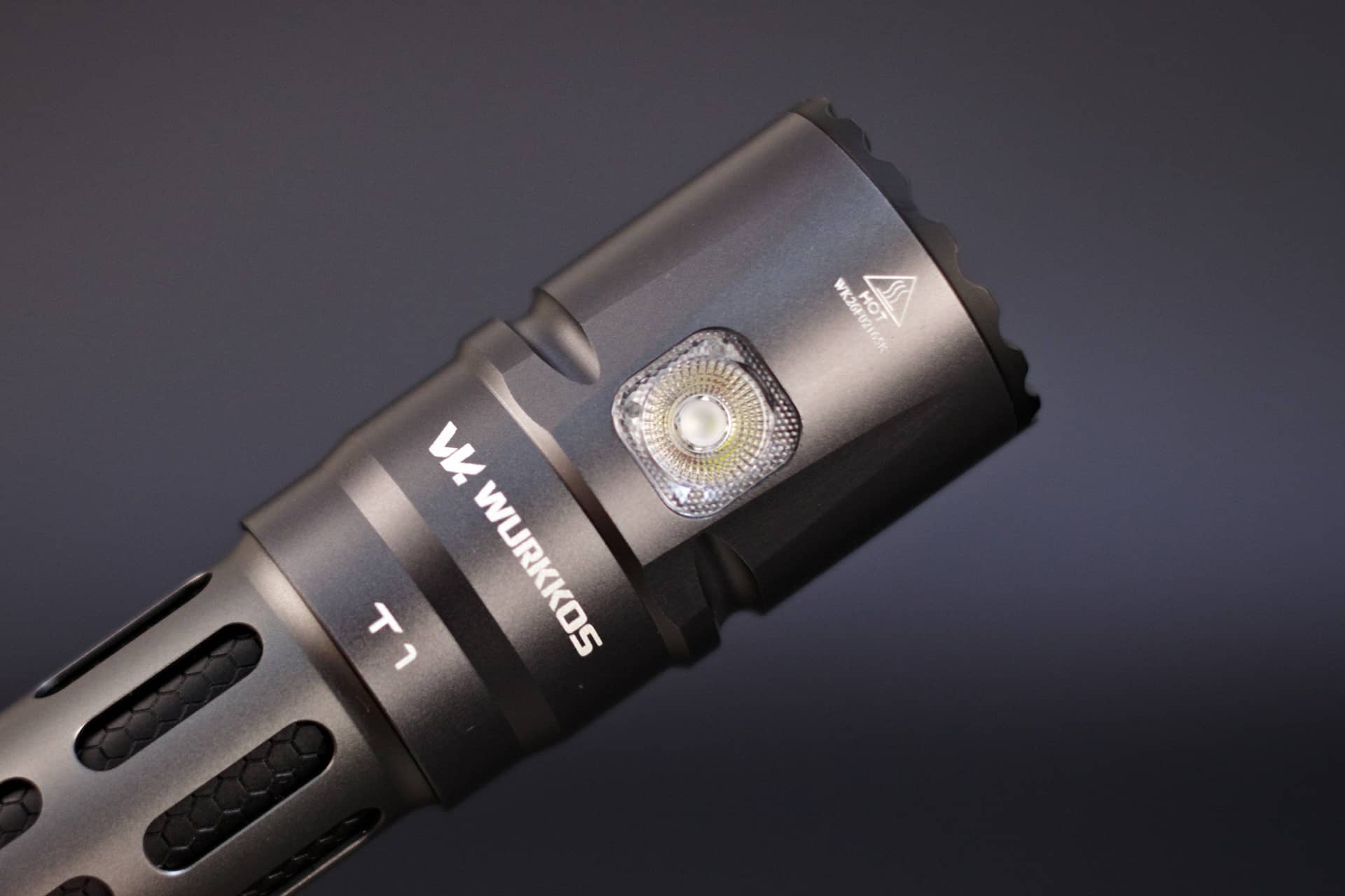

AUX lights: The T1 features a color battery indicator and a side light on the main body that can be set to white, red, green, blue and some blinking modes. The side light are actually powerful for it’s size, with near 100 Lumens on the high color modes. The red, especially, is useful for camping to not draw insects attention.

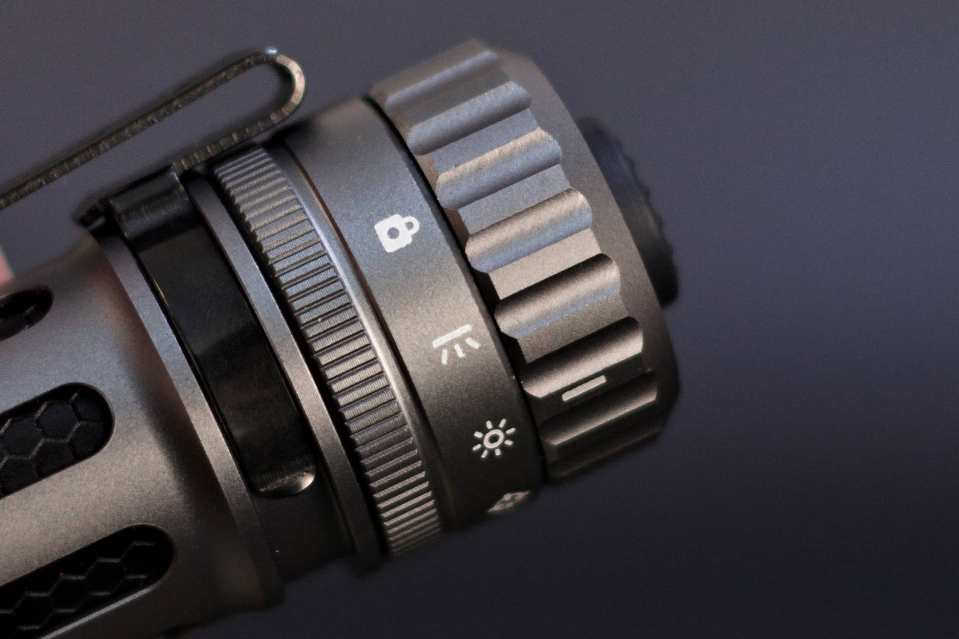

Buttons: It features a mechanical switch on the tail cap for turning the light ON/OFF and cycling between brightness levels and also a magnetic rotating selector - which I think is too easy to miss the right spot to select a mode - for changing the operation mode. The tail mechanical switch has a pretty interesting feature, it has a half click without going all the way down, just a little touch on the switch and it cycles brightness levels.

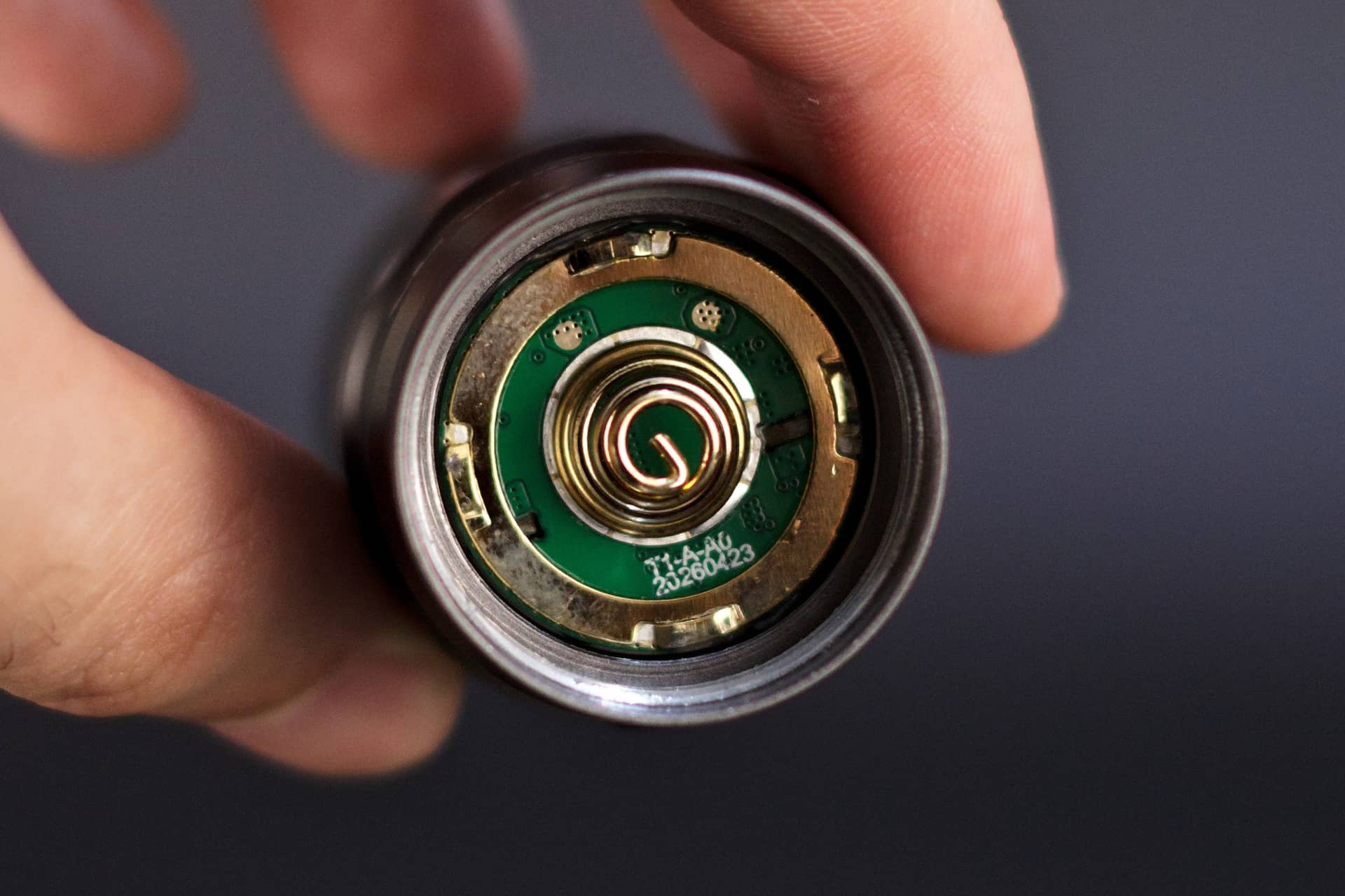

Battery contact: Contact is made with the battery by 2 gold-plated springs, one at the tail cap, the other at the driver PCB.

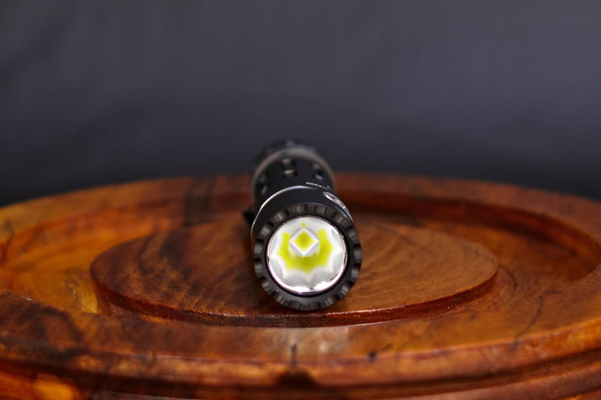

Bezel: The bezel is a slightly agressive bezel , it’s crenelated with rounded trapezoidal shapes and is made of stainless steel with a matte black coating. It came very tight to unscrew on my unit, but it isn’t glued.
Water Resistance: It’s advertised and graded to have the IPX8 water resistance rating. The tail cap is locked by glue and seem properly water sealed, the battery tube and bezel threads have O-rings for water protection, and the USB-C has a silicone gasket.

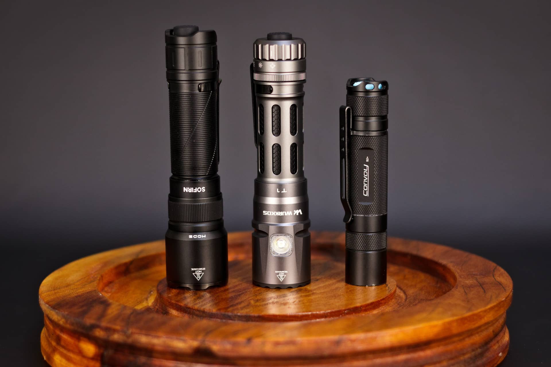

Size comparison: On the left is the Sofirn SK31 (21700), on the middle the Wurkkos T1 (21700) and on the right the Convoy S2+ (18650).

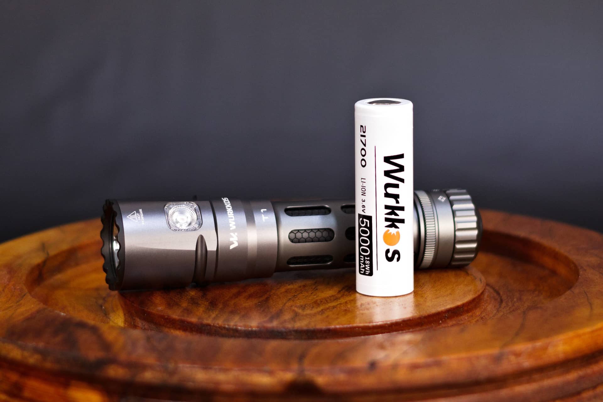

Battery: The T1 is powered by a single 21700 battery. It comes with a Wurkkos 5000mAh Li-ion battery on the box. The included battery has 10A CDR and 15A maximum peak discharg - as this light has the Cree XFLSNA emitter and supposedly hit 5500 Lumens, I recommend using a battery with at least 20A of CDR, although the 15A peak might be fine for the small time it can sustain Turbo mode, but it probably doesn’t hit it’s full potential with the included battery.
Protected batteries or ones with USB-C doesn’t fit inside the battery tube.

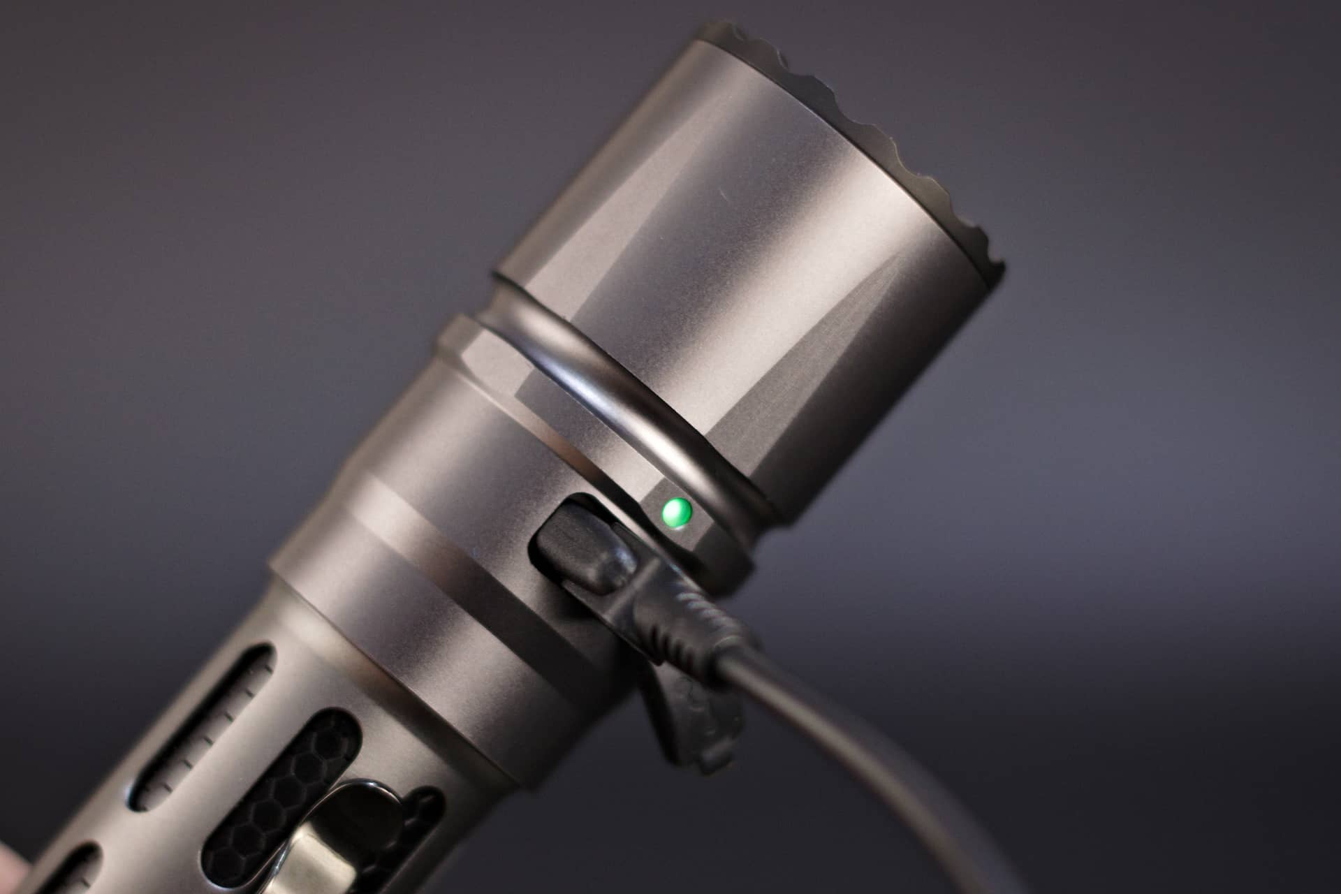

Battery Indicator: It features a color battery indicator right above the USB-C port on the main body - pretty important and useful feature.

Charging: The T1 features USB-C charging on body, the charging port is located on the opposite side of the side LED and covered by a silicone cover. It charges at 5V 2.4A maximum, taking around 2h30min to fully charge.

Lockout: Lockout is present on this light by twisting the magnetic selector to the lock icon - which is on the left side of the selector. On lockout, if you press the main button the battery indicator will show the battery level for 5 seconds, if you hold the button it will access Moonlight momentarily.

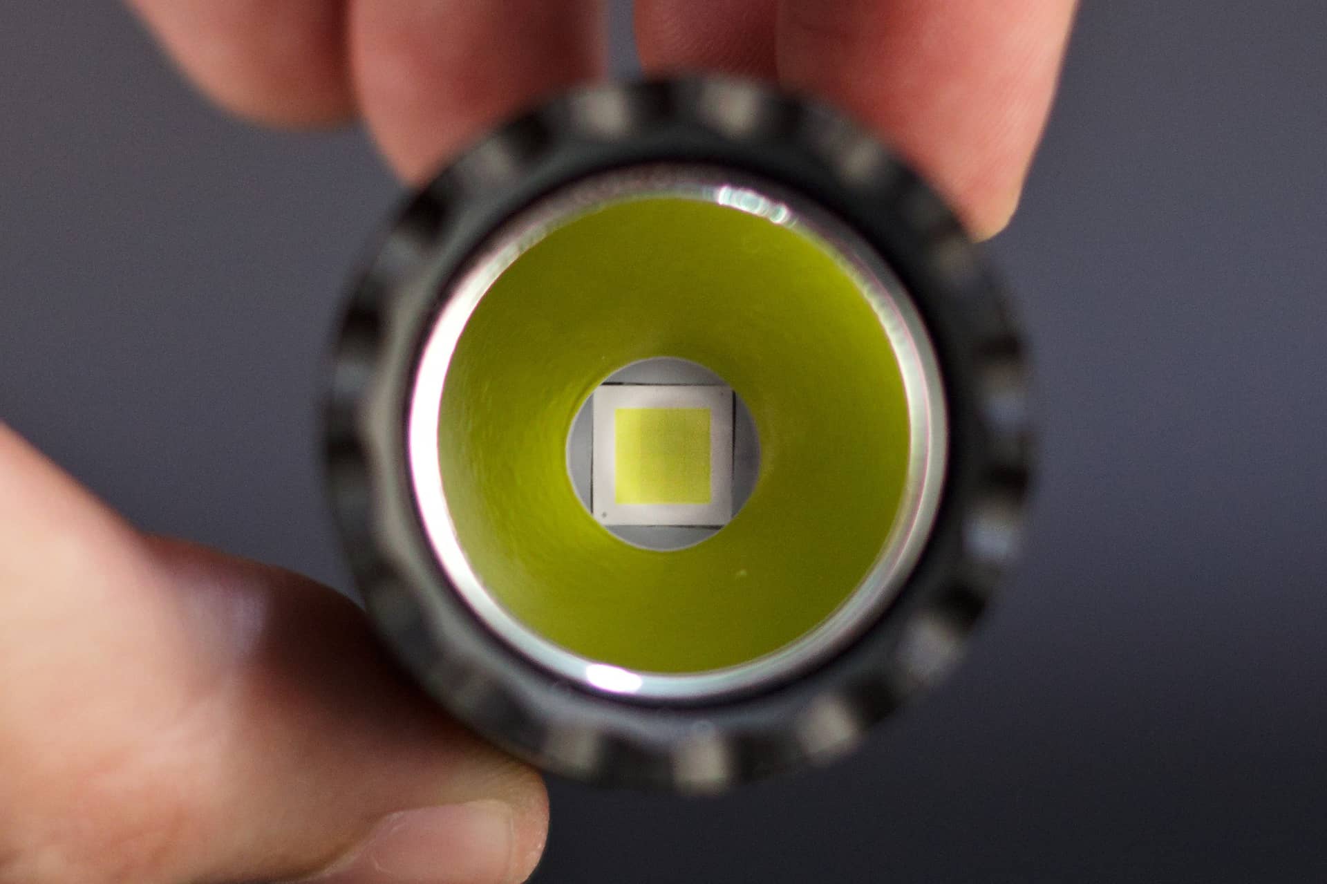

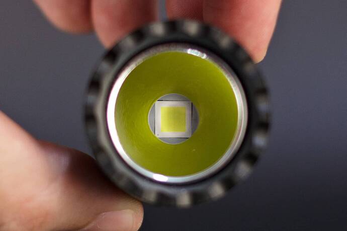

Emitter: The T1 uses a Cree XFLSNA in 6500K, this LED seems to be very similar - or even the exact same - to the LMP LHP73B in 6500K. I actually thought it had the LHP73B initially, and really, it’s the same LED. The beam pattern and all seems identical. Pretty efficient LED, very high brightness and generates a lot of heat when pushed near it’s limit.
Lens: It has an AR coated glass lens in front of the reflector.
Reflector/TIR: It uses a 28.6mm Orange peel reflector.
Beam profile: The beam has a central hotspot with a smooth transition to the spill some small artifacts and small light rings.

The confusing part is the side light UI, holding a half click turns it ON on white, continue holding to cycle (White - Red - Green - Blue); a fast half click cycles brightness level (Low - Medium - High); a full click goes to the blinking modes, on the blinking modes a half click cycles (Police strobe - red SOS - red beacon). I think the side light UI is very weird and confusing, it would be better to have the solid color modes on the full click than the blinkies, for example.
