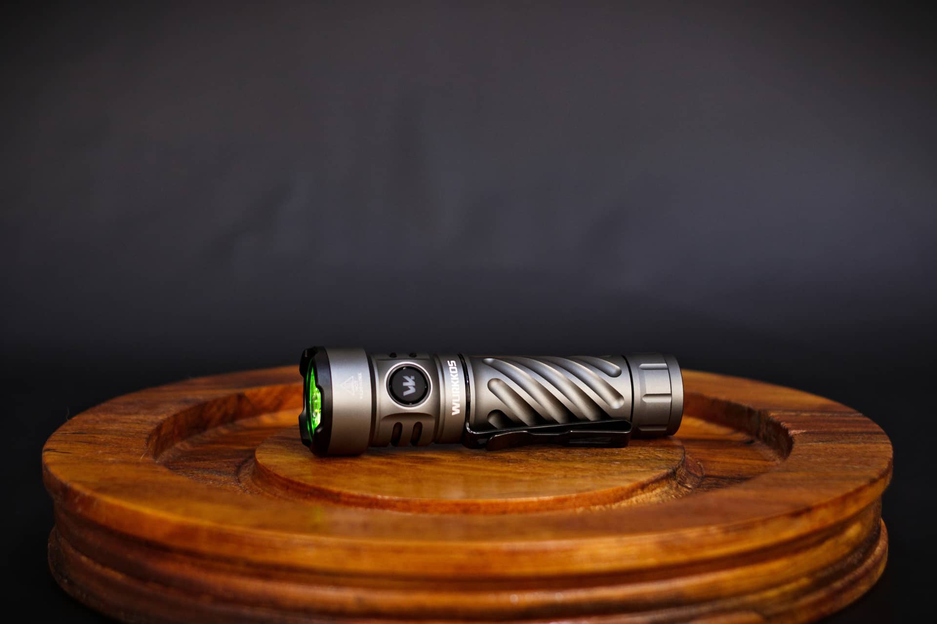

This is the Wurkkos TS26, but they tried to fix it! It now features Nichia 519A LEDs in 5000K instead of the older model TN3535 6500K! Sadly, some problems still remain, but the 519A emitter really improved this light. It features a Boost driver, USB-C charging on body, RGB AUX on TIR and more!
• My opinion
The addition of the 519A LEDs to the TS26 was a big improvement, the TN3535 emitters were not bad, but not suitable - in my opinion - for an enthusiast focused flashlight. All the rest of the flashlight seems to be the same as the older model, so it still has the Boost driver problem which causes the candle-like flickering on modes between 1/150 and 5/150, every other mode doesn’t seem to have PWM and flickering, and the driver works efficiently on the higher modes.
My suggestions to improve this flashlight would be more anodizing colors, driver capable of sustaining 1 Lumen or less without flickering and adding AUX lights to the main button - there are already LEDs there, why not make it have an AUX?

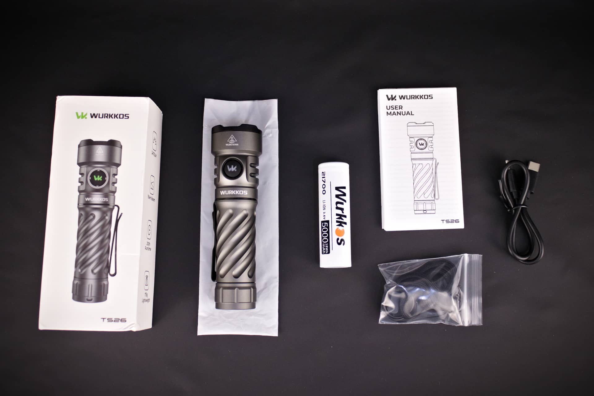

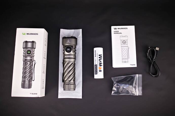

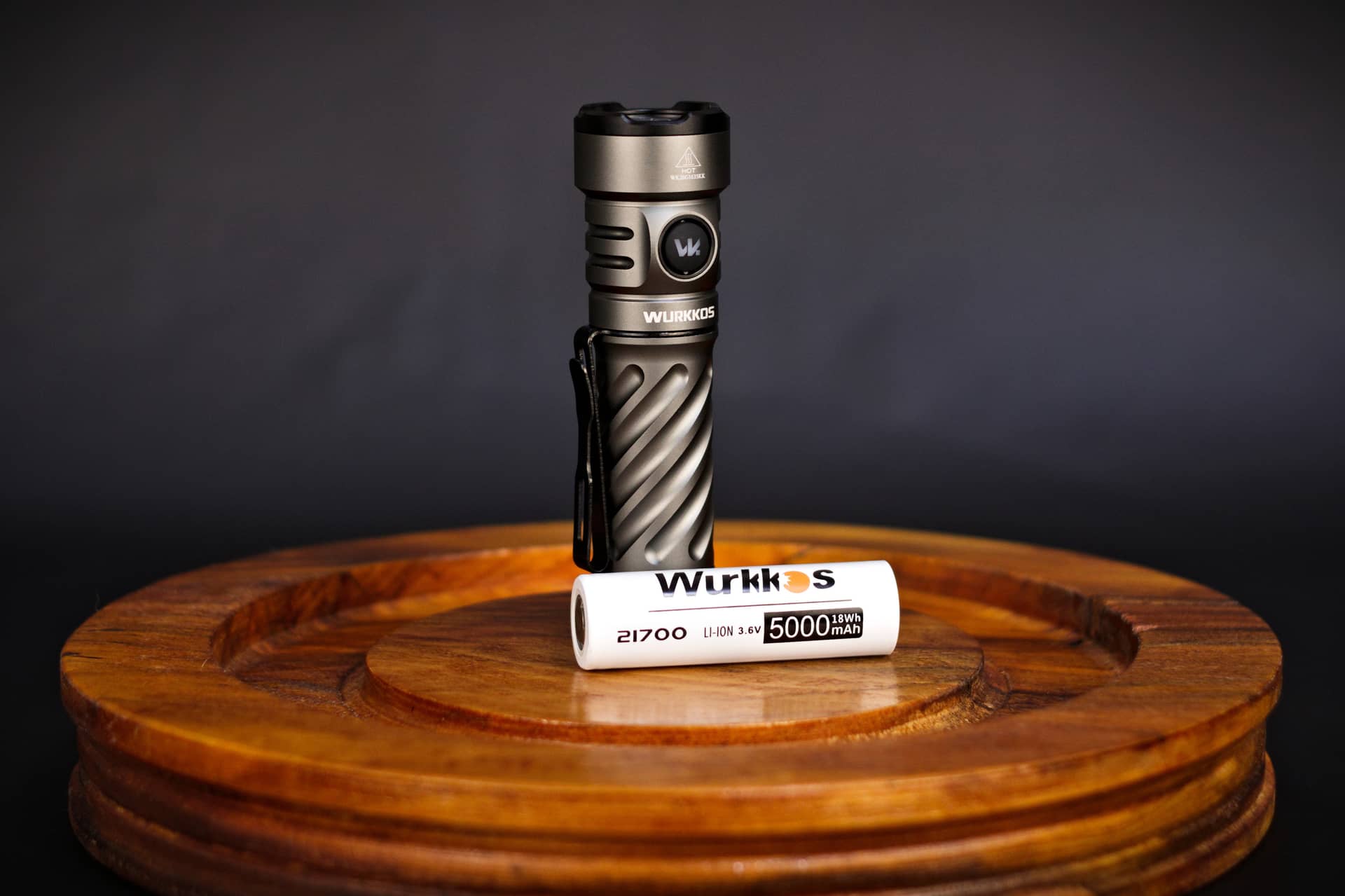

• Box contents
- Wurkkos TS26 519A
- Wurkkos 21700 5000mAh Li-ion cell
- USB-C to C charging cable
- Lanyard
- 2x extra O-rings
- User manual

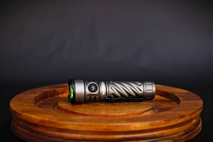

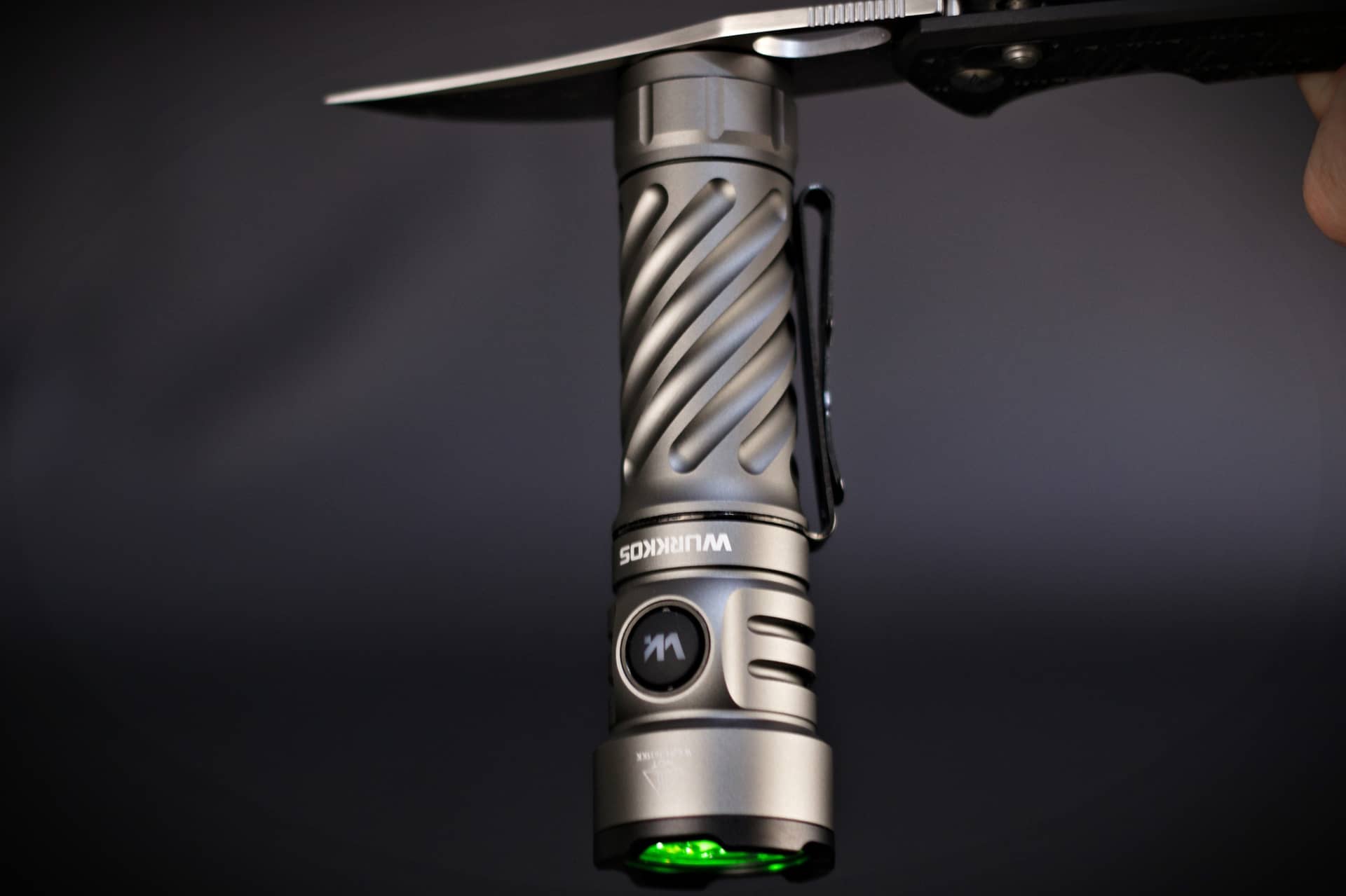

• Body and build quality

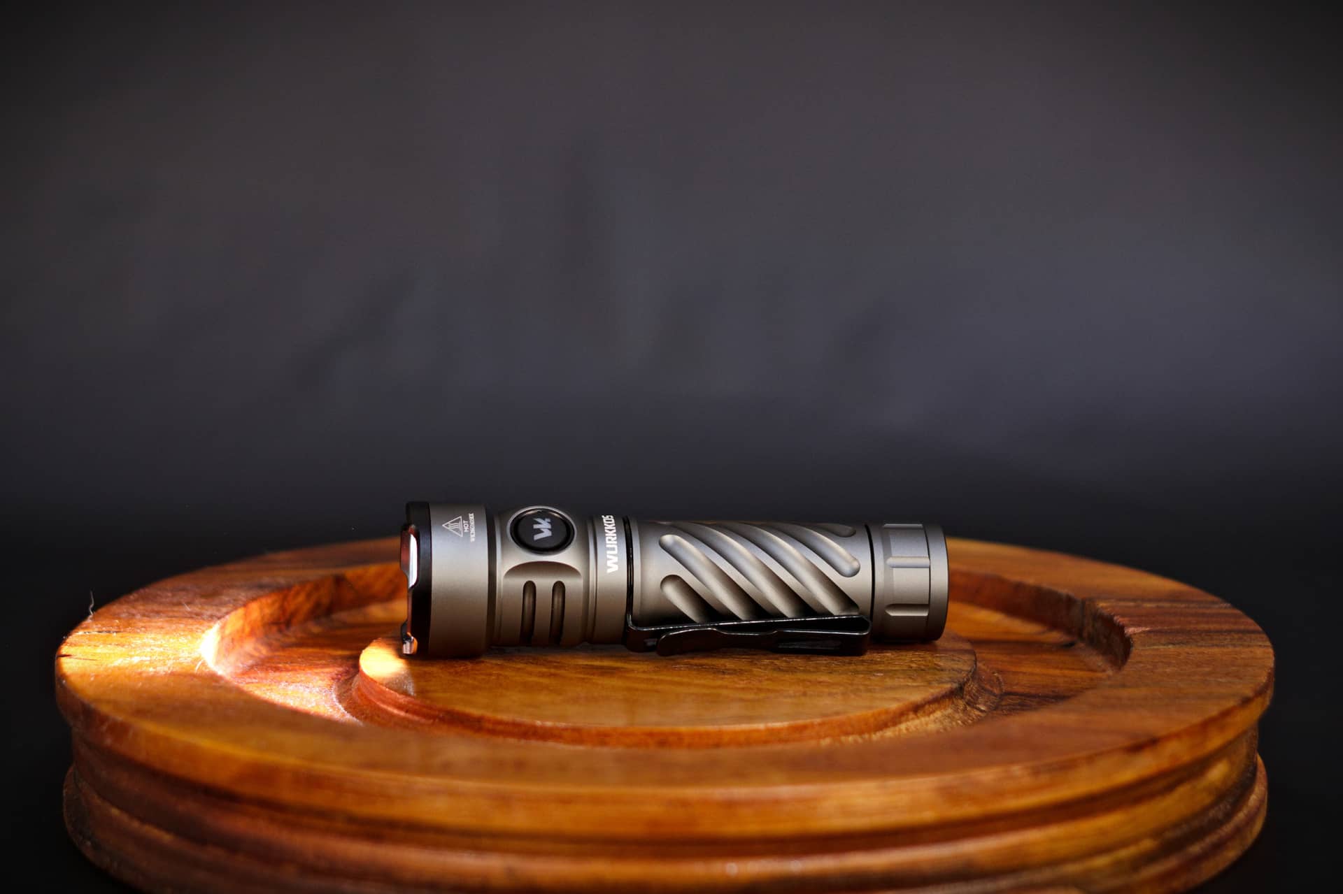

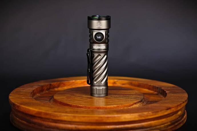

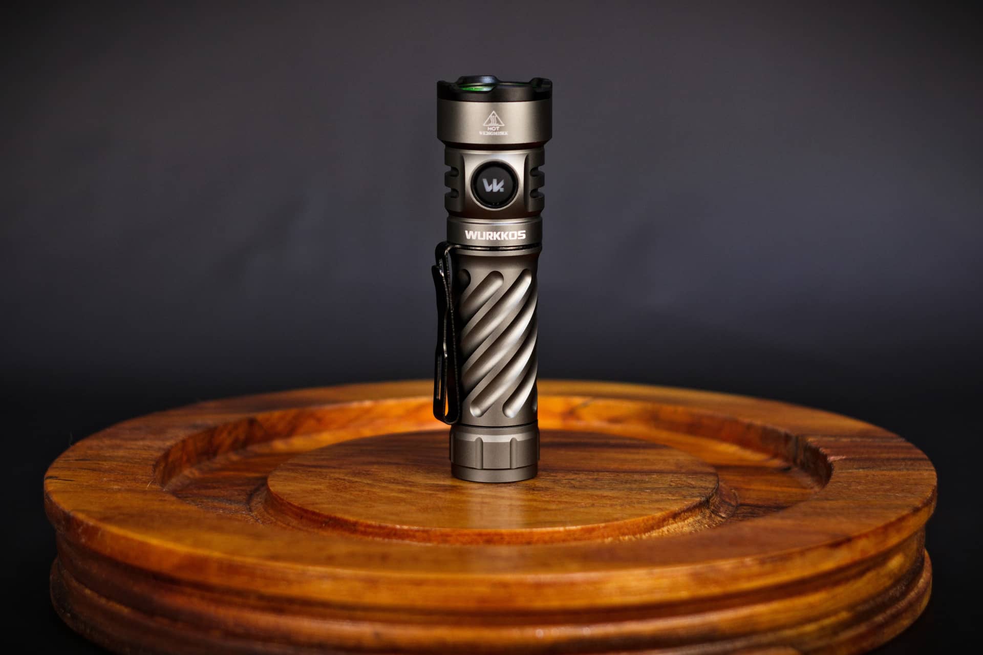

Anodizing Colors/Material Options: The TS26 is only available in 6061-T6 aluminum with gray anodizing - most probably type II anodizing to have the gray color.

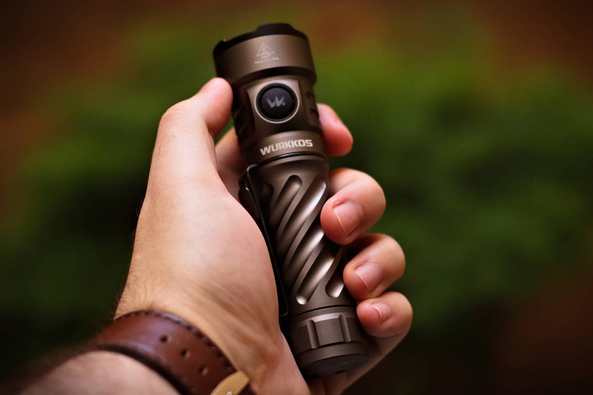

Main body/Grip: The battery tube has smooth round cylindrical grooves that improve grip, the head part has head dissipation grooves - they are kinda sharp on my unit. The main body general shape and size are pretty good.
Material: The main body os almost entirely made of 6061-T6 Aluminum alloy, with only the bezel and clip being made of stainless steel with a black coating.

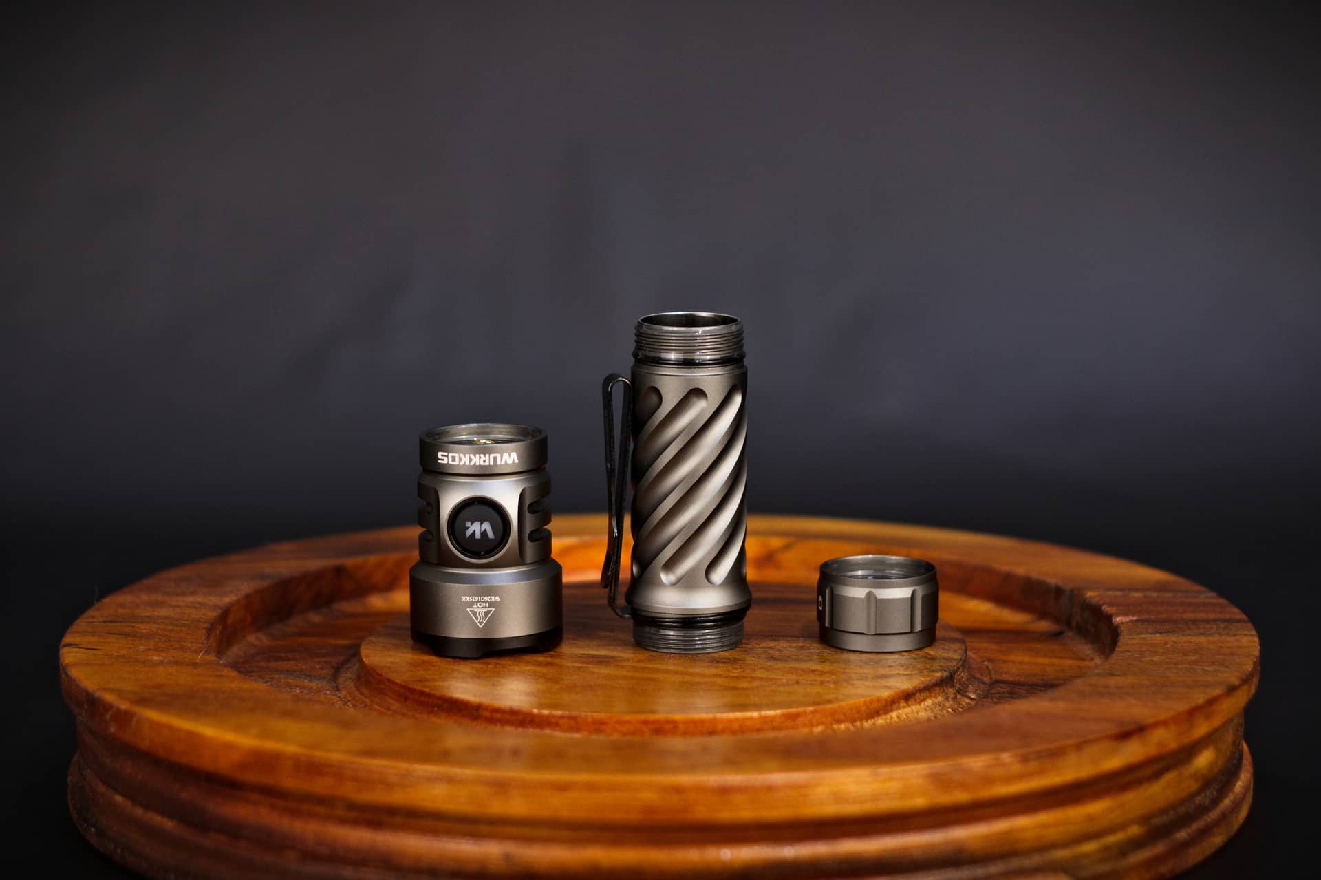

Threads: Both threads of the battery tube are anodized, the tail cap threads are squared and the head threads are the standard thinner threads.
Clip: The head part of the battery tube has a dedicated O-ring to make sure the flashlight is waterproof when the clip is installed. The clip can only be placed on the head part of the battery tube, it’s not possible to place it on the tail cap.

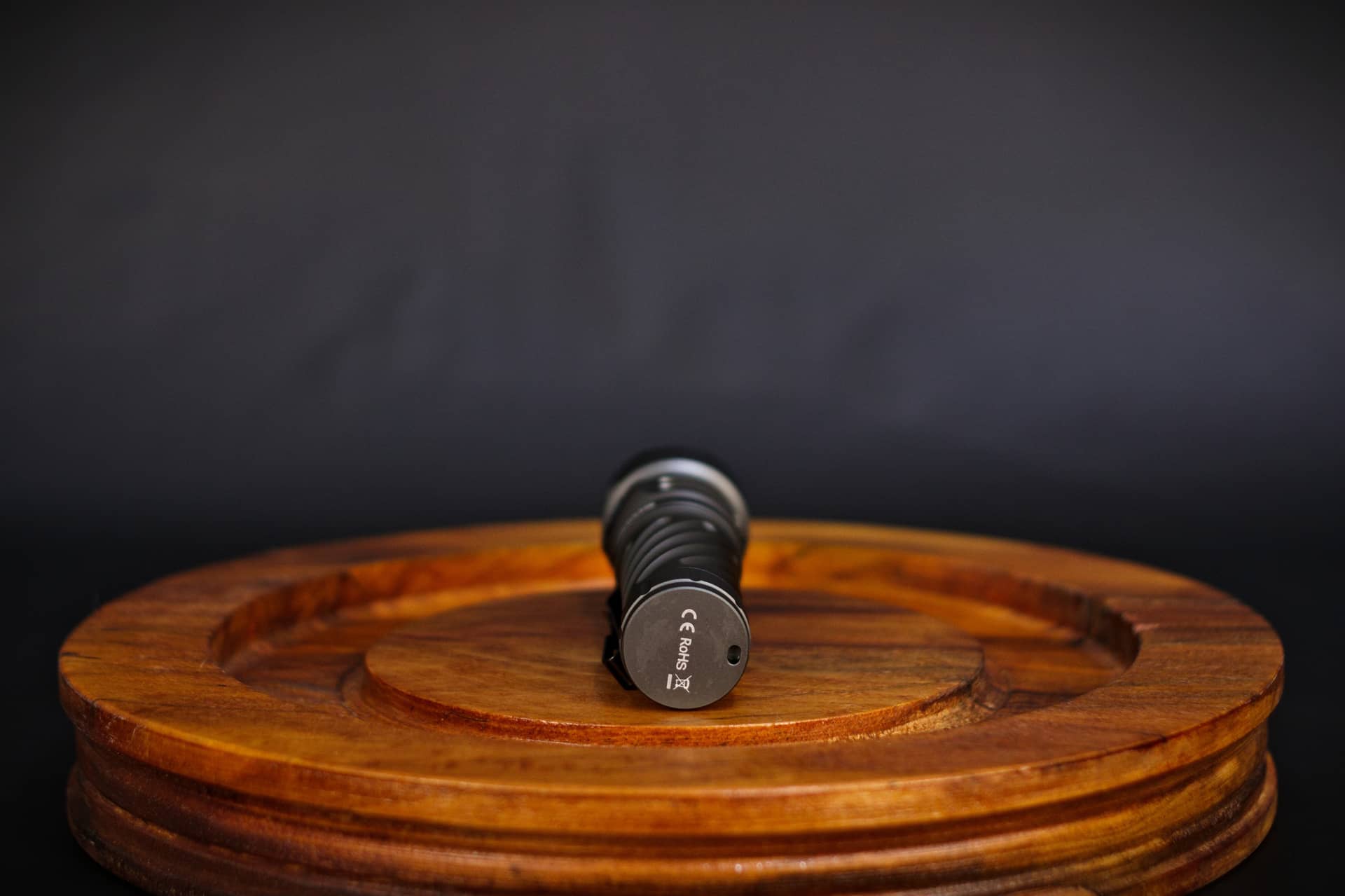

Tail stand and rolling: It can tail and head stand without any problems. The flashlight can roll a lot without the clip, so be sure to use it if you don’t want your light rolling around.

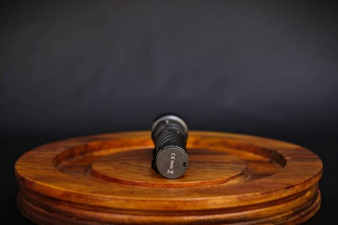

Magnet: This light features a magnet on the tail cap, it’s strong enought to hold the TS26 on most metal surfaces, even horizontally if there is enough metal for the magnet to lock in!

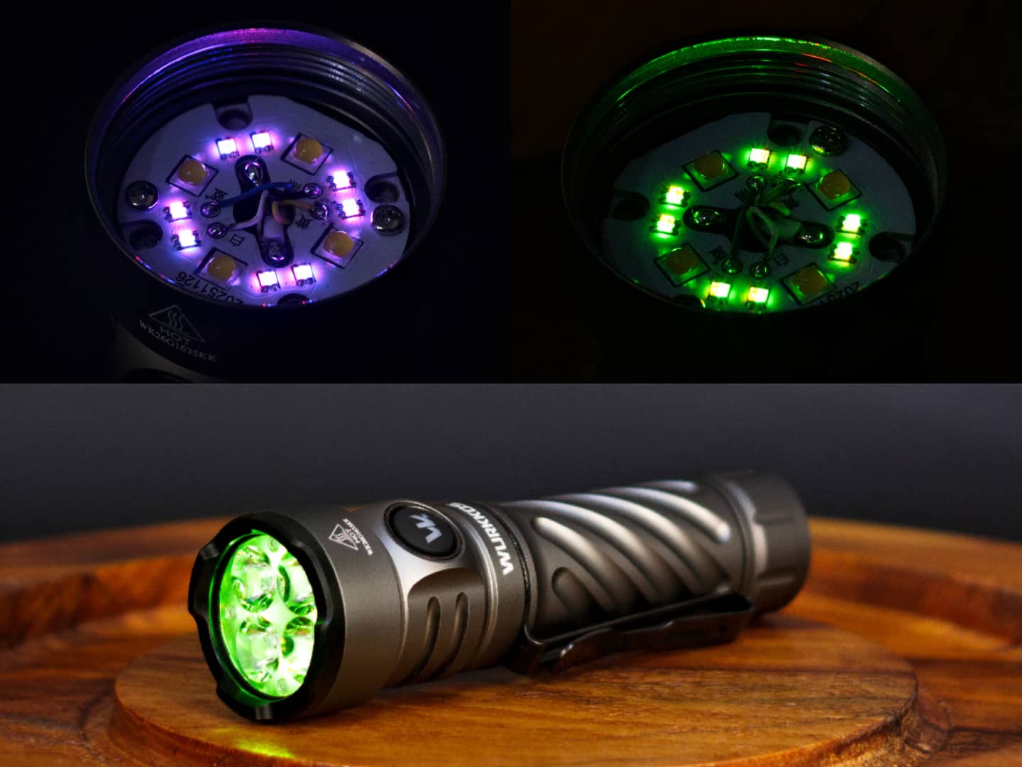

AUX lights: TS26 has RGB AUX lights on the TIR lens - and also on the main button but, sadly, those are only to indicate charging. The TIR AUX can be configured by Anduril UI to match your taste, pretty important feature on Anduril flashlights. It could have proper AUX on the main button as an improvement.
Buttons: There is a single button on this flashlight - like most Anduril flashlights - it fully controls the flashlight with the Anduril 2.0 UI. It’s an e-switch covered by a black silicone boot with the Wurkkos logo in transparent

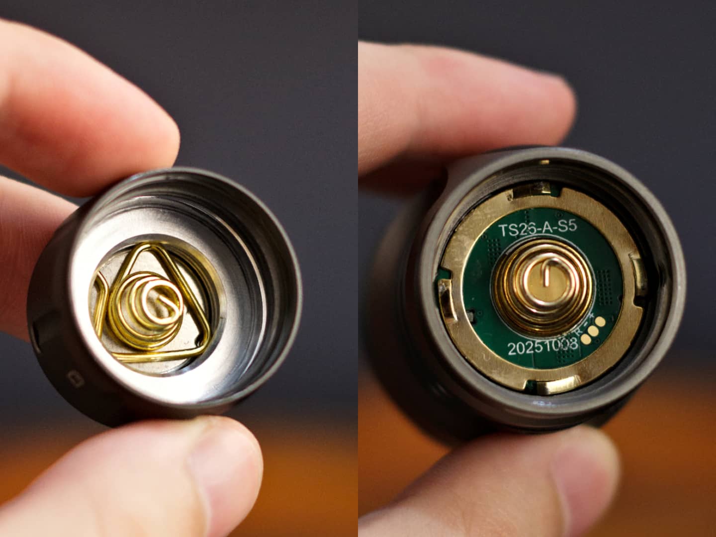

Battery contact: Contact is made with the battery by two gold-plated springs, one on the driver and the other on the tail cap.
Bezel: The bezel is crenelated with 4 protruding trapezoidal shapes, made of stainless steel and has a black matte coating.
Water Resistance: It has IPX8 rating and seems well sealed on all potential water ingress points, O-rings on all threads, even a dedicated O-ring for the clip to make sure the light is water resistant with it, the USB-C port has a rubber cover to protect it.

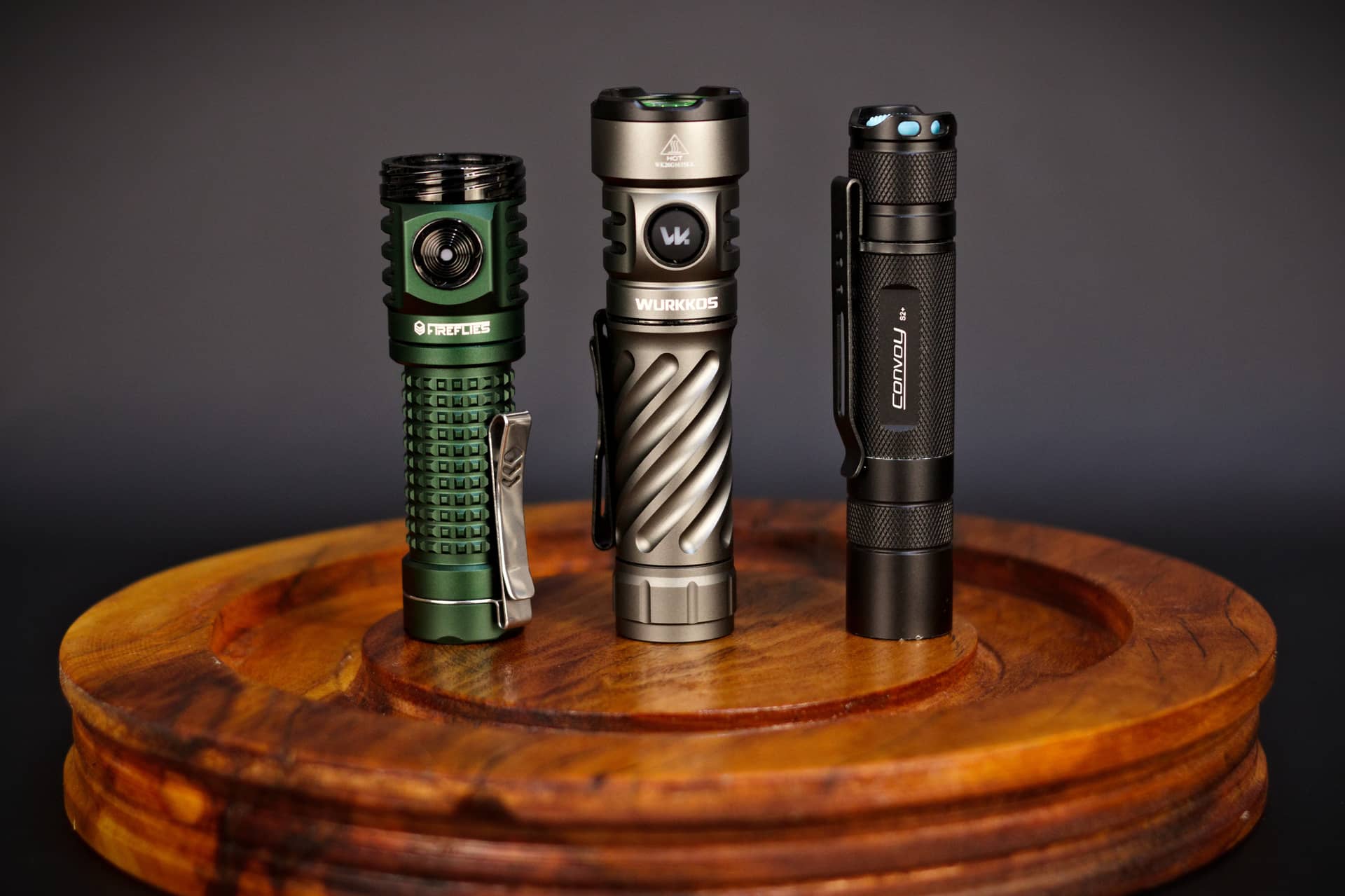

Size comparison: On the left the FireFlies X4 Stellar, on the middle the Wurkkos TS26 519A and on the right the Convoy S2+.

Battery: The TS26 is powered by a single 21700 battery, it comes with a Wurkkos branded 21700 with 5000mAh and 10A CDR (Constant Discharge Rate) with a 15A maximum peak. Button top cells also work with it, but protected cells are not compatible as they are too long to fit inside the flashlight.

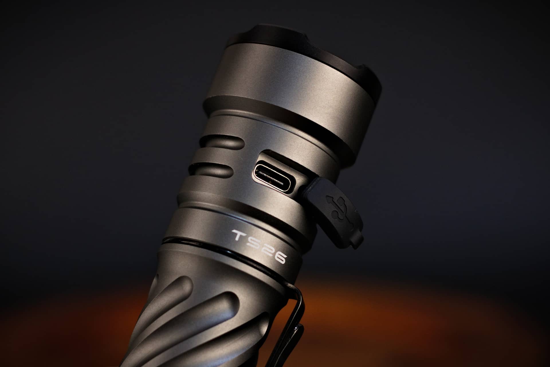

Charging: The TS26 features charging on the main body, on the opposite side of the main button. It’s protected by a decent thick rubber cover. When charging the button light will be flashing green, when the charge is complete it will become solid green. When you unplug the charging cable the button will light up blue, if it’s fully charged it will be solid bright blue, if the battery is low when you unplug it will be flashing blue.

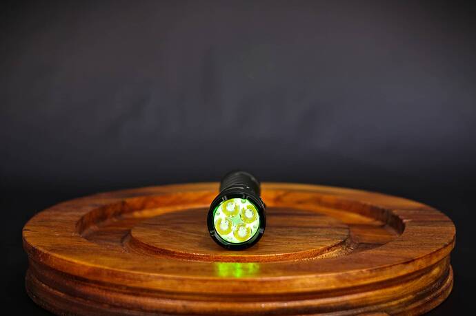

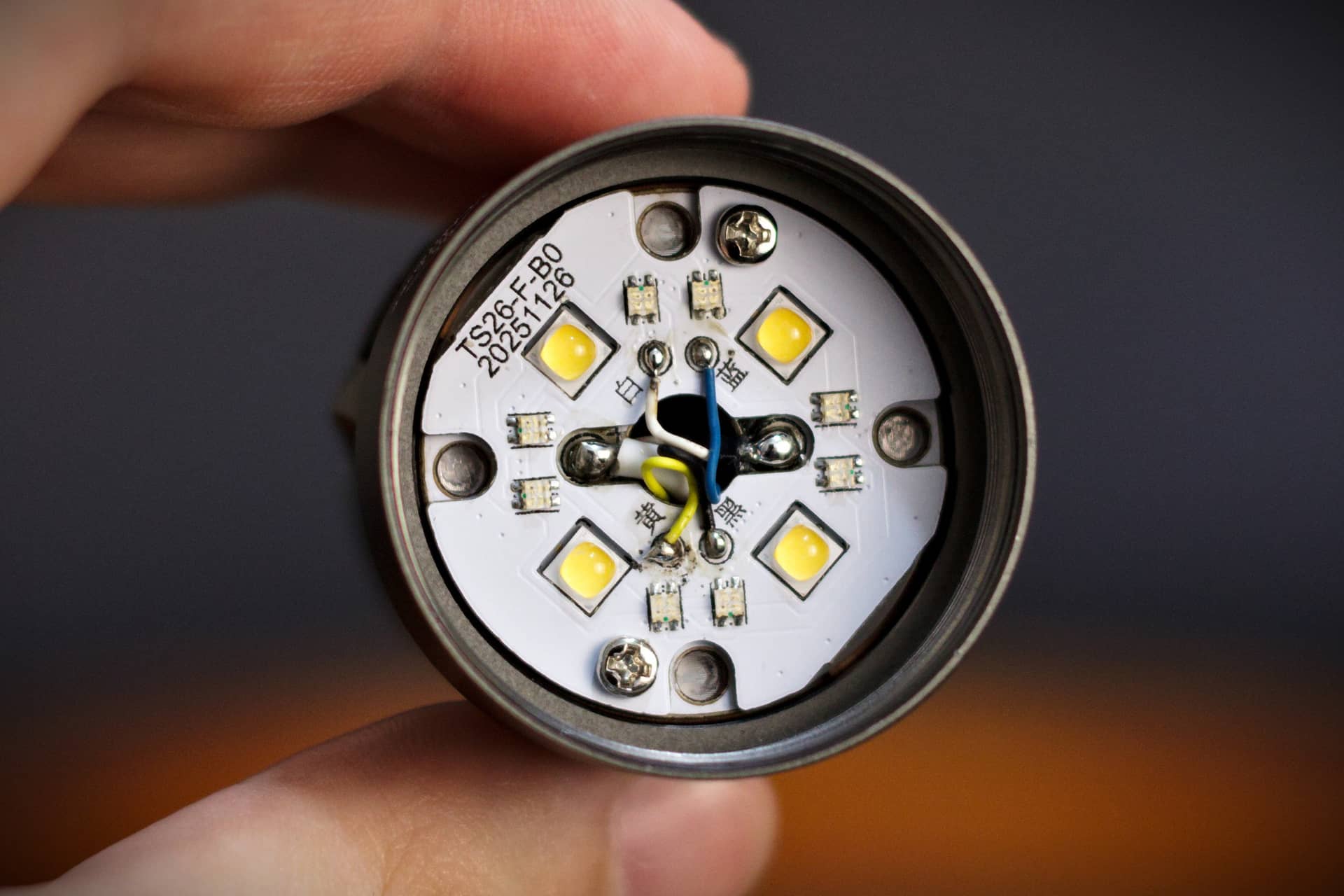

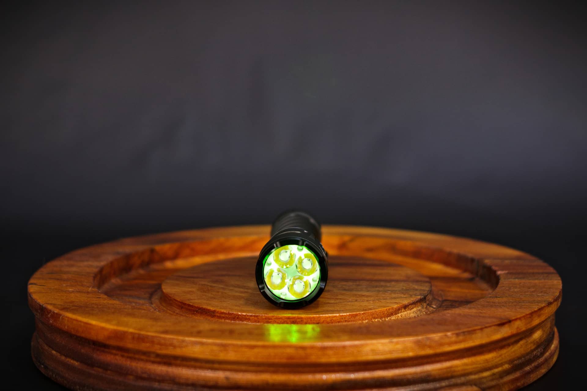

Emitter: This version of the TS26 fixed one of the major “problems” with the old version, the LEDs. This version - as you probably already noticed - has 4 Nichia 519A emitters in 5000K, with excellent neutral tint and CRI.
Lens: The TS26 uses normal glass lens, it doesn’t seem to have AR coating.
Reflector/TIR: The TIR is frosted right above the LED, clear around it and frosted again on the outer part.

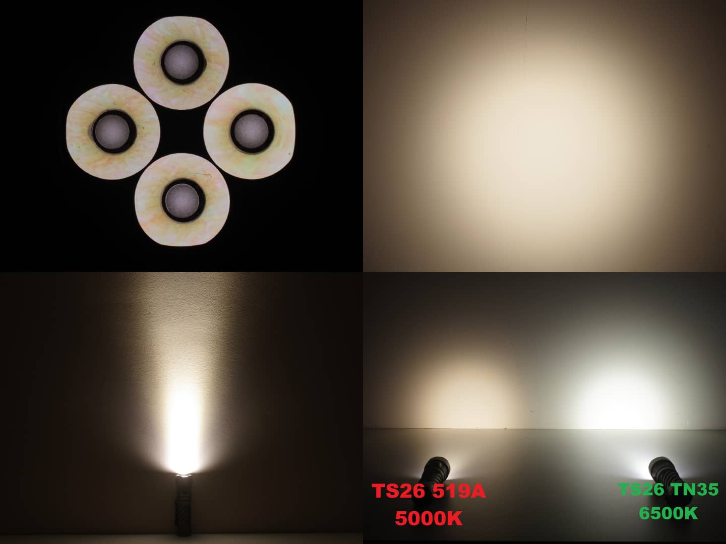

Beam profile: The beam is mainly floody, but still has a slithly defined hotspot that can throw a little.

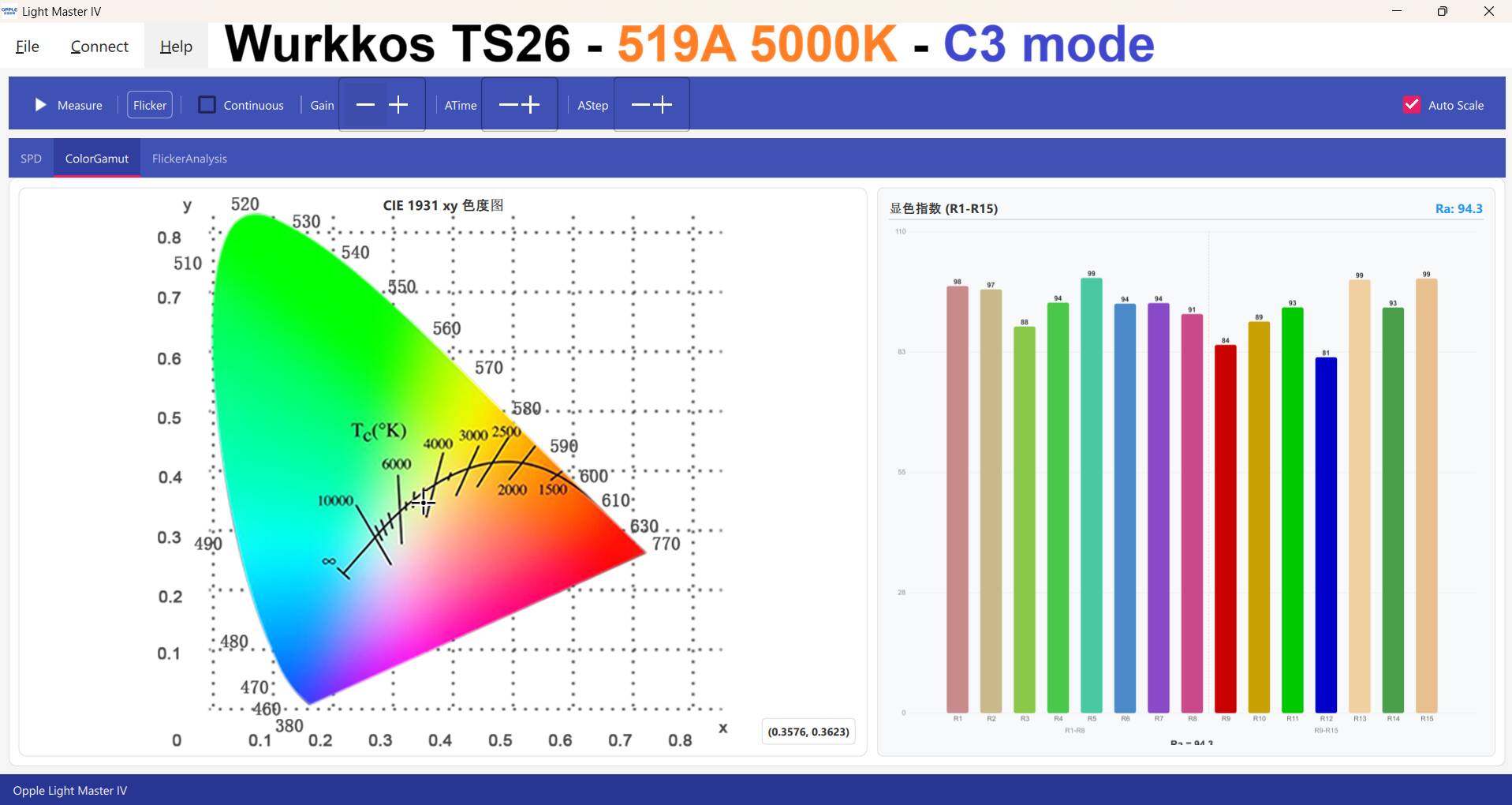

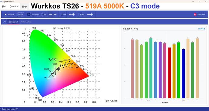

CRI: With the Nichia 519A 5000K the light should have 90 CRI and 80 R9. Measuring with an Opple LM4 on brightness level C3 I got 4600K, -0.0005 Duv and 94 CRI with 84 R9, pretty good results.

TS26 519A 5000K - H8 (Turbo)
TS26 519A 5000K - G7 mode

Driver: The TS26 uses a Boost constant current driver to power the 4x 519A LEDs. The driver seems to be the same from the older version, it’s efficient on medium and higher modes, but when I tried to lower the floor level between 1/150 and 5/150 clicks on Anduril UI I noticed the candle-like flickering problem (A problem that consists on the main light having a flickering similar to a candle on these lower modes). This problem is probably due to the driver not being fully capable of sending the pretty small currents necessary for a lower moonlight, any mode above the 5/150 clicks seem to work flawlessly, and the way the light cames pre-configured from factory has no flickering. *The candle-like flickering problem is cited on the user manual to be “normal”.
