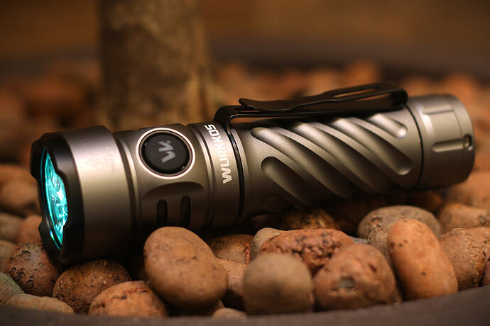

This is the Wurkkos TS26, a enthusiast focused flashlight with 4 TN-3535 LEDs, RGB AUX LEDs on the optics, USB-C charging and reverse charging, 21700 Li-ion battery, magnet on the tail cap and much more!

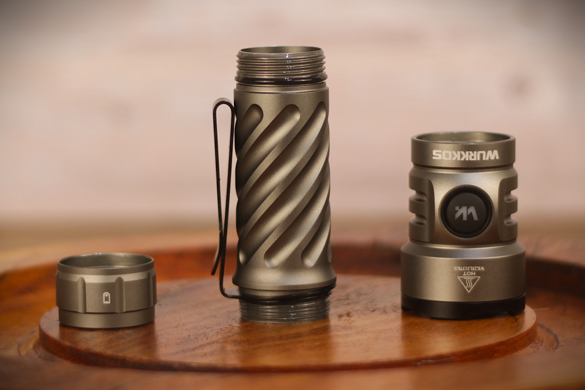

- Very easy to disassemble

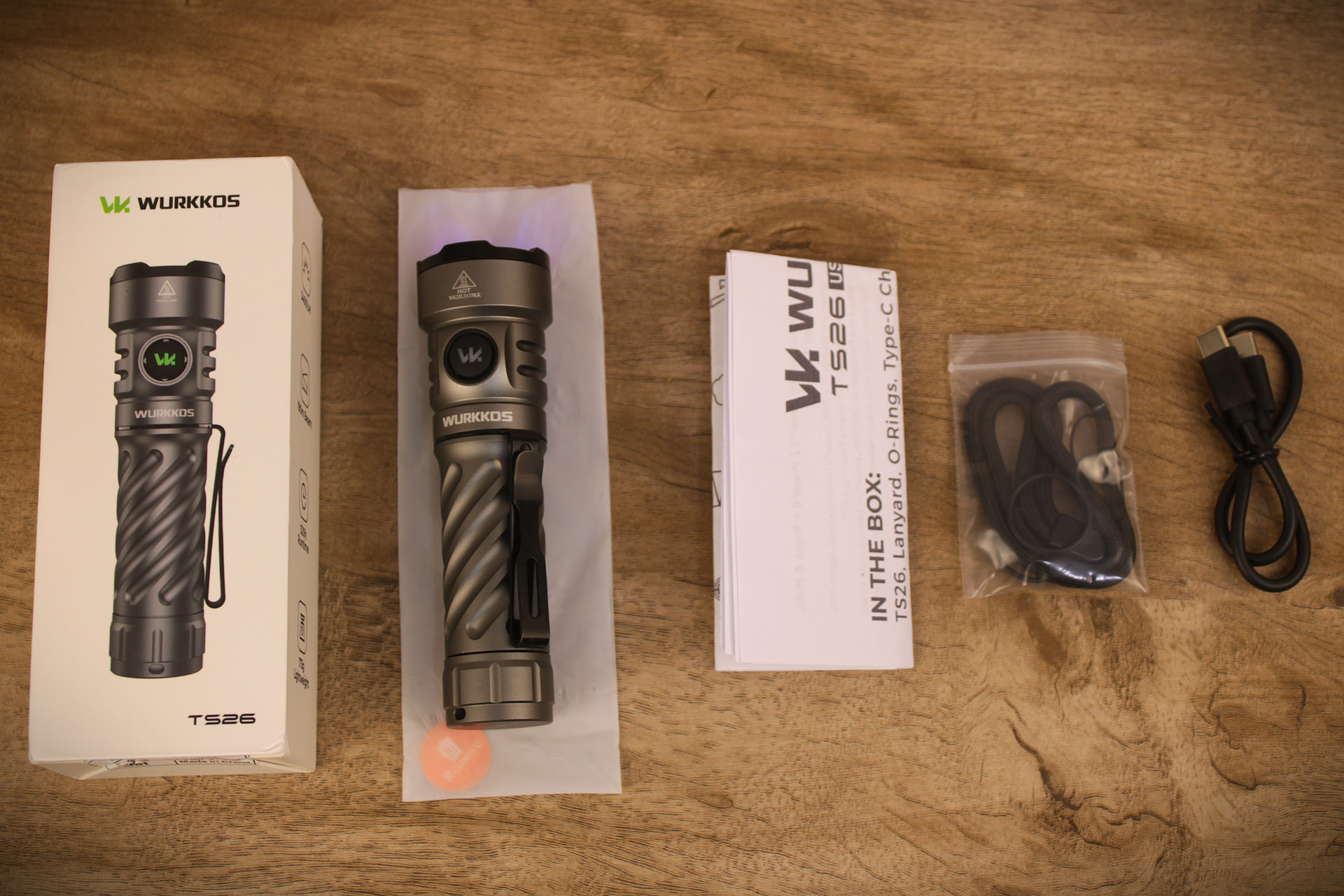

• Box contents
  • TS26
  • USB-C to C charging cable
  • Lanyard
  • 2x spare O-rings
  • Instructions manual

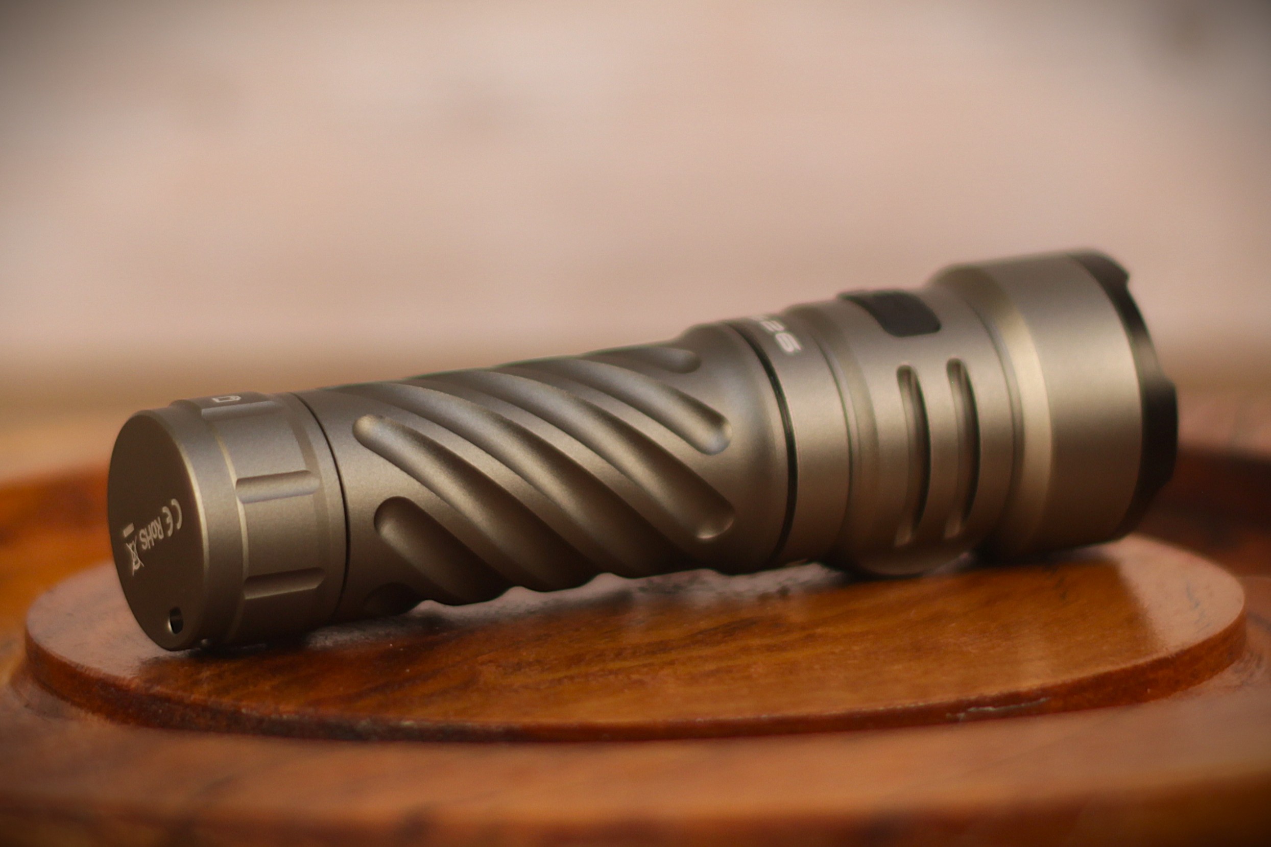

• Body and build quality
Colors/Material Options: This flashlight is only available in aluminum and grey “gun metal” anodizing
Material: The main body is made of 6061 hard anodized aluminum, the bezel and clip are made of stainless-steel with a black coating.
Threads: Both threads of the battery tube are anodized, the tail cap threads are squared and the head threads are the standard thinner threads.
Clip: The battery tube threads have a space for the clip to be inserted before screwing only on the head, the clip cannot be reversed! There is also an O-ring in contact with the clip ring, and another to prevent water in the flashlight tube.

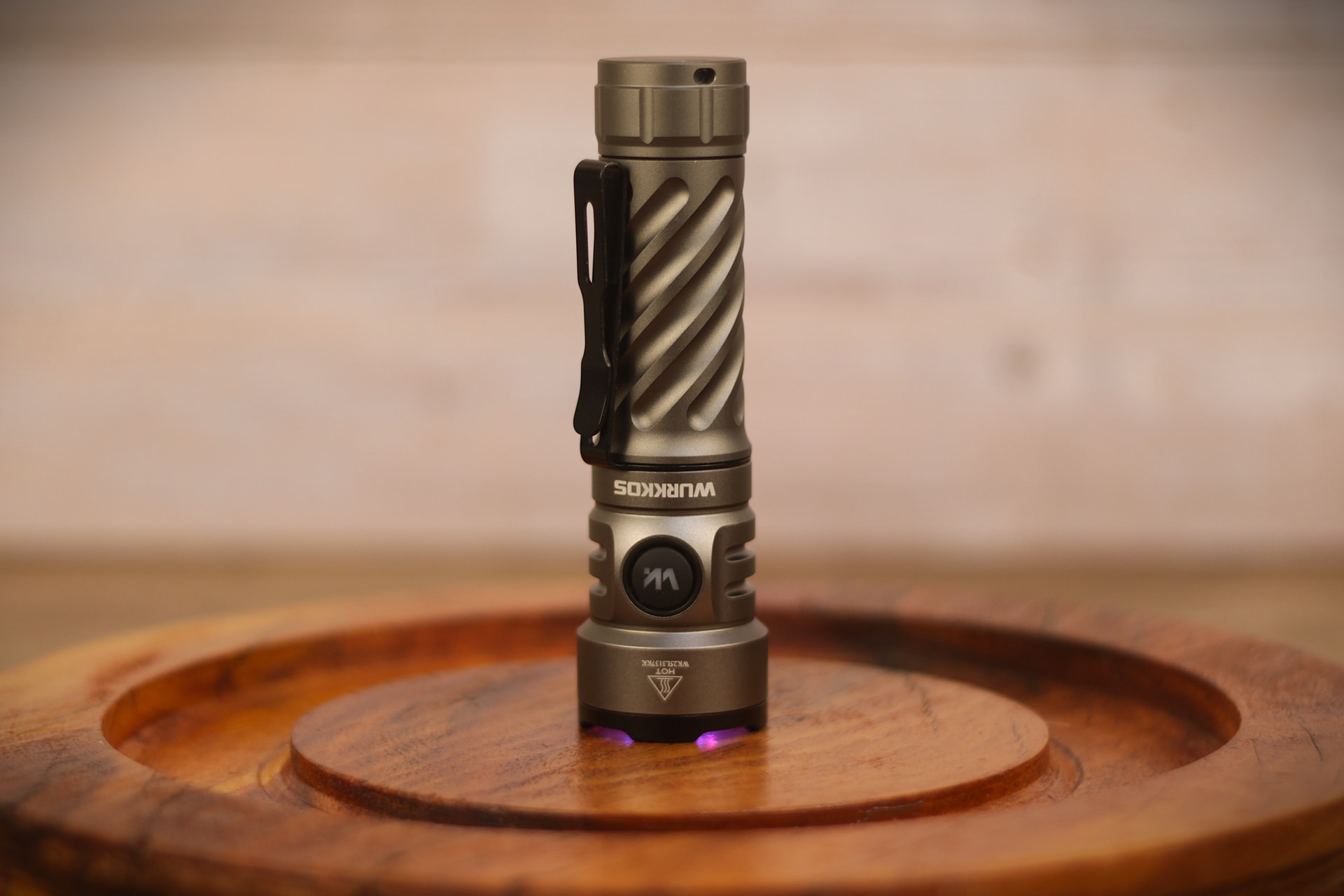

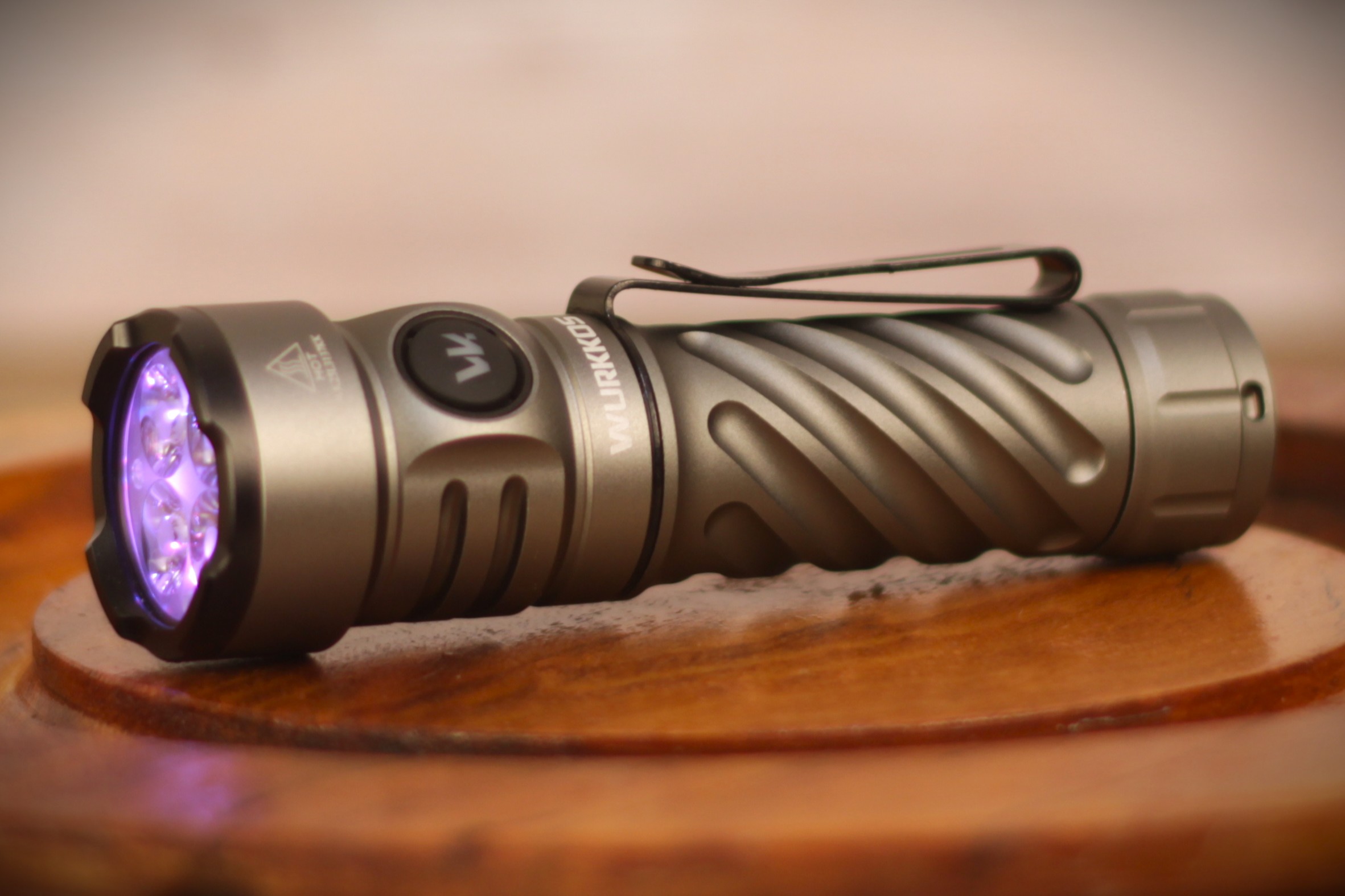

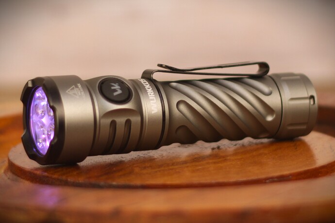

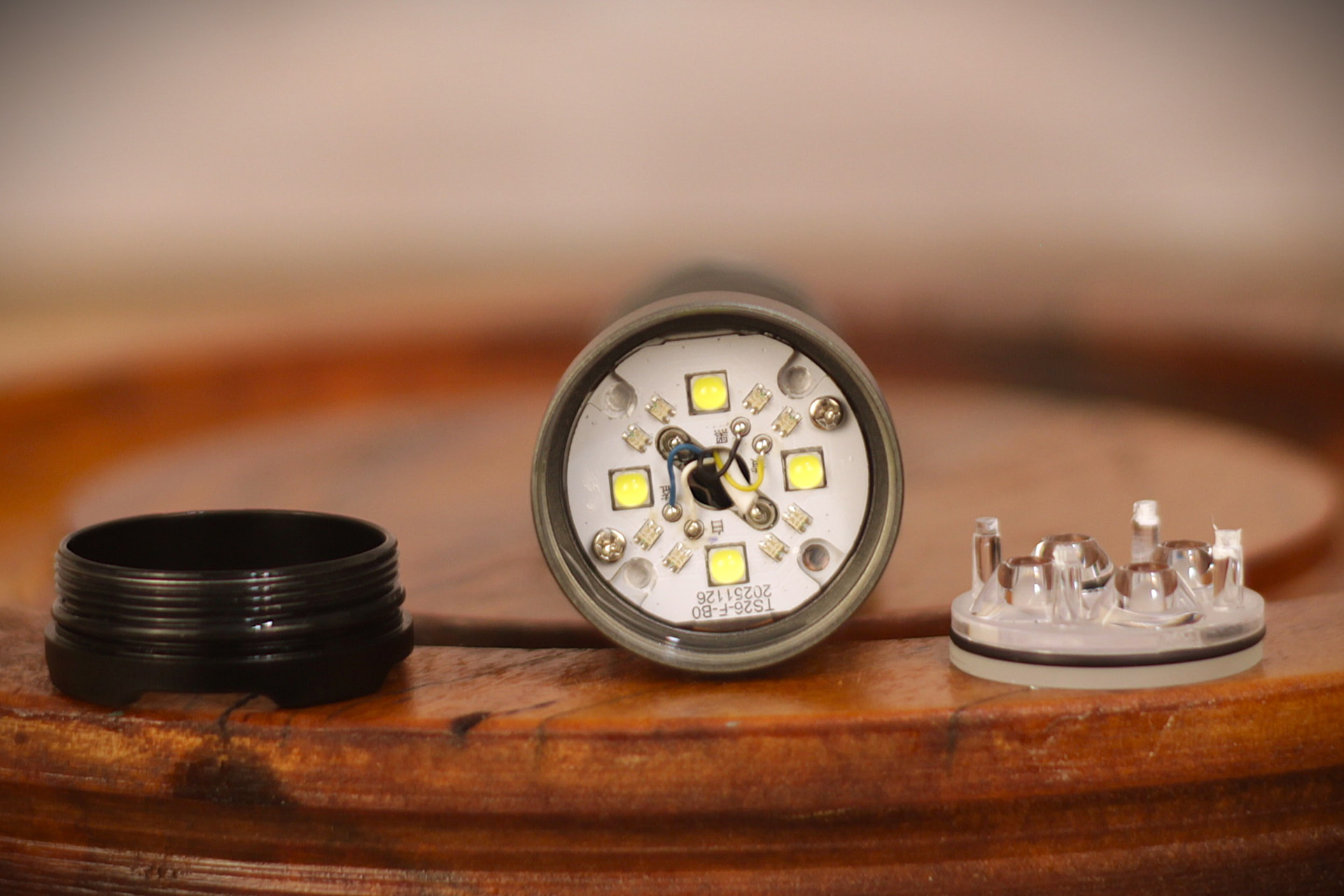

AUX lights: This flashlight has AUX lights on the optics and on the main button! The optics AUX LEDs can be configured on Anduril to blink, show battery level and has a lot of fun modes, the button only lights up green when charging to show the charge state, and for some reason it lights up blue for some seconds when you unplug it from charging.
Buttons: This flashlight, as most Anduril flashlights, only has a single click e-switch. It is covered by a black silicone dome with the Wurkkos logo in transparent silicone.
Bezel: The bezel is crenelated with 4 trapezoidal shapes, it is very useful when you leave the flashlight on a table at dark as you can still see the AUX lights, and this type of bezel can also be used to break glass on emergency situations.

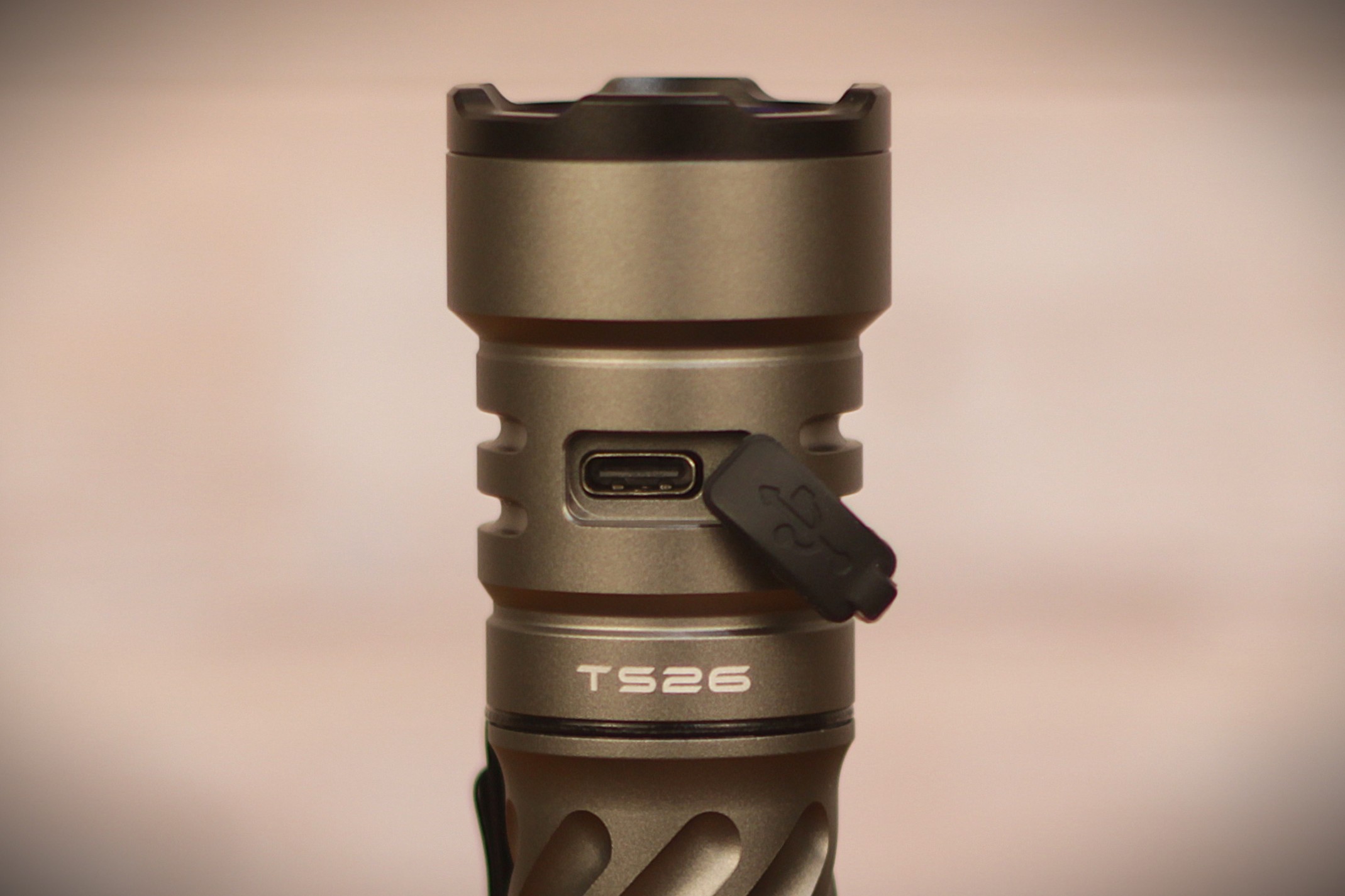

Water Resistance: It has ISO IPX8 water resistant rating, and I don’t see any major failures in the water proofing, I don’t like much the exposed rubber cap to protect the USB-C from water damage, but the rubber cap seems to be good on this model.

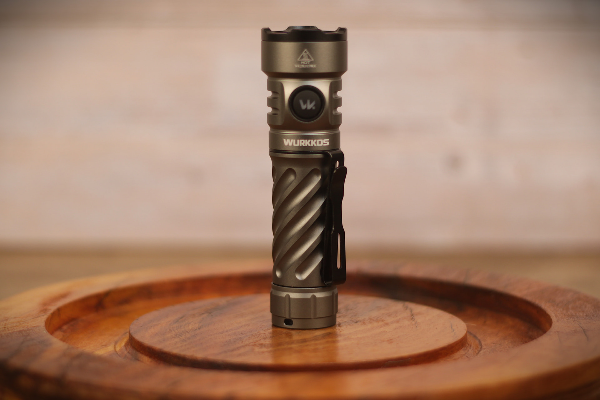

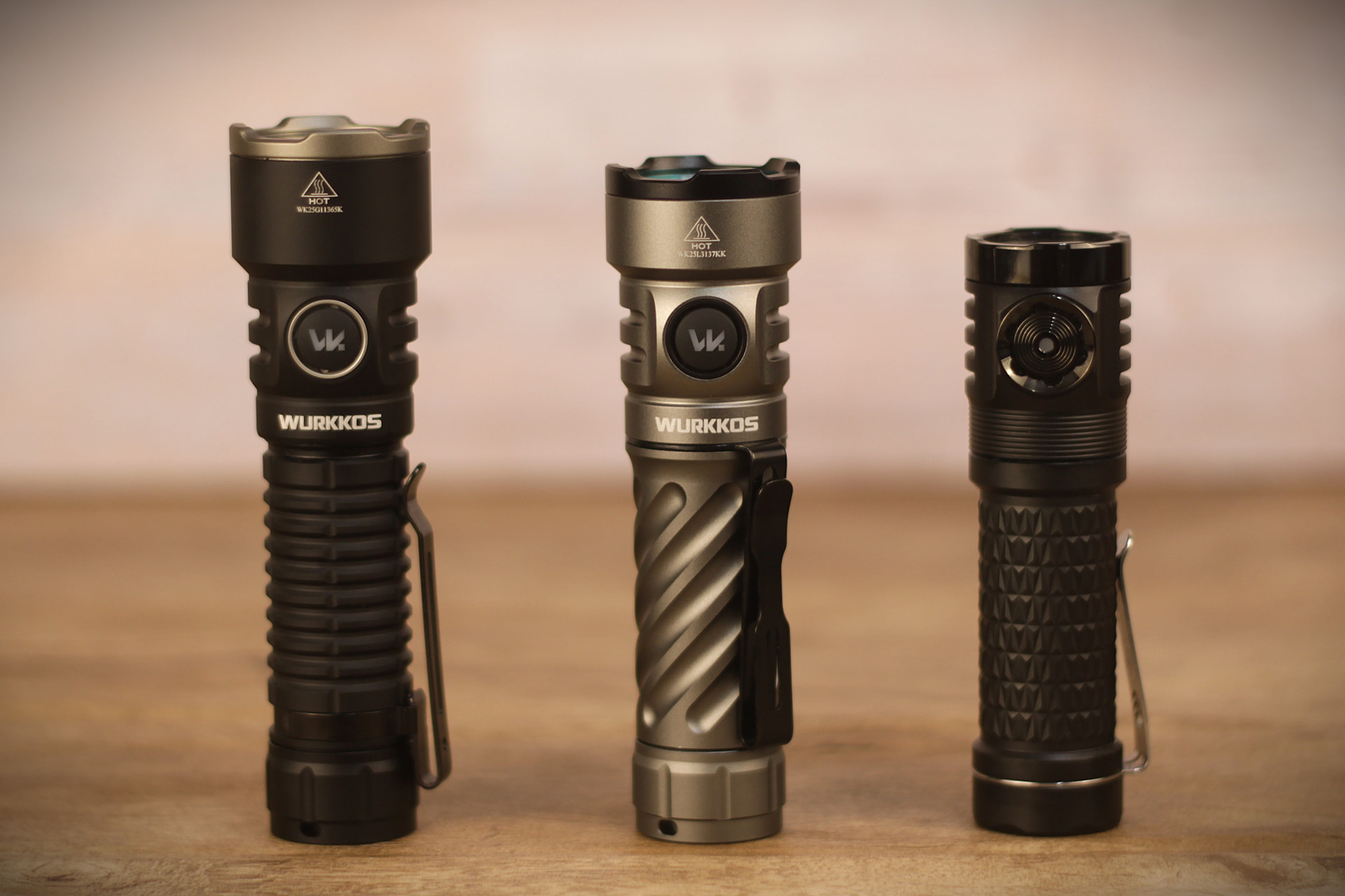

Here is a size comparison with 2 other flashlights the Wurkkos TS28 on the left and FireFlyLite X4Q Comet on the right:
• Weight and size
Weight: 106.1g (without battery – measured on scale by me)
170.0g (with battery – measured on scale by me)
Size: 122mm (length) x 35mm (head diameter) x 27.9mm (tail diameter)

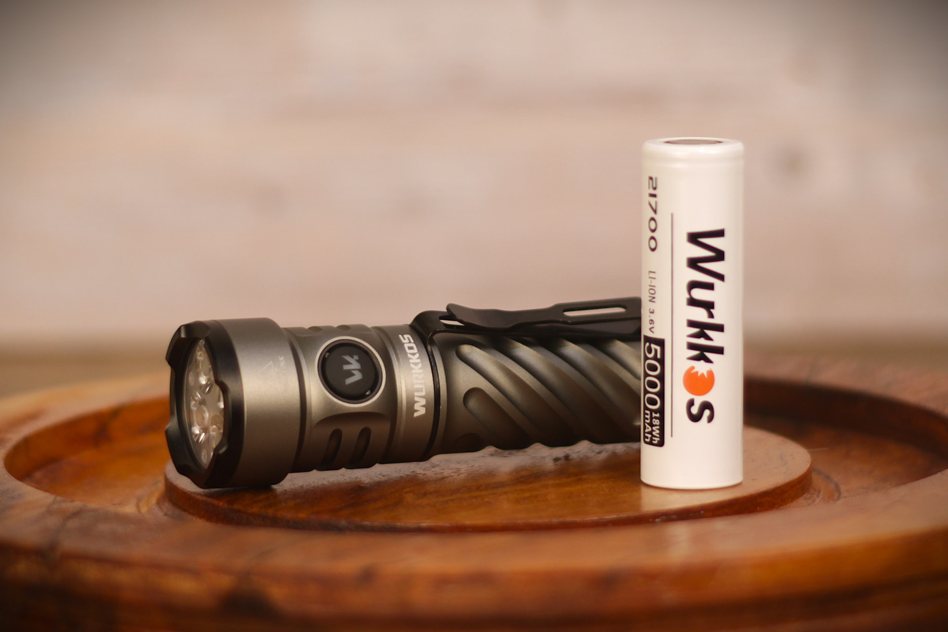

Battery: This flashlight is powered by a single 21700 battery, a Wurkkos branded 5000mAh 21700 is included inside the box, I tested and 18650 can also be used, but be sure it can handle at least 10A constant discharge and to make an adapter so it doesn’t rattle inside the tube.
Battery Indicator: The main AUX lights serve as a battery indicator every time you turn OFF the flashlight, also you can access Anduril battery indicator by clicking 3 times the main button while the flashlight is OFF.
Charging: The TS26 features USB-C charging on the main body. The USB-C is protected by a rubber cap. When charging the button light will be lit flashlight green, when the charge is complete the button will be solid green. When you unplug the charging cable the button will light up blue.

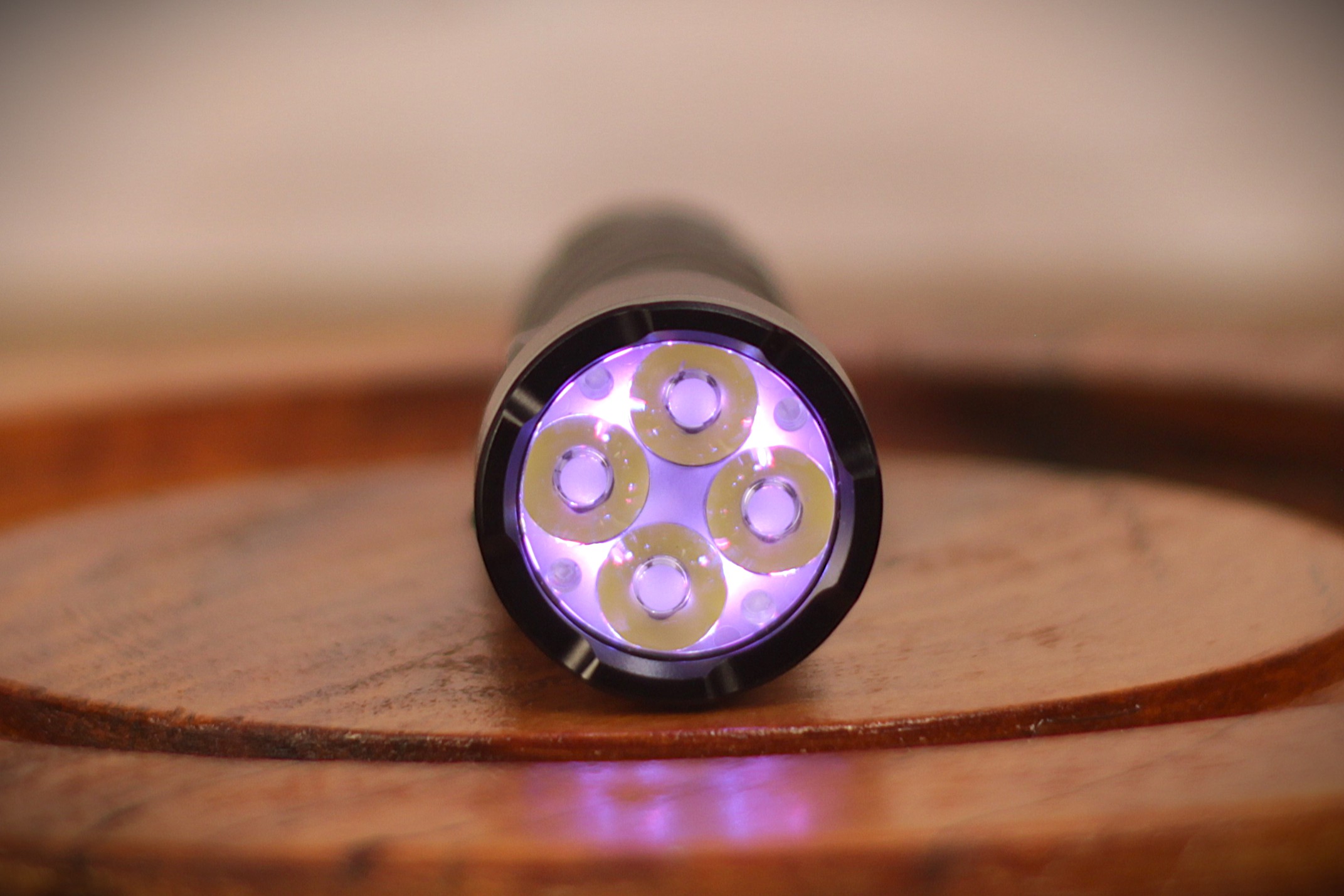

Emitter: This flashlight uses the TN-3535 emitters in 6500K, they are not bad emitters, but I feel for a flashlight with Anduril UI focused on enthusiasts it would be much better to use lower CCT emitters, like at least 5000K or 4000K, also high CRI emitters would be very good on this flashlight. My opinion is a lot of people, including me, were expecting the TS26 to use the same LEDs as the the TS26s, the Nichia 519a. When they announced it had the TN-3535 I saw a lot of people complaining, and I totally agree with it. The 519a LED would make way more sense on a enthusiast flashlight like this.
Lens: It has anti-reflexive coated glass lens in front of the TIR lens.
Reflector/TIR: It features a balanced TIR lens, being floody while still managing to throw light a little far.
Beam shape: Very smooth hotspot transition with little diffused flood around it, usual on TIR lens like this.
CRI: No. The 6500K TN-3535 LEDs used on this flashlight doesn’t have high CRI.

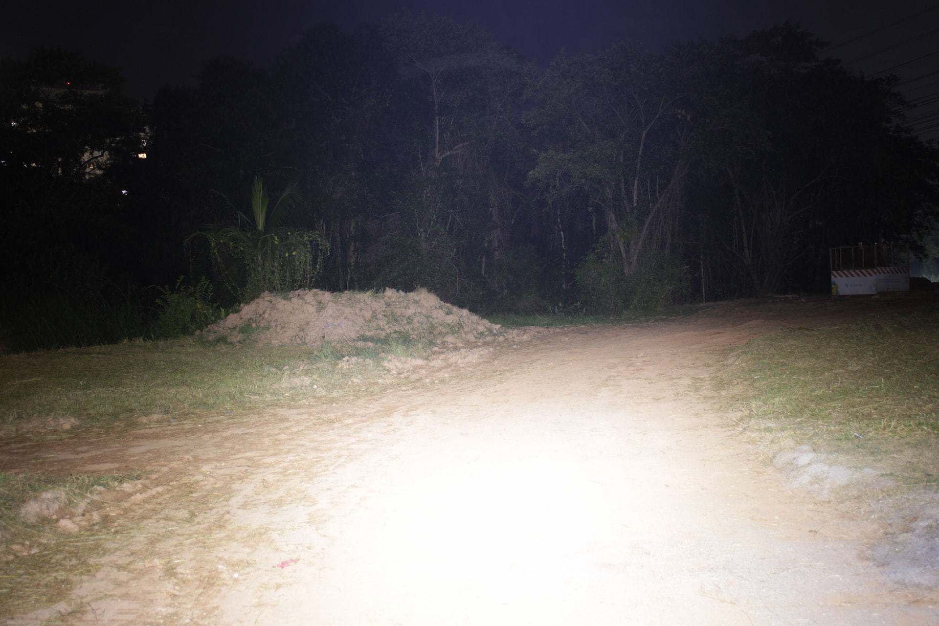

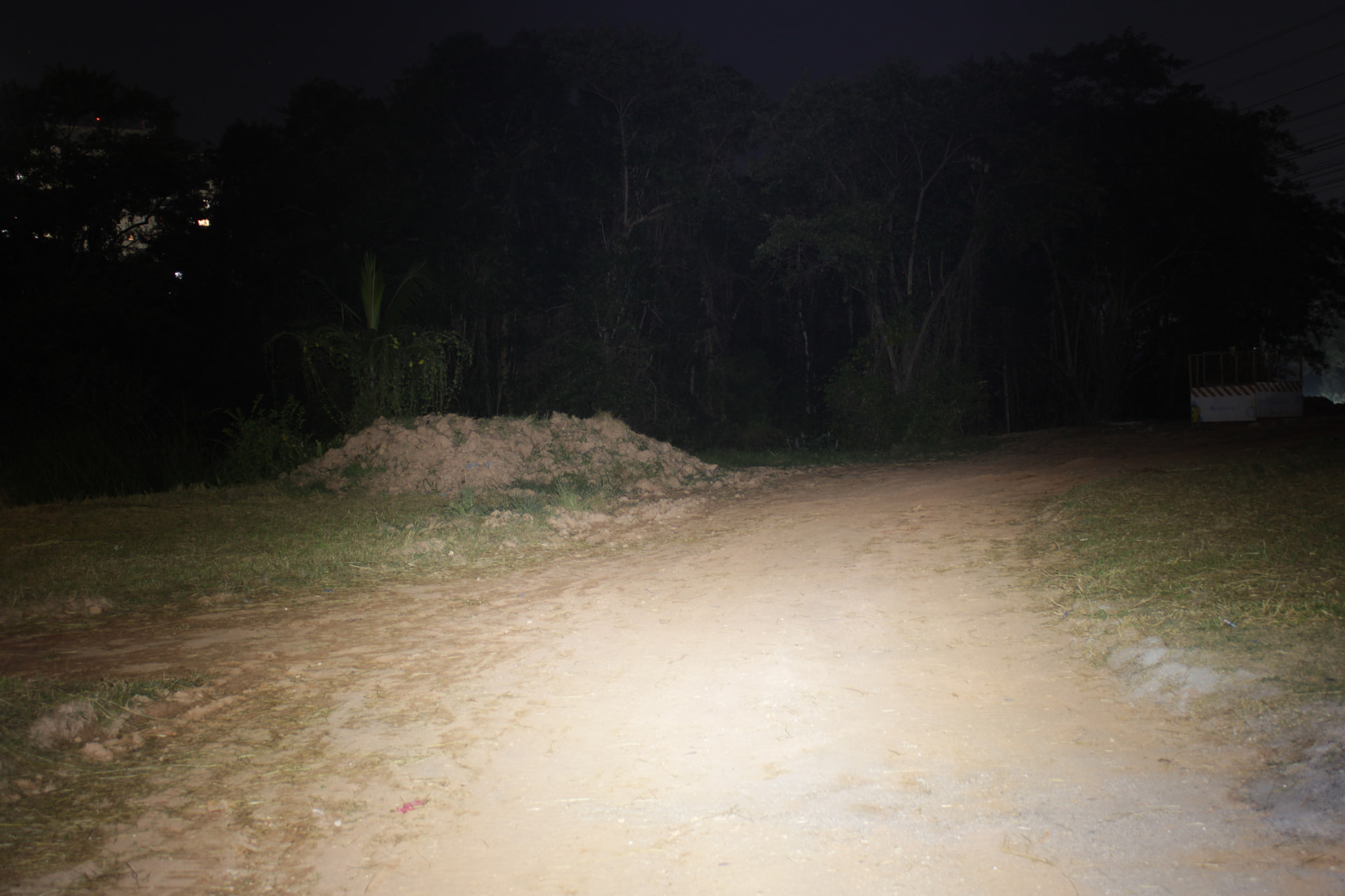

• Beamshots Camera settings:
  • 24mm lens, 1", F4, ISO200, WB: 5200K (daylight)
I always try to match what my eyes can see on the beamshots, so camera settings may vary.
F6 mode (1150 lumens)
G7 mode (2100 lumens)
H8 mode (3400 lumens)

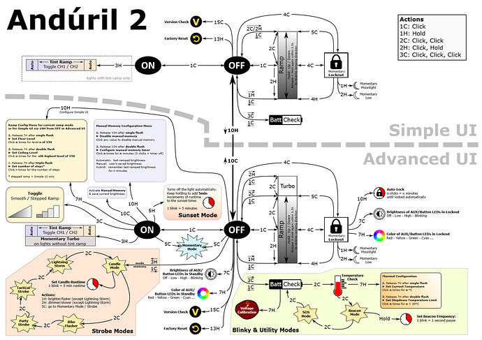

UI: The TS26 uses the famous enthusiast UI: the Anduril v2.0. This UI is full of cool and useful features, it’s almost totally customizable! I will not focus on the UI as it would make this review much bigger, but you can check all the information on the github official page, and I will include a picture with a lot of information about the UI.
Anduril Github page
Anduril manual and image credits
