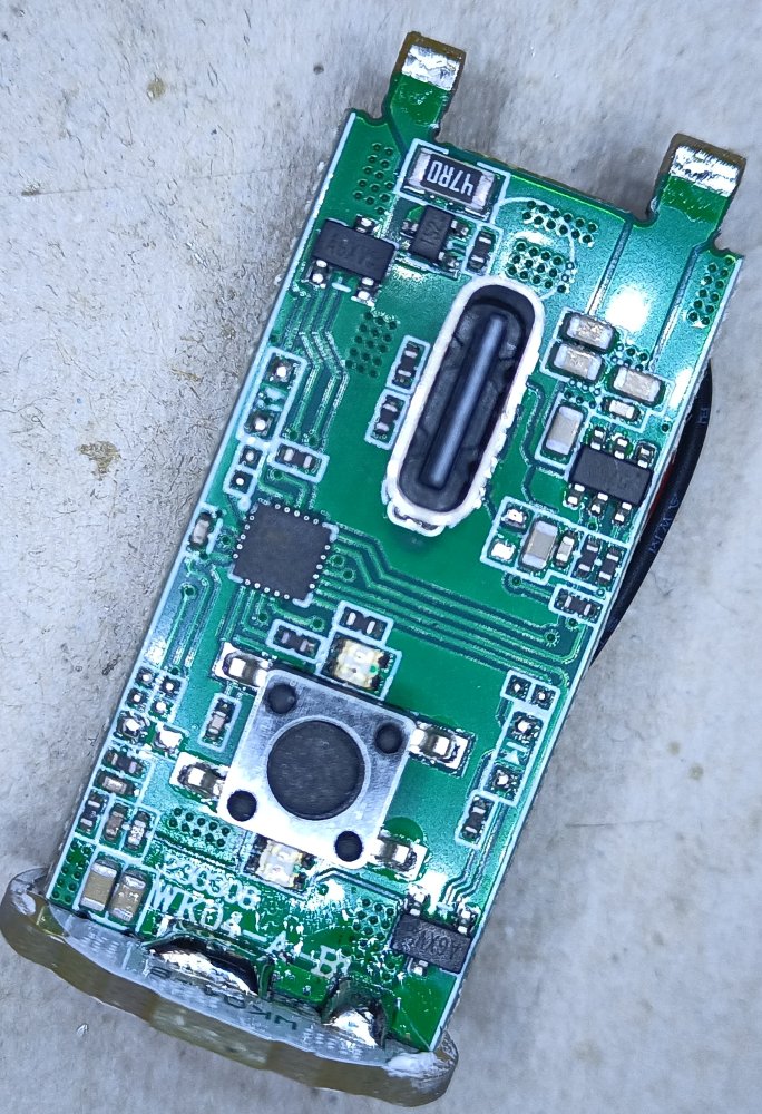

I was wondering what’s inside. I was hoping I can reprogram the MCU but it seems to be a custom one. FMD G3HKGEH. The battery is a 300mAh 3.7v. I can only post one image at the moment but I can upload a few more later if anyone interested.
What is the main high CRI LED in it?

It is unregulated, with poor cooling. So the runtime graph would be as bad as you’d expect. A sharp decline after short turbo and continuous downward slope. It’s too big with too small of a battery IMO. If they can cram in a 900mAh I’d be interested.
Looks like LatticePower TG3/TH-3535
It is the little brother of LatticePower TN3535 LED I tested earlier.
