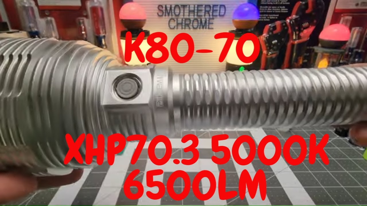

Hey, take a look at this guy
Another option is the Pioneman K80-70 XHP70.3.
