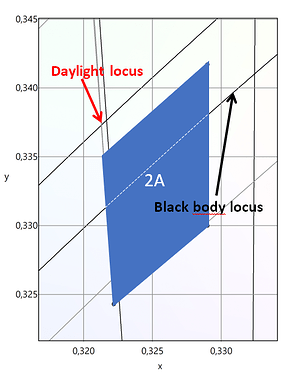

Perhaps the reference used is not the BBL but the more commonly used daylight locus, which agrees with the BBL below 4000K but becomes greener with higher CCTs. If this is the case, a duv of 0.0021 at 5000K should be below the locus.
This could be the case. In the datasheet it seems that the chromaticity bin is according to the daylight locus but I can’t tell for sure since no BBL is shown in the chart.

Ahhh good point! I proposed the guess precisely because there is no locus shown in the chart, but now that you’ve said it, the offset between 1C and 2A bins is indicative of some sort of modified locus.

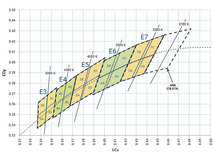

H = 2-Step
G = 3-Step
E = 5-Step
For R9050 (Simon’s emitters): 30G, 40G and 50G are 3-Step.
Correct about the 3-step, incorrect about R70 - stepping applies to R9050. R70 use classic binning:
I have the XHP70.3 HI R9050 5700K 2A M2 in an M3-C.
The blue polygon represents the quadrant corresponding to chromaticity region 2A. And I can tell you that the datasheet uses the ANSI C78.377A-2008 blackbody locus path.
You’re absolutely right. Sorry for my mistake. Corrected.
