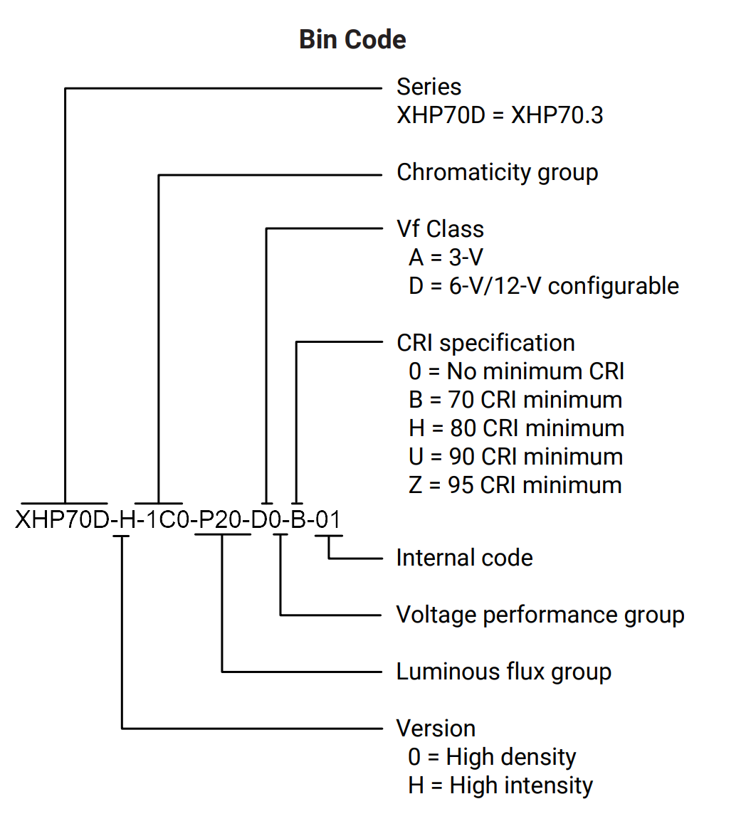

How to decipher those codes?

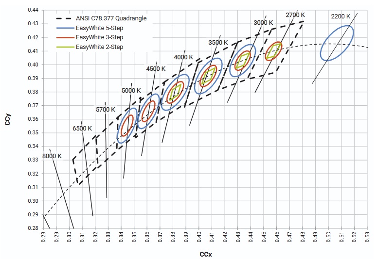

For the R70 we’re talking typical Cree bins, there are four available: 1C, 3A, 5A, 7C.
For the 3A and 5A you’re pretty much guanateed to be below duv and therefore no green tint.
As for the 90CRI we have 50G or 40G - first two numbers is CCT (50 - 5000K), G means 2-step binning as shown here:
As you can see most of the red circle is above duv therefore green tint is fairly likely.
Very useful diagrams. Also, i see Simon has nice green tints in Cree 3v XHP50.3, which is very interesting. Also, the XHP70.3 6500K R70 is 1C.
