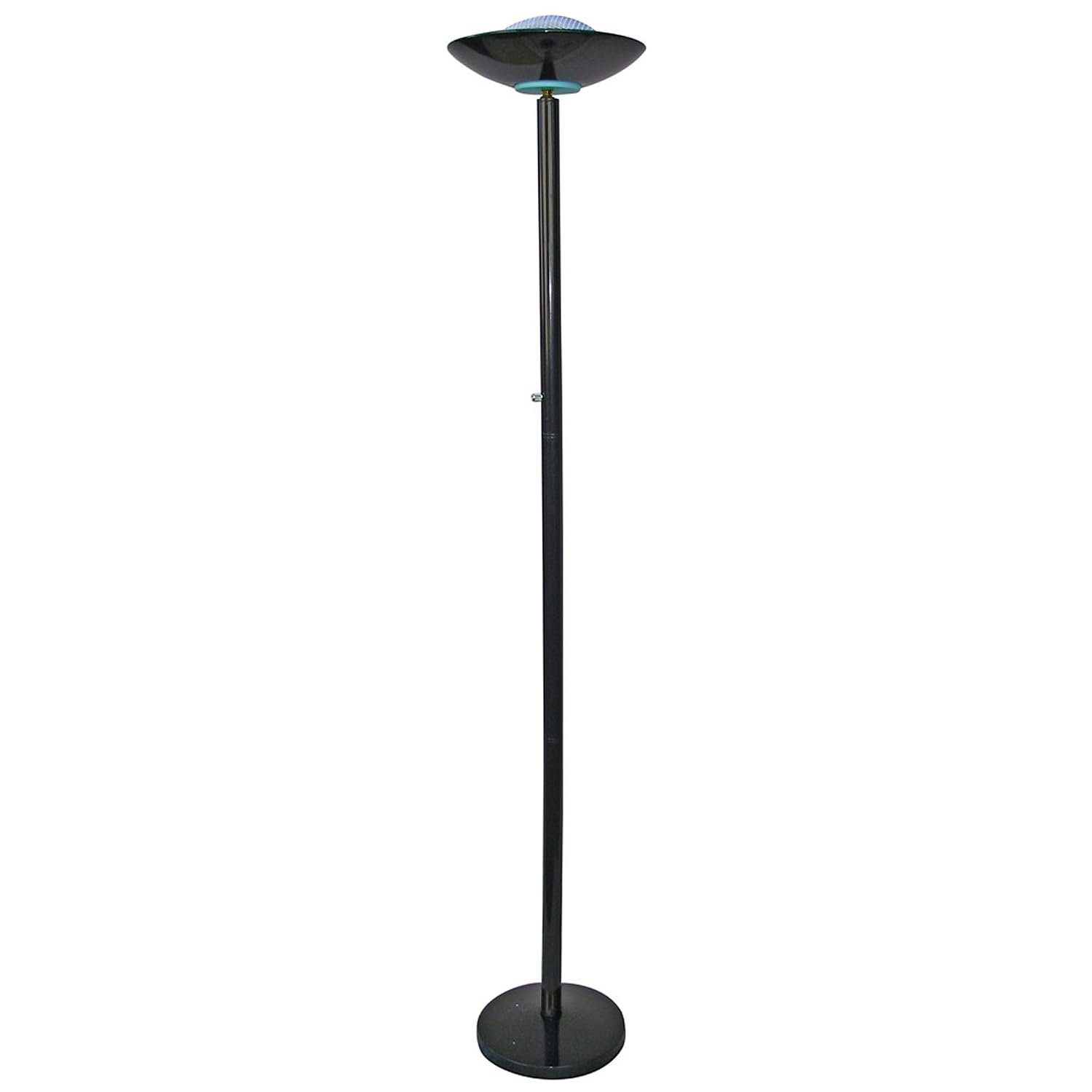

We have large 4 lamp 4’ fluorescent (retrofitted with LED tubes) fixtures in our living room for when guests are over. but generally, I prefer indirect lighting to direct lighting and to achieve this at home, I use LED bulbs in torchier style floor mounted lights. The bulbs I use output about 800 lumens and fit in standard screw sockets. The torchiers I use have opaque shades which allow some direct light. If you wanted to go completely indirect, I imagine you could fashion some sort of foil shield, but if you mounted it inside the bulb area, you’d need to be very careful of not creating anything which could possible cause a short. Then again, foil outside the shade would look pretty ugly. Painting the interior of the shade white would be a reasonable compromised in my opinion, but you’d look efficiency.
Perhaps you could retrofit some torchiers, convert for low voltage. This would reduce the risk should a short occur. If you could get the right tint, P60 drop-ins might not be a bad option.
