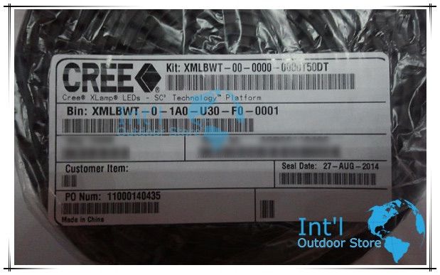

Just noticed that Hank has a new batch of XM-L2 U3 in 1A and 2A tints.
Finally a U3 that can be trusted
Here's the link.
Here's the link.
