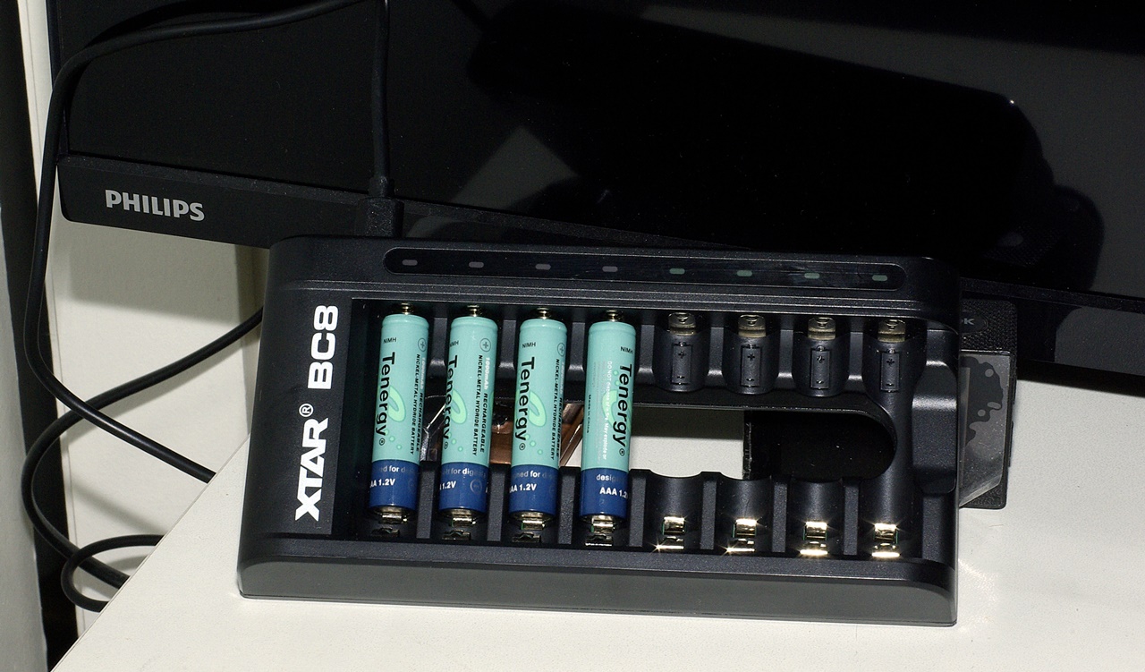

Using the BC8
Honestly , it’s as simple as plugging in the BC8 into a suitable USB power supply capable of at least 5v 2A . To charge NIMH batteries simply pop them into the charger and pull them out when the charger gives a green light ( fully charged ) . The red light signifies the battery is being charged . And this charger is a constant 0.5A charger , so charging is neither fast nor slow . In fact the charger is nice and easy on the batteries and I did not detect any over heating on the AA or AAA I charged . AA stayed in the 30 deg C range and I did see 42C on a few AA , ( Room temp was 20 deg C ) .
A unique feature of the BC8 is the hole in the back of the charger . I believe this is to aid in the extraction of batteries that have completed their charge cycle . It can be a real pain peeling the odd battery out of a charger once it has finished charging and the hole in the back allows you to simply push out the completed battery with little effort .

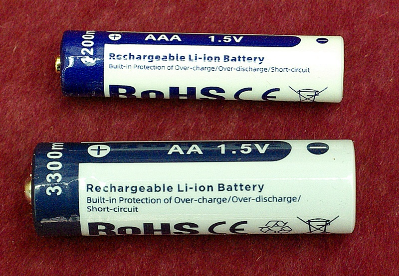

Charging AA / AAA LI-ion ( From Xtar )
Just as easy as charging NIMH batteries . Just pop them in the charger and he charger automatically detects them and charges them . Speaking off !
The charger starts at 4.2 volts 0.5A and voltage slowly increases to 4.8 volts and then the current slowly decreases and the charge cycle completes at around 5 volts . This is why it would be a very bad idea to try and charge other batteries ( Li-ion / Lipo ) with this charger .

Xtar Li-ion AA / AAA
I ran a discharge at 0.2A on one of the AA Li-ion batteries .
Initially the voltage dropped slowly into the 1.2 volt range ( being discharged )
The voltage bottomed out at 1.14 volts around 1000mAh having being discharged and then began to rise !
