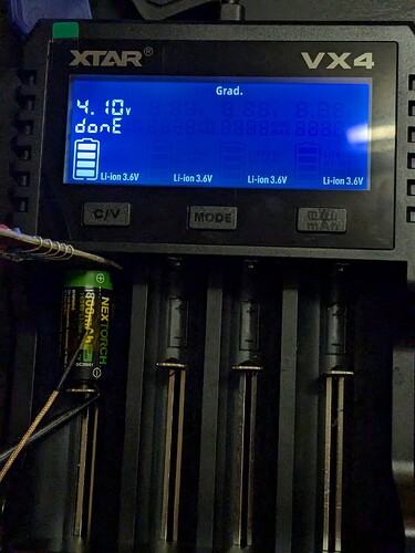

Grade CH1 3.6V Li-ion #4
CH1: NEXTORCH 16340 3.6V Li-ion 800mAh (button top)
Measurement CH1 CH2 CH3 CH4
Start Voltage 4.169
Finish Voltage 4.097
Capacity (mAh) 796
Grade worked OK for a protected NEXTORCH 16340 3.6V Li-ion cell.

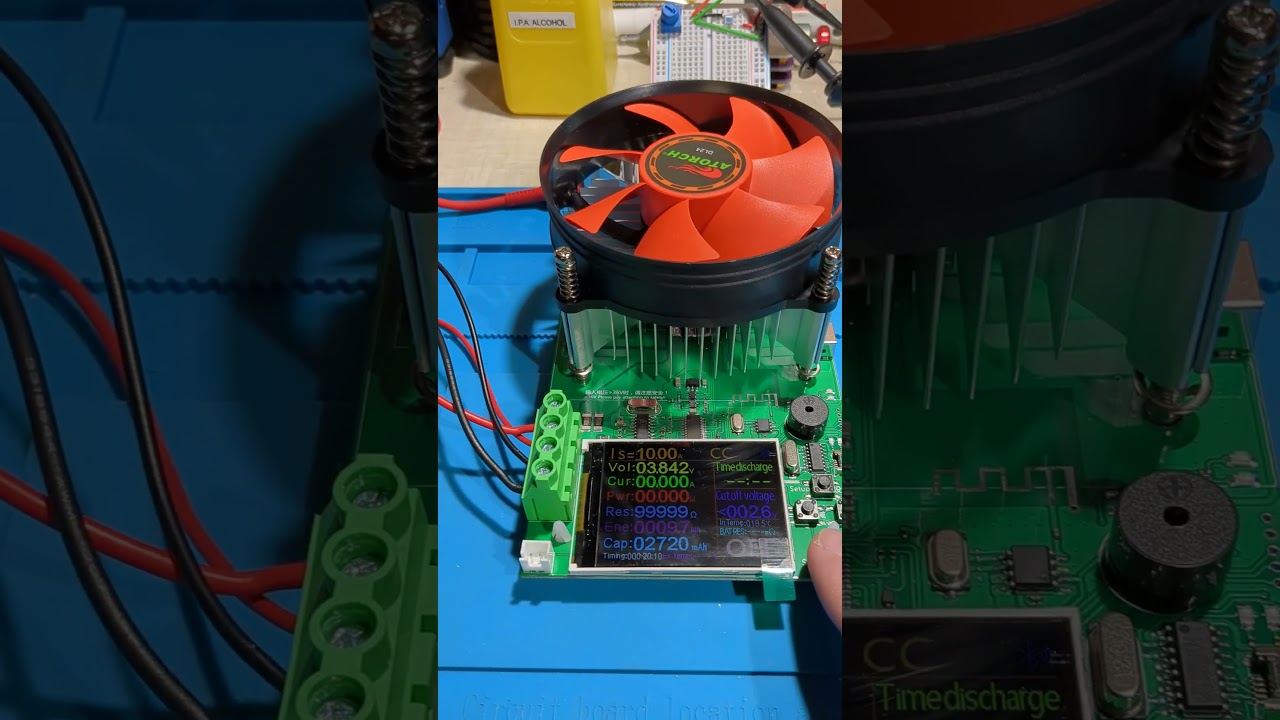

I’m discharging the XTAR 26650 at 10A to charge in the VX4.
