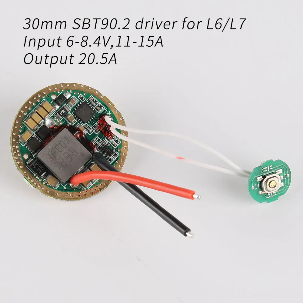

Convoy L7 has a very high power buck driver. Needs it for the SBT90.2 ![]()
Indeed, and it looks to has synchronous rectification, so it should have good efficiency.
