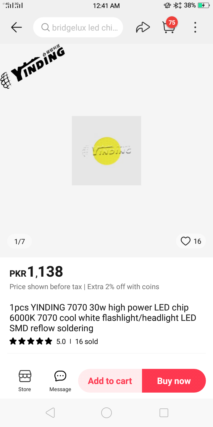

Yinding 7070 30w LED
There exists yinding 7070 30w emitter which according to seller is capable of giving 5100 lumens output 6000k with 2.9mm^2 emitting area withstanding 12A… Is it so?.
If so then its almost equal to cree xhp70.3?
Am I right? Please explain someone.
Nope. Not even close. 30W is closer to maybe 3000 lumens. The xhp70.3 is an entirely different LED (runs on 6v pr 12v, quad die) and you can’t compare it to that one. The 5050 LEDs claim high outputs also, but the SFT40-W handily beats them.
