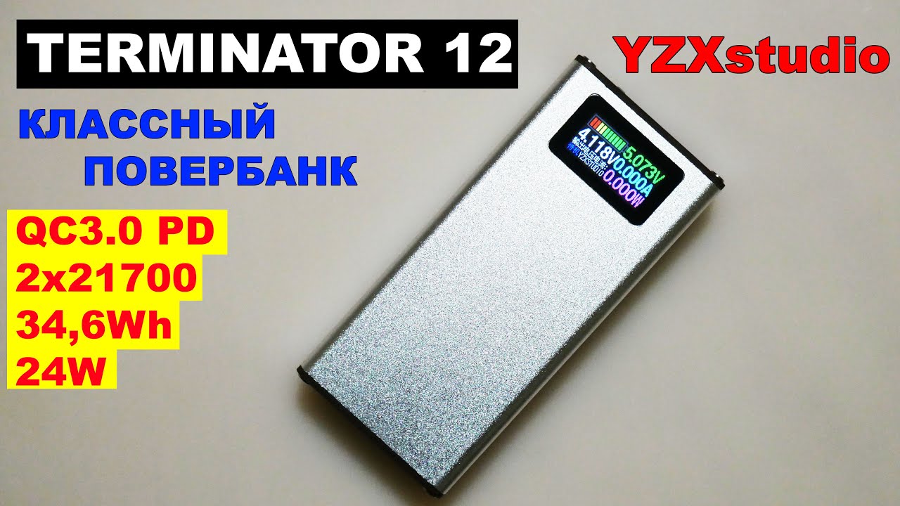

And for the 12th generation there’s also an 3d printable bumper and it is reviewed on YouTube:
https://www.ebay.de/itm/154461697173
https://www.ebay.de/itm/154461696244https://3dmixers.com/m/282188-bumpers-for-the-yzxstudio-terminator-12-t12zr-powerbank
https://www.prusaprinters.org/prints/74661-bumpers-for-the-yzxstudio-terminator-12-t12zr-powe
| Name | capacity | price |
| YZXStudio Powerbank Terminator 12 (T12ZR) | 35Wh | 64€ |
| YZXStudio Powerbank Terminator 11 | 86Wh | 238€ |
| YZXStudio Powerbank Terminator 11 | 99Wh | 258€ |
| YZXStudio Powerbank Terminator 11 Ultra | 143Wh | 270€ |
