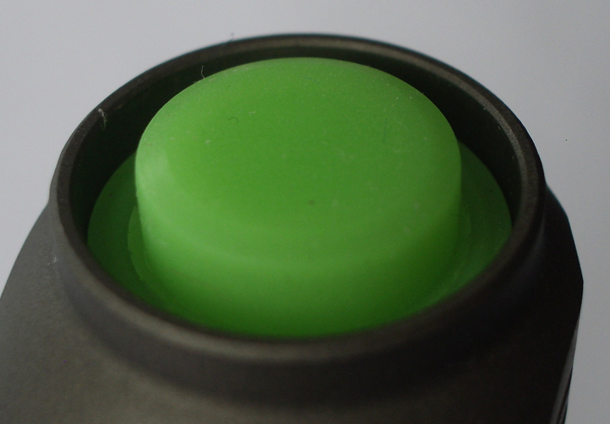

Then (@alpg88) I was able to replace it with a GITD switch boot which fits quite well under the bezel, and should ensure proper water resistance since it has a lower surrounding ring, see pictures and sketch here.

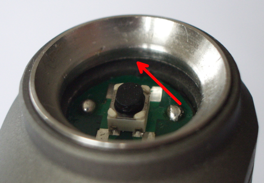

Here you are:
First you have to remove the switch boot, which will be destroyed in the process. I grabbed it with my nails, pulled, and it tore leaving its outer rim stuck between the light body and the bezel.
Then you need to carefully remove all rubber leftovers, because they prevent you from inserting a tool to pry the bezel. I did so using a very sharp X-acto knife, and small tweezers. Once the (very narrow) gap between the light body and the bezel is free of rubber, insert a very thin flat screwdriver and twist it to gently lift the bezel up (red arrow on the following picture).
Please note that I took this picture after removing the bezel, and putting it back in place but without force-inserting it completely, so the actual gap you will see is even more narrow.
When working with your screwdriver, #1 be careful not to touch the switch as you may damage it and #2 don't try to pry it out in one go, but work all around the bezel little by little.

You can see there is a rim which is part of the light body, around the switch PCB: your screwdriver leaned on it at the former step, therefore not risking to damage the switch PCB.

And here is the GITD switch boot I will use, which fits perfectly on top of the light. Its rim is a bit too thick so I'm not sure the bezel will stay on once press-fit, but I don't know how to make this rim thinner, not sure sandpaper will work on soft silicone (any suggestion folks?).

In fact there is a tiny groove all around the booth, near the base of the raised part. It matches the very narrow protruding edge at the bottom of the bezel, but it is not deep enough. I've tried pressing both parts together in a vice, which caused the silicone to be slightly "cut" by the metal edge, hence allowing the bezel to go deeper into the silicone. But I feel that if I press any further this will eventually cut the silicone, leaving the outer ring apart, hence a lower water protection. I'll try and see how it goes once I have done my GITD paint job on the bezel.
