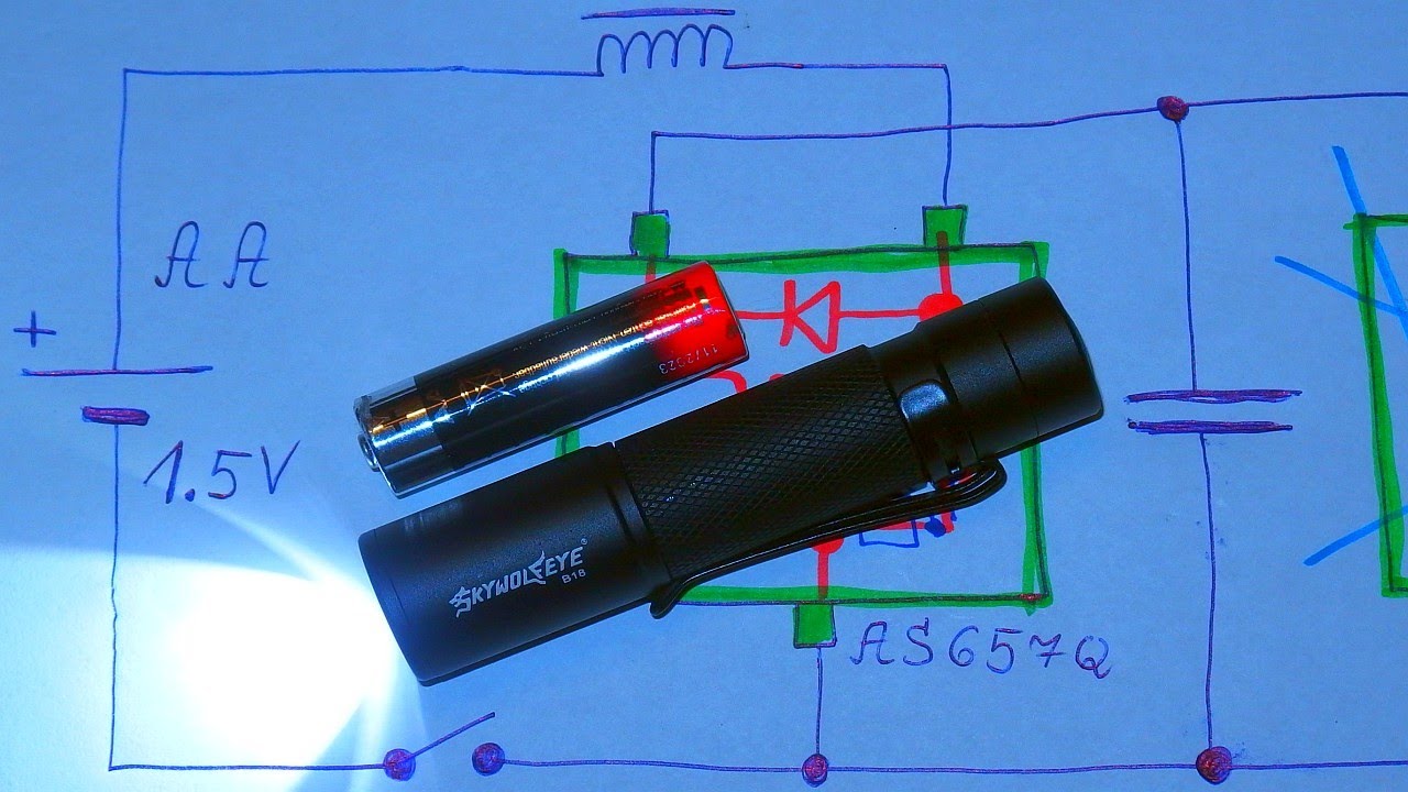

The AAA version i already have, so i had to order the AA version too.
It’s nice and compact, as opposed to the good old SK68 design.
It’s possibly the most compact (read thin walled) AA zoomie on the market.
Luckily they make it of military grade aircraft aluminium (recycled WWII planewrecks?)
Oh hey, i missed that one!
It seems to be listed no longer, but maybe i’ll find it, as part of the SkyWolfEye® sleek zoomie series.
(there’s also a 2x AAA version by the way)
