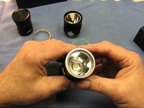

The light stinks. Poor exterior finish, loose threads, dirty, oily, damaged reflector top edge, cheap glass lens, hollow under the star, star is not held down and rattles, no heat sinking at all, no mode memory and you have to cycle through all the modes to get to off, about 300-400 lumens on high. It does have an XM-L2 in it, about 7000k.
I bought two, I wish I had bought none...
EDIT:
Some Dimensions:
OAL: 102mm
Head OD: 42mm
Lens: 41mm x 2mm thick
Reflector: 38mm Dia, 23mm deep, 10mm hole
Star: 32mm x 1.5mm thick
Driver: 30.5mm Dia.
Driver Pocket: 17mm depth so there's some room for a heat sink below where the star is, depending on the driver used.
