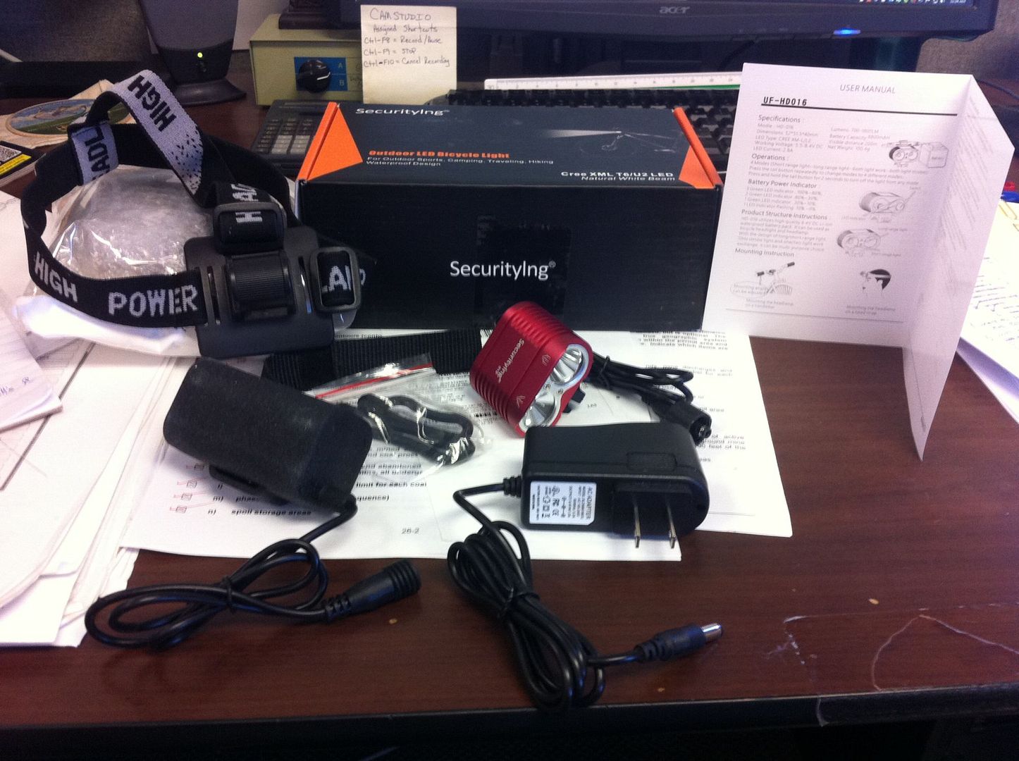

Just received my HD-016 "SecurityIng" version from Amazon.  Battery had enough juice to run through the modes one time before it died.  Will test it out later.  First impressions is that it looks good!
1
(That's my SSX2 package on the left.)
1
The box is just a generic bike light box.  It says "XM-L" and "Natural White" which are both lies.  It came with cool white XM-L2's.

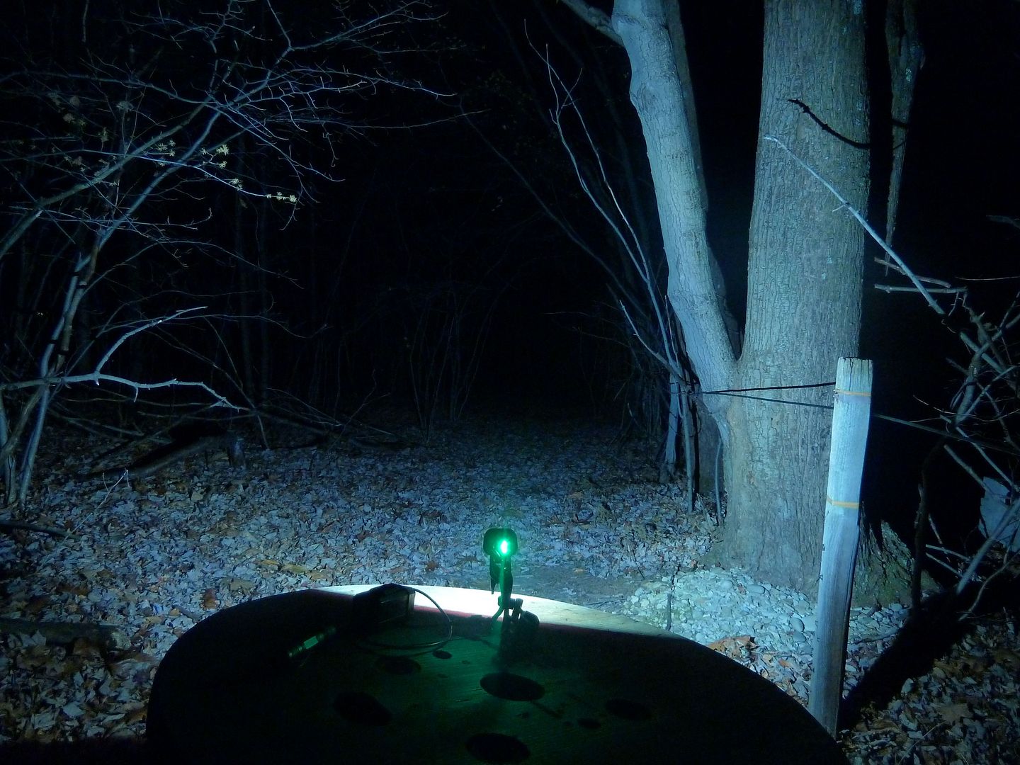

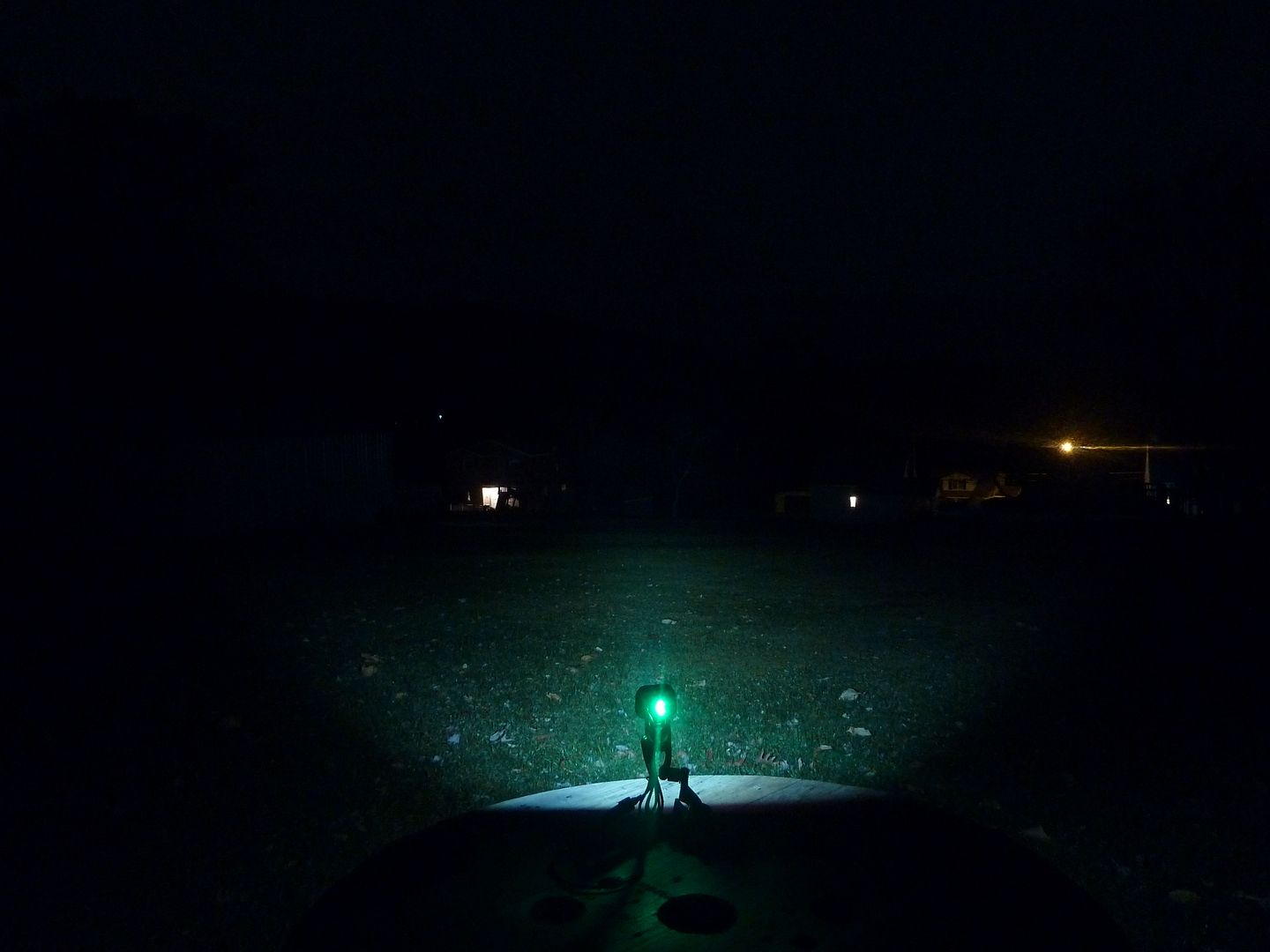

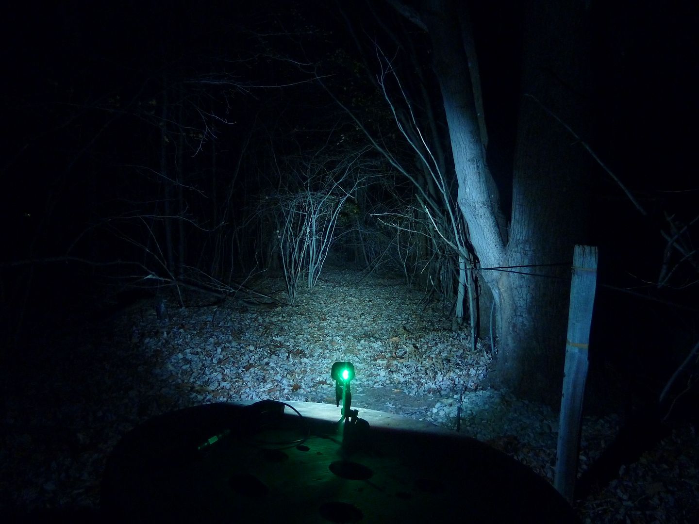

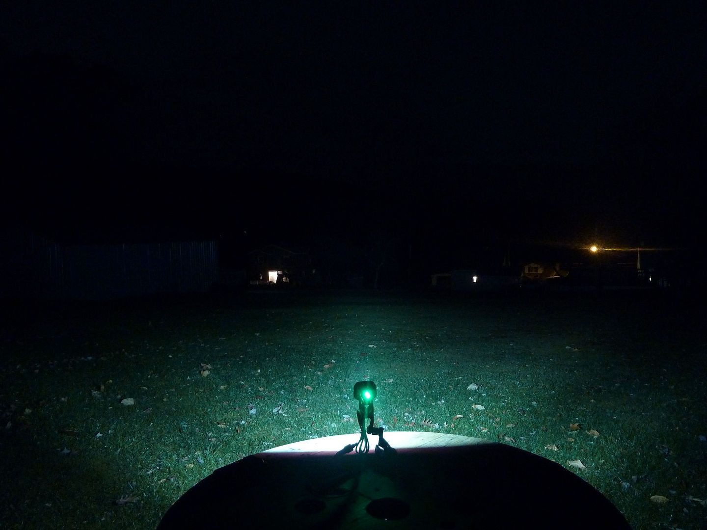

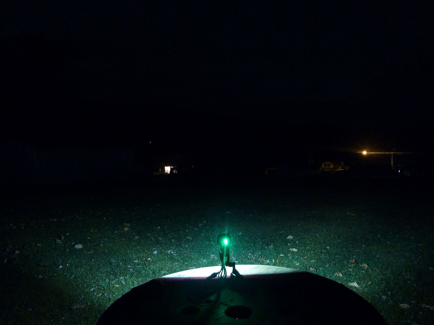

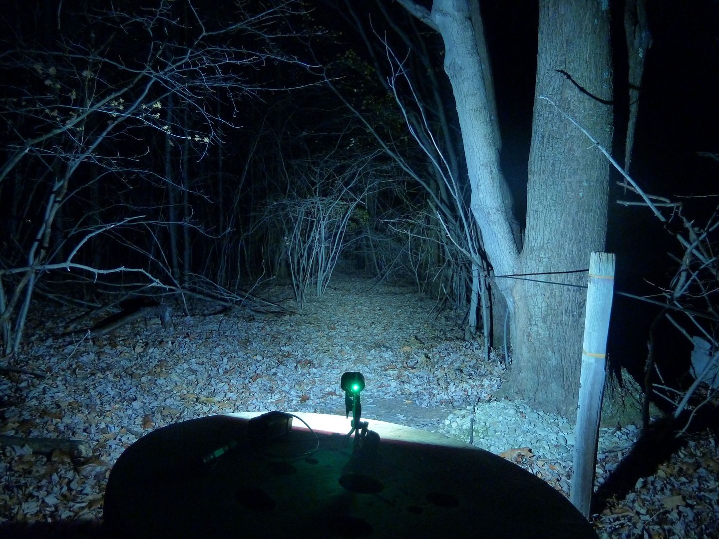

I just received my SecurtyIng version from Amazon.
I haven't torn it apart yet, but I've taken current readings and got some beamshots.
Current pulled from 2-cell battery pack at 8.24v:
Off: 0.020A
Flood: 0.663A
Throw: 0.665A
Flood & Throw: 1.410A (Steady, not dropping)
(BTW - I am confident current readings I make are accurate.)
Flood is VERY wide! However the "flood" mode doesn't throw out far at all. I can't imagine "flood" alone being enough to ride with (except commuting where it is used more for "be seen" use. I think I would prefer the reflector be just a tad deeper in order to get a little more throw out of it.
Here are some beamshots. Pics taken with my same manual camera settings at roughly the same location so that my beamshots can be compared one to another. In the first set of pics, the distance to the trees I aimed between is approx. 185 feet (garage is beyond the trees at an undetermined distance - I really need to determine that). Approx. 275 feet to the house off to the left of the trees. (Note: you can barely see the trees or garage in the "throw" pic.)
Flood:
1
Throw:
1
Flood & Throw:
1
Now to my wooded trail spot:
Flood:
1
Throw:
1
Flood & Throw:
1
That wooded shot above really sells this light!
Full size pics can be found in my PhotoBucket Gallery.
Next is a full teardown and mod to XM-L2 T5 5B1's and a resistor modded SSX2 driver to run Flood & Throw LEDs at all times in a High-Med-Low (or Low-Med-High) arrangement.
