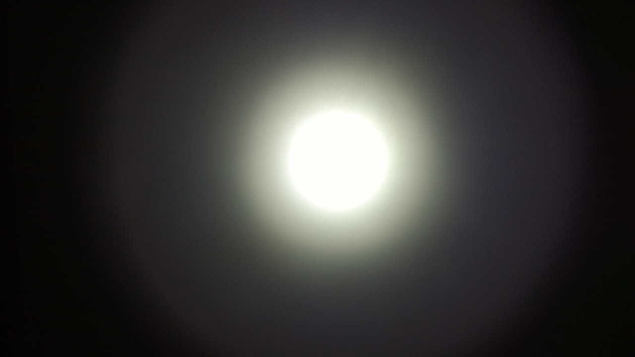

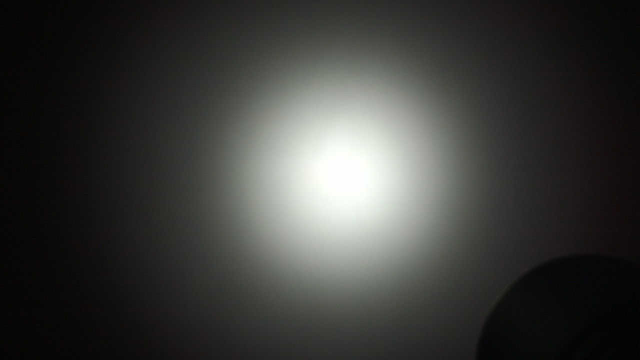

I use simple diffuser cut out to the size from Gerber printer vinyl, normally used for labels and placards in aviation (withstands 135 deg. C and has some flame resistance).
Similar materials are used for backlit posters, bus stop advertisements etc.
Vinyl is 10 mils thick (0,25 mm), frosty on one side and clear and smooth on the other. It’s very hard to scratch and protects glass on the flashlight well as an extra bonus.
It’s probably quite ineffective and blocks some light, but I don’t mind, I like smooth beam and don’t care about some lost percent of light.
Solarforce L2P flashlight with XM-L T5 4B LED and OP reflector.
1m from the wall – standard OP reflector:
Added diffuser (sorry for the shadow):
