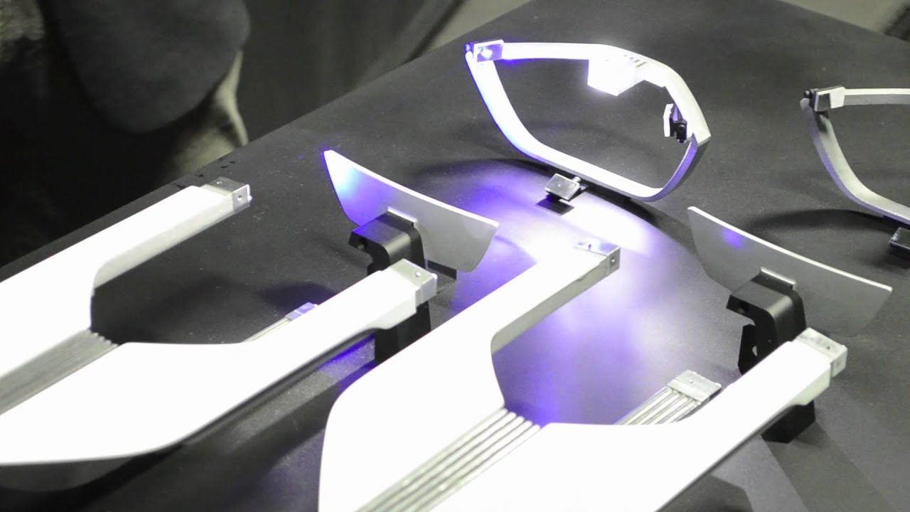

I have no idea on specs. But the headlights on I8 sure looks nice. Could some of the upcoming high-end flashlights maybe implement that technology in the future and have benefits that exceeds LED technology?
Looking into it, they demo’d this tech in 2011, with production estimates for 2013, so should be out soon. Firing the laser into a phosphor and then reflecting the the diffused wavelength shifted light with a reflector mirror, recoil style. Tech demo in this video:
there is no information on that link on how it works, and in my experience, concepts like this that extoll virtues but with no explanation of the underlying technology usually evaporate into ether
I think you’re reply was to the OP and not the video link I provided, but I watched the video again anyways to make sure I wasn’t crazy. For those too lazy to watch the whole 3 mins, here’s the jist: Laser diode off mirror into plate of phosphor, diffused light from phosphor gathered by a lens then reflected recoil style out the front. Laser diode surface area 10x10 microns, which is why they claim brighter than the 1mm square of LEDs.

Since they're still lighting up phosphors, I don't see why this would be inherently brighter or more efficient.
What I do think would be promising is if automotive headlights started using micro motorized mirrors like is used in video projectors and projection televisions. That should allow all the light to be used and directed where it's needed when it's needed, versus using a blockoff plate for the dipped beam and using motors to move the entire beam pattern around. That should net huge OTF gains.
Lasers are more efficent than LEDs, with some in the 600 lumen/watt range compared to Cree LEDs which are still doing well over 200 lumen/watt. And putting that much brightness out of a 10 micron square surface guarentees more originating lux, since it’s a laser.
But you are right to question, since they are seperating that from the fact of going thru a phosphor. I’d have to imagine that it acts like a diffusing film if nothing else so the lux is gone, which they clearly indicate in the video by saying it’s safe now to look directly into post reflection. I’d be very interested in some OTF numbers with ANSI ratings.

When I first heard about this, I thought it'd be about something like this, which I do think could be more efficient.
Perhaps after the conversion by phosfors this concept may not be much more efficient than a led, but I can imagine the surface brightness of this light source can be made much higher, making this a leap forwards for directed light applications (in BLF this equals: throwers )
Wasnt it more like this - laser reflects back from that front thingy into the mirror from which then the light is being reflected outwards /towards the enivronment? And theres phosphor between that front thingy and the laser.
