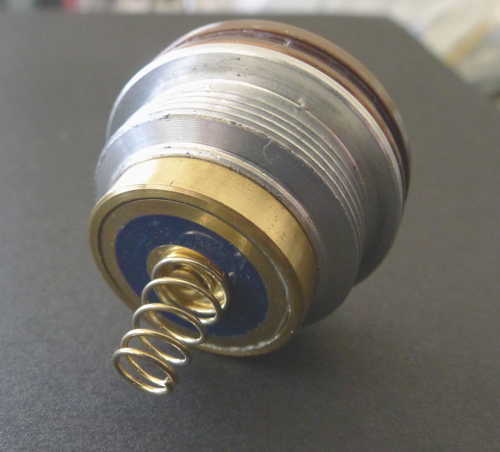

1. Used one of these shaved down to 18+ mm to fit in pill brass driver holder extension thingie (see picture)
http://www.banggood.com/Wholesale-7135-Two-Sides-Gold-Plated-Driver-Boar…
2. Attached stock aleto battery spring to blank disk.

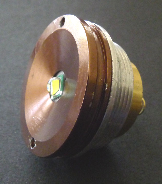

2. Must use a 16mm star (NOT a 20mm) so that the wire holes line up in the pill. 20mm wires will NOT line up correctly. Even though emitter area is CAVERNOUS for stock giant star, brown cover holds 16mm star in place perfectly. Included stock plastic spacer keeps emitter terminals from shorting.
3. Piggybacked 17mm Fasttech nanjig to shaved-down blank PCB driver disk. Disk press fits into brass receptacle, so don’t shave it down too much. Fit perfectly and worked like a charm. Like someone built the piggyback setup for the Aleto.
