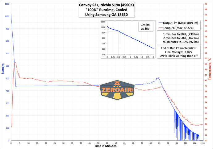

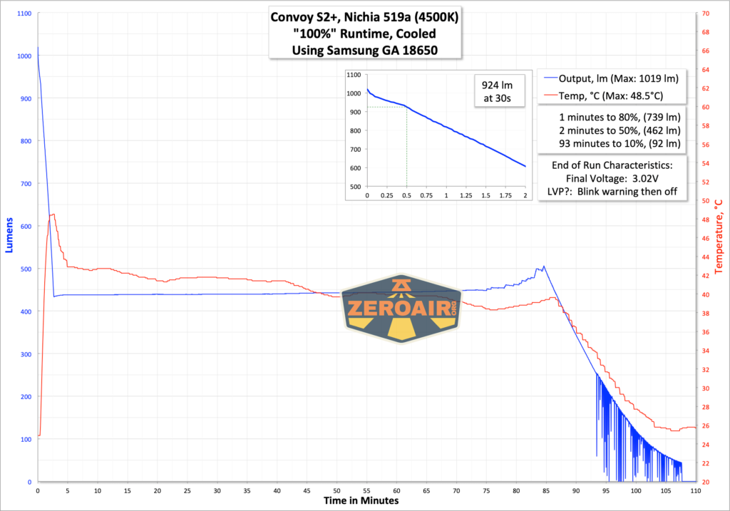

Check out the graph for the same test with a $15 convoy s2+ and linear driver.
Same thing. That’s just a runtime test. That’s not regulation.

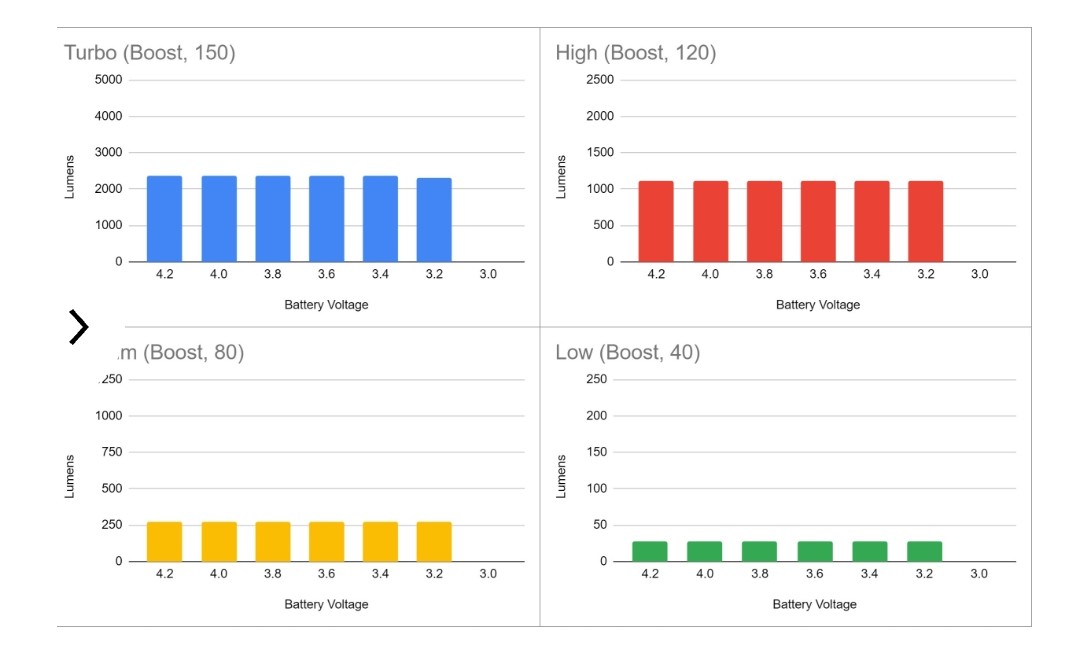

Regulation is a flashlight that is just as bright when the battery is almost dead as it is when the battery is fully charged. And boost drivers are the best at that. Check out the regulation for Hank’s boost driver measured by tacgriz on his site
Straight across the board. Like you would expect from a boost driver.

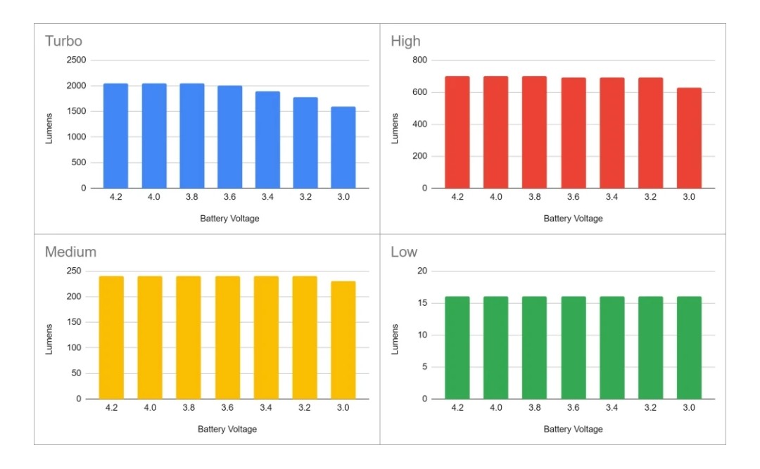

Here’s convoy’s 12v boost driver
Again, except for the highest levels pretty straight across the board

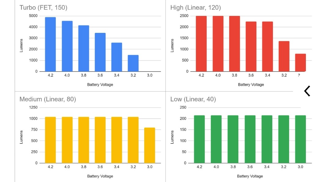

Here’s the graph for Hank’s linear FET, which won’t be as well regulated as a boost driver.
The high levels depend on battery voltage, but the low levels are still pretty well regulated. This is expected for a linear driver.

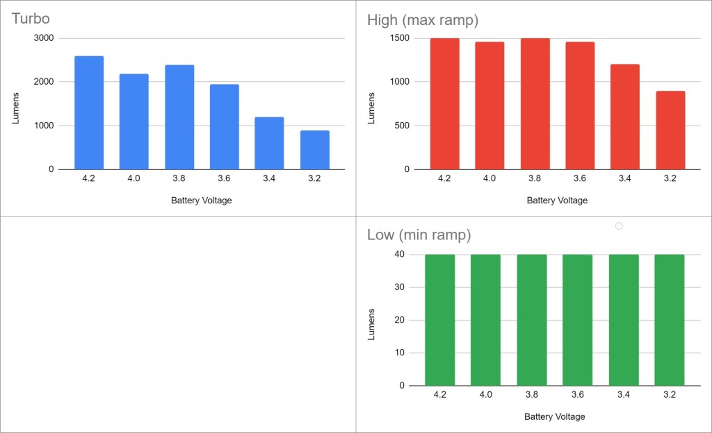

Now here’s the graph for the boost driver catapult pro
Output is heavily affected by battery voltage on all but the lowest levels. What is even going on here? This more closely resembles the graph of the above linear driver than of the above boost drivers. And this the most expensive flashlight out of all the above examples.
To be fair, I tested this ligh also, and it’s not bad. Yes, there’s the dropout drain from the capacitors (afterglow). Until you start putting stuff on graphs, you wouldn’t really care about the so-so regulation because at the end of the day, it sustains high output as good as my Acebeams do (with superior drivers and better regulation). Depending on which Convoy 17mm driver you get, it’s either a PWM controlled FET or 7135 based. A true boost or buck driver, even a so-so one will have better constant output and depending on the LED, better efficiency/lower temperatures on higher output.
