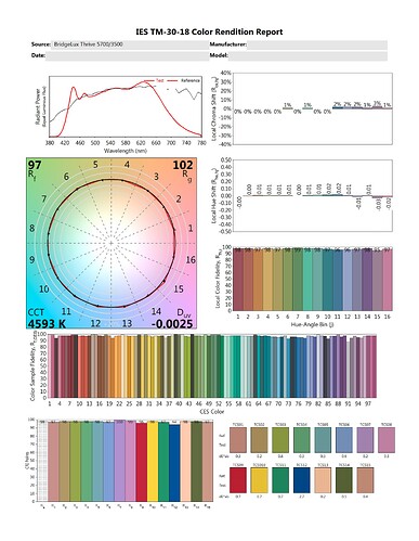

TM-30 report for a bulb I swapped in a mix of 5700K/3500K:

Nice light quality over there. With Rg 102 colors could be slightly oversaturated, but this should be fine.
I wish I could understand all that beautiful colored graphical jargon.
Any tips for how to learn to interpret that stuff.
Because visually I know what I want a blend of beautiful Rosy pink and slight blue mixed with white in the middle that’s the best I can do to subscribe but to me it’s like a diamond.
What system device generates those reports?
Gah wow tell me more

I use a Hopoocolor HPCS-310 spectrometer, and import the raw spectral data in ColorCalculator for the TM-30 report. I also have a ColorMunki Photo, but it’s lower resolution and doesn’t appear to be as accurate.
