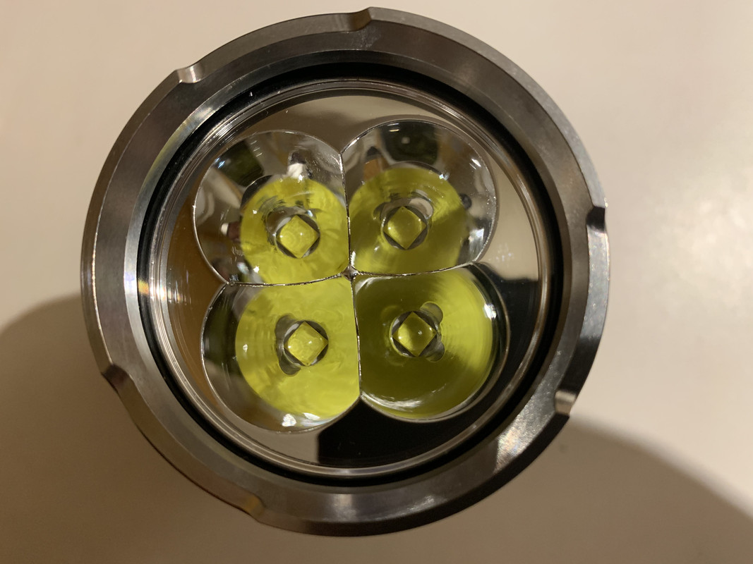

Sofirn Q8 4xK2 3B0 5400k 3v 50.2’s……………………………………
Q8 K2 5400 to Triple C8F 1A 6500….tint…
YUCK! :confounded:
Iieewww :frowning:
Wait for the better tints perhaps then. Slicing may help reducing the green corona but the overall tint will get greener, so that does not really help.

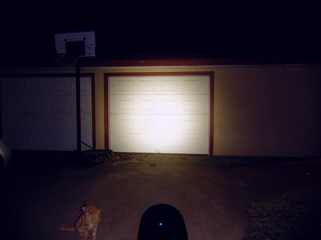

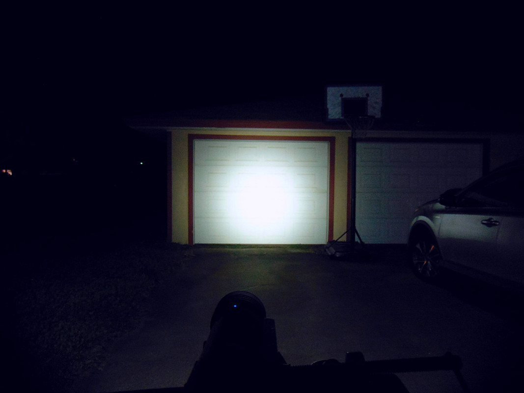

Here is a picture of the 70.2 in my ThruNite TC20 after it was sliced and diced ……….
And here is what the beam looked like before on a White Garage door (medium mode)………
And the same light and same emitter , only with the slice and dice done……….

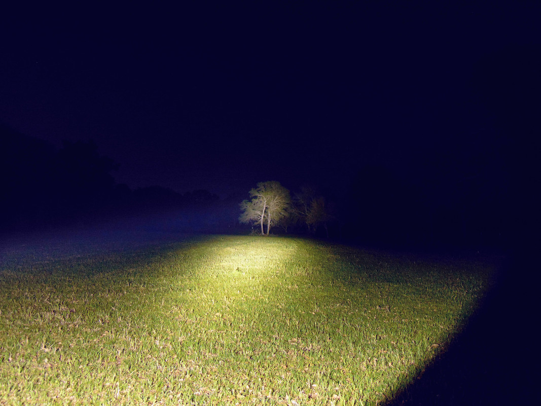

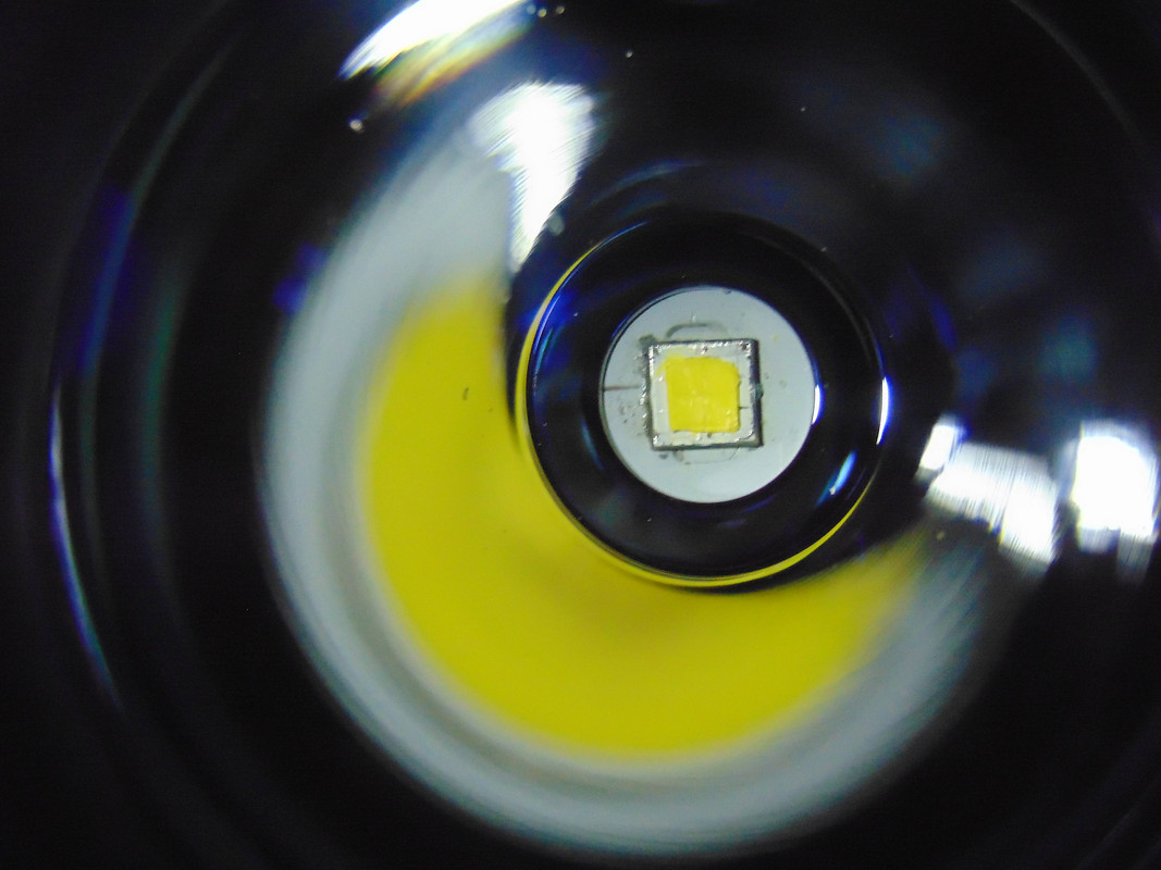

Not the best picture of the emitter but , here is the sliced and diced 50.2 K2 3C / 5000K , that I put in 1 of my Maxtoch 2X a few weeks ago….
And what the sliced/diced 5000K 50.2 looks like out in the field by my house at 175 yards from the trees (No leaves yet on the trees in the picture)…….

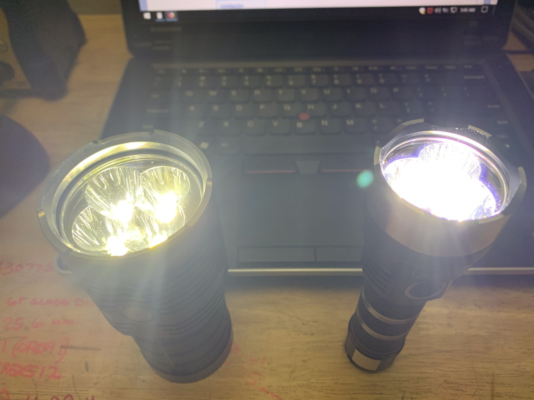

Sliced & Diced 1 and De-domed 1 3v 50.2’s so far, got 10 more to go! I Dropped the de-domed (it was just about perfect one little tiny piece of silicone left on it) on the FLOOR, guess how it landed :cry: , sliced and diced work good and then it started to burn on the Rock, it is soaking now in some Toluene.
Now I’m just checking the different tints and going for out-put, so I’ll pull 2 of the 5400’s and slap 2 6200 1D’s on the Q8 and offset the crap, might be nice, never know… :smiley:
