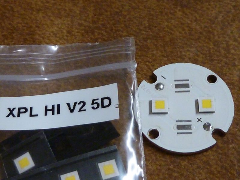

I modded the AX3 - really like the twin LED setup. The X9 is another sweet light - plan is for triple 3V XHP50.2's - not sure if I did this already??
Ohhh, guess I did -- yes, all in parallel for these:
This is what I did for the AX3:
