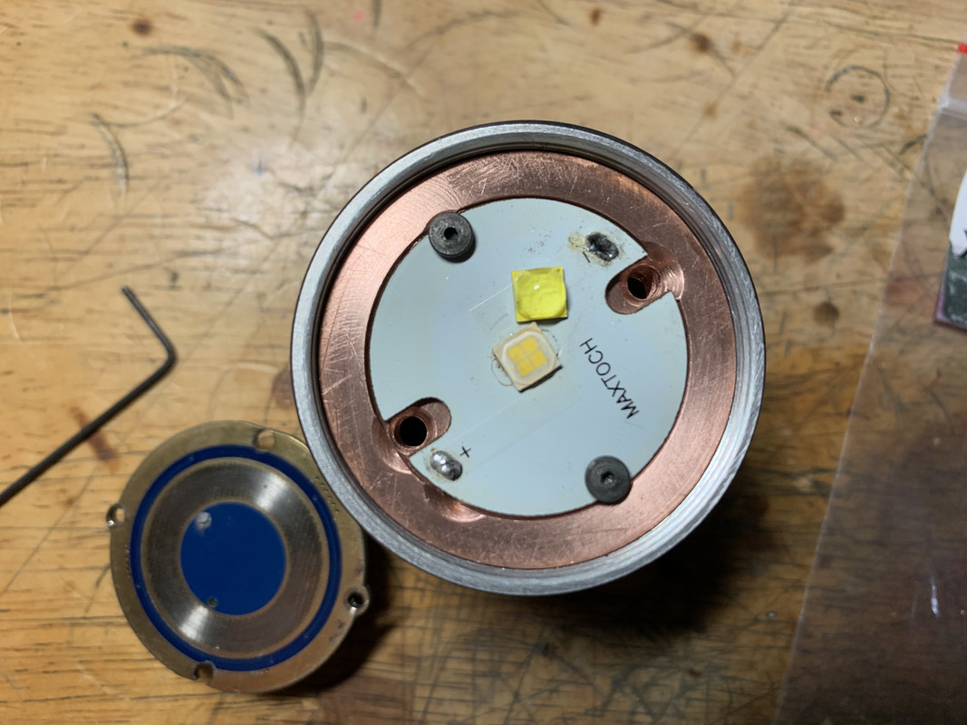

Yes I like it… don’t want it to go directly to Poof!

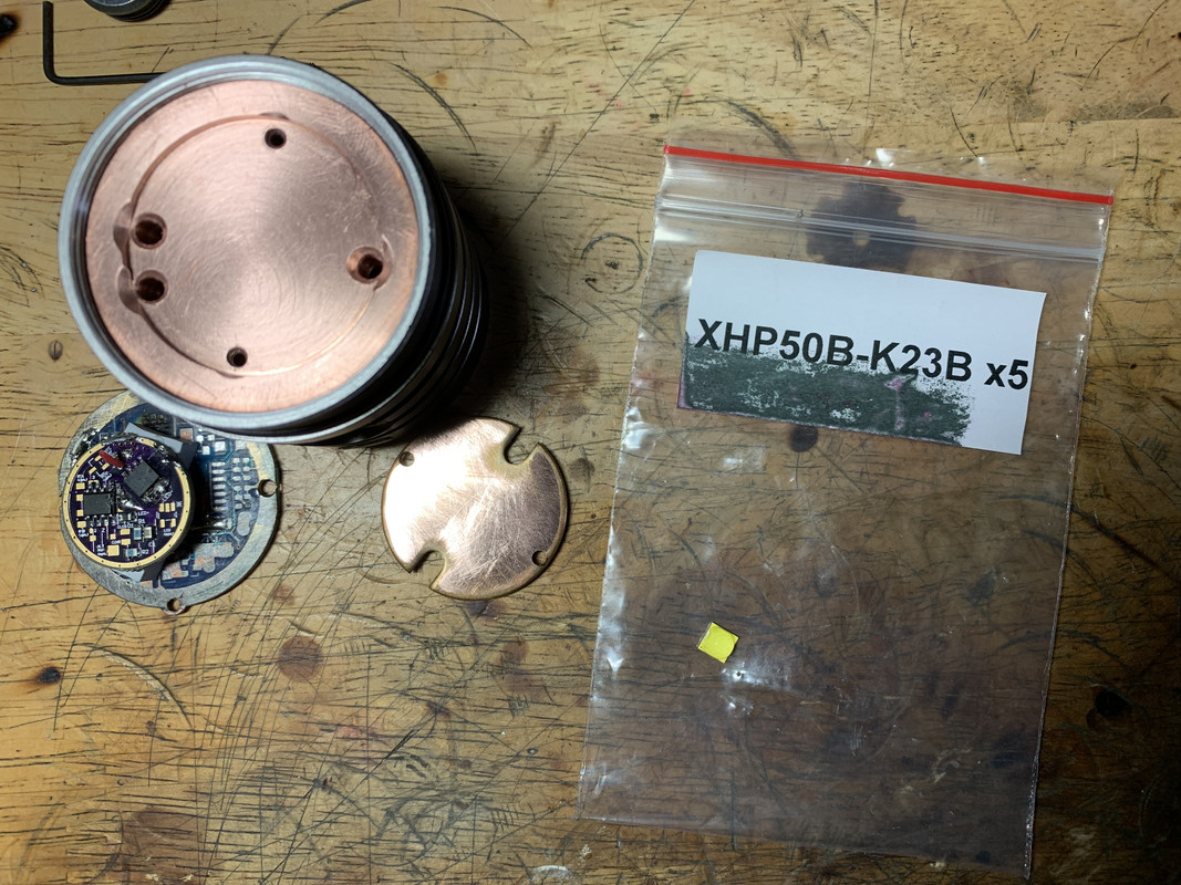

. Copper press fit sink - Check!
. Copper base plate, brass screws, 18awg spring bypass’s - Check!
May it (5400k) Die a slow and agonizing Death! :rage: :+1:

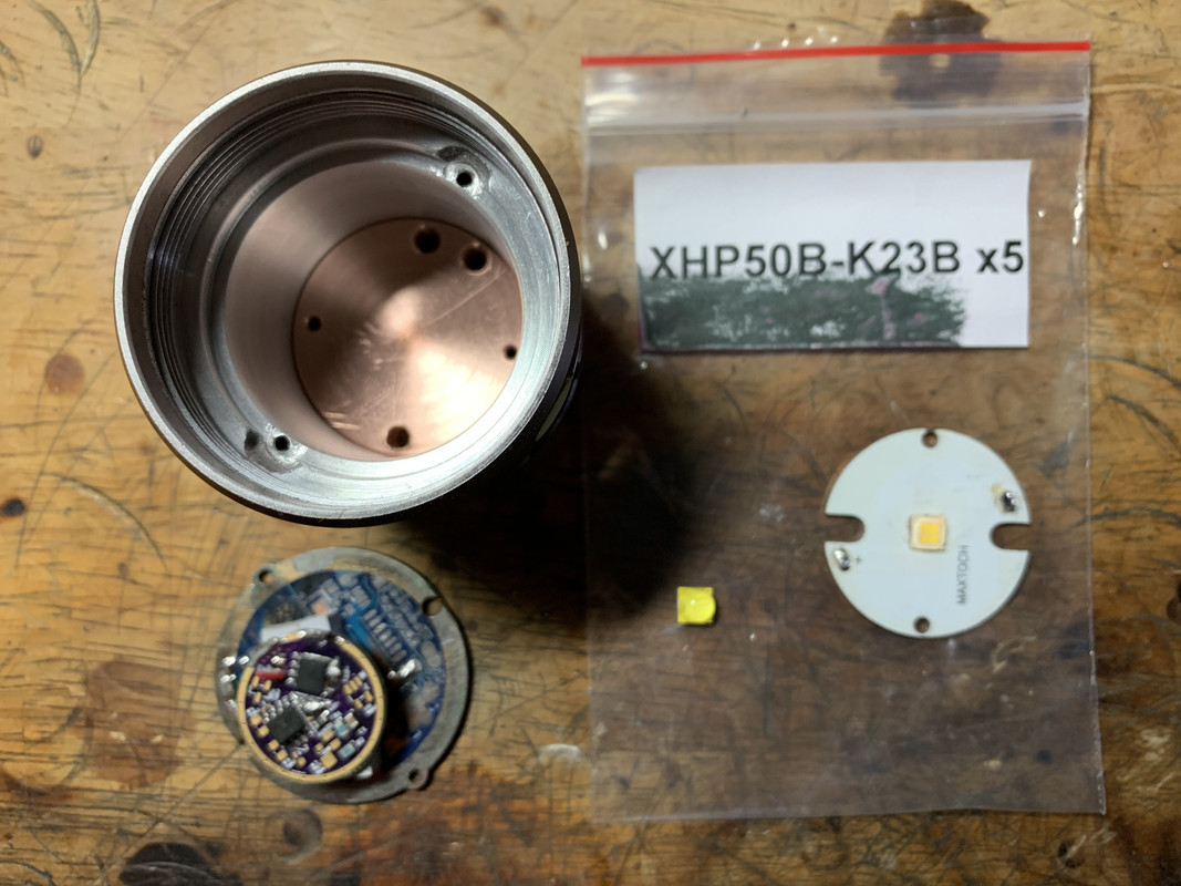

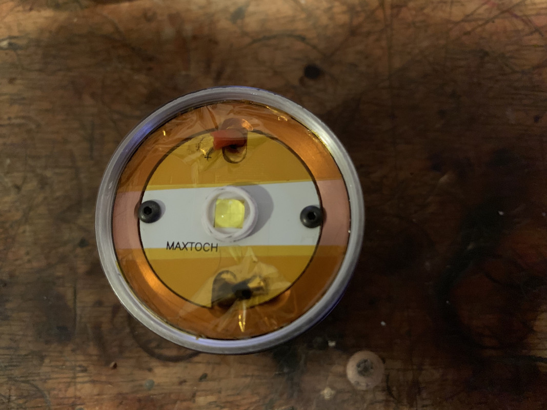

Not from the solid copper spring pcb, the old spring board had a jumper you could solder a loop across or add a switch.

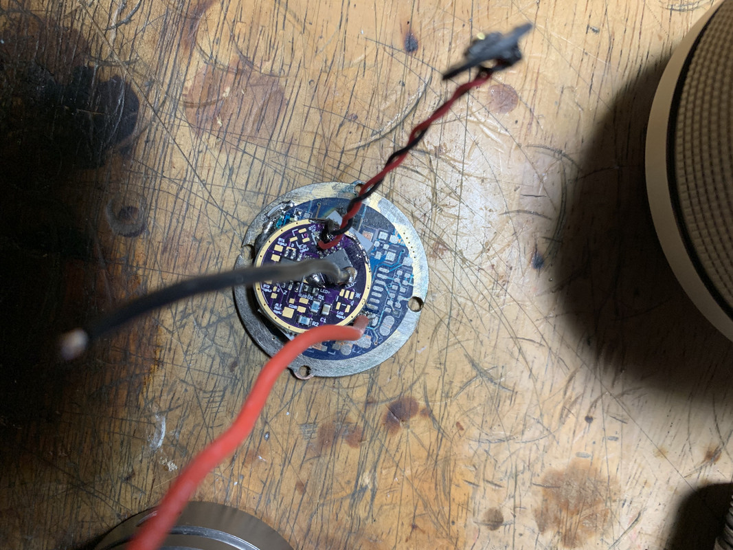

Pull the reflector (so easy with the Fat Head, just unscrew the entire head), de-solder the negative wire at the MCPCB, solder a loop between the driver lead and the MCPCB pad and get a current read at the emitter. :wink:

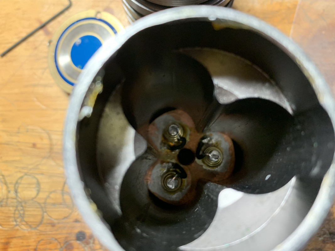

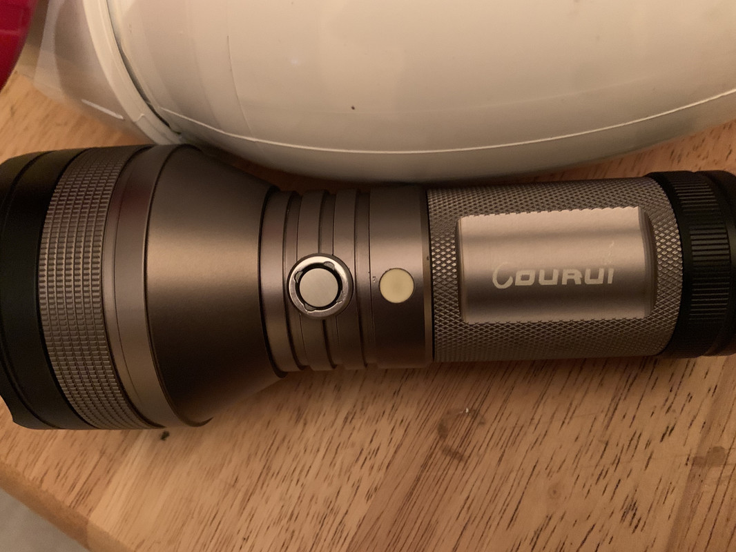

Great Idea :+1: But NO… I tempted fate twice this weekend and got burned, destroyed a MH20 and fried the driver in the C8F.

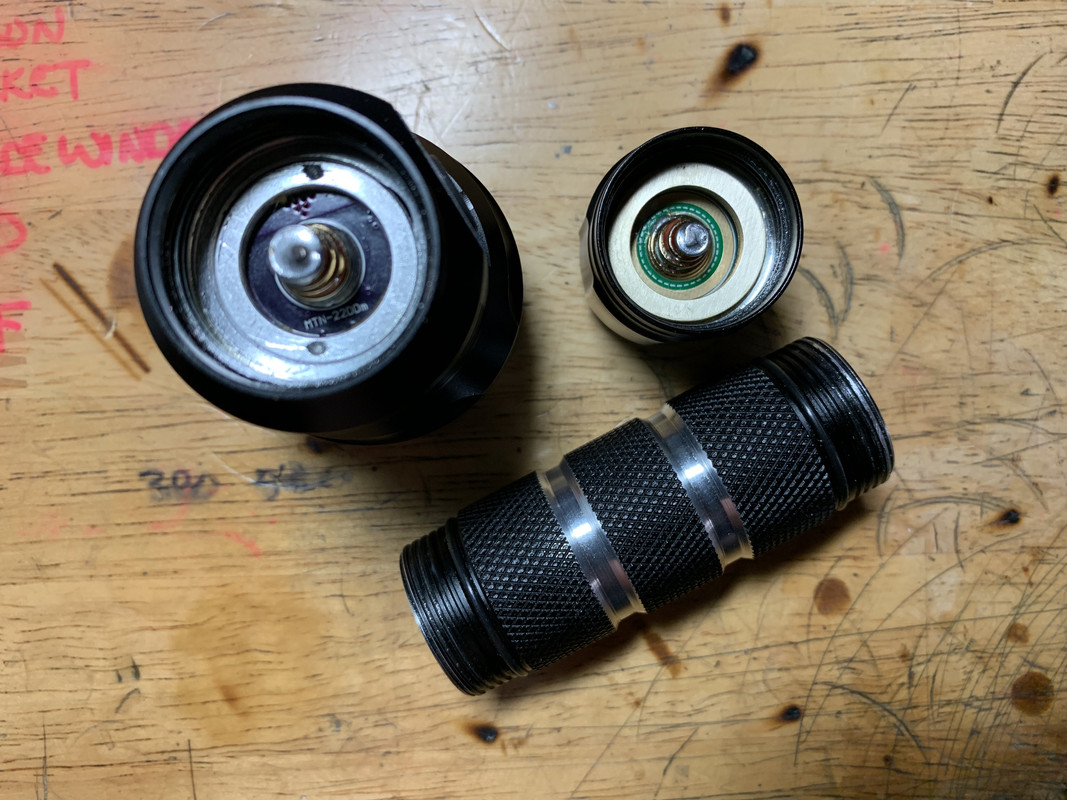

. But the good news is I had a Mtn. 22mm FETDD driver D4 UI V2 ( I don’t remember it ramping so fast) and I installed it in the C8F along with a brass battery tube spacer in the tail cap, no more dented 21700’s.
The Utorch C8F is now making over 9,000lms at turn on using a 30T 4.21v off the charger pulling just over 30amps. :sunglasses:

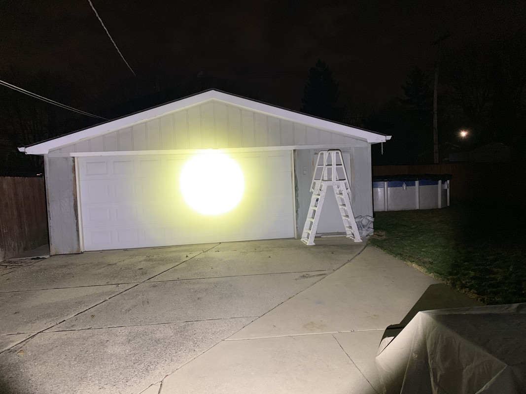

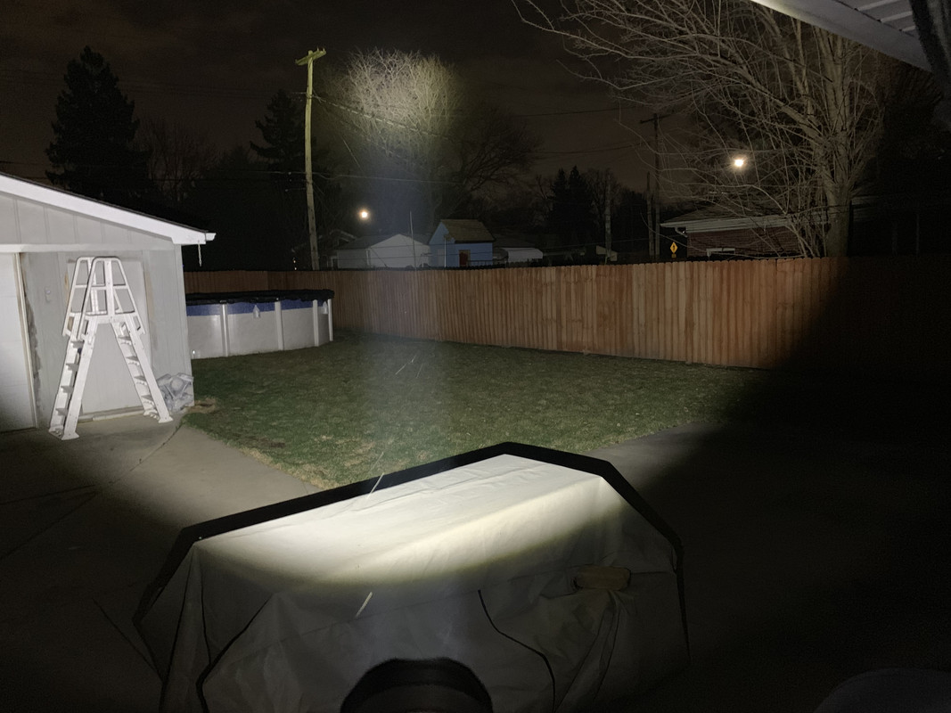

I put one of the 3V 50.2 in a Thorfire C8 with OP reflector and a FET driver.
The little C8 surprised me and holds its own pretty good against the much bigger Thorfire S70 with much bigger head and bigger emitter.
This is what the C8 beam now looks like compared to the Thorfire S 70 with the 70.2 I put in it , on the original driver.
At 100 yards from the gate………….
The C8…………
The S 70……

I sliced and diced a 3V XHP50.2 6000K and put it in my FT03…
14,2A at the tail, 140kCd and an unknown lot of photonsfrom the bright end (guesstimate 3000+ lumens ?)
It does heat quite fast for such as massive host, and the hotspot is bigger than stock.
The tint is warmer than the dome on LED of course, and the dicing get rid of the ugly green corona around the hotspot
