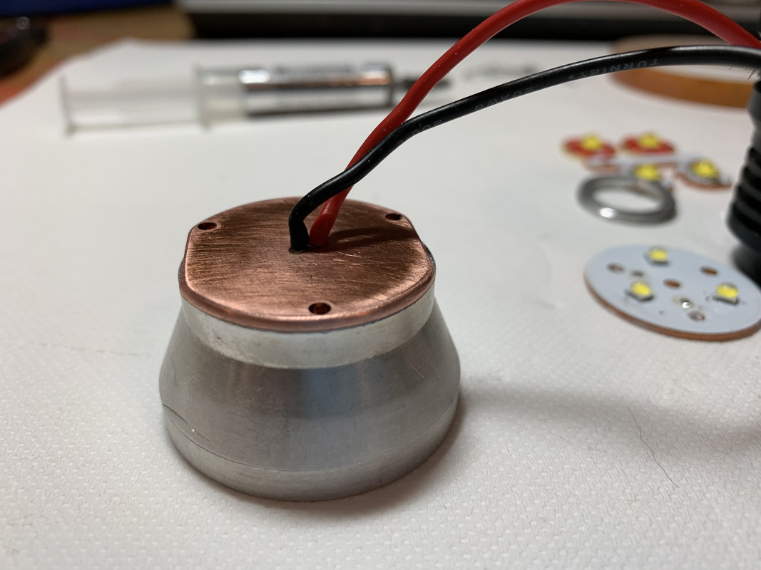

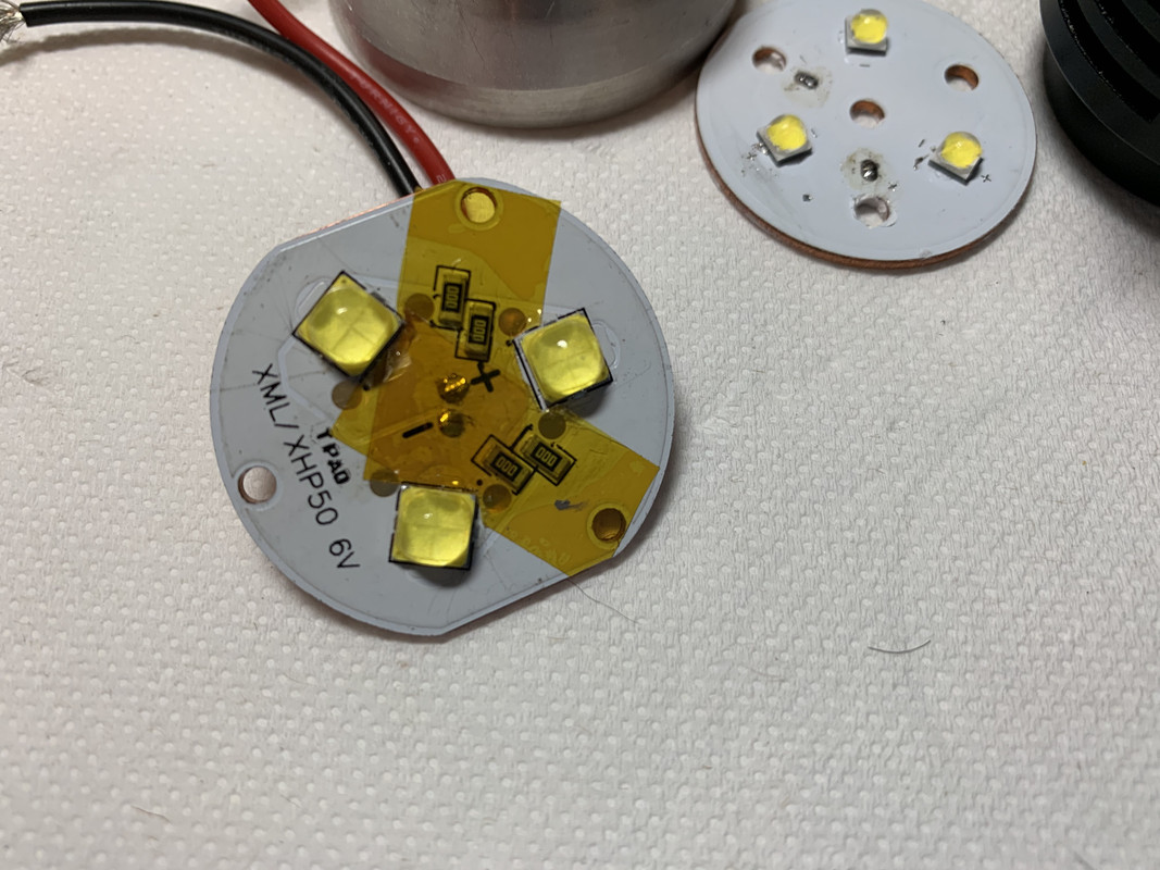

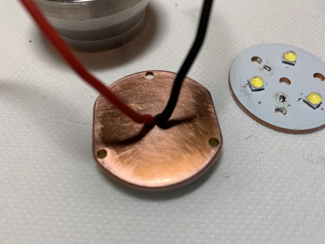

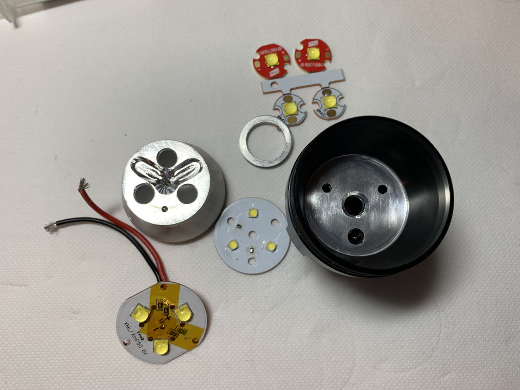

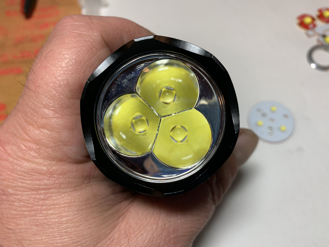

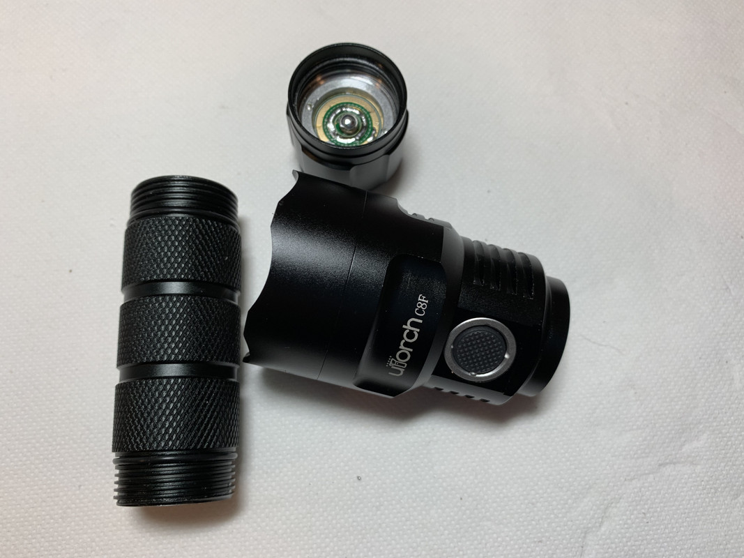

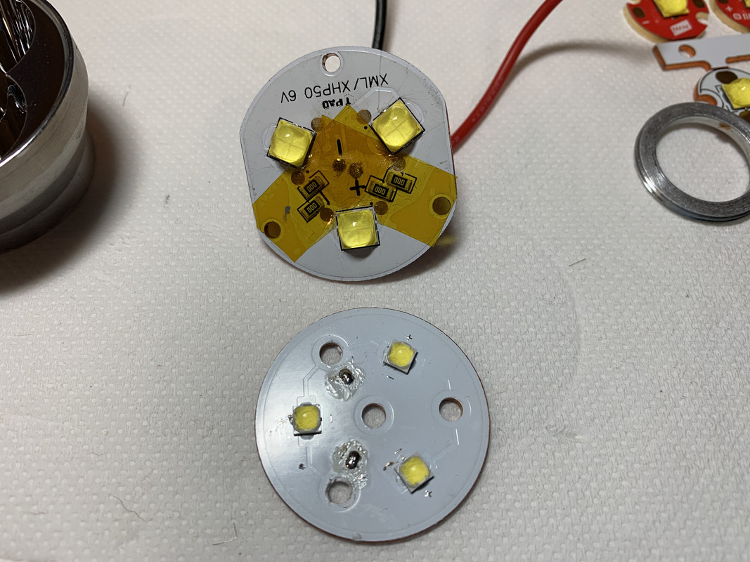

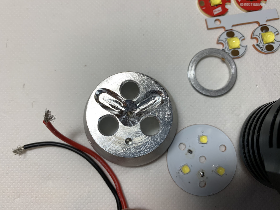

Just built a 21700 C8F 3v 50.2 Triple……in a word,STUPID!
Using the stock UTORCH C8F driver it’s pulling 23.8amps for 7036lms. on a 30T at 4.0v

For the 17A, that's expected, least for me. 4.25A per LED, should be ok.

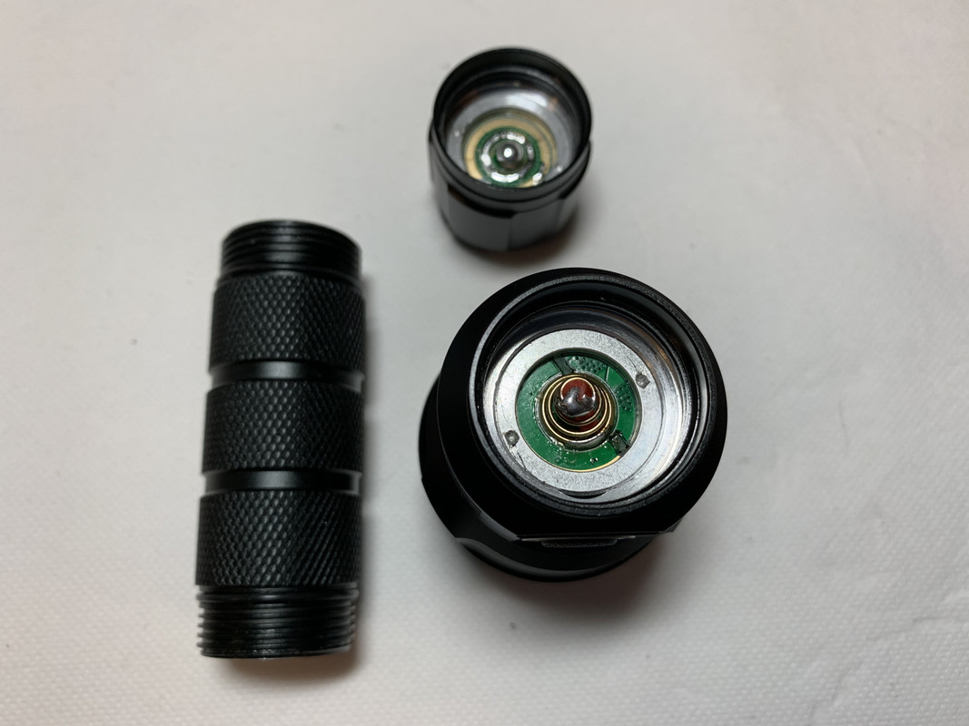

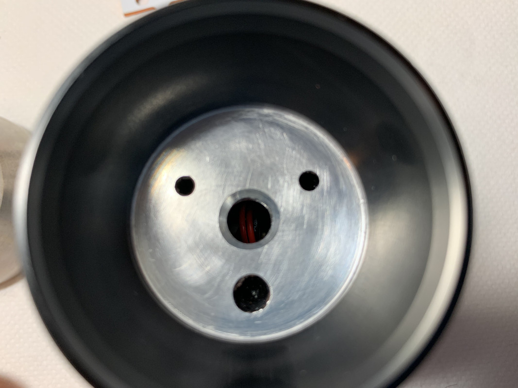

Yeah it’s the stock UTORCH driver, 18awg driver spring bypass that is it…. was going to swap the FET to an Infineon…but why waste it, this light gets stupid hot fast…
Awesome Kawi! Which optic works?
