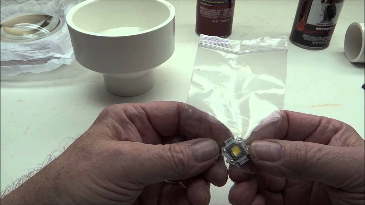

I wanted to see how the SST-90 would look with the 108mm lens, so I set up how the head would be and put the SST-90 on my aluminum rod heat sink, for some testing.
The SST-90 came from Kaidomain and it's on the stock 20mm mcpcb. It's copper, but probably not DTC. No matter, when it's on this aluminum rod, it will not get hot. Takes about 20 minutes for that long 1-3/4" diameter rod to get real warm.
I'm using the 2" to 4" PVC reducer with a 4" PVC coupling on top of it, to get the height I need, from the led to the lens. I cut a piece of 4" PVC pipe and put it down in the coupling, so the lens can sit on it. When it is done for real, the Maglite head will go in the 2" end and a custom heat sink will put the led level with the top of the Maglite head and flush with the 2" section of the pipe, so it will shine into the large diameter, instead of being constricted. Thanks to a member's post here, reminding me that I should not have the led down in the smaller diameter.
I used one of my 26650 cells direct drive. It gives me about 5.4 amps and drops from there. The bottom of the lens ended up being about 154mm from the top of the heat sink, so about 150mm from the led to the lens. The lens was quoted at 190mm, but I think it's more like 160mm to the focal plane. Anyhow, I did some testing and I really wanted to do some good photos, but no matter what I tried with this new camera, I can't get the shot I want, so I have a poor one and then some "smoke shots", to show something of the beam diameter.

I also got the SST-90 over to a Maxtoch star and got the dome off. I heat those with the hot air gun at 225 degrees and it lets the dome come off easily and seems to leave the sealer over the die to be more clear and smooth. Maybe it's just me, but I like the heating method.

SST-90 led de-domed and mounted as it will be in the finished light.
